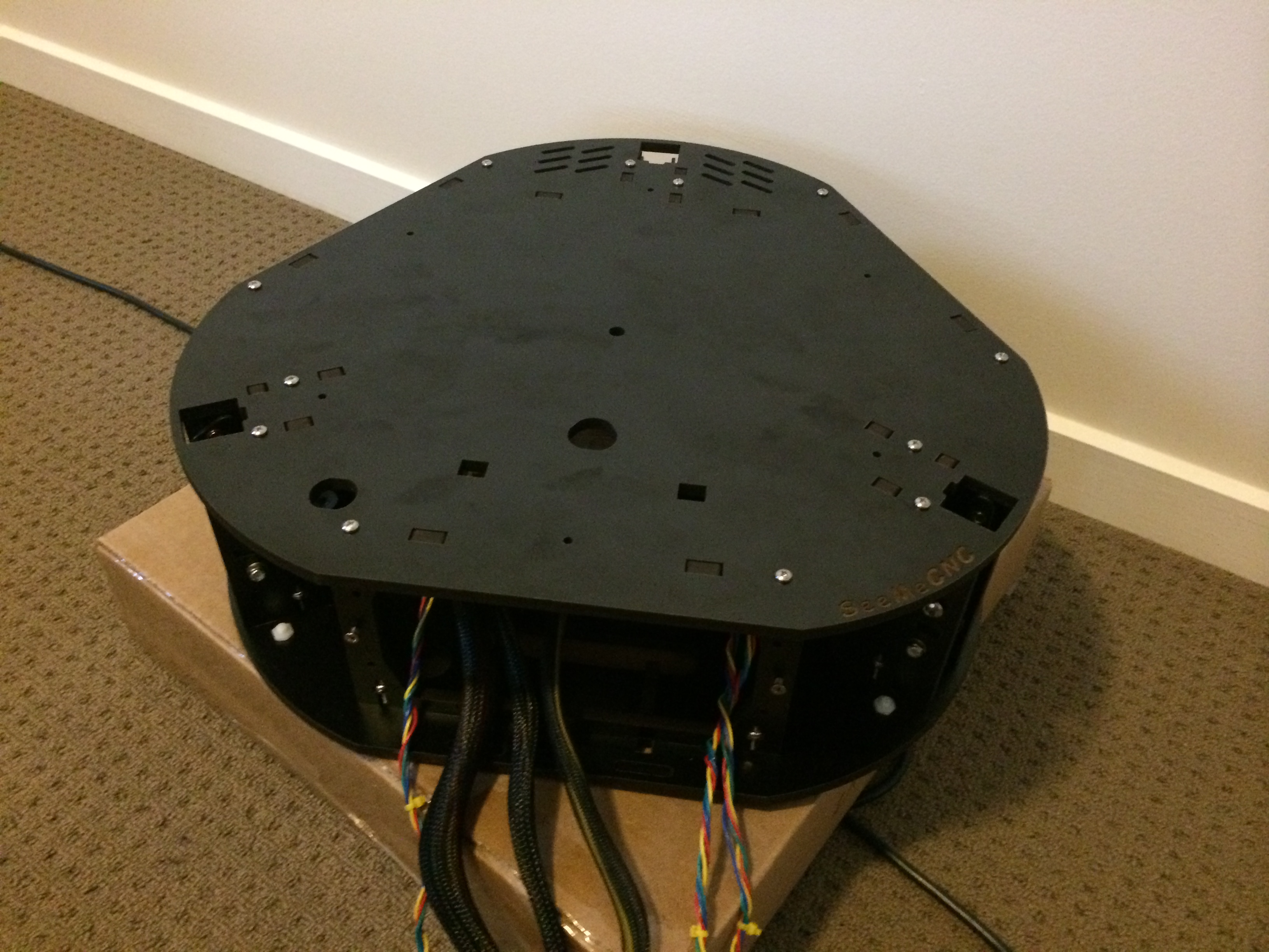

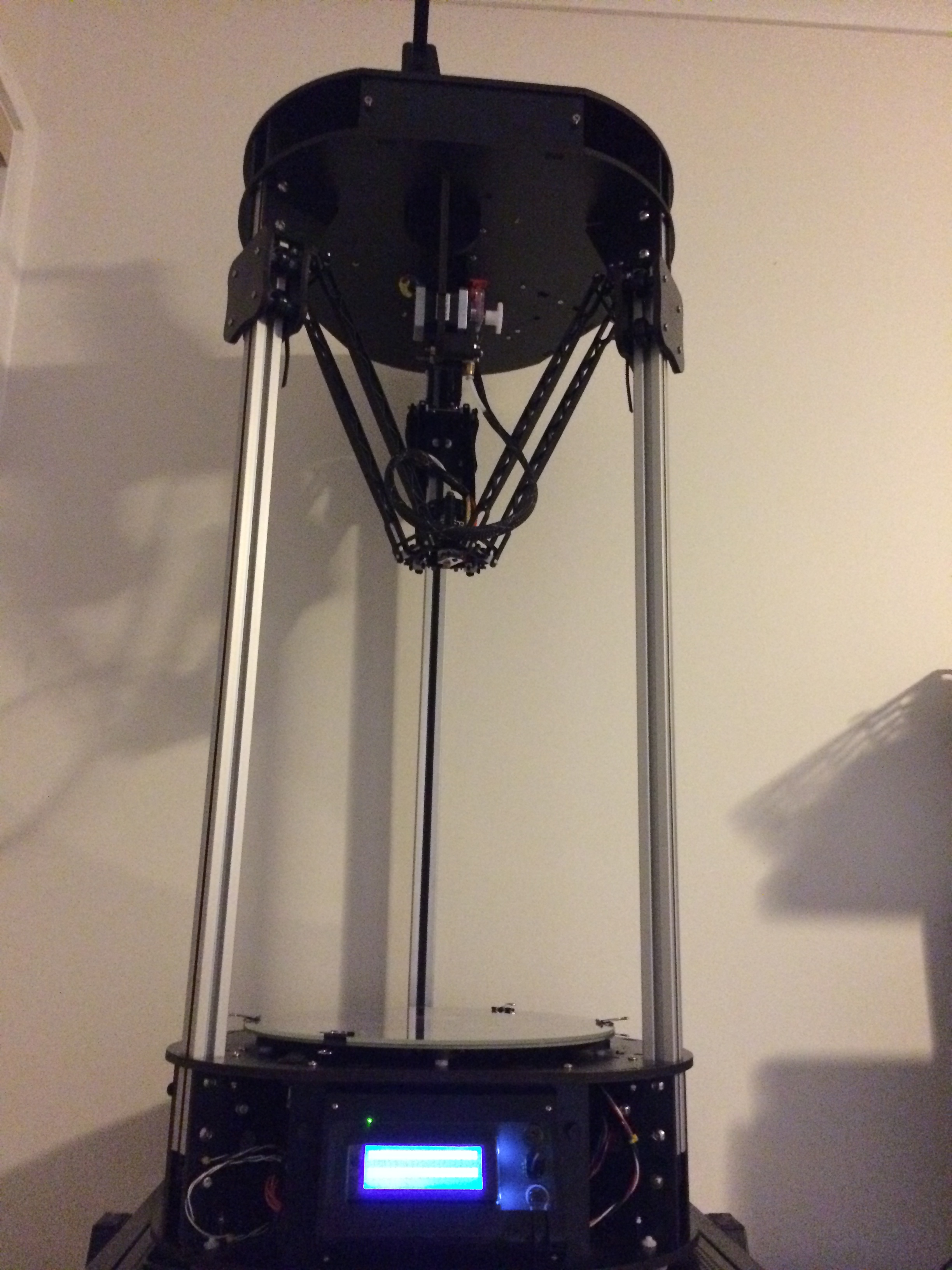

Hi Everyone at SeeMeCNC, looks like this is the place to be for all things delta! It has been great looking through the threads and finding so many awesome builds and people helping each other get the best from their machines. I am a recent delta convert thanks to our local Australian supplier DooDadDoes who have been a font of knowledge and most genuine helpful and all around nice people to deal with. I had never even considered getting rid of my hugely expensive name brand printer until I started talking to Isaac, who, somehow inspired me to make the jump over to delta heaven. He has helped me throughout the entire build and even printed me an E3D mount and had it shipped to me so quick it wasn't funny, all so I could get up and running quickly and painlessly. If you have''t already guessed I'm a pretty big fan of old fashioned genuine customer service and product knowledge of which Isaac and DooDadDoes have by the bucket load. So, thanks Isaac and hi to everyone!! Here are a few photos from the build I started about a week ago, great kit, great manual and overall positive experience, hopefully you enjoy the pictures, ill let them speak for themselves. :D :)

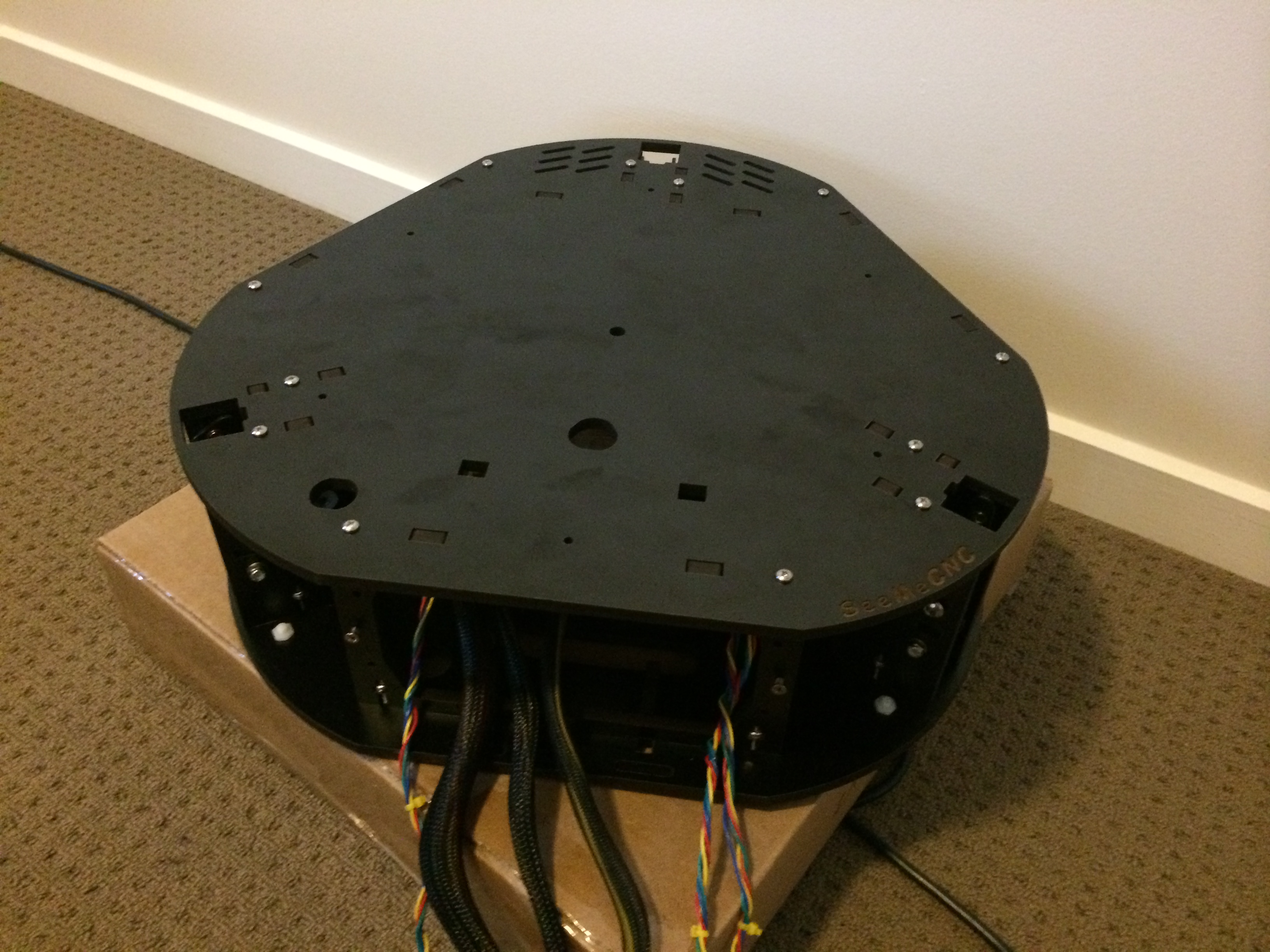

1st day, Thermaltake Toughpower 750w modular power supply wired and fitted into base.

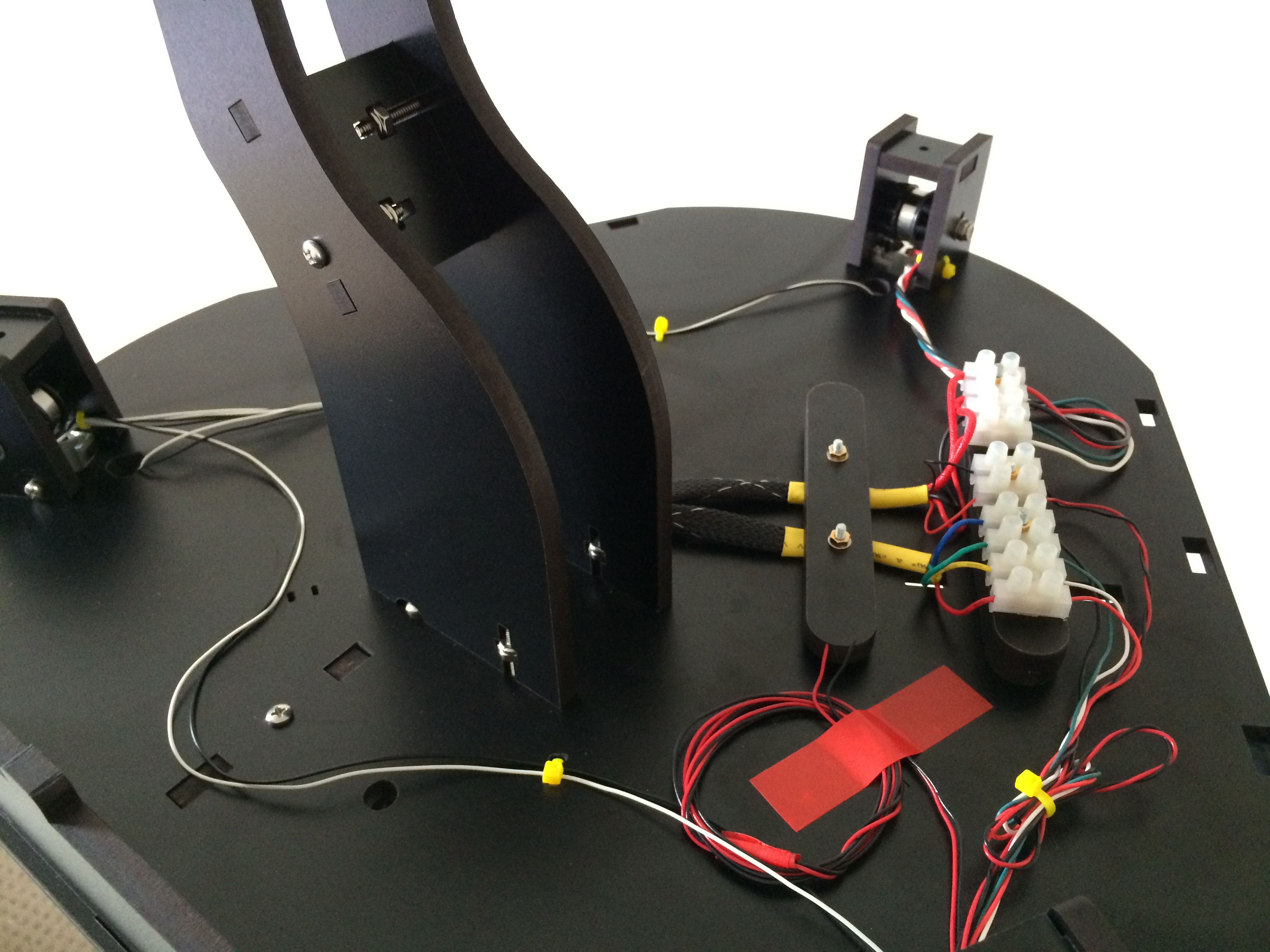

2nd day, wires run to top of machine and wired, also fitted tie down point from offcuts to relieve strain on the cables.

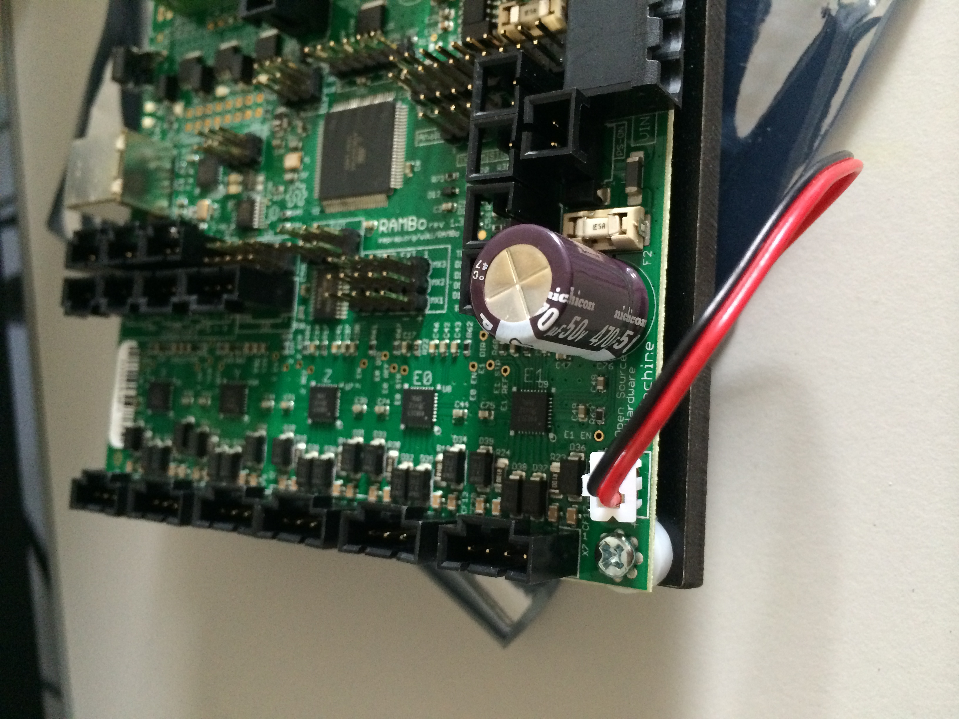

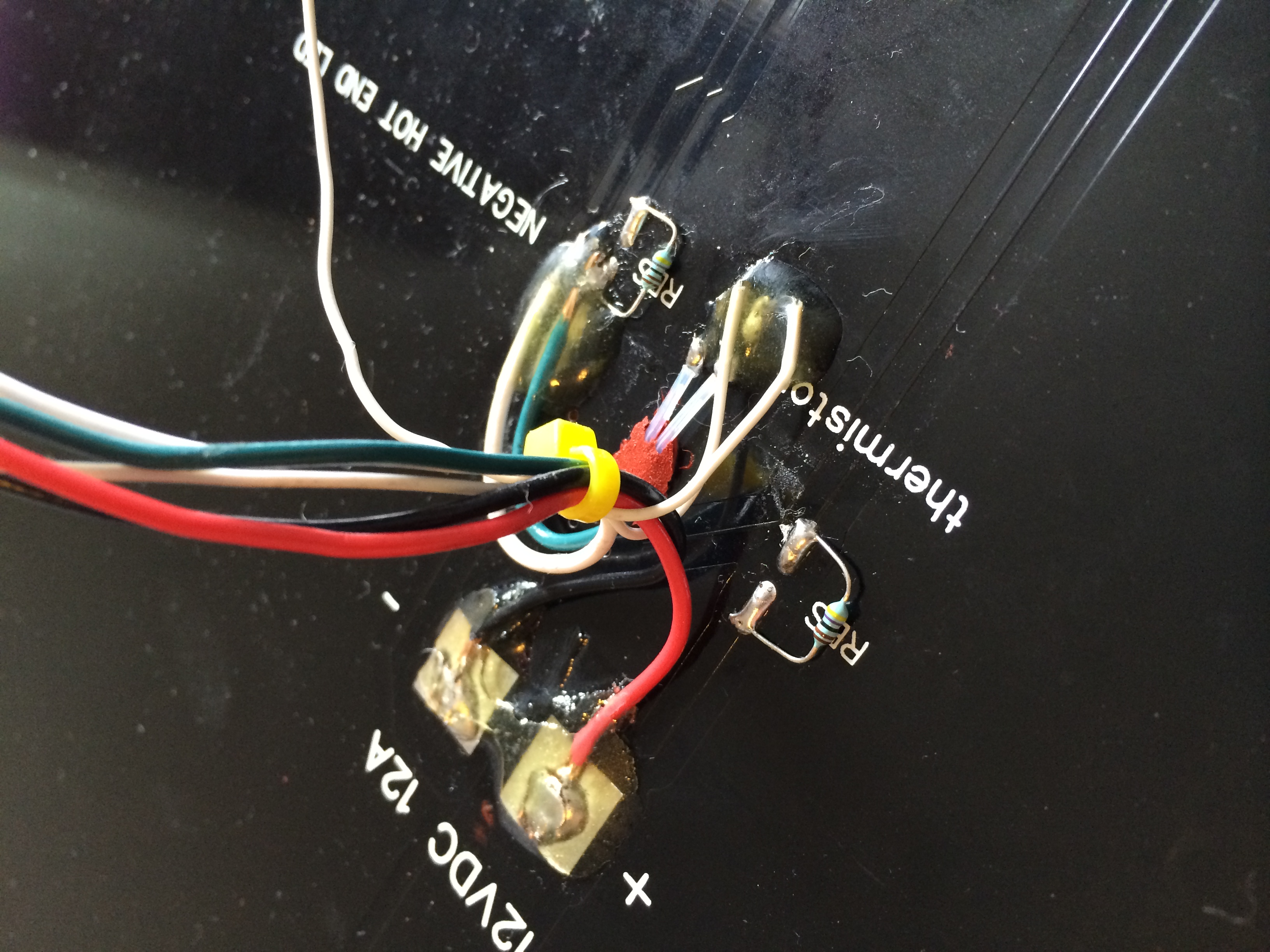

3rd day, 2 pin header soldered onto rambo, also soldered up heated bed etc
Switching it on for the first time.
Hotend (E3D) mount printed for me by DooDadDoes, thanks Isaac!
Firmware uploaded, nearly time for calibration.
The first plastic to pass through the nozzle. :)

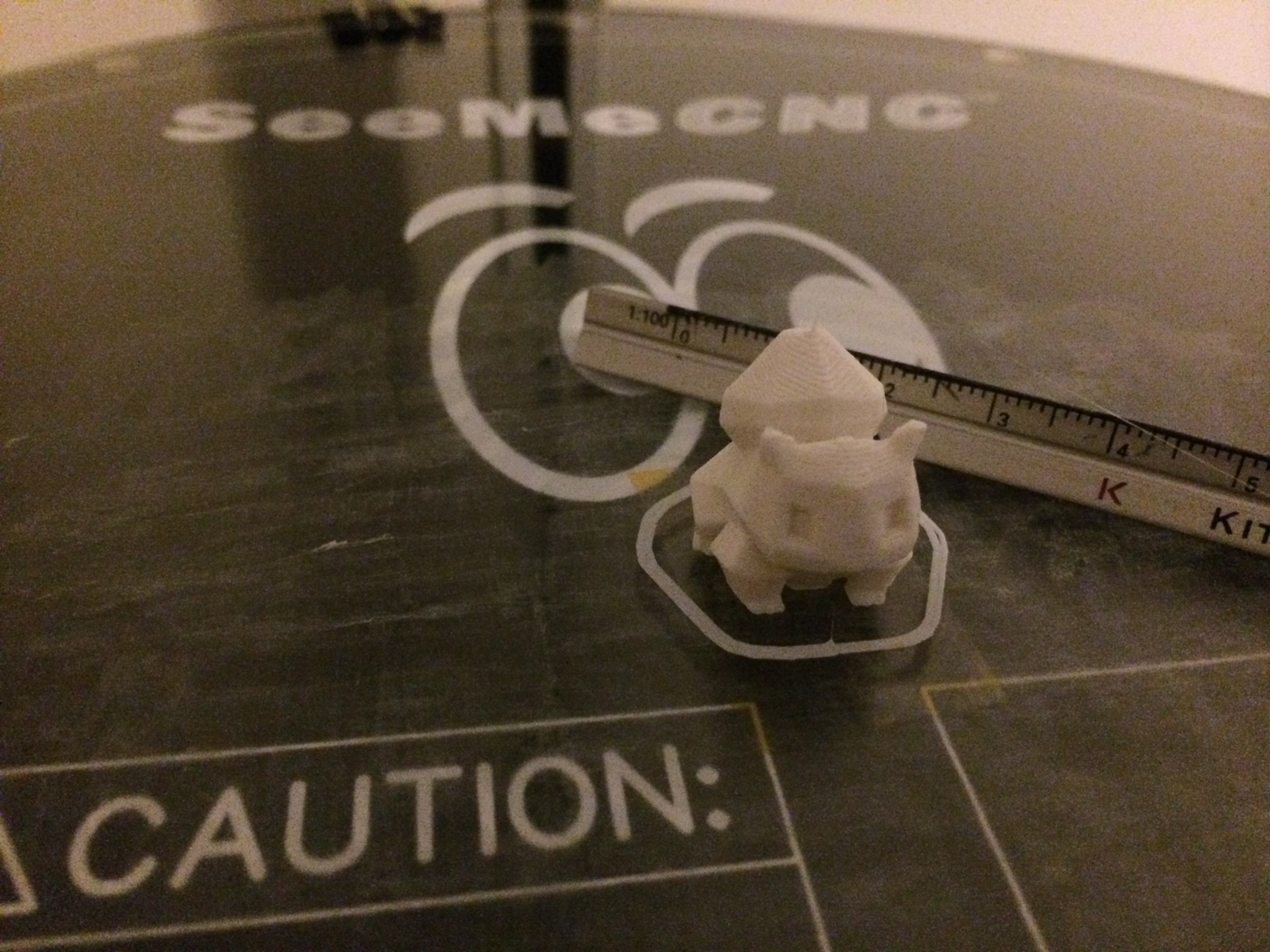

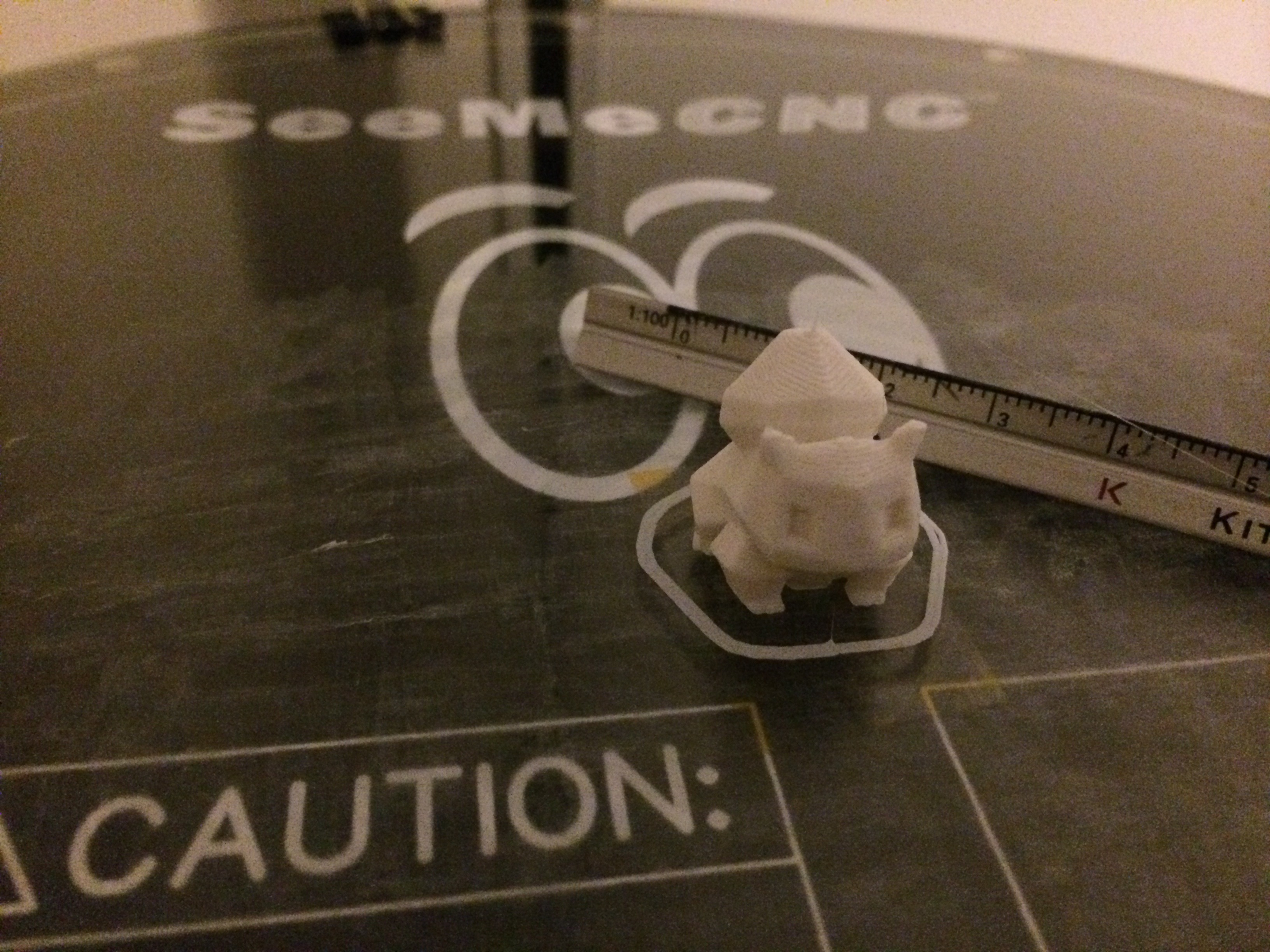

The first print!! Yes that lowpoly pokemon is actually very small, so far really happy with the print quality and I havent even done any fine tuning yet. Loving this machine.

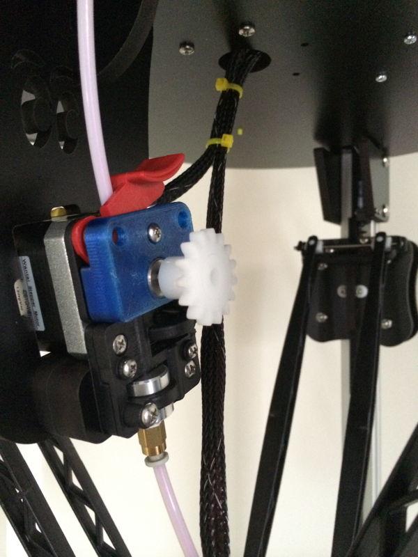

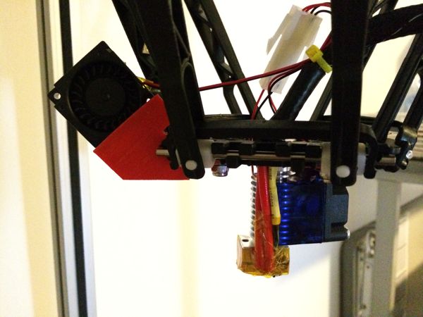

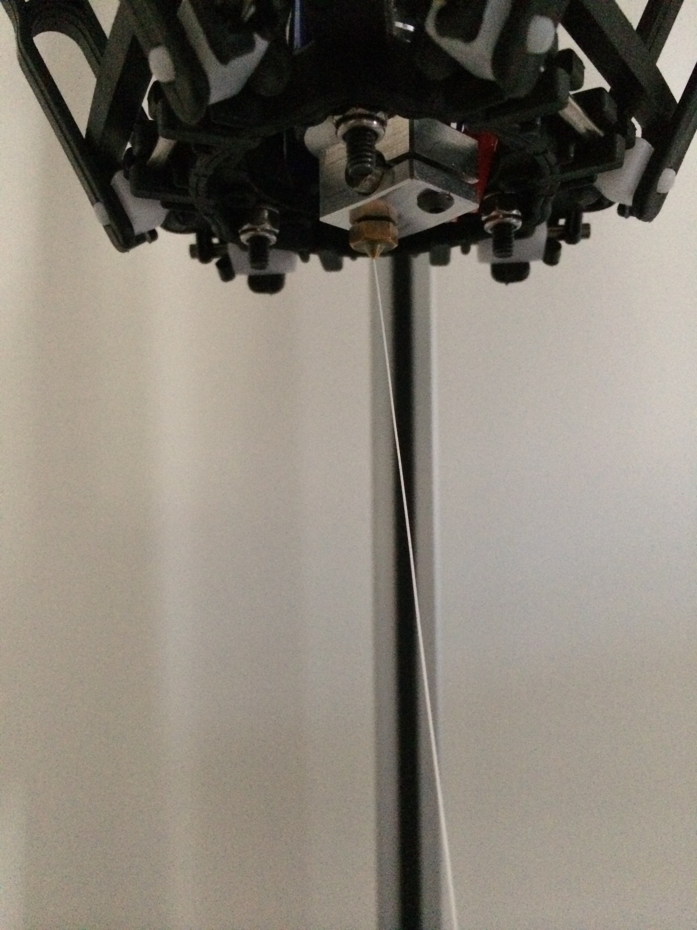

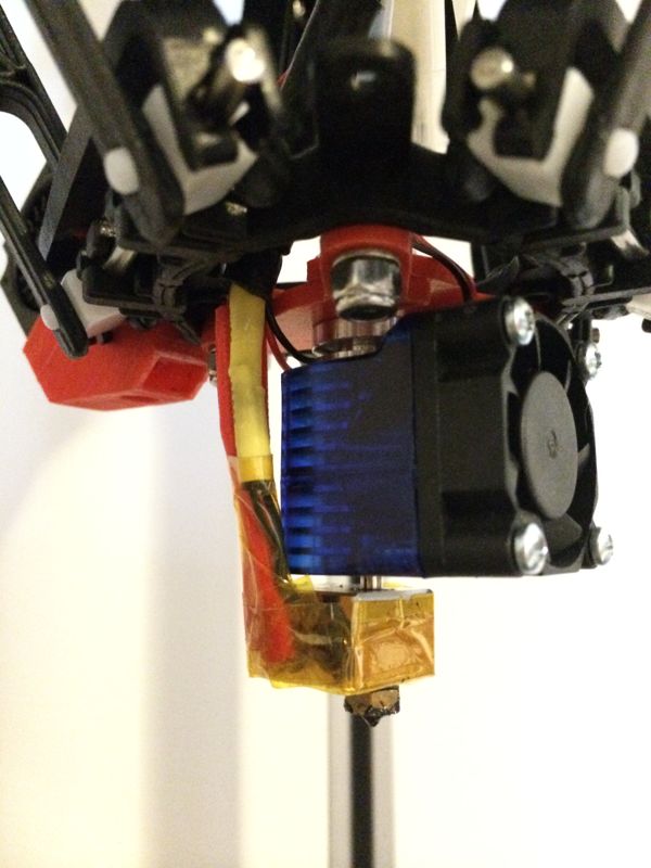

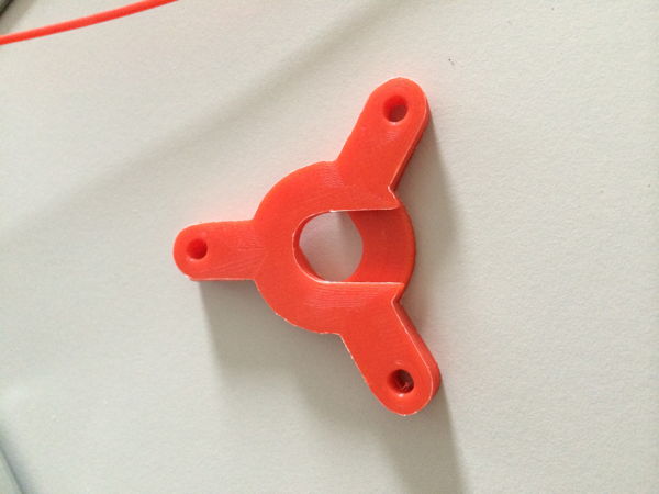

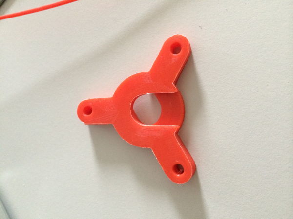

Printed a new mount for the E3D, I was trying for minimalist and function with the hotend mounted underneath the platform so that I can see whats happening and so that I have a small amount more airflow whilst still being able to print ABS, PC and Nylon, without having to add a layer fan. My layer fan is being used as extra cooling for the E3D so it can stay cool when running 300+ potentially printing PC. I also slowed the fans down by setting 240 instead of 255 in the firmware to reduce vibration. :)

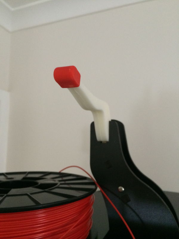

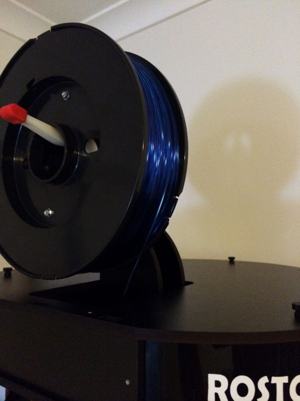

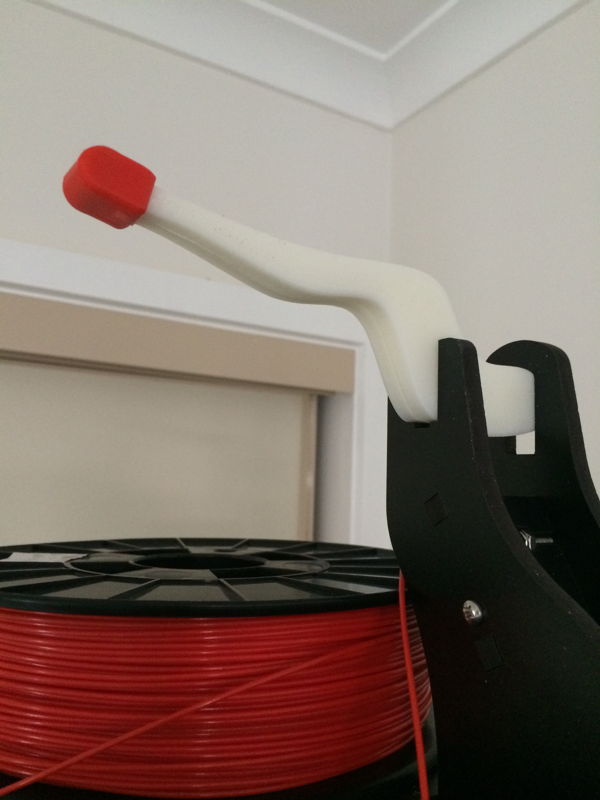

Designed and printed a new spool holder which is about 25mm higher than stock to allow me to use some of the left over stratasys spools (which are taller) I had without having to re-spool everything all over again.

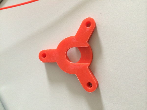

Printed a new cover for the EzyStruder out of PC just to give the PC a go and thought it looked cool so put it on, ill keep the original one as a spare but I dont think this one will need replacing any time soon. :)

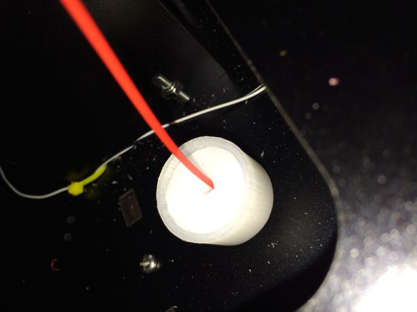

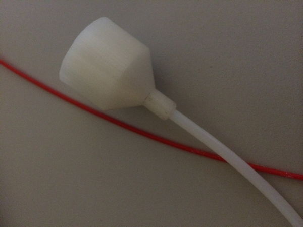

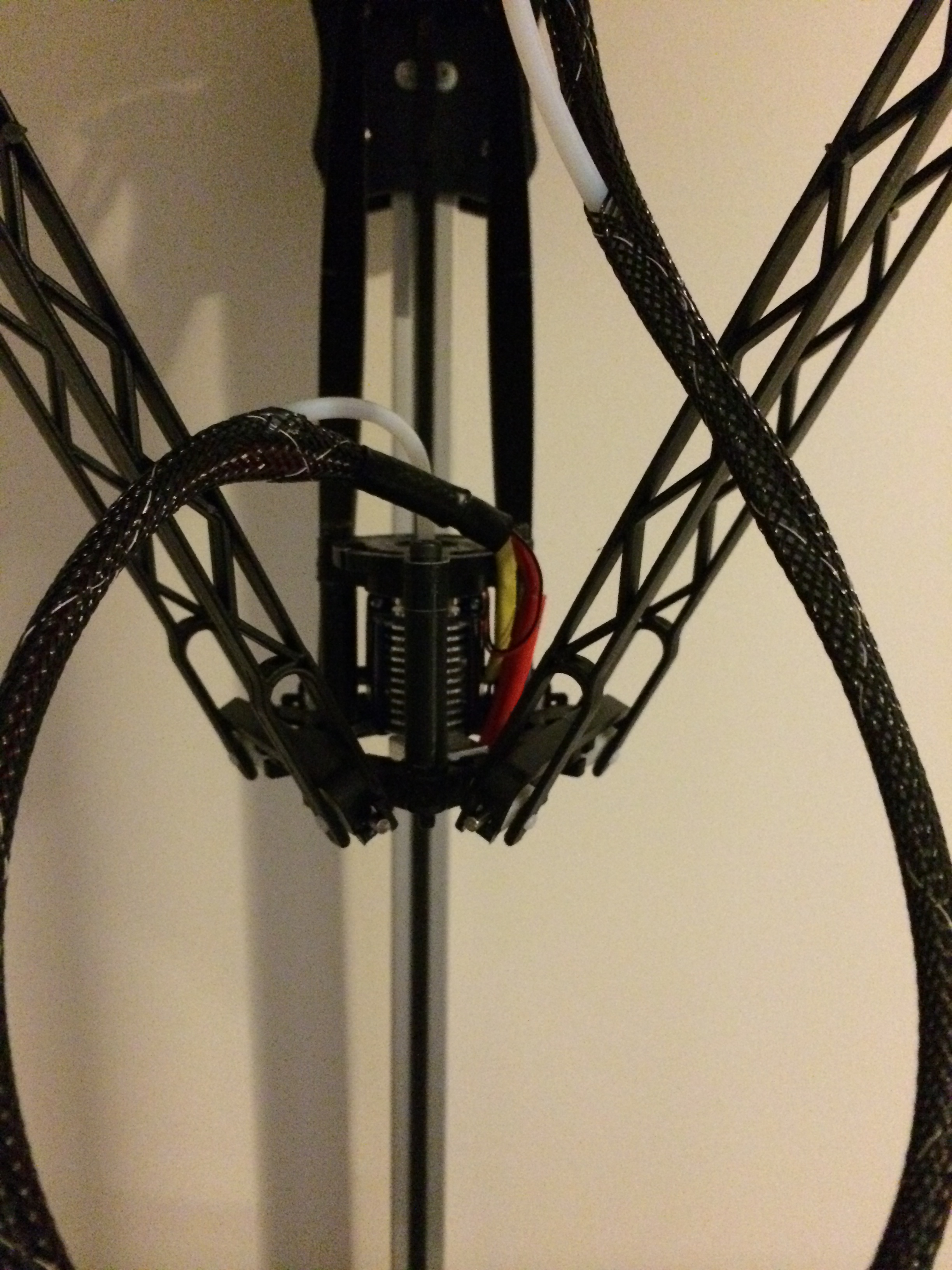

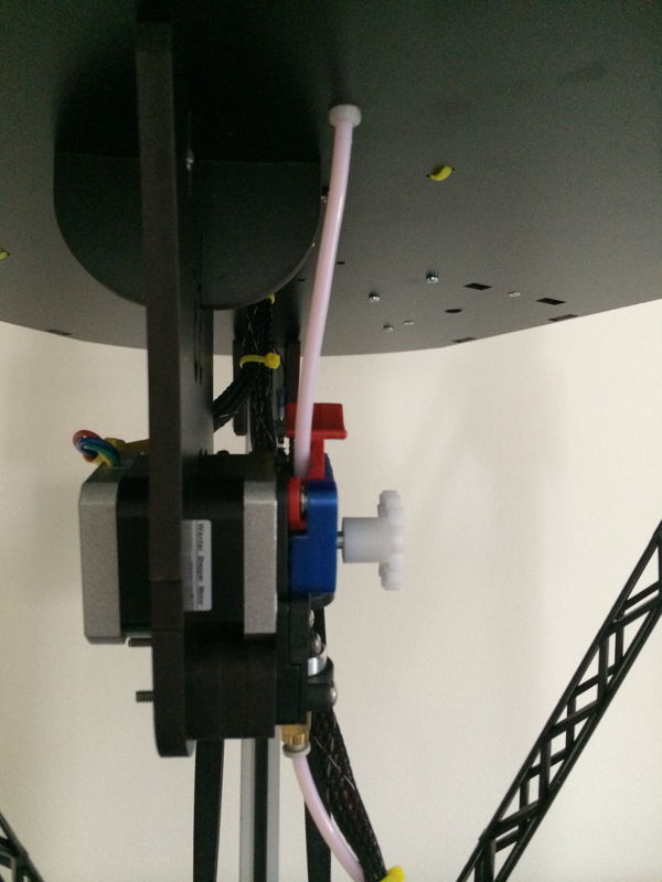

And lastly designed and printed a "filament funnel"? if you can call it that so that I could clean the filament on its way to the extruder and then keep it inside a ptfe tube until it gets to the drive wheel. Printed in Bridge which has turned out to be a great material to work with.

shapeshifter,
Nice build and mods. Would you be willing to share the STL file for your spool holder?

Hi Earthbound,
Thanks and sure no worries...I printed it in three pieces just so I didn't have to do any super long prints till I get it dialed in so its two of the arm pieces and the little nose piece on the end, all printed fine with no support. :)

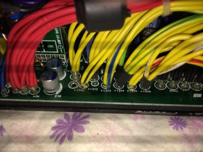

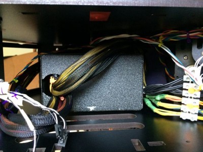

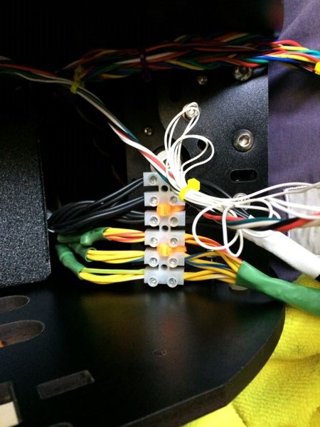

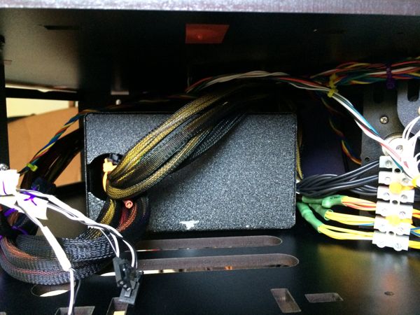

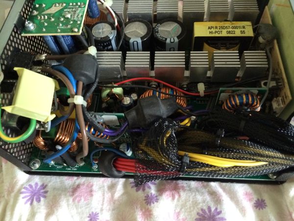

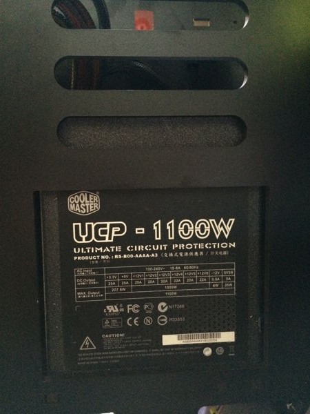

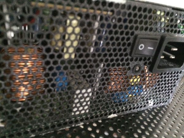

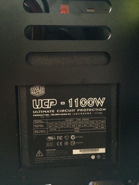

Ok well I just made THE BEST mod yet to the rostock today and I'm verry happy with the results so I thought I would share the happiness around. :) It all started last night when the power just cut out to the machine while I was trying to do a print with a 105C bed and a 255C nozzle temp, I decided then that the machine needs a pressure test so I dont get stuck with it stopping on me mid print or while I'm not watching it. I set a 120 C bed and a 255 nozzle temp and let it get on with the job.... I got it up to temp (well almost) once before it just started cutting out on me time after time... I removed some covers, it still cut out... I removed all the covers and panels, it still cut out... I let it cool, ran it up to temp to get a benchmark and thats where I switched it off and started the dissassembly. :evil:
If you have read the first post you would know I already had a Thermaltake Toughpower 750w CM but Thermal's ran high and tough it certainly wasn't so it had to go. Just for reference here's my warm up times for the Thermaltake, I only started heating the hotend after Heated Bed had hit 110C but it kept switching itself off and subsequently to get to 115C I had to forego Hotend ignition... boo... I will say though that at least the thermaltake shut tself down and didnt try to catch fire on me or something. :)
This was also wired correctly as in I had 3x 18AWG wires running from each of the 4 12V rails with 2 rail (6x18AWG wires) dedicated to the Heated Bed which apparently should have been 36 Amps total available to the Heated bed circuit.
Thermaltake 750w Test:
Ambient Air Temp 24C
Heated Bed starting temp 24.4C
Time to heat to 100C = 12 minutes.
Time to heat to 110C = 17 minutes.
Time to heat to 115C = 20 minutes. (hotend switched off)
Time to heat to 120C = Failed to reach temp due to psu failure. (Ran out of steam pffft)

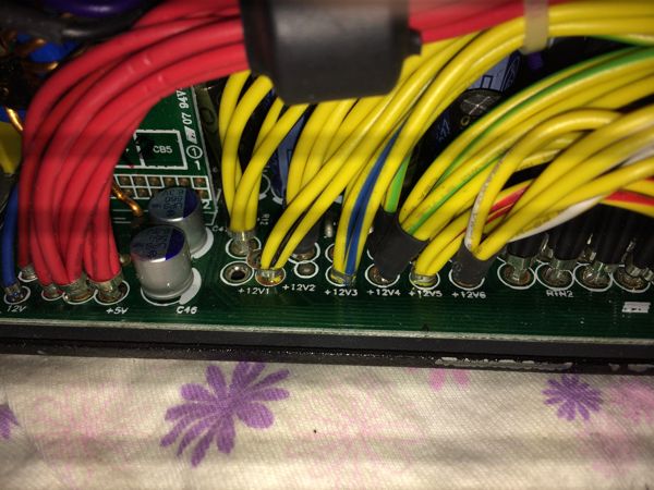

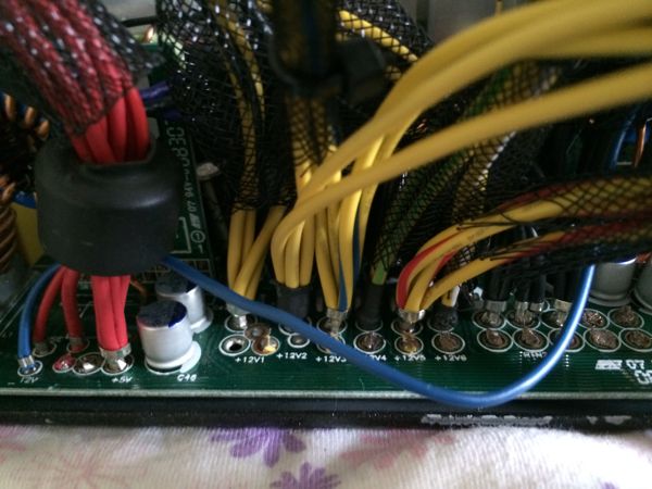

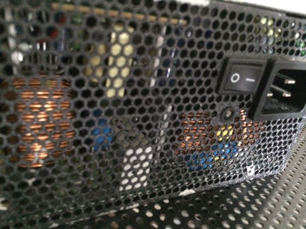

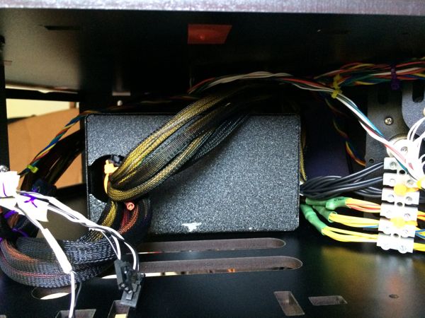

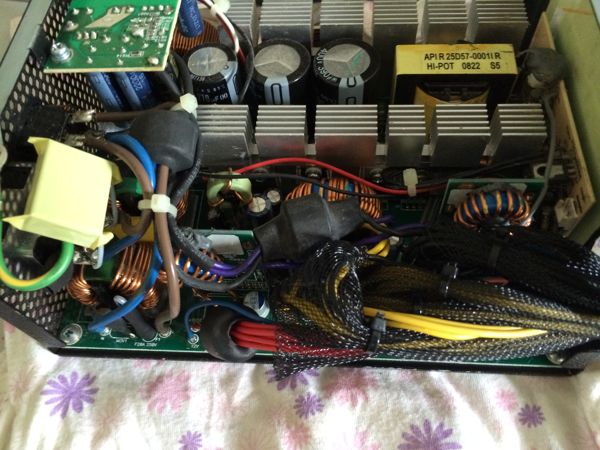

So today I spent a large part of the day re-wiring and installing the new power supply, a stunningly beautiful Coolermaster 1100W UCP (Ultimate Circuit Protection) unit that I had lying around. :) It puts out 1350W peak too by the way so I wasn't going to run out of juice this time...I hoped...

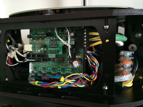

Heres the pics of the change over and re-wire.
6 x 12V Rails at a whopping 22 Amps each. :)

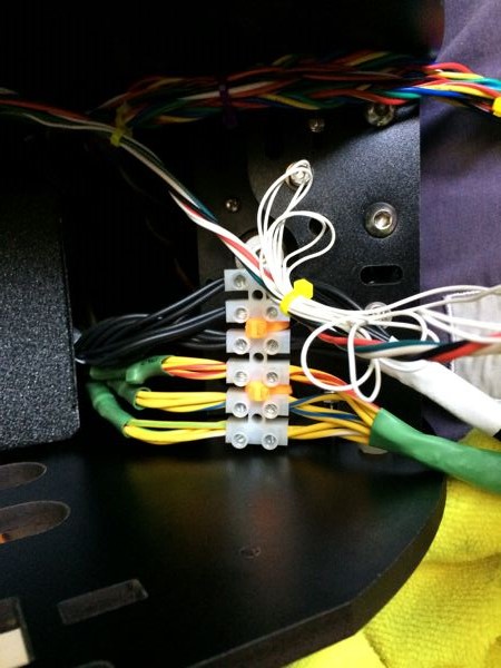

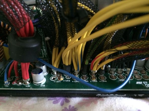

All the wires I didn't need were swiftly cut off at the knees... a bit hesitantly but swiftly none the less.
My finished wiring.

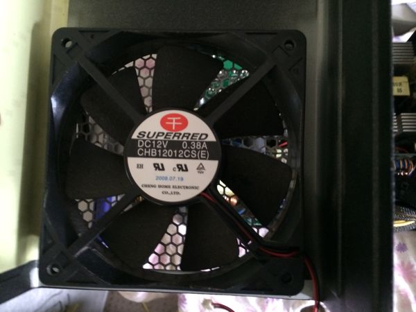

0.38A OK that should do the trick. :)
Copper. ;)
Woop there it is...
Yes that's a lot of wires, I used what I had which meant as many 18AWG wires as I could cram in there. Two rails dedicated to the bed (44A), two to the logic and hotend etc (44A), one goes to the motors (22A) and theres one rail (22A) spare for future requirements plus still the 5V and 3.3V available for future use as well.
Neat and tidy.
Boom. :twisted:
