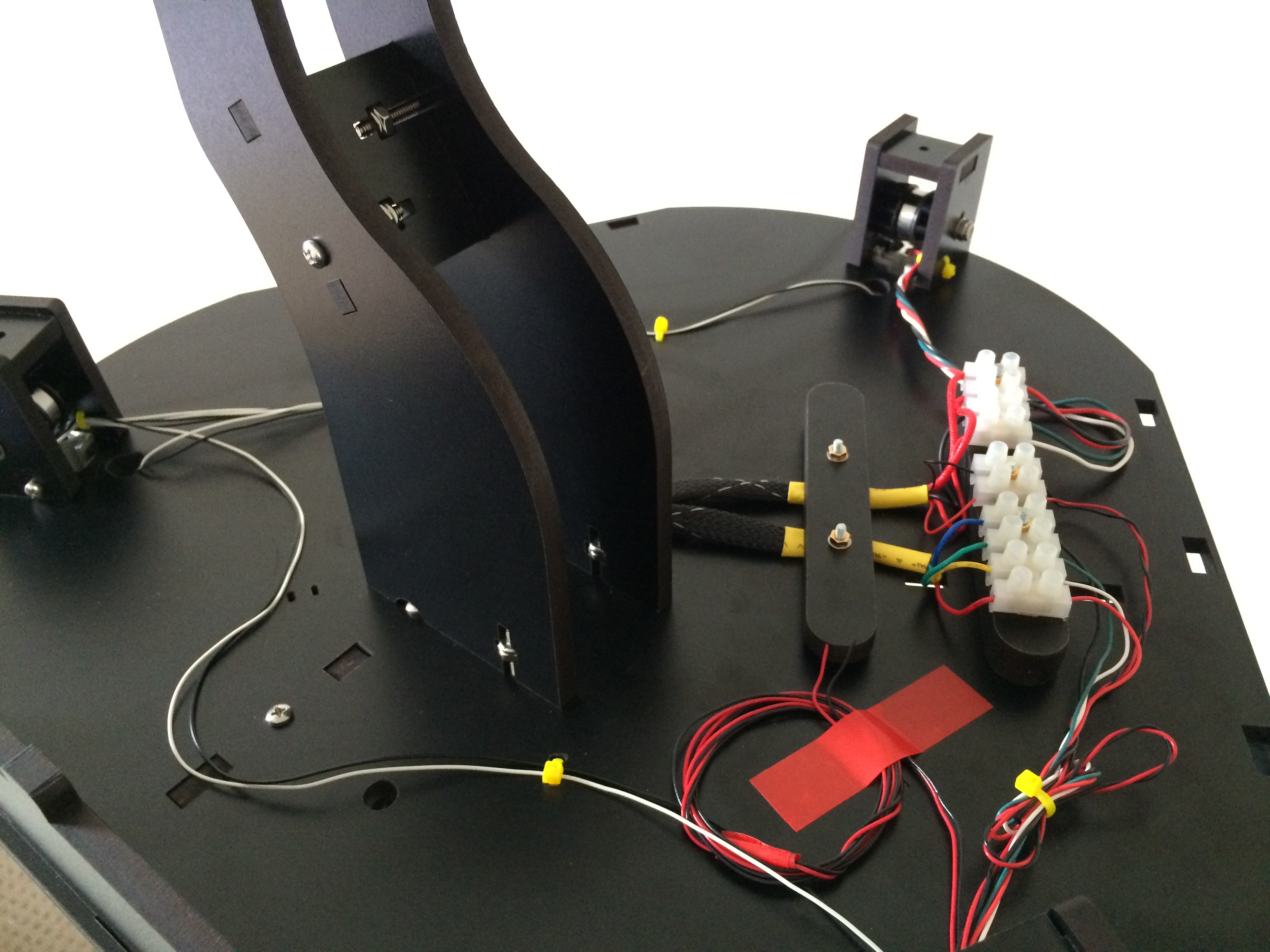

1st day, Thermaltake Toughpower 750w modular power supply wired and fitted into base. 2nd day, wires run to top of machine and wired, also fitted tie down point from offcuts to relieve strain on the cables. 3rd day, 2 pin header soldered onto rambo, also soldered up heated bed etc Switching it on for the first time. Hotend (E3D) mount printed for me by DooDadDoes, thanks Isaac! Firmware uploaded, nearly time for calibration. The first plastic to pass through the nozzle.
