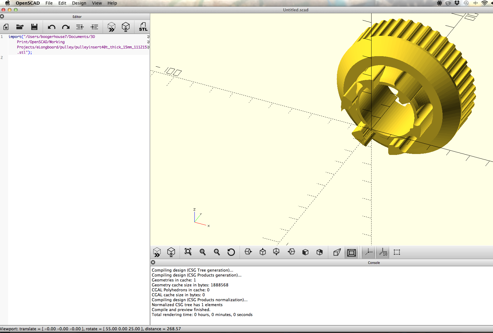

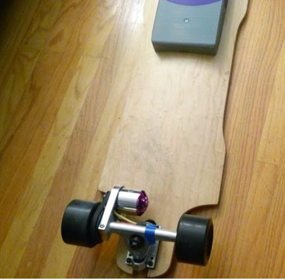

I am doing a second print of a toothed pulley for an e-Longboard skateboard conversion.
Both printings have this one anomaly on layers; 70,71,73,74, and 75.
Basically, the print commands have it stop printing my hex infill for approx. 1/3 of the surface of those layers... same place each layer... then finally doing a complete infill before returning to normal printing per the pattern.
Once complete, there is a bit of missing material at those layers, in the teeth of the pulley.
I downloaded this .stl from Thingiverse, so I don't have the whole code.
Is there a way to open the file, either from the file I have or if the person who created it will send me the build code, and figure out what's causing this anomaly?
Is there a way to view this in a slicer and see what's up?

Have you looked at the sliced file rendering layer by layer at this location?
Re: anomaly at layers 70-75 of 188
Usually issues like this are errors in the original model, it's probably not well formed. Unfortunately this is a common problem with thingiverse files.
Some slicers will deal better with certain types of modelling error than others, so you can try different slicers and see if they have the same issue.
The first thing you should try though is running the STL through netfabbs repair, to see if it will fix it.

Post your gcode here.

nitewatchman, I contacted the person on thingiverse who posted this originally... hopefully he or she will send me the whole file.
What I get from TVerse appears to be a locked file that can be read but not opened by me.
Here's what OpenSCAD sees when I open the downloaded file...
[img]https://flic.kr/p/Cuoyv6[/img]

http://www.catb.org/jargon/html/F/field-circus.html is the origin of the joke. I mainly use it to mean repairs which actually degrade function.

I took the .stl, popped of sections of the skin and climbed inside to look around. The shell looks very good with no partial planes or construction surfaces left inside. There were no inverted triangles, open vertices or other usual suspects that cause trouble. In short, everything looks okay.wsmac7 wrote:Xenocrates, hahaha.... 'circus engineer version'?... cool!![]()

I let netfabb repair the openings I made and there were no changes to the appearance of the file. I then discarded the changes and kept the original file. I ran the original file through S3D and Slic3r using a layer height of .2mm to yield 188 layers. Focusing on the layers in the 60 to 80 range there did not appear to be anything amiss in the output code, (I did not print it).
I forgot to ask which slicer you are using to prep the code but to me it would appear to be something screwy going on inside the slicing routine. I could not find anything wrong with the file or any evidence of repair or tampering with the original .stl output.

nitewatchman,
Thanks for all that! Can't tell if you're some kinda surgeon or you work on a secret program dissecting aliens! "...popped out sections of the skin and climbed inside...
Long as I stay on your good side... I'll be able to walk around town without looking over my shoulder all the time.... bwahahahahaha
Seriously though, thanks for doing that. I do wish I understood the terms you are using and what you are doing exactly... but don't feel obliged to spell it all out for me...
I understand what you say about inverted triangles, open vertices, just not understanding how you get 'inside' to see all that.
I was imagining you exploding a 3D image... zooming inside and crawling over all the layers (if that makes any sense! lol). A virtual dissection in a sense.

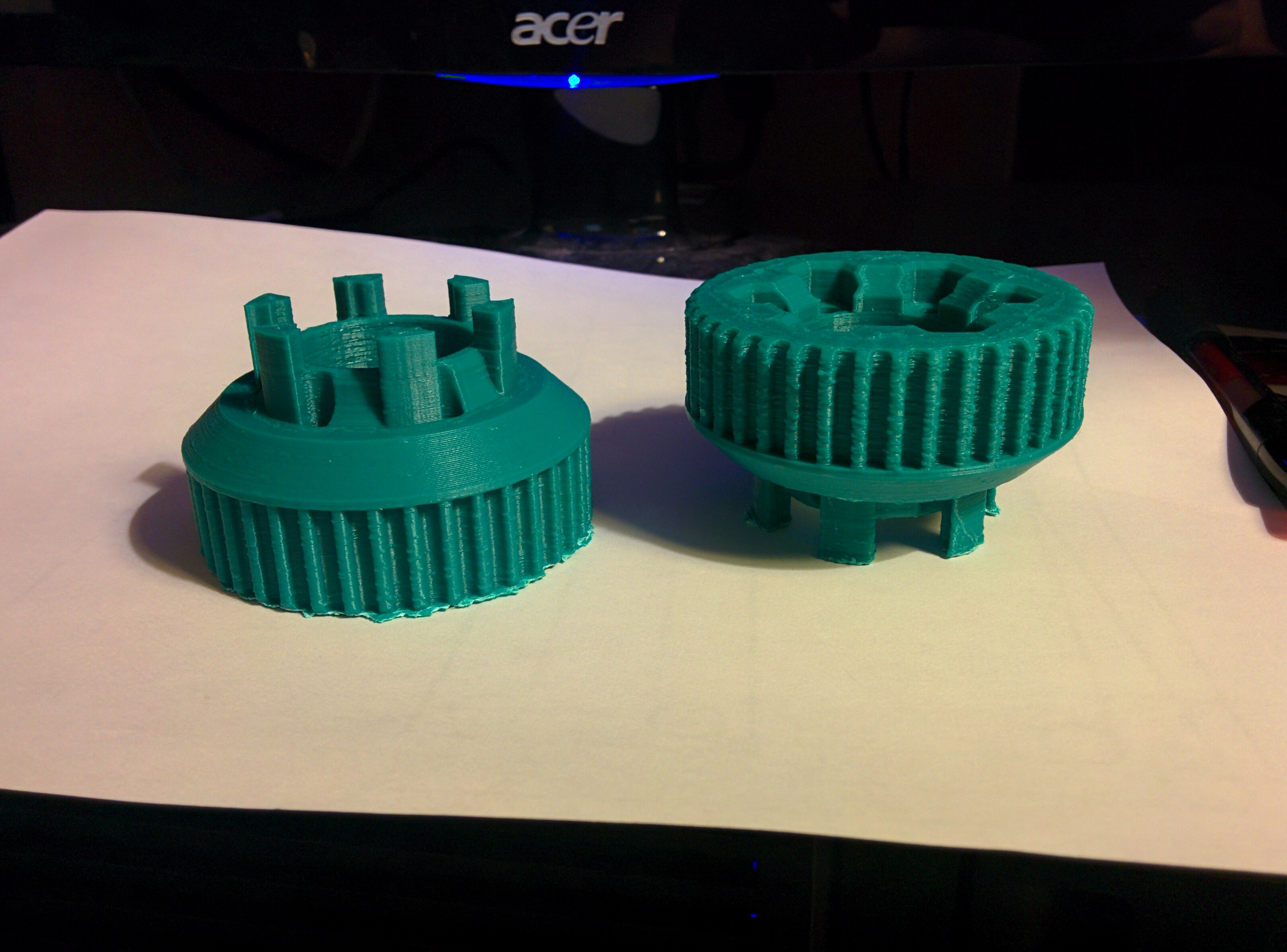

Both printed with ABS, in the position shown. One on the right printed at 80 mmps, the one on the right, 60 mmps. The ABS has been left out, so its sucked up some humididty.

Mac The Knife wrote:Both printed with ABS, in the position shown. One on the right printed at 80 mmps, the one on the right, 60 mmps. The ABS has been left out, so its sucked up some humididty.
Interesting part, clean design. What does it do?

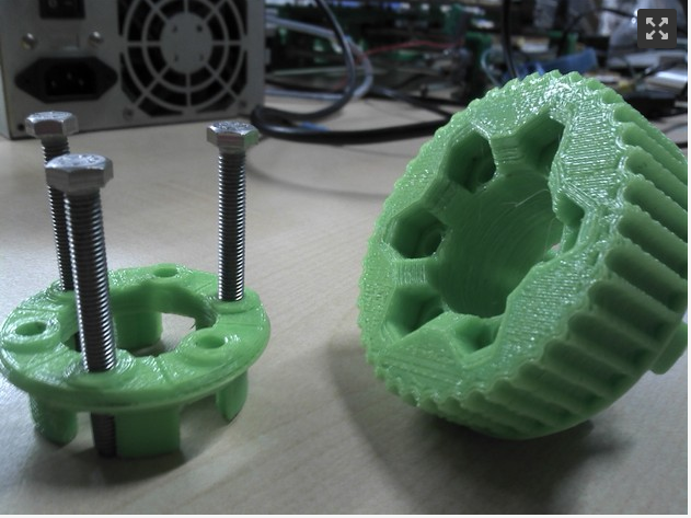

To drive the skateboard wheels... you have a bracket that the motor mount to on one end... with the other end attaching to the axle body of your truck.
This pulley is inboard.
A fiber belt runs from the small pulley at the motor, to this pulley at the wheel.
The six 'prongs' mate with six openings for a specific brand/model of skateboard wheel. The prongs... or maybe fingers are better?... tabs?... are what secure the pulley to the wheel hub to prevent slipping.
There is another part that fits on the outside of the wheel and provides the other surface for the six bolts to hold it all together.

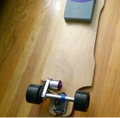

These images are from another person's build... I have the board... and I can make some of the parts... not sure I'm going there though... but it looks pretty cool!
People are making these with battery packs (you can see the person's grey/purple clamshell over their controller and batterypack, attached to the underside of the board), and electrics that allow them to use R/C wireless controllers or phones even, to run these.
They have regenerative braking as well!
Speeds around 20-30mph (some are claiming even 40+!) are being seen with these.
