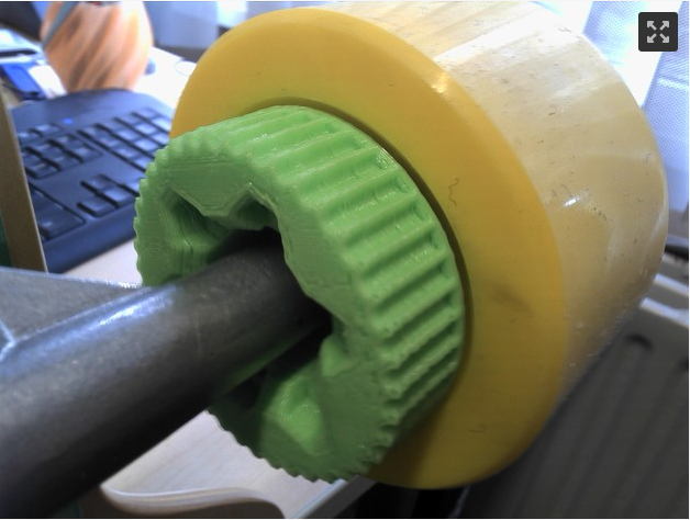

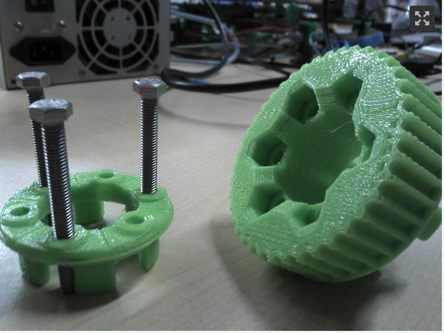

I am doing a second print of a toothed pulley for an e-Longboard skateboard conversion.
Both printings have this one anomaly on layers; 70,71,73,74, and 75.
Basically, the print commands have it stop printing my hex infill for approx. 1/3 of the surface of those layers... same place each layer... then finally doing a complete infill before returning to normal printing per the pattern.
Once complete, there is a bit of missing material at those layers, in the teeth of the pulley.
I downloaded this .stl from Thingiverse, so I don't have the whole code.
Is there a way to open the file, either from the file I have or if the person who created it will send me the build code, and figure out what's causing this anomaly?
Is there a way to view this in a slicer and see what's up?
I use MatterControl with my Orion.
The first one I printed in PLA, black, at stock settings.
The second is printing in PLA, blue, at custom settings.
Same anomaly... same place.
The gap is inboard, a few layers before the bevel... eta: okay... it's barely visible... I'll get a better shot of the blue one in a bit.
[img]https://www.flickr.com/photos/46843507@ ... res/7h5FF7[/img]
how the layers look while printing... the area in question is the solid fill, you can just see the hex fill in back... which is the proper fill
[img]https://www.flickr.com/photos/46843507@ ... res/t4j0a8[/img]
these should be self-explanatory
[img]https://www.flickr.com/photos/46843507@ ... res/7637rA[/img]

Thanks for the lesson nitewatchman!
Mac The Knife, I was thinking of printing with the orientation reversed for me (starting with the prongs down... like in the righthand imnage of yours).
Nice prints there too! Hope you have a longboard, motor and all the other stuff so you can build that sweet electric skateboard with wireless control! :D
To drive the skateboard wheels... you have a bracket that the motor mount to on one end... with the other end attaching to the axle body of your truck.
This pulley is inboard.
A fiber belt runs from the small pulley at the motor, to this pulley at the wheel.
The six 'prongs' mate with six openings for a specific brand/model of skateboard wheel. The prongs... or maybe fingers are better?... tabs?... are what secure the pulley to the wheel hub to prevent slipping.
There is another part that fits on the outside of the wheel and provides the other surface for the six bolts to hold it all together.
These images are from another person's build... I have the board... and I can make some of the parts... not sure I'm going there though... but it looks pretty cool!
People are making these with battery packs (you can see the person's grey/purple clamshell over their controller and batterypack, attached to the underside of the board), and electrics that allow them to use R/C wireless controllers or phones even, to run these.
They have regenerative braking as well!
Speeds around 20-30mph (some are claiming even 40+!) are being seen with these.
