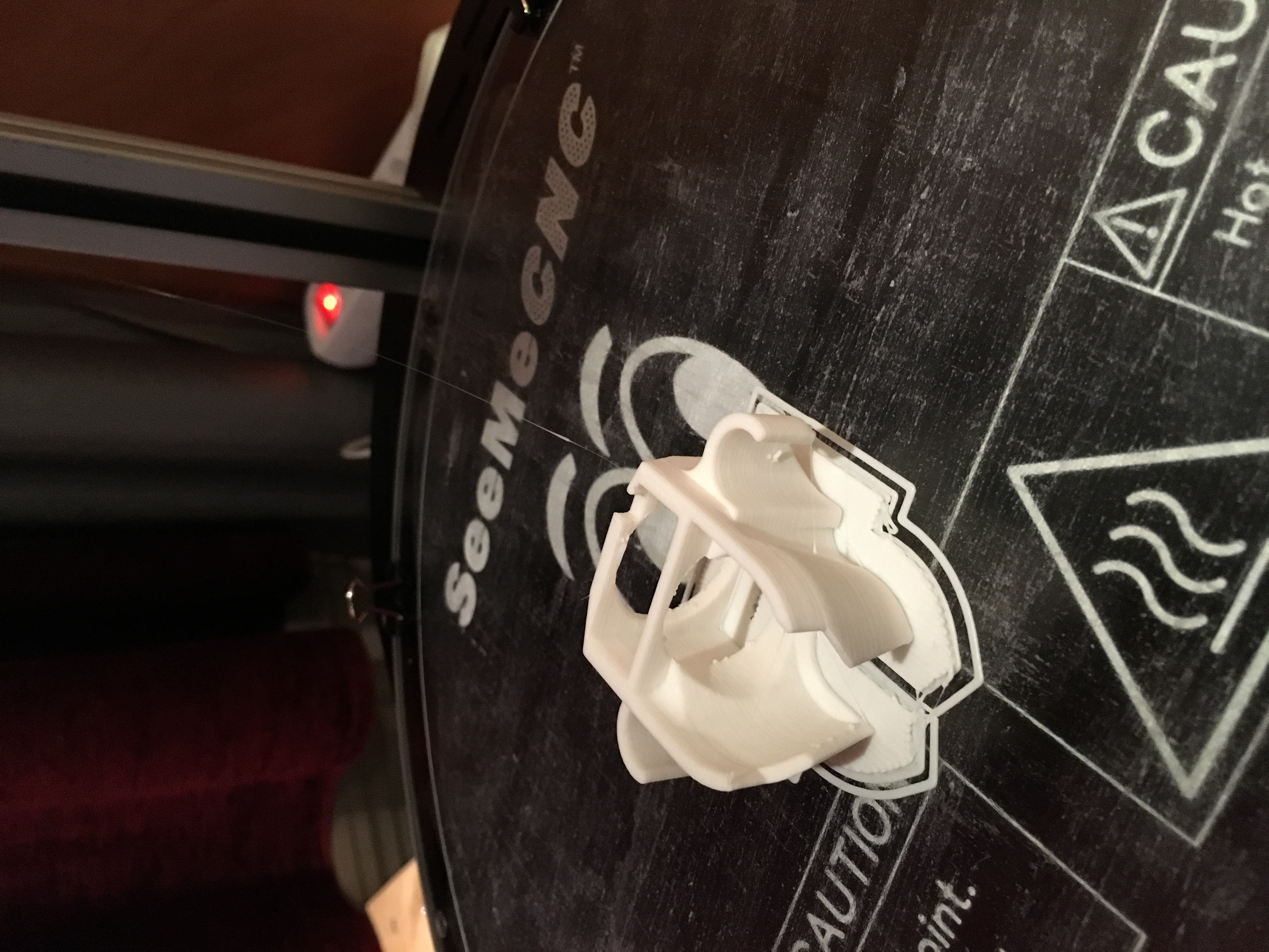

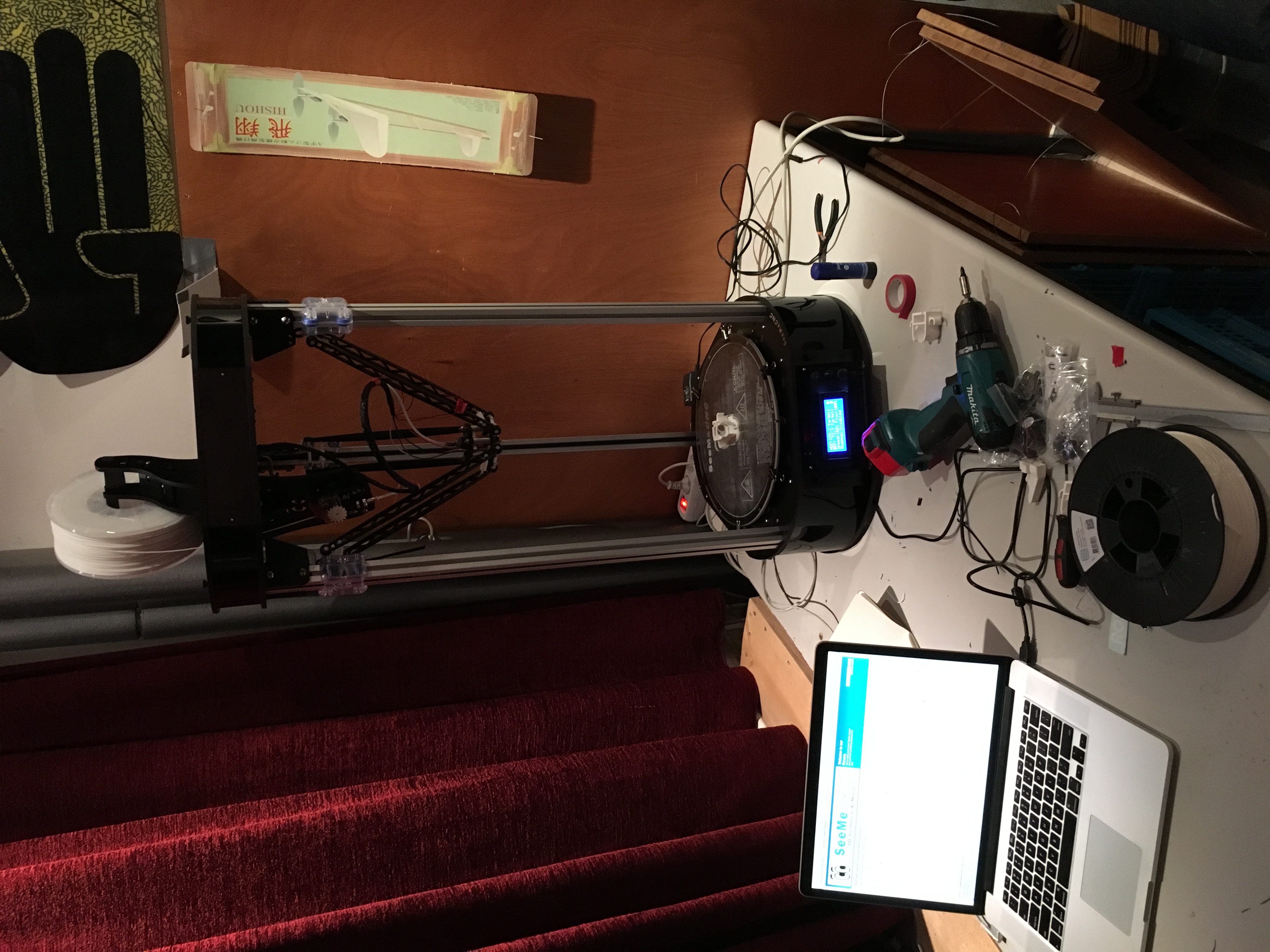

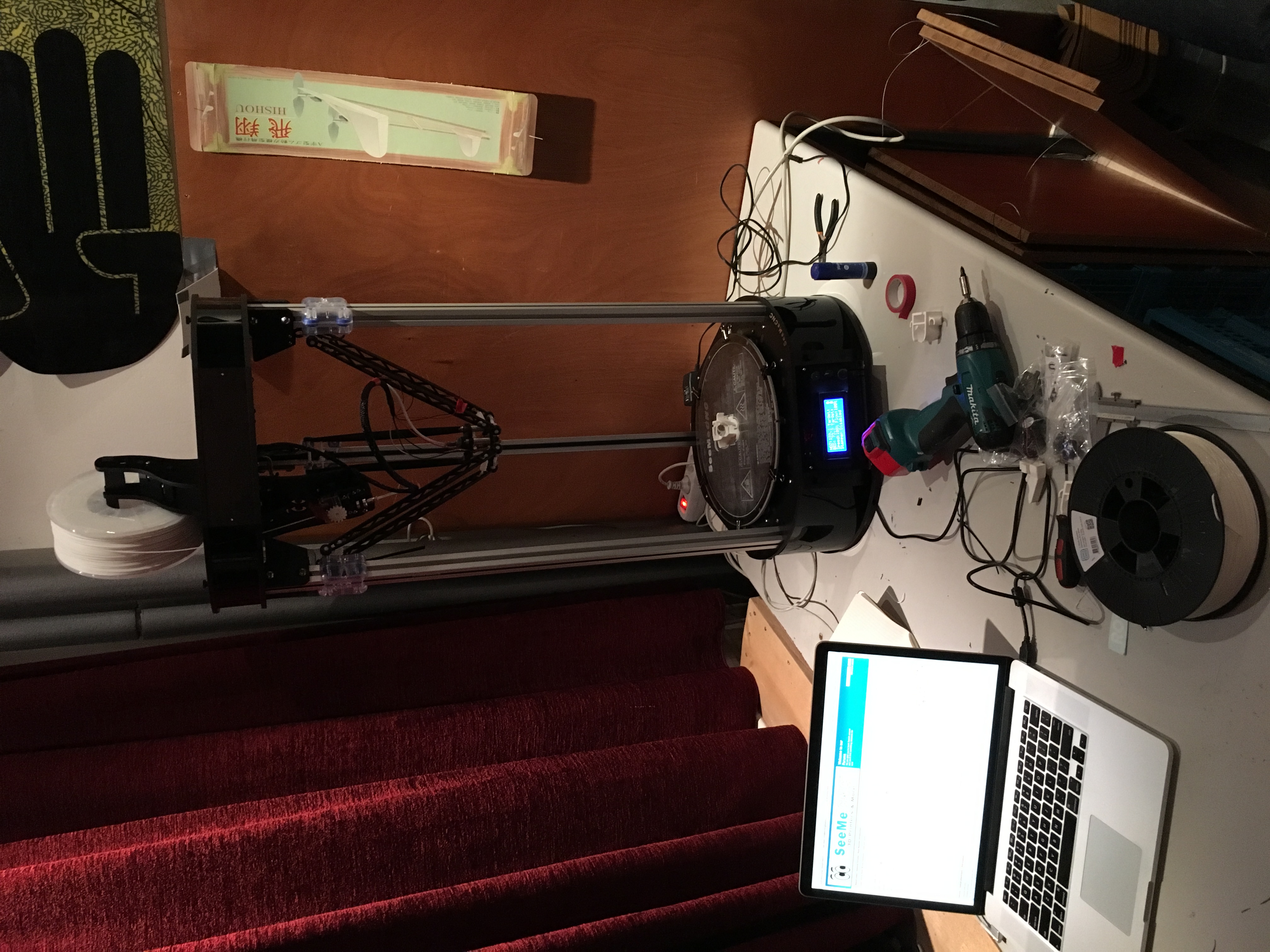

I just got my Rostock max v2, it even got here, Delft in the Netherlands, a day before estimated shipping delivery!! Assembled it in two days and right now i'm printing the PEEK fan shroud, it is looking great so far. No big trouble so far, only got confused when auto tuning the PID, it got too hot and I read on the forum that i should adjust the PID max from 255 to 128, but didn't know where. luckily I figured it out after an hour or so.

Finished the Fan Shroud while typing, looks pretty good!

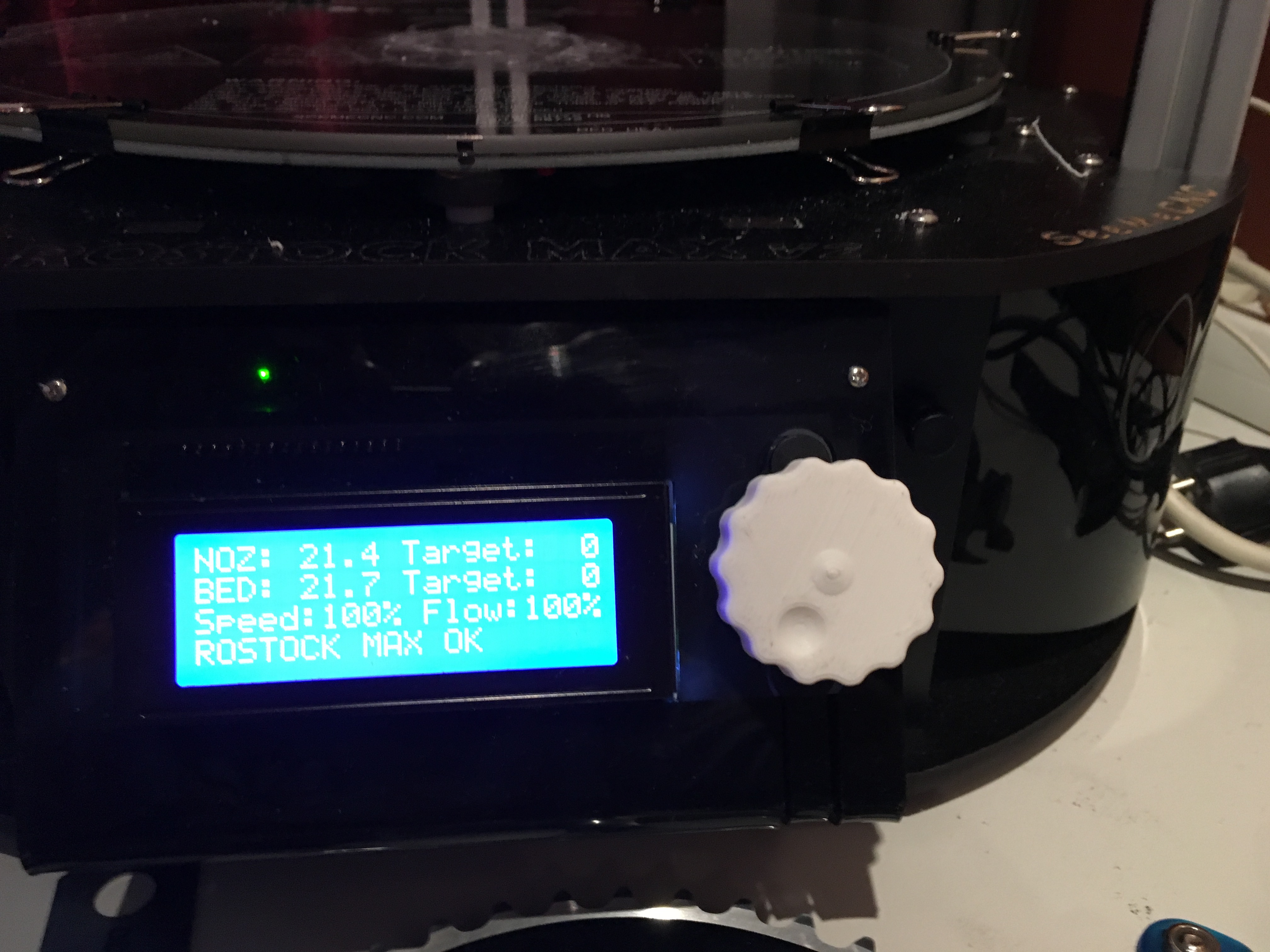

my first simple but to me very usefull upgrade, a new scroll button. It is great for scrolling fast to the right temperature or quickly through the menu.
While looking around i couldn't really find a place to post fun upgrades to share, probably again due to my forum newbyness, so i'll post it here. If you know where i should actually post it tell me and i'll repost it in the right spot.

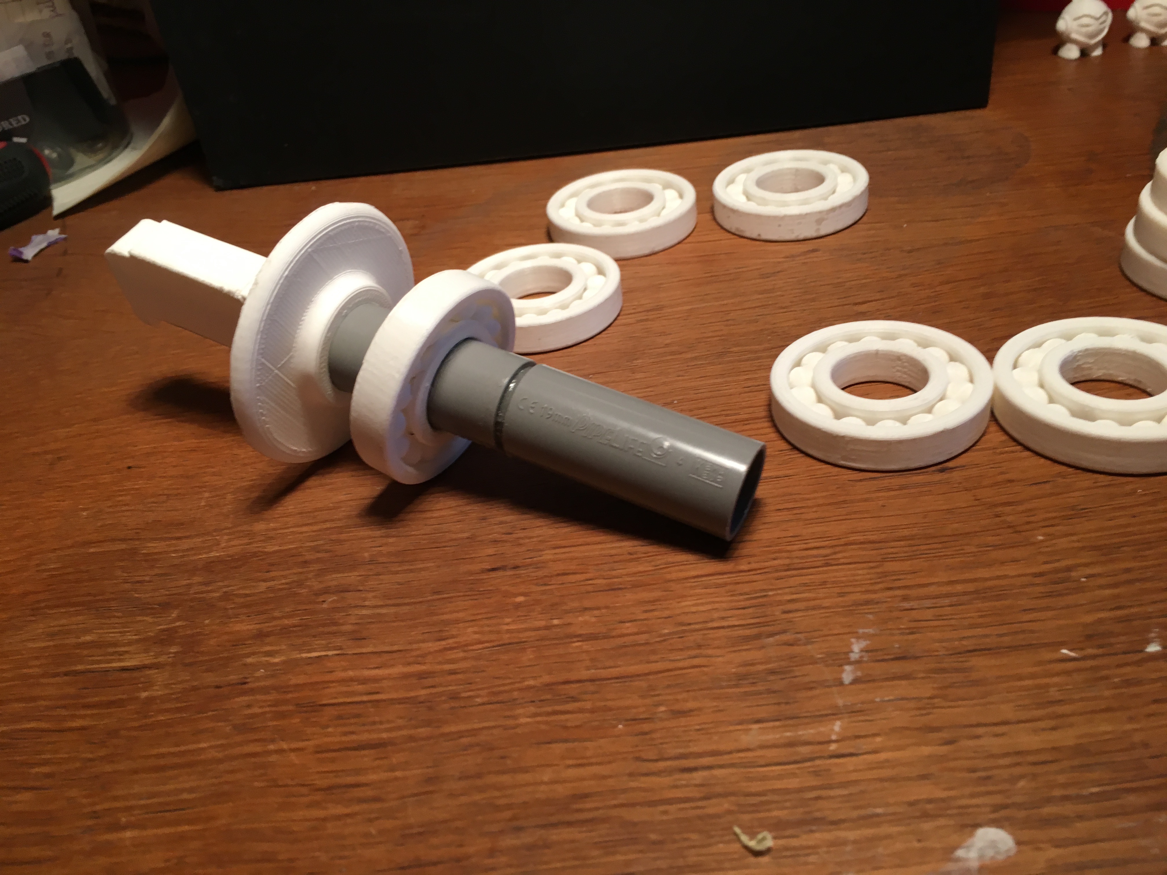

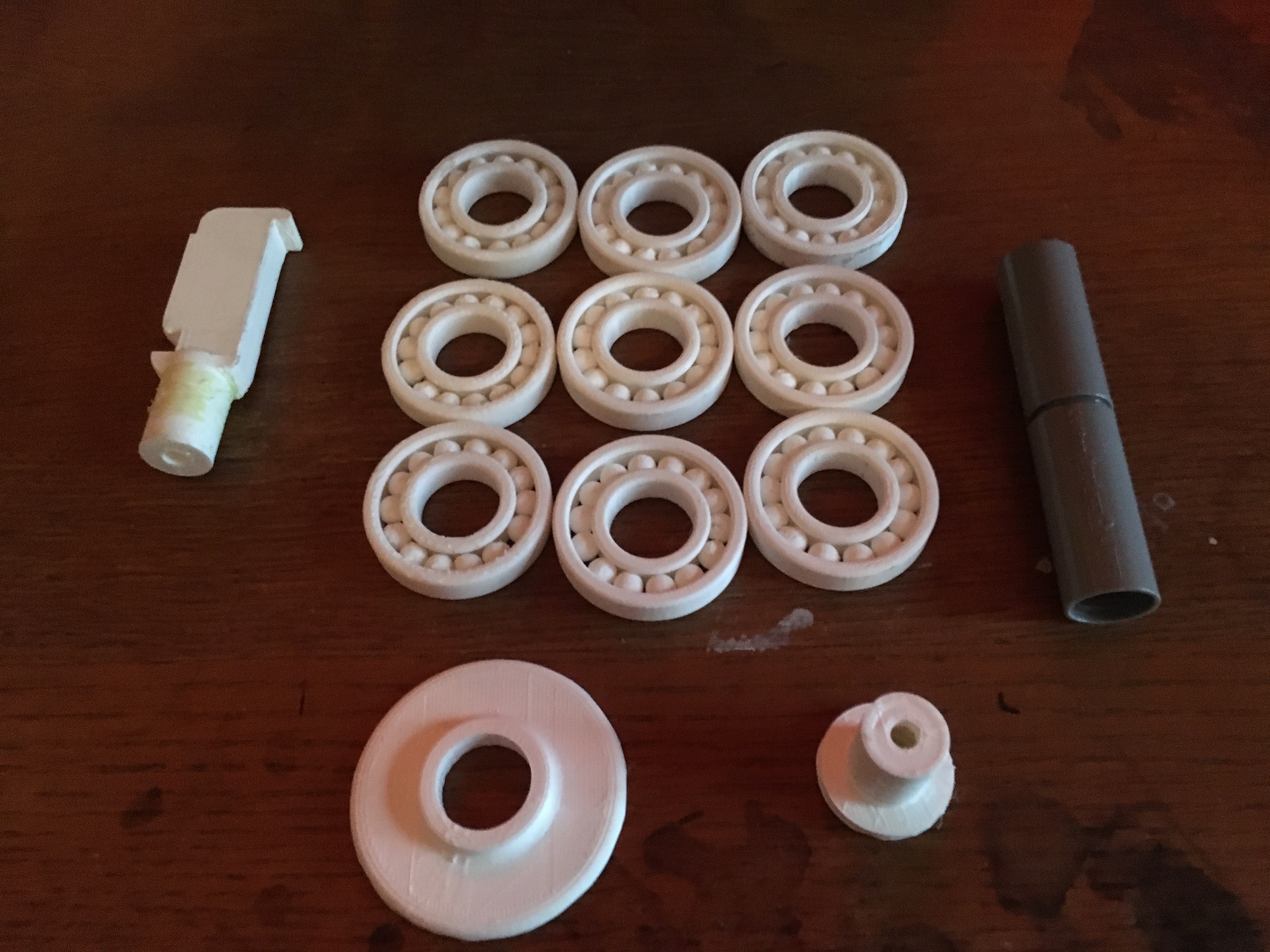

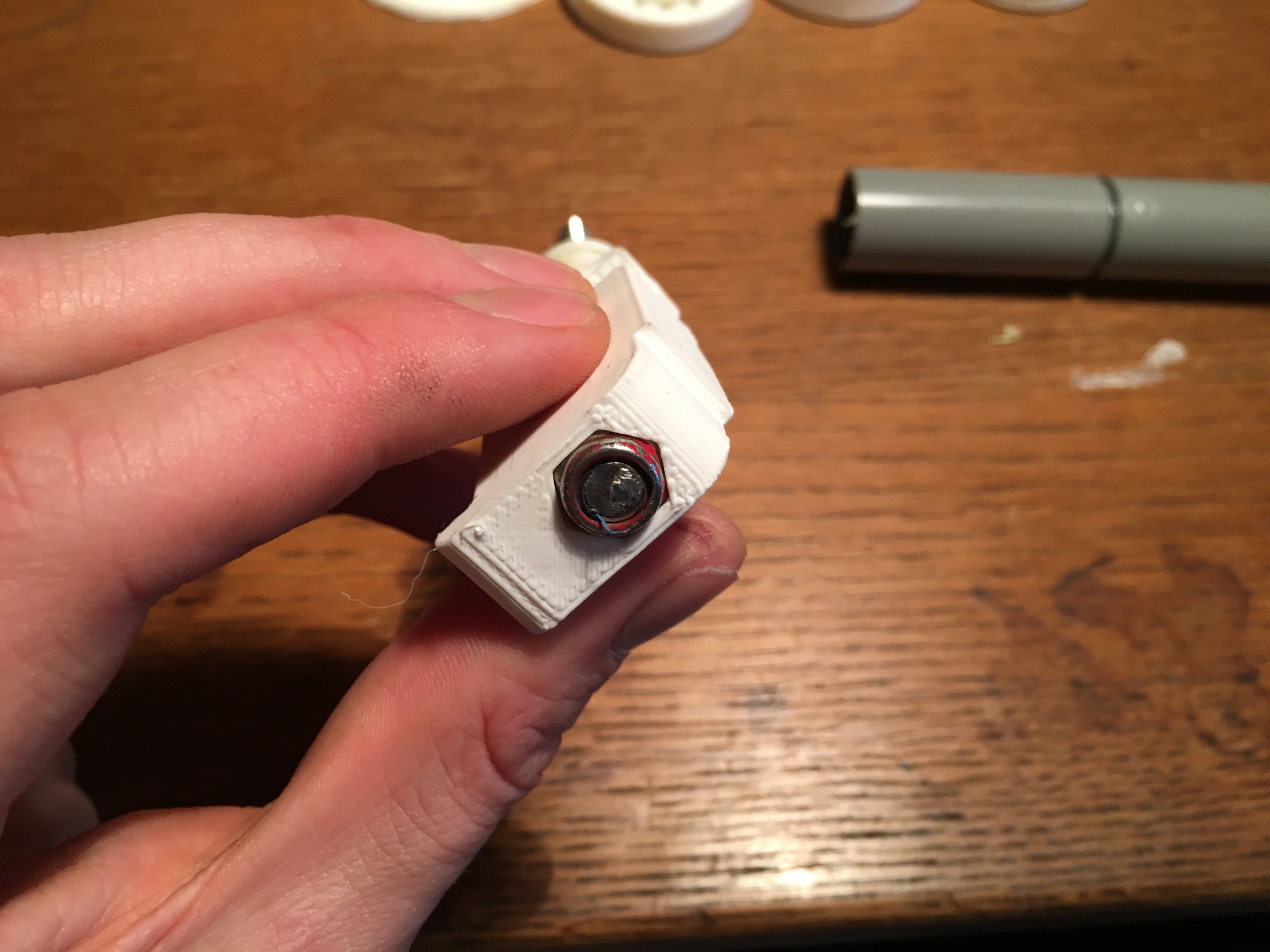

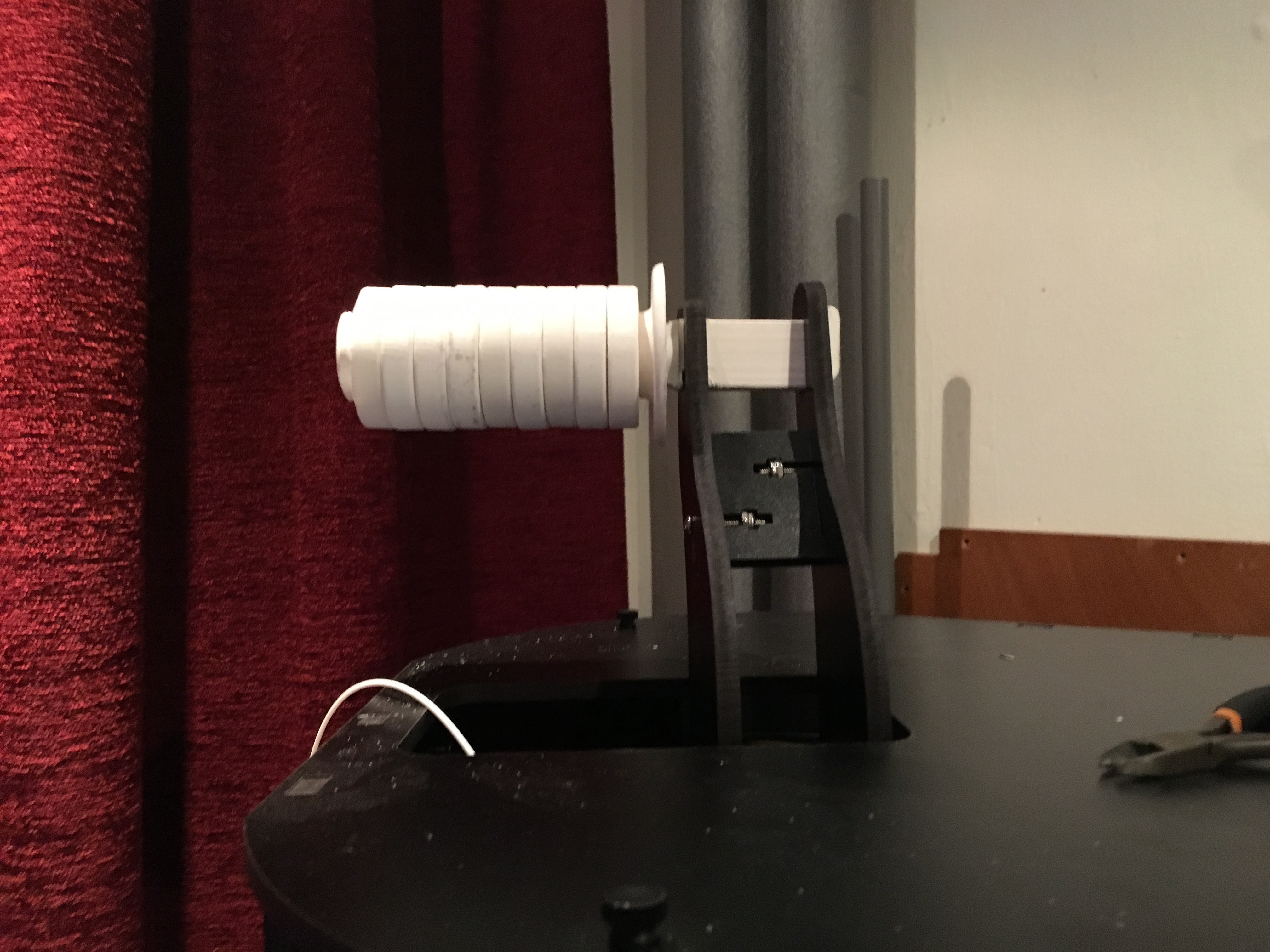

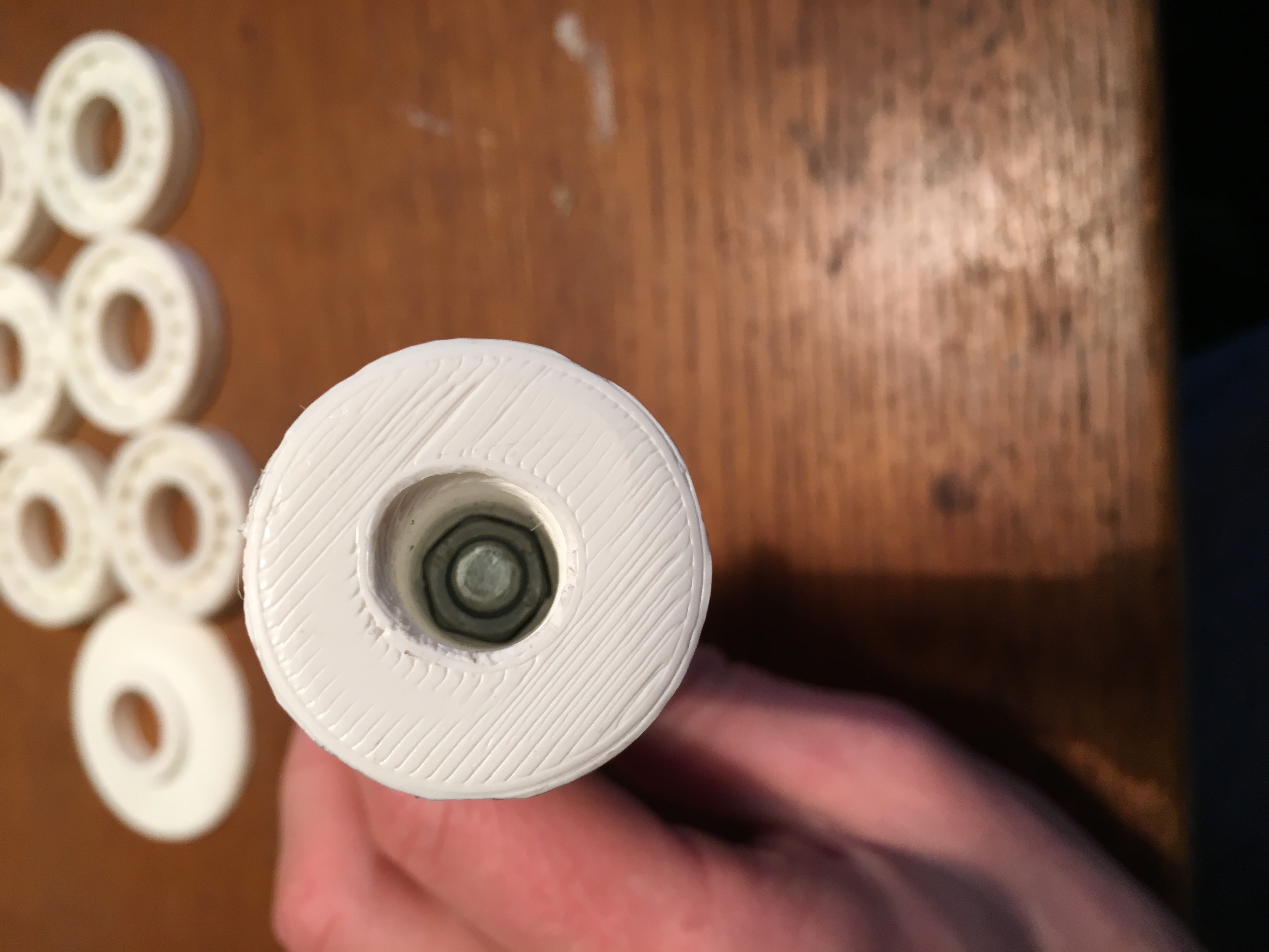

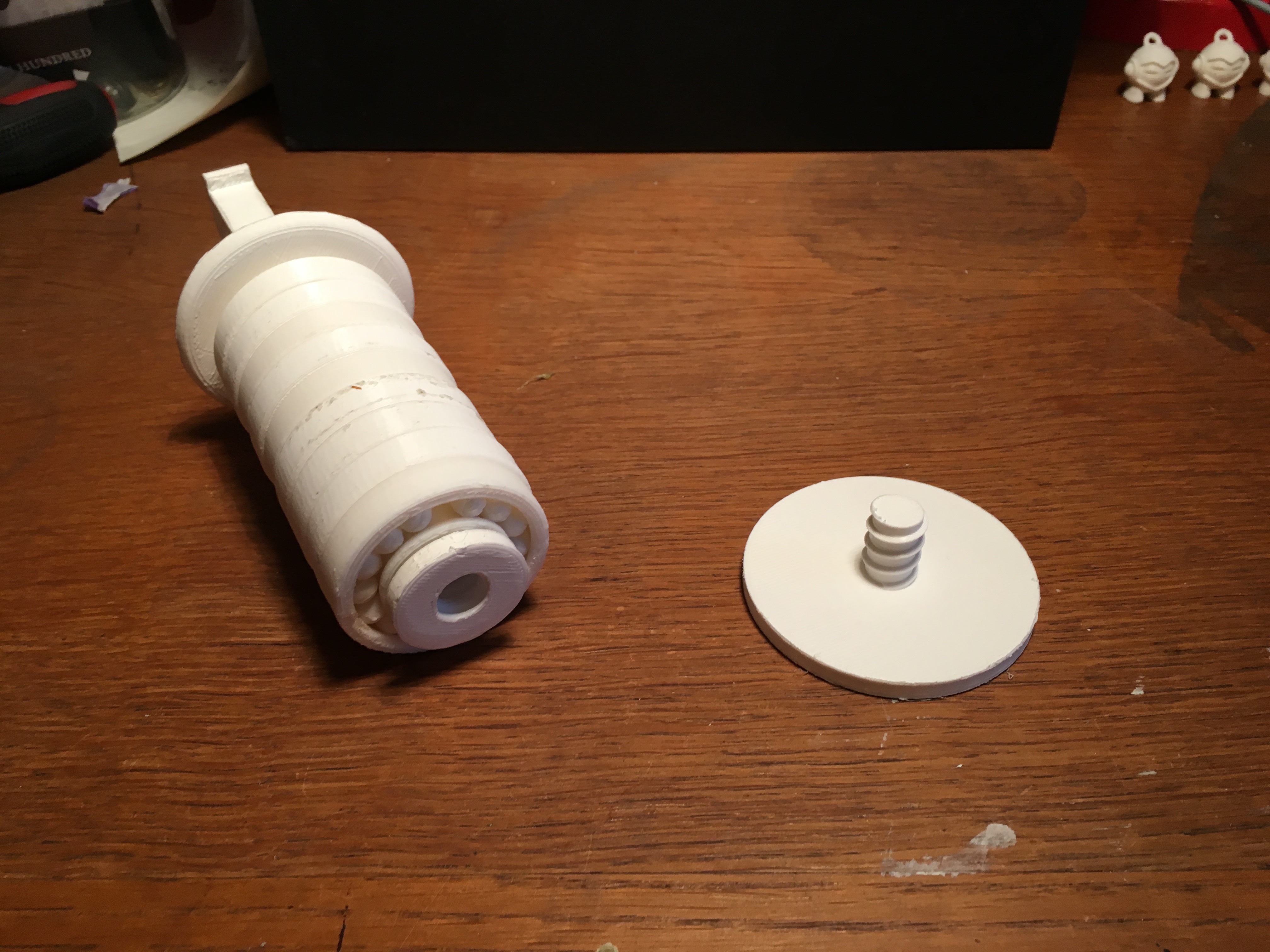

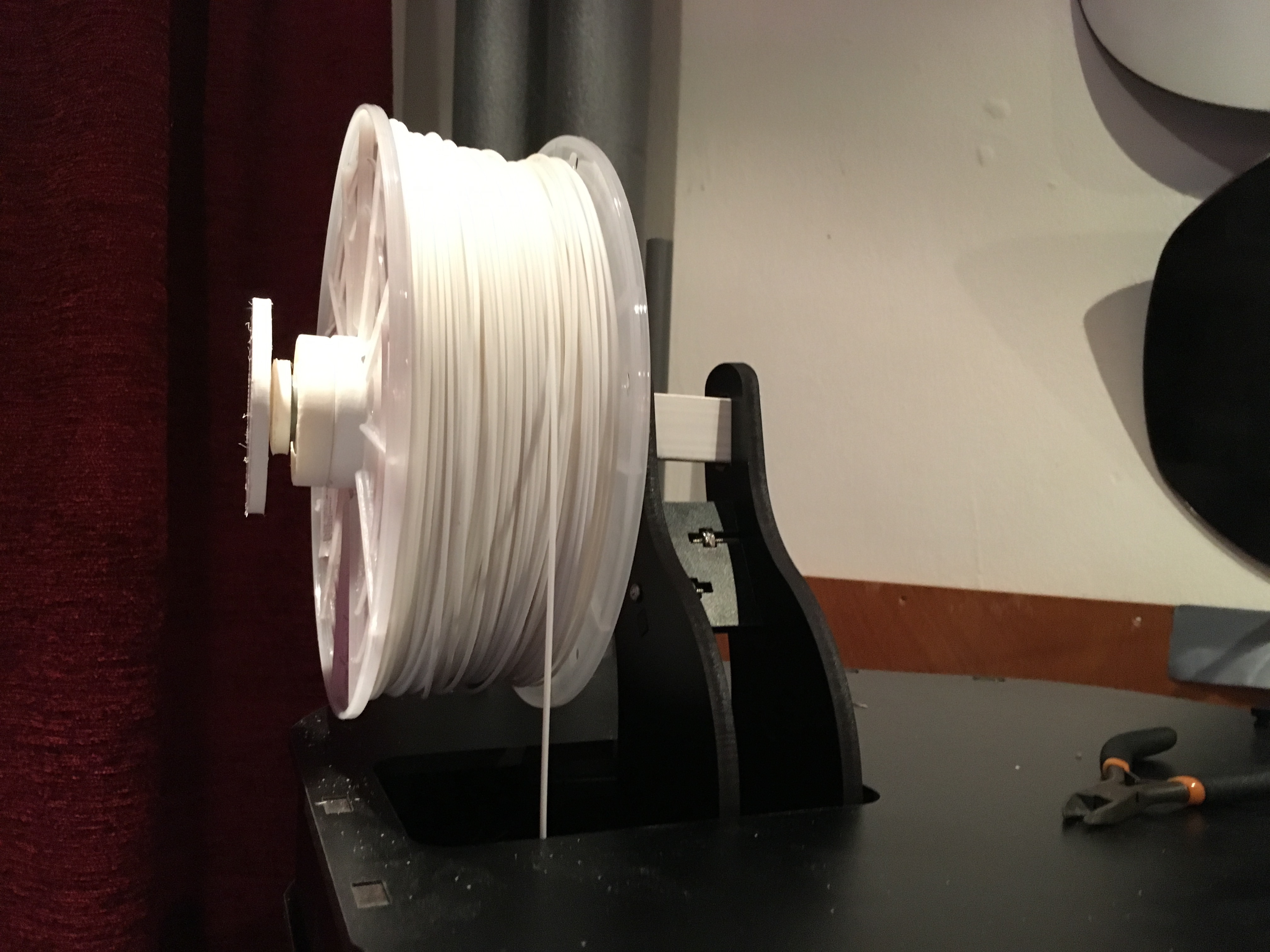

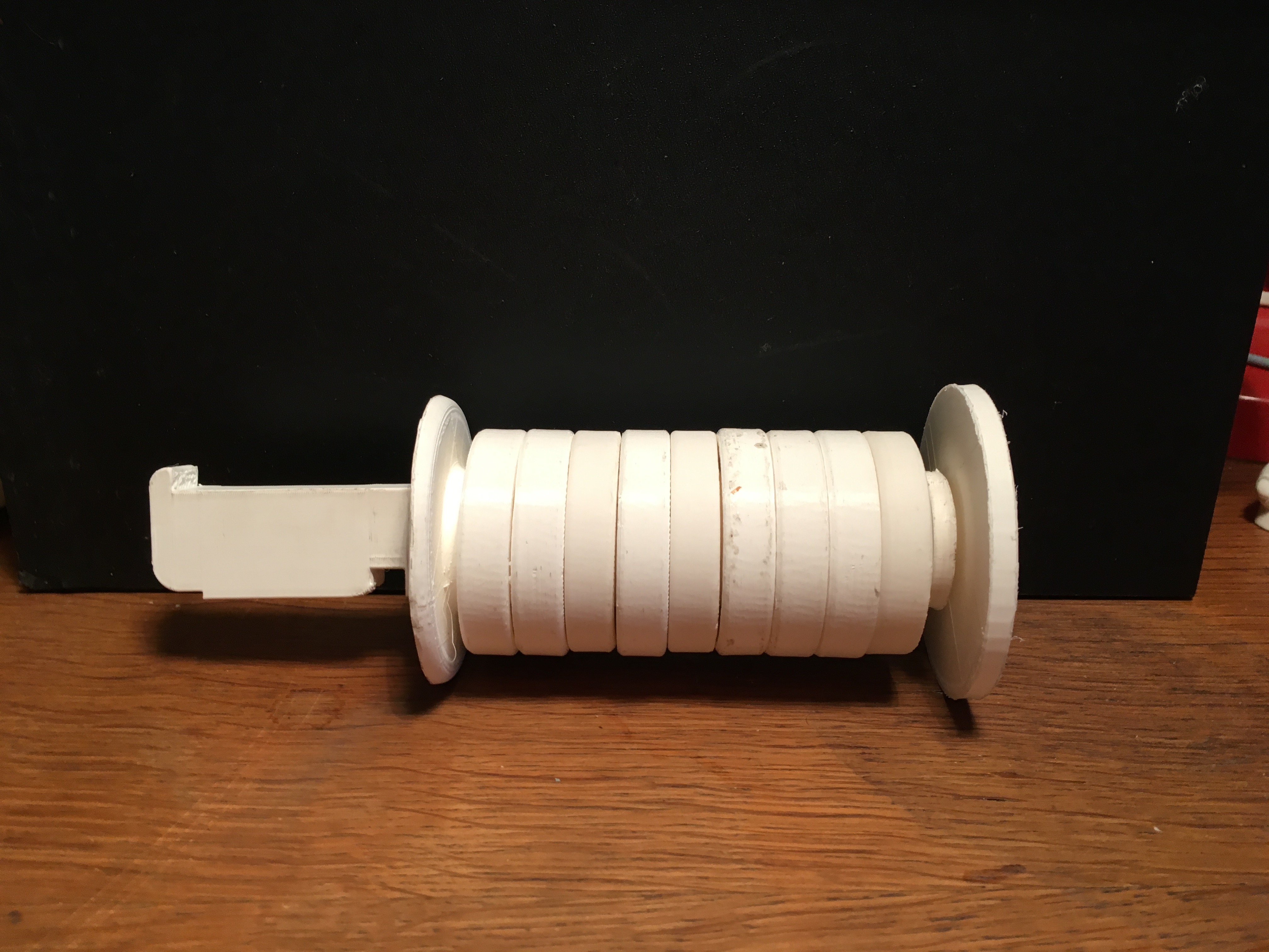

And another printable upgrade, a filament spool holder with printed bearings:
(The bearing is downloaded from 3D hubs and scaled down to fit in a filament spool)
(The tubing is PVC from the hardware store, ø20mm connectors and ø18mm pipe)

Those bearing decent. How do they roll -ish?

Bearings roll great, ABS better than PLA. They keep spinning for a little while after you give them a spin. If they had some more mass i'll bet they wood keep spinning for quite some time. at least they are more than smooth enough for supporting the filament.
