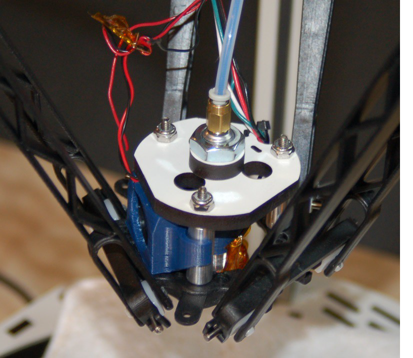

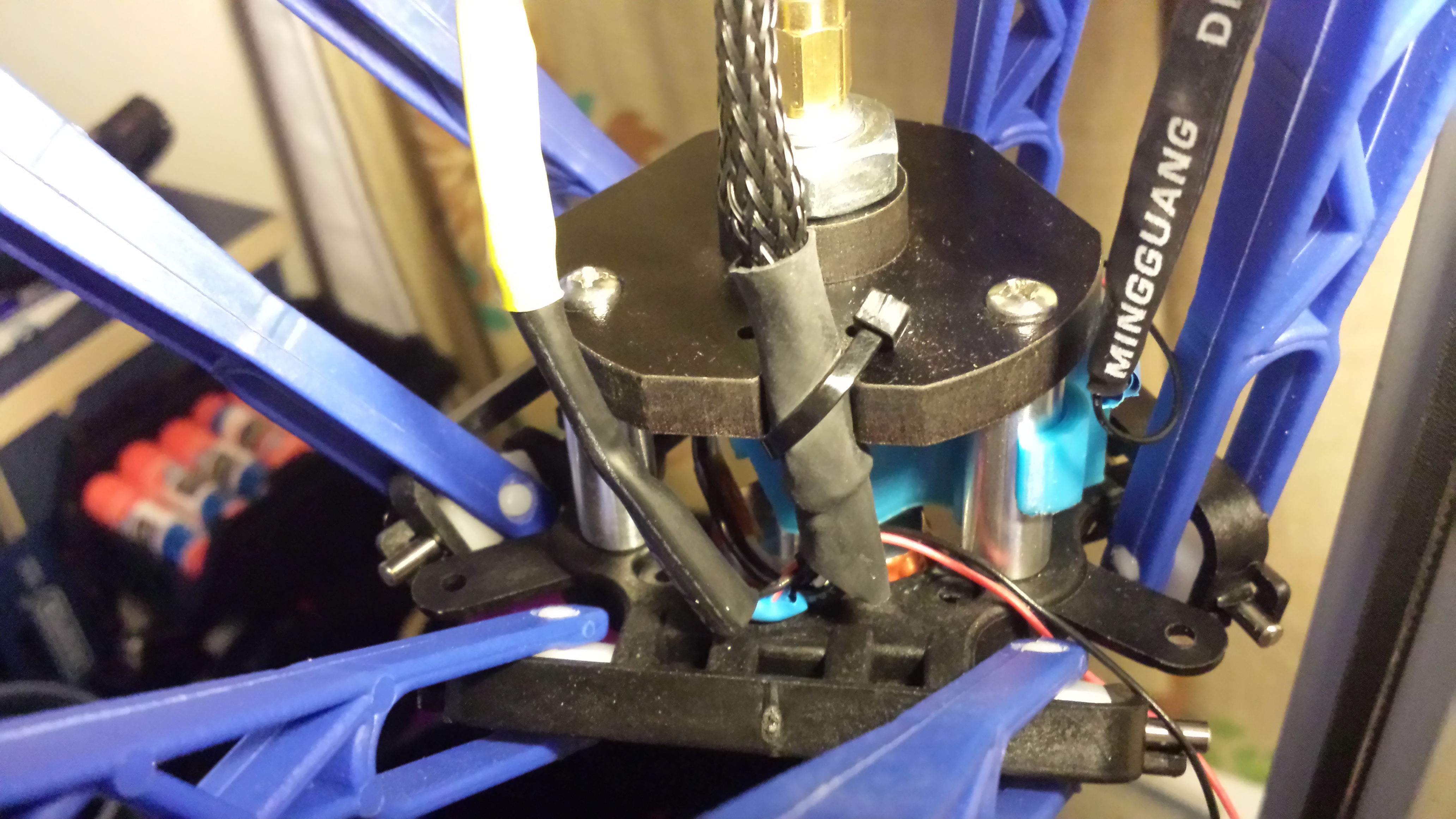

After looking over the CAD file it's different to the one on my Orion as the bit where you clip on the hot end wires etc with zip ties is in a different position.. right next to one of the offset screw/bolts. Whereas on mine it's equidistant between two of the bolts and screws.. also mine only has one hole in the centre for the 1 hot end.
Unlike Fig 20.31 on Page 257 of the manual which has multiple holes same as the cad file on Github.
My Hot End Adaptor
My Hot End Adaptor plate with zip tie connection equidistant
Hot End Adaptor on Github and in Max Manual
One in the max manual
So has anyone got the CAD file for the Orion "Hot end adaptor" with the single hot end hole as in My hot end adaptor above?
As the wires are cut to exact lengths the position of the zip tie slot is pretty important...
I've spoken with SeeMeCNC online but they only have records of the one on Github.. they are looking into it however. My only thoughts are it's a new design that's not been uploaded to Github as the one on there now is >1 year old. There is a file in the IGES directory but it's not an IGES file labelled Hot End Adaptor.rpt for repetier 0.91?
So once again any help much appreciated.

The 3 holes really don't matter. But I did position them for three hot ends. We like to say two hot ends quadruple the complexities of printing.
The pic in the manual is a Rostock MAX. It's rotated 120 from my design, but doesn't matter. It'll work fine like the picture, but I originally put the wire toward the right rear (as your facing the mahcine).
