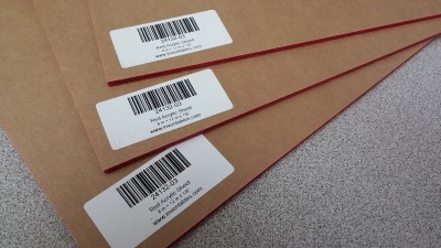

I ordered a few sheets of acrylic from Inventables a few days ago (https://www.inventables.com/categories/ ... ls/acrylic). These guys are in Chicago, I think, so perhaps shipping will be much quicker (since they're only a couple hours away). I have no idea if their acrylic will cut as easily as Tap Plastic's. I'll let you know once I get it how well it works.
As for balsa, head to your local Michael's or Hobby Lobby and pick up a various thickness pack. It's like $8. Balsa and Bass wood is pretty much useless stuff for me but it's fun to practice with.

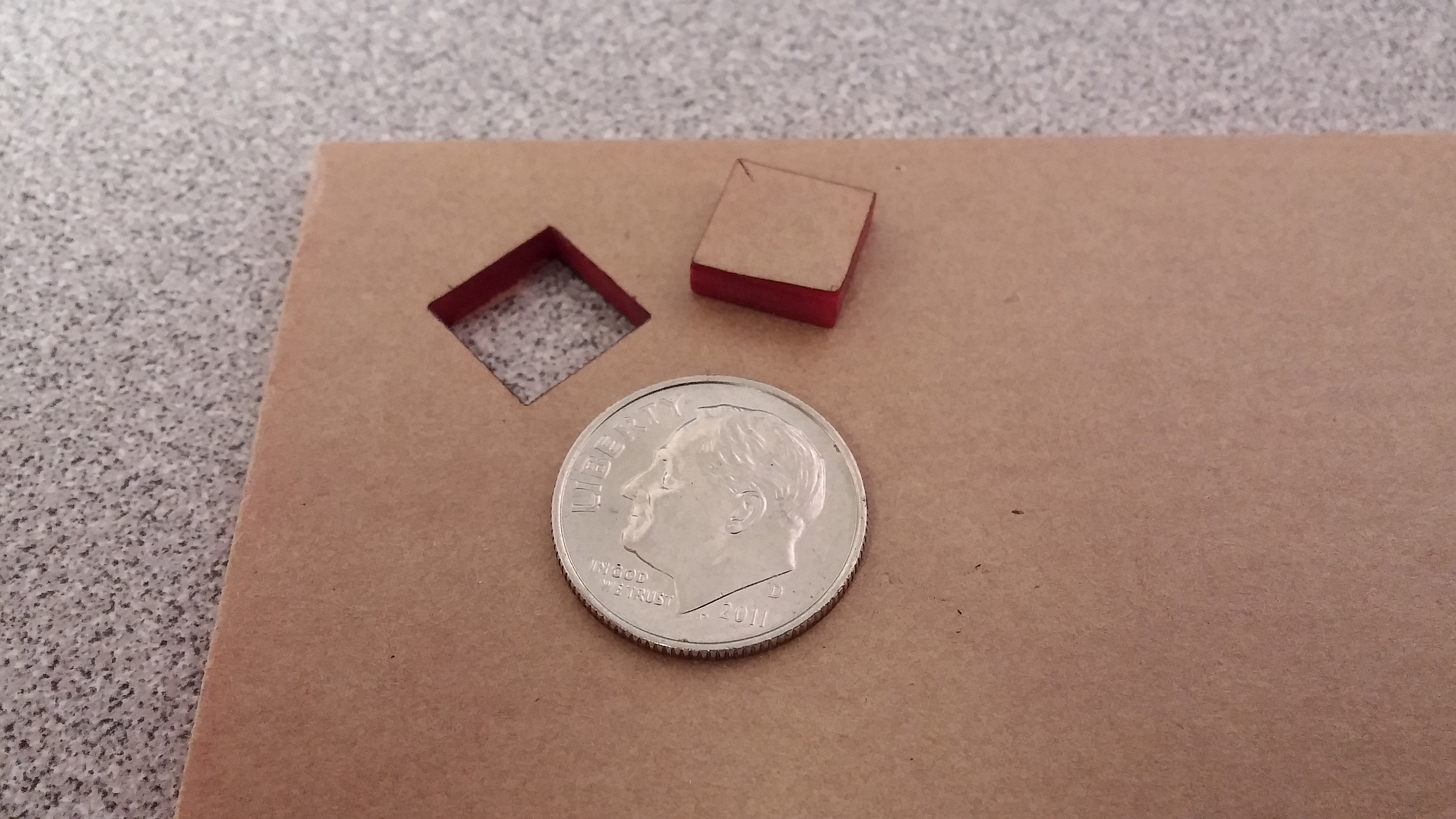

I received my Inventables acrylic yesterday. 1/8" thick red opaque. It appears to cut just fine, equally as well as Tap Plastics. I cut a small .375" square.

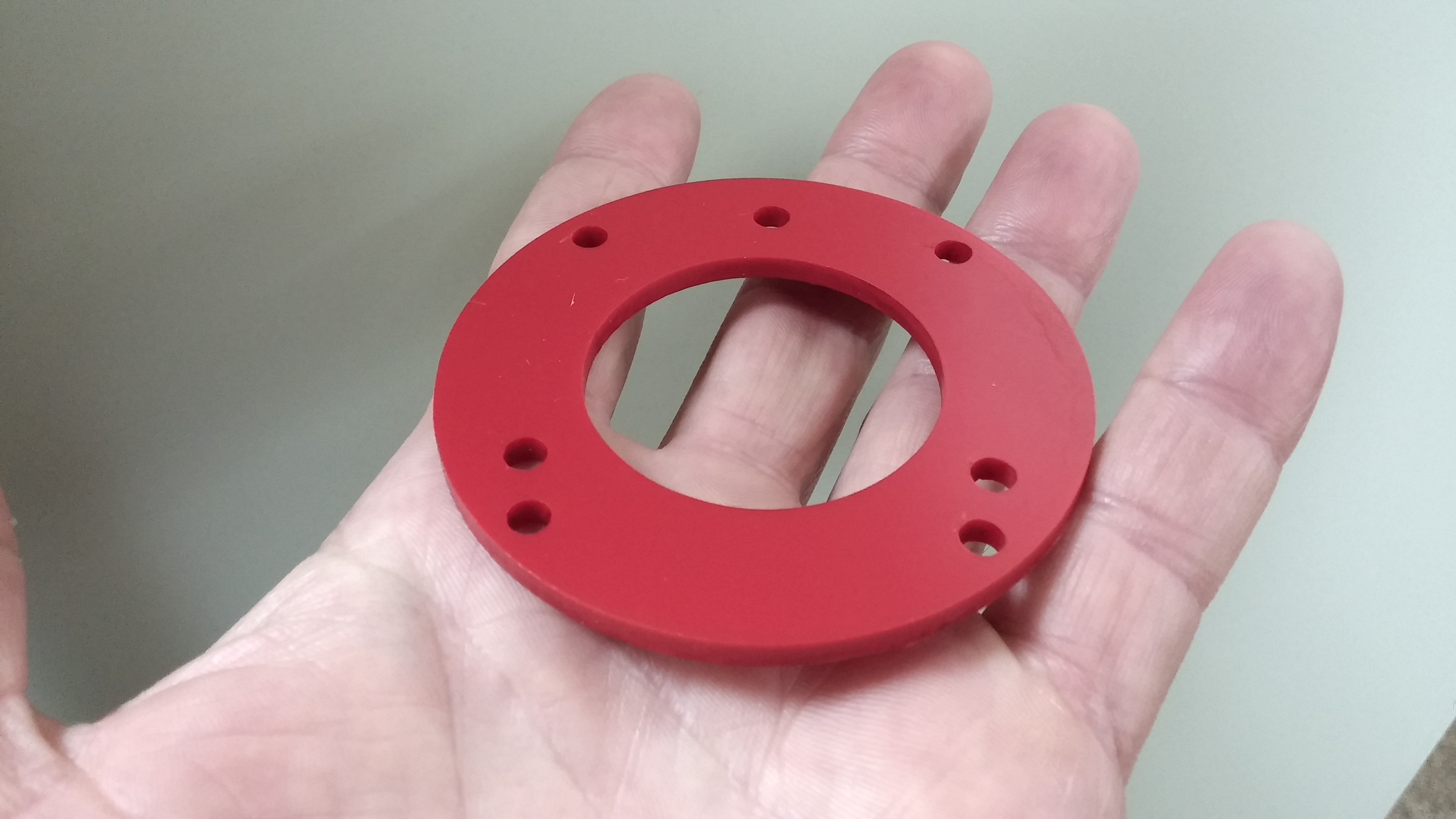

I found that it's possible to mount the L-cheapo without removing the hot-end screws.
The effector has 6 #6-32 holes. It's possible to use one set of three holes for the hot end and the other set for the laser.
[img]http://i.imgur.com/ON6Kocg.jpg[/img]
[img]http://i.imgur.com/mSVuhrN.jpg[/img]
[img]http://i.imgur.com/caNx5r7.jpg[/img]
[img]http://i.imgur.com/KpGNqj1.jpg[/img]
Note, however, that I'm using an E3D v6 hot end, extra 1/2" spacers and screws, and a SeeMeCNC J-Head mount.

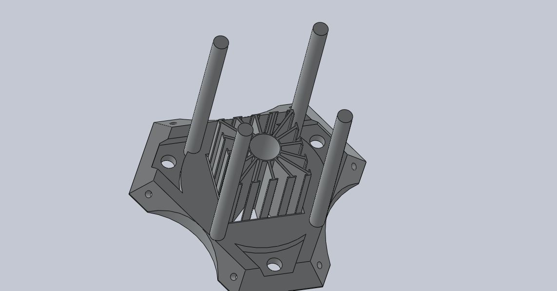

I´m planning a Laser-Mod too. But here are some toughts:
Lets say the mount for the Laser is 80mm in hight. adding 100mm Laserbeam to have it focused well, you have 180mm from bottom of the effector to your cutting.
When the effector tilt for whatever reason ever - geometrical issue, lack in bearings etc. - lets say 0.2 degrees, your focussed laserspot is moving 0.63mm off. That´s massiv for a quality cut.
Even if it is tilting less than the above example, the more your effector is above your "cutting spot", the less is the quality.
For that reason isn´t it better to build a Holder that is above the effector Platform like it is for the Hotend? Or am I wrong?
Bubbasnow did it with his way of attaching, and I think it´s a better solution for higher resolution/quality.
Or am I completly offtrack?

That's the way you are supposed to do it. I don't remove my hotend end screws ever. They are just long enough to accept my laser mount. All I have to do is screw on the nuts.
I just recently removed my E3Dv6 and went back to a stock hotend. I think I was getting some jamming with the E3D.
By the way, your mount looks really nice. Great job!

Yes, it is better to mount your laser on top like bubbasnow. Always. However, I didn't want to unassemble anything. I don't like doing that. I want to easily go back and forth between 3D printing and lasering. Bubba can easily do that with a magnetic mount but I can't. That why I suspend from the bottom.critical_limit wrote:I´m planning a Laser-Mod too. But here are some toughts:
So far I've not run into delta issues with this mount. My parts haven't been any bigger than 3". My cuts seem precise and are not tapered. Clean side walls. Only time will tell if I start to have problems.

@heathenx:
Don´t get me wrong please. No critics to your build. You did an amazing job and brought me to the Laser mod. Thanx for your posts, hints and of course the video. Good job.
My english isnt good enough to find the right words. So please execuse if it sound rough sometimes.
Anyway. But there is a advantage to first mod with magnetic ballends....
Here is a quick draft of my Effector i made in the last 15 mins (I´m at work

That's alright, really. I didn't misunderstand you. I'm not a sensitive person. I can take critique. But it's not that at all. I agree with you actually. I'd love to get the laser on top of the effector but it wasn't easy for me that way. You actually gave me an idea for a magnetic removable hot end...not the effector.
Your mount design is quite interesting.
