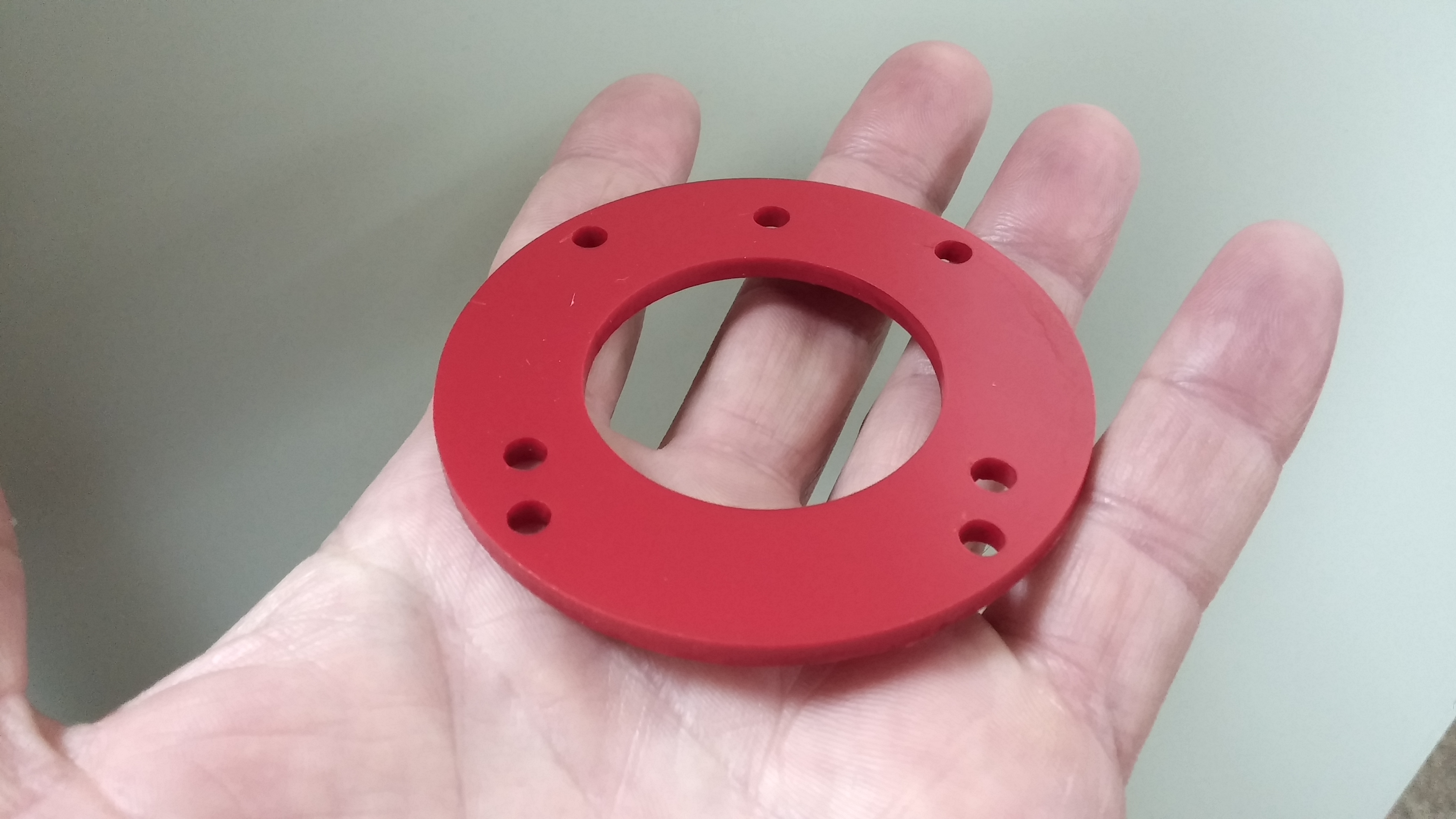

I received my Inventables acrylic yesterday. 1/8" thick red opaque. It appears to cut just fine, equally as well as Tap Plastics. I cut a small .375" square.

Oh, I like that mount. I'm working on a magnetic variation of my mount. Ordered and received about 50 magnets to play with. I'd like to easily snap mine on and off.

I found that it's possible to mount the L-cheapo without removing the hot-end screws.
The effector has 6 #6-32 holes. It's possible to use one set of three holes for the hot end and the other set for the laser.
[img]http://i.imgur.com/ON6Kocg.jpg[/img]
[img]http://i.imgur.com/mSVuhrN.jpg[/img]
[img]http://i.imgur.com/caNx5r7.jpg[/img]
[img]http://i.imgur.com/KpGNqj1.jpg[/img]
Note, however, that I'm using an E3D v6 hot end, extra 1/2" spacers and screws, and a SeeMeCNC J-Head mount.
