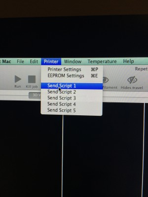

Here is what I did. It is very similar to Geneb's procedure, just using the EEPROM instead of screws and doing some simple calculations for Horizontal Radius.
Before anything, started by getting the Z-Height right (using geneb's procedure described in manual). Then, start the calibration with Z tower:

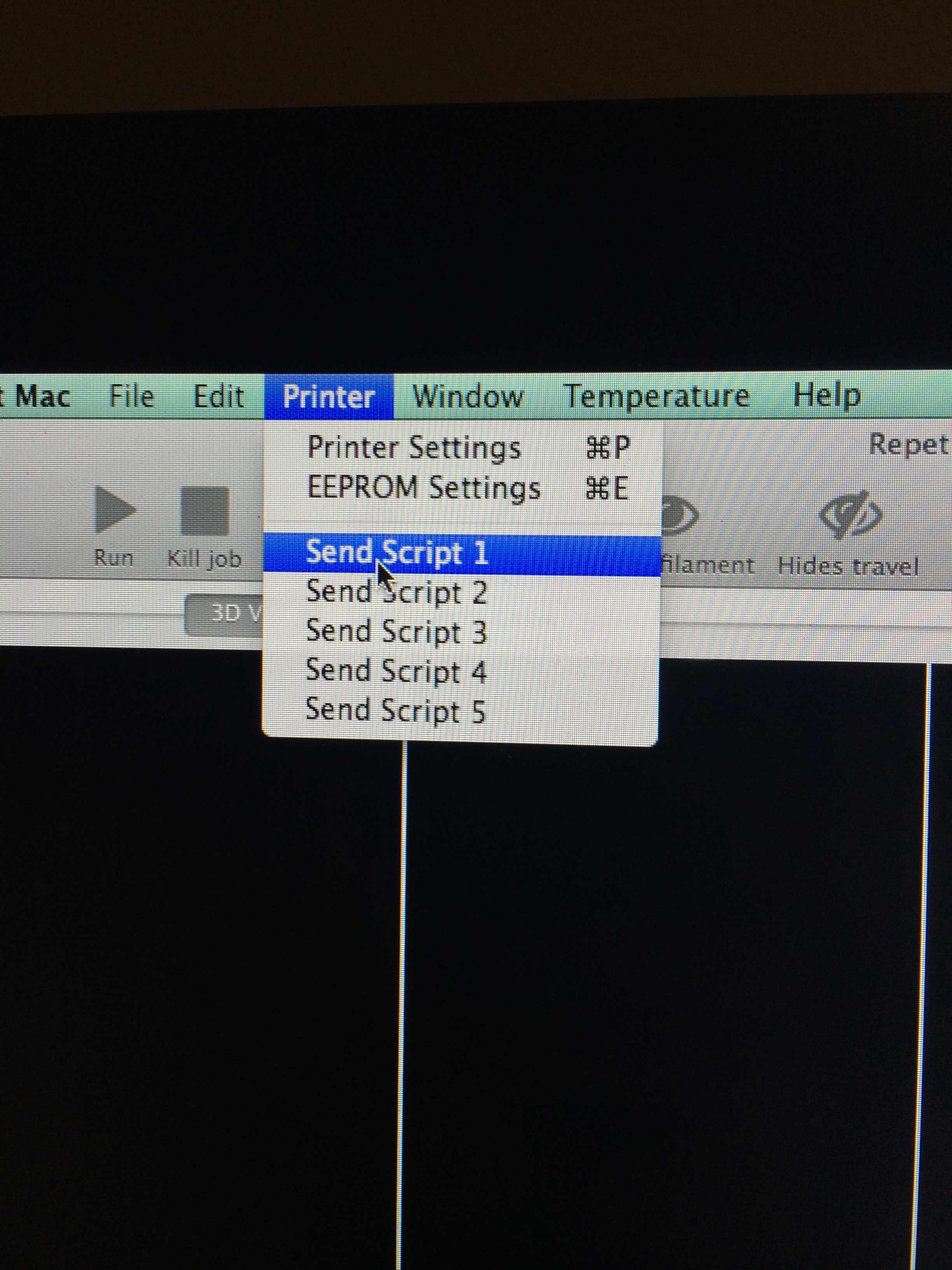

1. Ran the "Script 1" (or whatever script you are using for Tower Z) to get Z tower height. Yes, you should set Z5 or so the first time, just as a precaution to avoid hitting the borosilicate glass :-)
Script 1 (for tower Z)

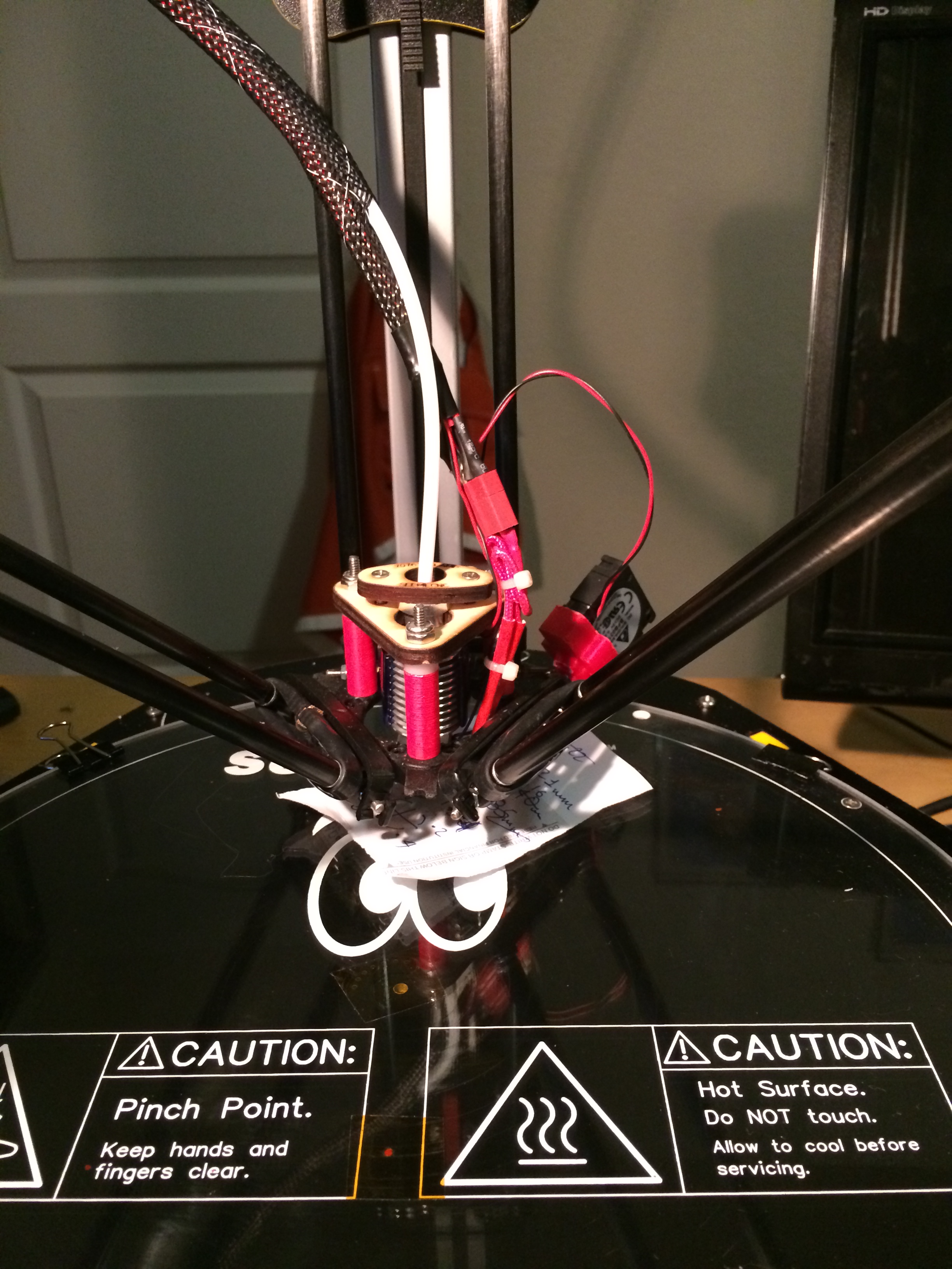

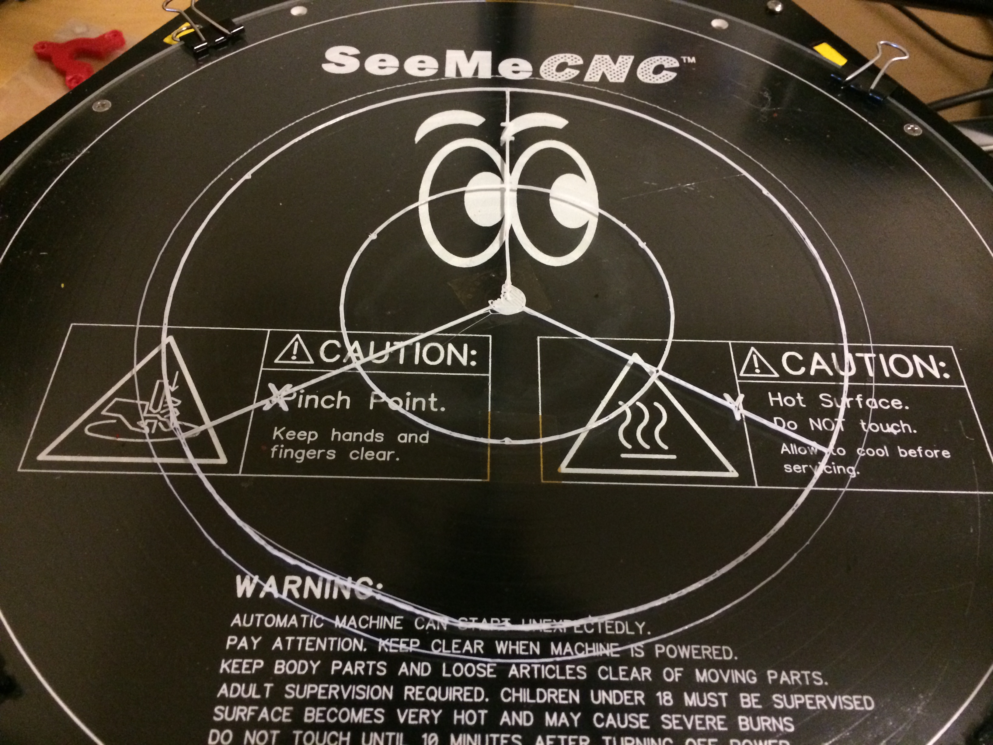

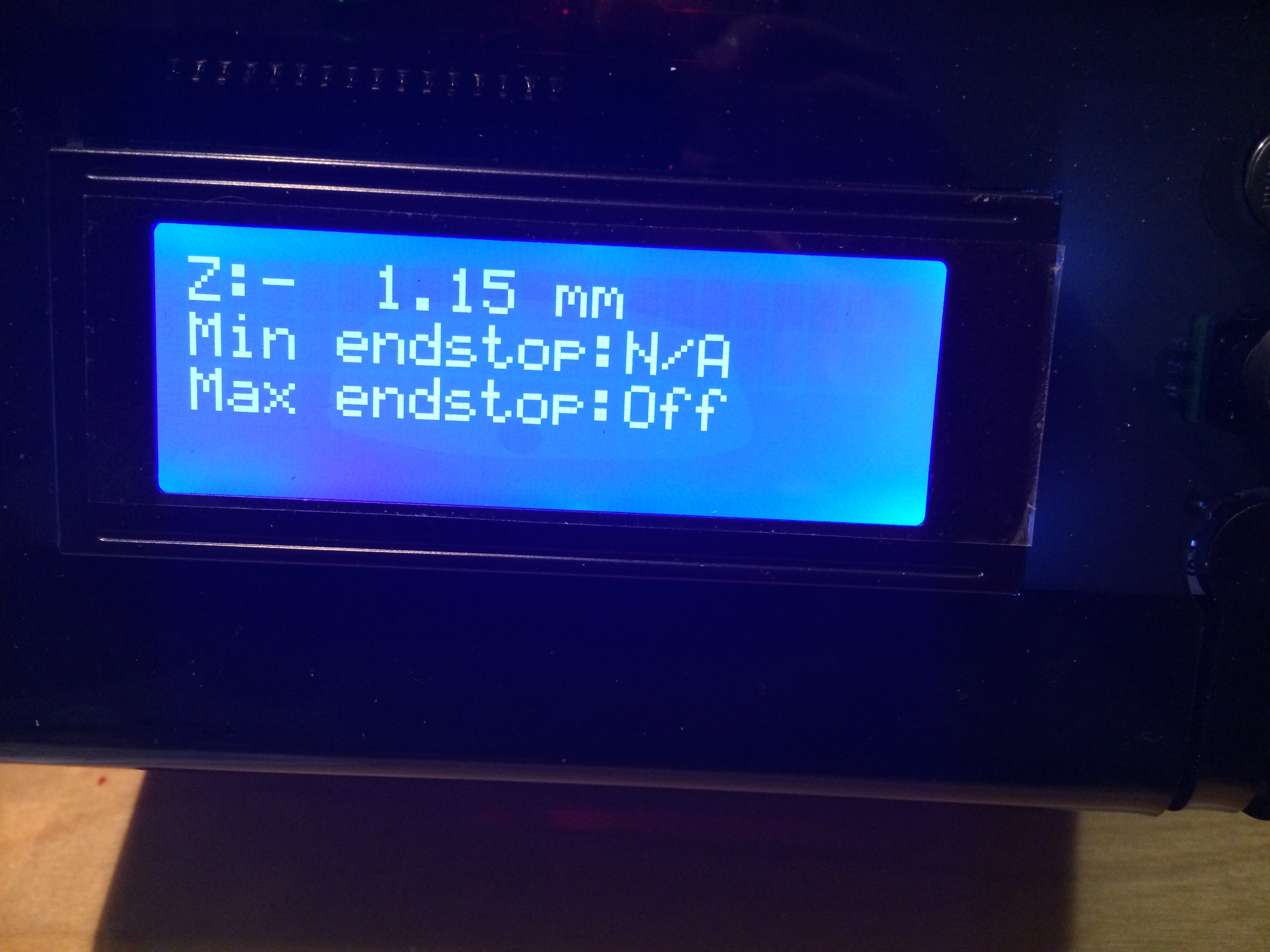

2. Using the "Z position" option from Advanced Settings menu, move the nozzle until you get it down to the bed (yes, use the paper method). Then write down the offset value for this tower. In my case, it was -1.15 mm.
Using the paper!
Using the paper!
offset in mm
offset in mm

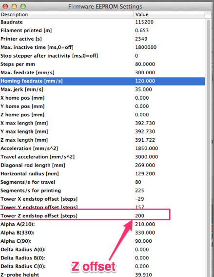

3. Convert this offset value, from mm to steps. For this, get the "steps per mm" from the EEPROM (it is 80 for my V2), then, simple multiply this value by the offset in mm, then, invert the sign of the result (or, simple, multiply it by -1) this is
-1.15mm x 80steps/mm x -1 (just to invert the sign) = +92 steps
4. Get current value placed in EEPROM "Tower Z endstop offset [steps]", then, and add this to the value from step 3. For the first iteration, the original offset value would be ZERO. However, in the following calibrations, this value would be the previous offset entered. I was in my second calibration, then the original offset was 200 steps
current Z offset value in EEPROM
The new offset value would be:
200 steps (original offset value) + 17.6 steps (current offset) = 217.6 steps (new offset)
Store this new offset in the EEPROM variable, overwriting the original value.

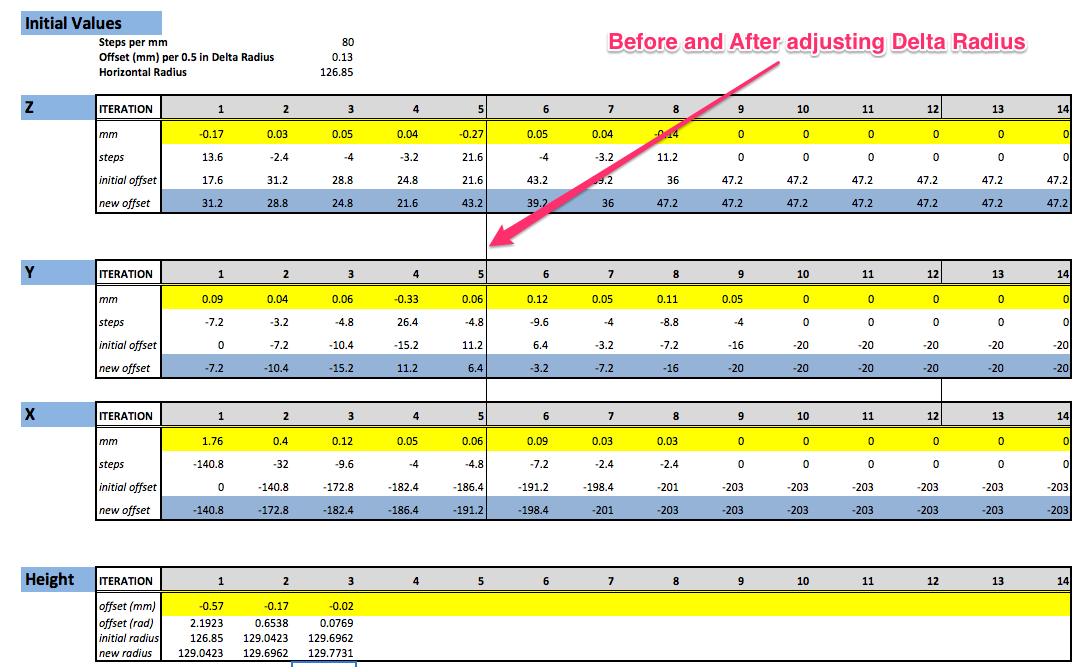

6. Now, run the Script 4 (or simple G28 followed by G0 Z0) to get the Z-height. As you know, it could be above or below 0 (NEVER zero :-) ). Use the "Z position" from Advanced Settings menu to get the offset value in mm. Write this value down, will be used in step 8.
Now, as explained in Geneb's manual, you have to modify the value in the EEPROM for "Horizontal Radius [mm]" by 0.5 (adding or subtracting it to the original Horizontal Radius).
7. Get back to re-calibrate the towers, but this time, you do not need to adjust one by one. You can get the three offset values first, and then enter all of them at once in the EEPROM (remember to invert the sign and to add this value to the original offset value in the EEPROM). You can do it one by one, but if you do it at once you can time.
8. Get the new Z-height (G28 + G0 Z0 or script 4). If not zero, then get the current offset (again, using "Z position" option). Then, get the variation in offset from the original one (from step 6), and the new one.
Delta = Z offset Step 6 - current Z offset (Important, get the absolute value => NO SIGN!)
Use this delta to calculate the new new Horizontal Radius:
New Horizontal Radius = (0.5 * current Z offset) x Delta
NOTE: this DELTA value is the mm that your nozzle will move with 0.5 variation in "Horizontal Delta Radius", it is important to write it down, as will help you to speed this process in the future.
9. For me, it was all, at this step my bed was flat.

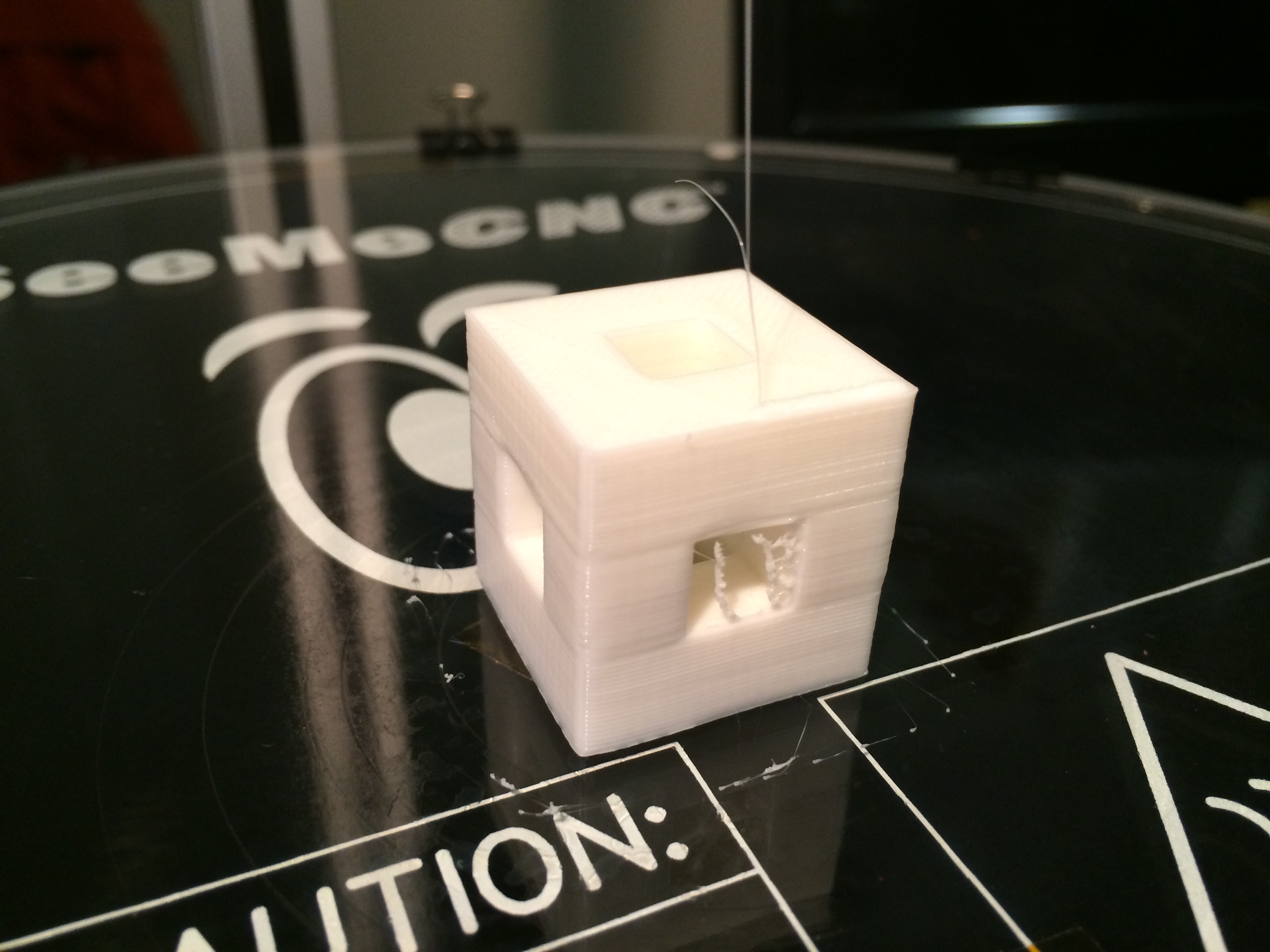

I just finishing a second print (actually, the third, as the second ended when I tried to read the EEPROM to while printing :-) ). This calibration print was the larger one, not only 200mm as the first posted. You see two points were the print is messy, but believe me, it was due that I didn't spray enough aqua net, as the first layer (0.2mm at 100%) was printed perfectly over the entire bed!
New print calibration
and, here is the calibration cube -third print!- (25mmx24.95mm x 25.06mm):
Holly Cube!
Holly Cube!
Not bad For sub 30 mins calibration. I am loving my Night Fury!! ;-)

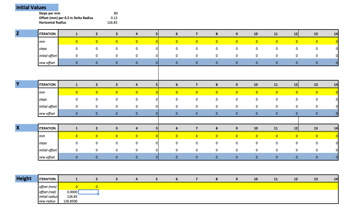

I will share (once at home, as I do not have it here) my spreadsheet. Nothing that you cannot create, but will help you to enter your data and get the idea faster; then you can create something more sophisticated.
It could, ultimately, be introduced as a routine in the firmware (oh, if just had enough time to deep dive into the code! :-) ), being you the "probe" and entering manually the results. Of course, an integrated probe is better, but, if not, this would be the second best option.

For some reason, the Z tower endstop offset is being ignored.
Because i am lazy i found a new trick (and being a dumbass this is probably the problem). Anyhow, if you are too low with the hot end, then you can just use the Repetier to move the hotend up, and it shows you how far above you are from the bed.
Every thime i was 0.4mm below the bed, sqeezing the paper, and i lifted it up by 0.4 mm (by 4 clicks on up 0.1mm) and got the tightness i wanted. However, after 5 repetitions of scrip1 and raise i noticed that i was too far down by 0.4mm every time. So i put a 1 in front of the offset value and repeated the process and again i was 0.4 mm too low. So something is not quite happening correctly.

Check your X tower offset.
I am still checking but it may be that it ignores negative values.
*** EDIT.
I used your method to calibrate my Rostock. Something had gone terribly wrong with my initial calibrations. The z height was off by 5 cm. Yet it still printed but proportions were off by %1 in x and Y and %10 in Z.
On my machine, the offsets only accept positive values. Putting in negative values is perceived as 0 by the software.
THANKS A LOT!

Ah, by the way, I said I would share my spreadsheet, here it is.
Rostock Calibration Spreadsheet V0.1.xlsx
(18.15 KiB) Downloaded 1027 times
Is silly, nothing complicated to do, but it helps me to get the thing calibrated very fast, 30 mins max, if I want to get fancy, down to the 0.01 mm :-)
You will need to change the initial values for your printer (Steps per mm and Horizontal Radius). My both printers have a "ratio" of 0.13mm per every change in 0.5 in Horizontal radius, so, you can start with this value. This is how it looks when you start
Before calibration, all offsets are zero.
Then, you just have to enter the offset in mm, you will get the "new offset" value to set up in the EEPROM, script, get offset and repeat :-) This is how it looked in mine after the last time I used it
Screen after calibration is done.
As you can see in this pic, I have a line in the spreadsheet. I put this only to get to know when the towers were aligned BEFORE I started changing the Horizontal Radius.
Once you get the three towers aligned and ready to modify the delta radius, you will use then the offset in mm in the "Height" section. It worked for me :-)
