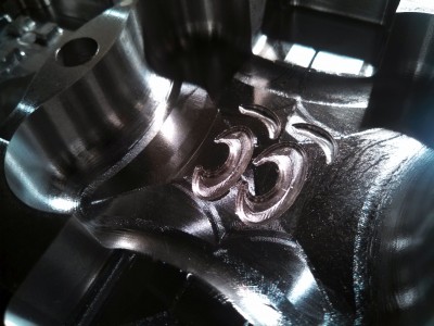

I hacked into the SeemeCNC computers and found two images of the new cheapskates for all of you that were wondering
and to burst Gene's "secret". For your enjoyment:

I'm guessing the second picture is part of the injection mold for the cheapskate frame in the first picture.
Re: New Cheapskates Revealed!
Eric wrote:I'm guessing the second picture is part of the injection mold for the cheapskate frame in the first picture.
I believe that is correct.
Yep, that's part of the injection mold.
You guys are gonna love those things. :)

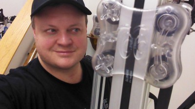

Here are my espionage photos, too!
http://imgur.com/a/zmGoE
They'll work with the new style arms (with the plastic spring clips), so yes to the V2's, and yes to the newer V1's. Luckily, all of the conversion parts are available for older machines, so you can do the upgrade on any SeeMeCNC machine, you just might need a few extra bits and pieces.

After getting the pictures and seeing what you have posted I can't help but wonder if those cheapskates will come apart for repairs to the wheels.
The seam looks as though it is glued together.

I see phillips head screws in the pictures, so I'd say they come apart.
Eric wrote:I see phillips head screws in the pictures, so I'd say they come apart.
After looking again, I can now see the screws, thanks you have some sharp eyes!

What are they functionally improving?

edge922 wrote:What are they functionally improving?
They have built in springs that control the pressure of the rollers, no more adjustments.
It is 2 plastic parts and 2 screws that replace 4 nuts, 4 screws, 4 cams, 4 spacers, 2 pieces of wood, and 1 arm carriage (and that's if you don't use any washers :) ) I'm sure it's considerably lighter too.

I wonder how the Tensioners will last on the Bearings, Looks like it is just molded and relays on the plastic spring tension. I could be wrong and not seeing something.
Joe
joecnc2006 wrote:I wonder how the Tensioners will last on the Bearings, Looks like it is just molded and relays on the plastic spring tension. I could be wrong and not seeing something.
Nope, no springs or anything, just the flex of the plastic.
I'll be curious to see what mileage these are good for as well.
