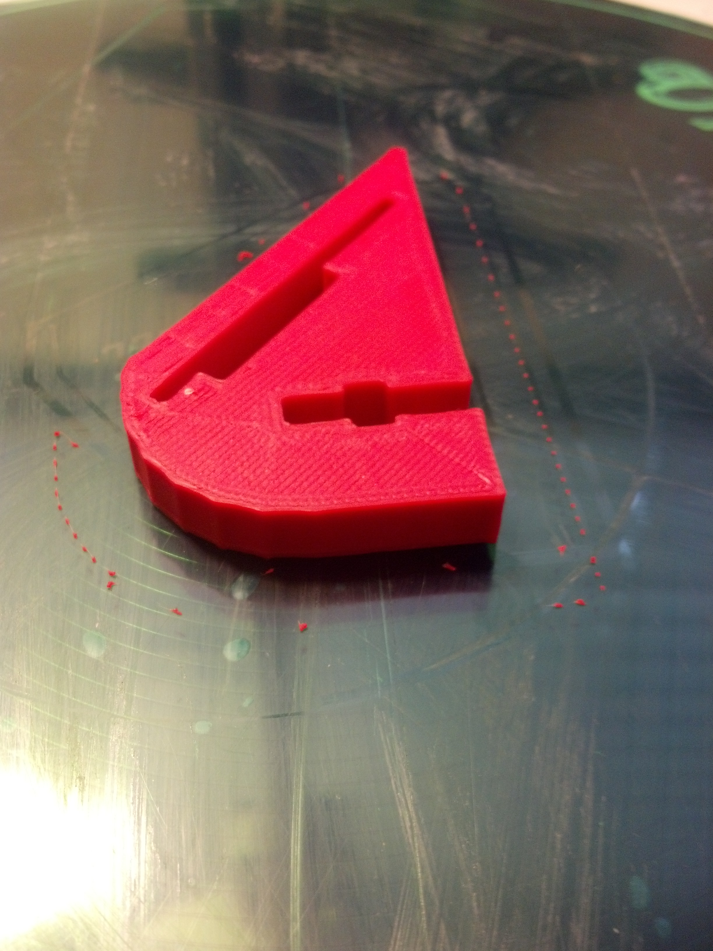

Still working out some of the caveats with the new repetier firmware. filament was retracted too much and didn't prime quite enough before the print started.
- foshon
- Posts: 600
Re: Cura settings
Ummmm....ok. 100+mm isn't enough to prime? The dots start at the beginning of the perimeter and continue to the end. Pretty telling.
Btw, I was poking around the firmware today and saw this:
If it works for you, wonderful. That fact doesn't make it sound advice for all.

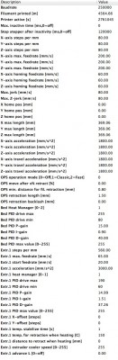

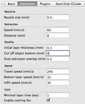

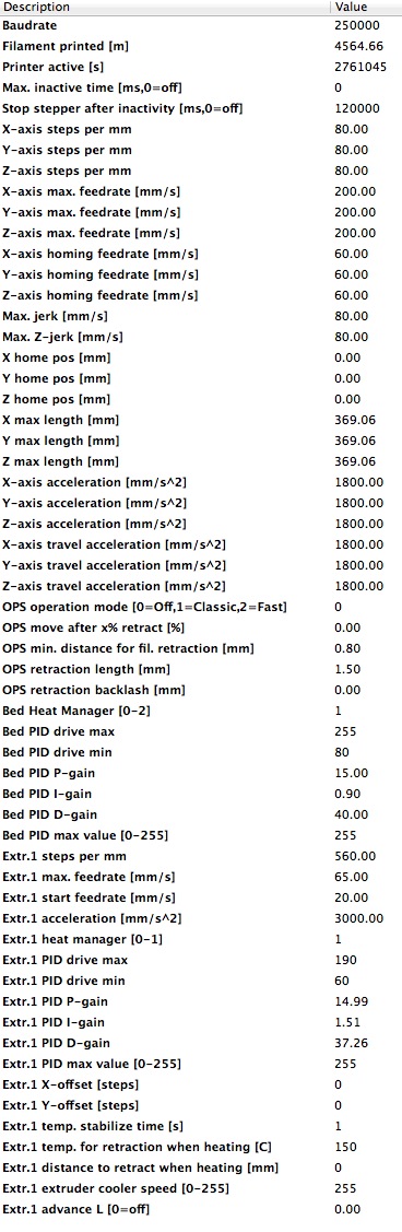

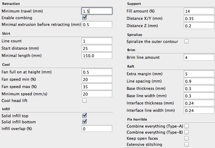

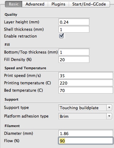

Hey after many months of fiddling with everything this seems to be getting me good results even on holed items including my EEPROM settings
Only mod I have is the J-Head Hot End
Minimum travel in the advanced settings would be changed higher on fairly solid objects and even or a bit lower on items with tiny holes.
Also speed, shell thickness and Bottom/Top thickness on some items depending on the model and printing resolution.
hope it helps!
