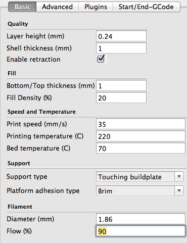

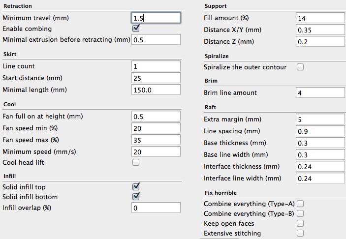

Re: Cura settings
Hey after many months of fiddling with everything this seems to be getting me good results even on holed items including my EEPROM settings
Only mod I have is the J-Head Hot End
Minimum travel in the advanced settings would be changed higher on fairly solid objects and even or a bit lower on items with tiny holes.
Also speed, shell thickness and Bottom/Top thickness on some items depending on the model and printing resolution.
hope it helps!
