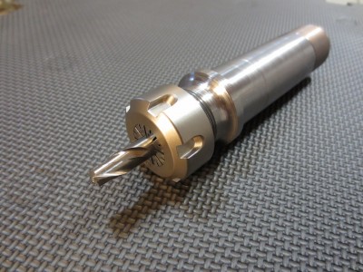

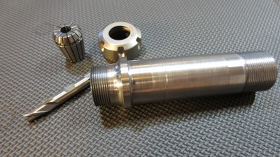

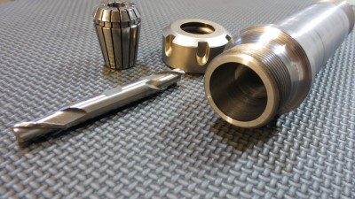

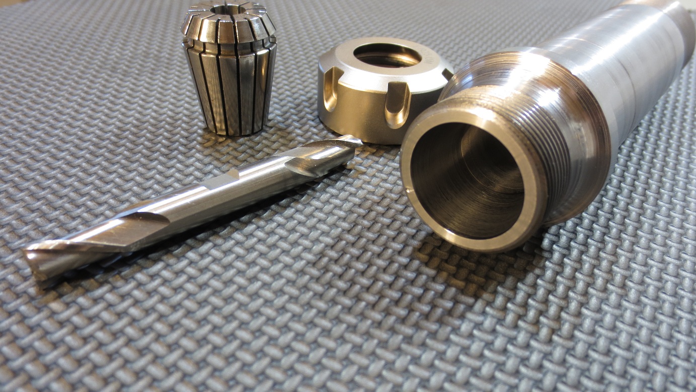

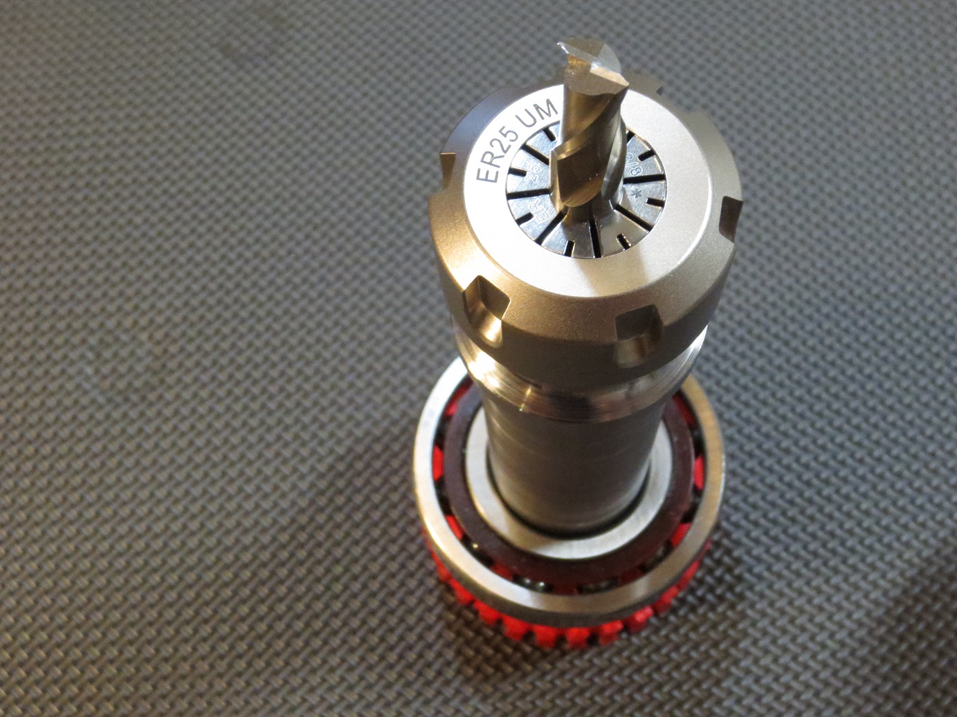

Update on the part making, I made the main milling spindle;
I still have to do a few more operations on it, like ball mill some round slots for round keys that will transmit torque. The big red thing is a pulley for a timing belt. It's meant for a Gates Poly Chain belt with 8mm pitch, which looks like the best, stiffest, strongest timing belt on the market. RPM range for this milling spindle will be 0-10,000 RPM, with a clutched stepper motor to do rigid tapping. The whole thing is on a rotary axis and acts as the 5th axis of the mill, so all sides of the part can be finish machined in one setup. I'm also making progress on the linear ways and stuff so the machine will start getting assembled soon.

ER25? You're not mucking about, are you
Be very interested to see how your spindle assembly turns out. Something I'd love on my machine is to be able to lock the tool spindle (or run it live) and have an A axis that ran like a lathe at speed with some guts behind it, or as a servo drive for a normal chucked A axis on the mill, OR as a trunnion/tombstone drive. But it all boils down to the combination of servo and spindle drive.

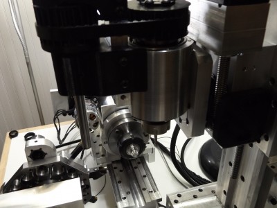

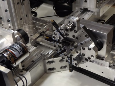

Right now there are 4 main assemblies on the machine; Headstock, Tailstock, Turret, and Milling Column.
The turret can be switched out for a tooling block (gang tools) for small parts. The milling column moves in both the X and Y axis, and has a dual worm drive swiveling head that is the spindle from the last post.

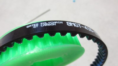

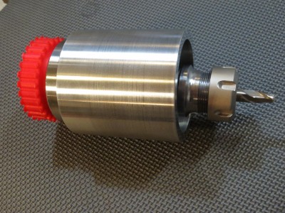

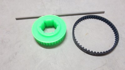

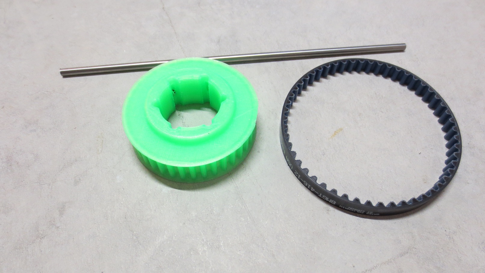

This is the new main spindle pulley design. It's threaded to fit on the back of the spindle, and it has 6 0.25" round key slots to keep it in place and transmit torque. The round keys can be adjusted and preloaded in place with set screws at an angle to the keys, so screwing in the set screws presses the keys against the spindle. This is to take out backlash, and possibly help with centering the pulley.
The belt is a gates Poly Chain, it's carbon fiber reinforced with a blue nylon tooth surface. I carefully measured the belt tooth profile and drew an accurate conic rho curve for the pulley mating profile; there is no backlash and there are at least 20 teeth in contact when the belt is on the pulley. This is the best I can do with 3d printed parts, I think it will work nicely. The green pulley is just under 4 inches in diameter, this should give more torque and a maximum speed of around 2000 RPM at 25 volts with a 149kv motor. If the initial tests are good, I'll get a full 3kW 48V power supply unit for twice the RPM.
I have the machine frame mostly done at this point, once I get the carriages finished I'll get pictures of the whole thing.

Clever work on the keys - will adjusting the set screws also affect axial angle as well as runout, though?
Can't wait (as I'm sure you can't yourself!) to see it all together and running.

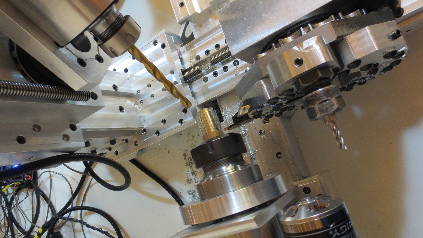

Just a tease for now, I have to finish a few technical papers before I can show the rest of the machine.
I ended up going with an Azteeg X3 Pro board for now to control it, I want to use the high end smoothieboard in the future whenever it comes out.
It's running repetier host and has successfully turned and threaded parts. I need to do some major firmware modification to get this thing to run the way I want.
In repetier host (and firmware), you can jog the X, Y, and Z axes with the GUI panel. You can also work the extruder forward and reverse, and switch between extruders with the T0, T1, T2, ect command. However, you can only control one at a time. This is a problem because the B and C axes (rotational) need to be able to move simultaneously for certain cuts. The tool turret also needs to be able to home to a default zero position so the tools can be made with offsets. As far as I know, you can't cheat the firmware by zeroing the hotends/extruders in repetier firmware.
Can anyone help me out with where to start with firmware mods? My goal is for all 8 of the stepper motors to be treated like independent axes so all of them can be homed or moved simultaneously. Rather than switching to another axis by command "T3", I would just do it as part of the G1 command, like "G1 X0 Y0 Z-1 C45 B90 E10" or something.

Re the firmware and driver board: this sounds a bit like guys fitting extruders to CNC routers (just the other way around). Yes, you can do it. Yes, it kinda works. Eventually. But it's a kludge that's far from optimal and every time you go to use it the headaches will outweigh the advantages.
Hate to say it but, for something this complex, I'd be looking to move away from printer drive boards and go for something like a kflop, a mesa board on a machine running LinuxCNC, or even a good old parallel port style BOB (eg UCNC100 or 300) running into dedicated step/dir or servo drivers.

I considered doing the mach3/linux cnc thing but I wanted to end up with something a little more future-proof. All of the parallel port stuff is going extinct, and it's kind of a pain to have to have a computer wired up to the machine all of the time just to run it.
Right now I'm maxing out the number of stepper drivers on the board, my machine would be a bit faster if there were a few more stepper drivers for extra functions. Servos are too expensive for now, and I'm getting around 50 IPM rapids with this machine without adjustment or optimization (or full stepper current). For a machine with a small work envelope like this, 50 IPM is fast enough.
The longer term plan is to modify a GUI and host software so the machine can be controlled from a touch screen tablet, like those matterhackers ones. If the new smoothieboard is as good as it sounds, it will have all of the features I need to make a working production CNC machine that can crank out parts all day unattended. At least that's the goal, I still have to get tool changes and bar feeding sorted out.

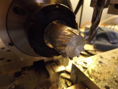

Another update on this thing. I haven't gotten that much done in the last few weeks on it. It can turn, thread, and mill parts in an ER40 collet or a 5 inch 3 jaw chuck. The spindle is eccentric by about 0.00015" or 3-4 microns because I used cheap non-precision bearings, but that's actually better than I expected. Static rigidity at the spindle nose looks to be about 40,000 to 100,000 pounds per inch of deflection, which isn't as good as full sized machines. I blame the thin-walled aluminum body tube for this floppiness.
The C axis works (precise indexing rotation of the workpiece in the spindle) with a belt drive on the back, which has a pin-engaged clutch to switch between the brushless DC motor for turning and the Nema 23 stepper motor for indexing and threading. Eventually I'd like to switch away from this system and have a direct drive for turning and threading and a clutchable strain wave gear for indexing and heavy milling/braking.
The B axis is the swiveling milling head, it's driven by a double worm gear where the worms are fast travel leadscrews on opposing sides of the rotating shaft gear. It's a 45:1 gear down using a 3d printed gear out of PLA. It can't be backdriven unless the gear teeth shear off, which is a realistic concern since it's printed plastic! So far there seems to be no wear or backlash and the rigidity is pretty good. I've been testing strain wave gears as a replacement for the worm gear since the worm gear may not be capable of larger torques from heavier milling operations.
The turret (shown below) has 8 tool stations for fixed turning tools, drills, and boring bars. It may be compatible with live tooling in the future because I have a through-turret bearing shaft that can be powered, but right now there is no motor hooked up to it. The turret is indexed with a tapered geneva mechanism for 16 stepper rotations per full turret rotation. It can't be backdriven and there is no backlash since the locking pin is tapered and preloaded slightly. Repeatability and rigidity of the turret seem to be good so far, but it's unhardened 1018 steel so it won't last forever.
This is just a small impeller I was making as a test. It's easy to program this stuff by hand.
I have run into a few problems though. The Azteeg X3 Pro board has most of the hardware I need to make this machine work, but the firmware is limiting me. I need to be able to switch tool offsets without switching fake extruders, so I need to modify the firmware to allow tool offsets since it has a maximum of 5.
I also need to change the controls so that the firmware treats all axes as independent so they can be moved simultaneously. I need to be able to zero my fake extruder axes so the milling X and Y axes can have a home position, and also touch off milling tools to get the radius from the B axis. Then with more firmware modification I can make the swiveling B head maintain a fixed position relative to an observer while the B axis rotates, if this makes sense.
Pretty much the entire machine is scratch built, and the only parts that ended up not working right where things powered by fast motors. I didn't plan that part very well, so I had to go through several design iterations to make it work. If I had to do it again I would use sensored BLDC motors with larger keyed drive shafts and metal pulleys/gears, along with better ESCs. I should have put time into designing a gearbox/pulleybox to drive the spindles.

What he said. More photos and videos of the beast in operation please, but what you've shown us so far is a thing of beauty.
How are the plastic guides holding out so far, considering smooth motion in the 'allowed' degree of freedom vs stiffness in the others?
Rather than the strain wave harmonic drive style, also worth looking at hypocycloidal eccentric gears. Nice smooth curves = relatively easy to machine the rotor and the ring can be done with some steel rod stubs. Considering putting one together to rebuild my el cheapo chinese 4th axis which is currently belt driven off a NEMA23 stepper and which I can backdrive by hand - even if it's only a bit of 8mm rod in the chuck.
Question: it looks like your X is driving the A spindle back and forth along the rails, how do you keep the toolstock synched if, for example, you're just using a dead centre in it? Slaved secondary lead screw on the tailstock, does it clamp to the same one, or what?
