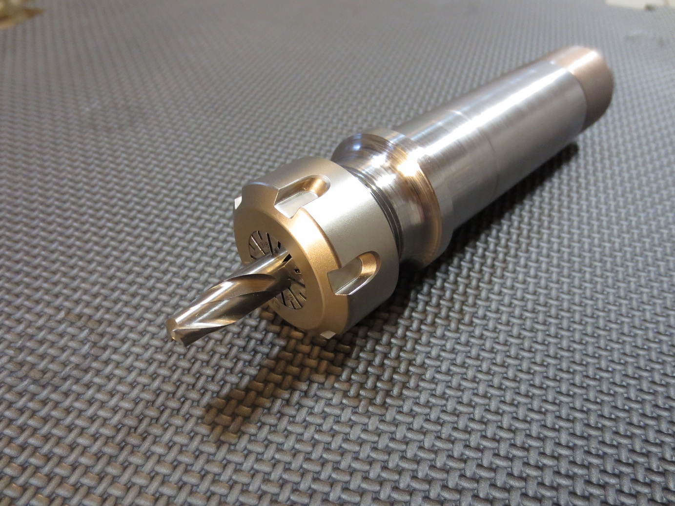

Update on the part making, I made the main milling spindle;
I still have to do a few more operations on it, like ball mill some round slots for round keys that will transmit torque. The big red thing is a pulley for a timing belt. It's meant for a Gates Poly Chain belt with 8mm pitch, which looks like the best, stiffest, strongest timing belt on the market. RPM range for this milling spindle will be 0-10,000 RPM, with a clutched stepper motor to do rigid tapping. The whole thing is on a rotary axis and acts as the 5th axis of the mill, so all sides of the part can be finish machined in one setup. I'm also making progress on the linear ways and stuff so the machine will start getting assembled soon.

ER25? You're not mucking about, are you
Be very interested to see how your spindle assembly turns out. Something I'd love on my machine is to be able to lock the tool spindle (or run it live) and have an A axis that ran like a lathe at speed with some guts behind it, or as a servo drive for a normal chucked A axis on the mill, OR as a trunnion/tombstone drive. But it all boils down to the combination of servo and spindle drive.

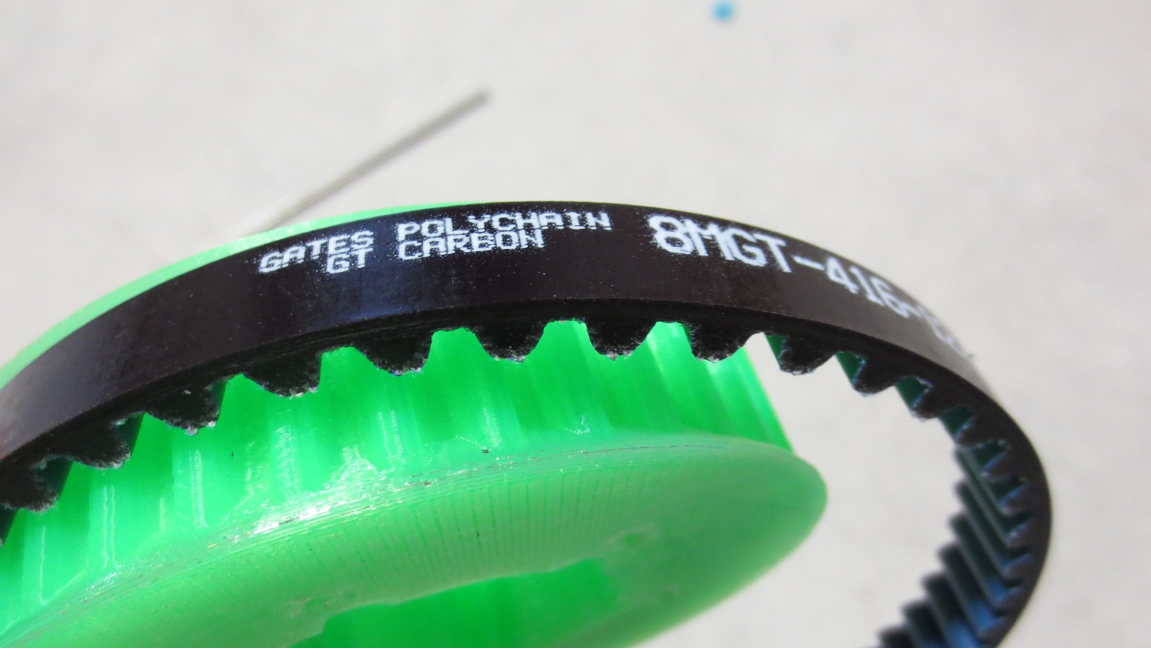

This is the new main spindle pulley design. It's threaded to fit on the back of the spindle, and it has 6 0.25" round key slots to keep it in place and transmit torque. The round keys can be adjusted and preloaded in place with set screws at an angle to the keys, so screwing in the set screws presses the keys against the spindle. This is to take out backlash, and possibly help with centering the pulley.
The belt is a gates Poly Chain, it's carbon fiber reinforced with a blue nylon tooth surface. I carefully measured the belt tooth profile and drew an accurate conic rho curve for the pulley mating profile; there is no backlash and there are at least 20 teeth in contact when the belt is on the pulley. This is the best I can do with 3d printed parts, I think it will work nicely. The green pulley is just under 4 inches in diameter, this should give more torque and a maximum speed of around 2000 RPM at 25 volts with a 149kv motor. If the initial tests are good, I'll get a full 3kW 48V power supply unit for twice the RPM.
I have the machine frame mostly done at this point, once I get the carriages finished I'll get pictures of the whole thing.

Clever work on the keys - will adjusting the set screws also affect axial angle as well as runout, though?
Can't wait (as I'm sure you can't yourself!) to see it all together and running.
