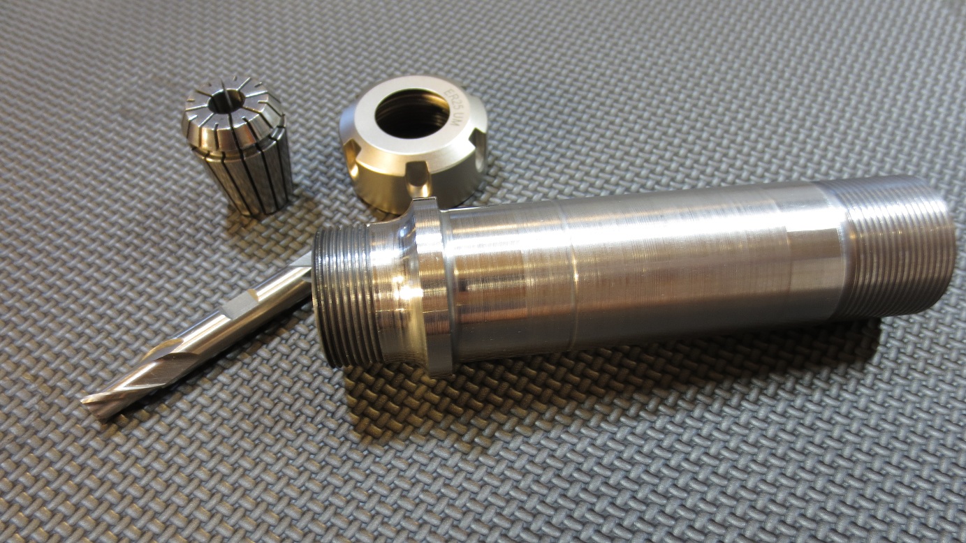

Update on the part making, I made the main milling spindle;
I still have to do a few more operations on it, like ball mill some round slots for round keys that will transmit torque. The big red thing is a pulley for a timing belt. It's meant for a Gates Poly Chain belt with 8mm pitch, which looks like the best, stiffest, strongest timing belt on the market. RPM range for this milling spindle will be 0-10,000 RPM, with a clutched stepper motor to do rigid tapping. The whole thing is on a rotary axis and acts as the 5th axis of the mill, so all sides of the part can be finish machined in one setup. I'm also making progress on the linear ways and stuff so the machine will start getting assembled soon.

ER25? You're not mucking about, are you :)
Be very interested to see how your spindle assembly turns out. Something I'd love on my machine is to be able to lock the tool spindle (or run it live) and have an A axis that ran like a lathe at speed with some guts behind it, or as a servo drive for a normal chucked A axis on the mill, OR as a trunnion/tombstone drive. But it all boils down to the combination of servo and spindle drive.
