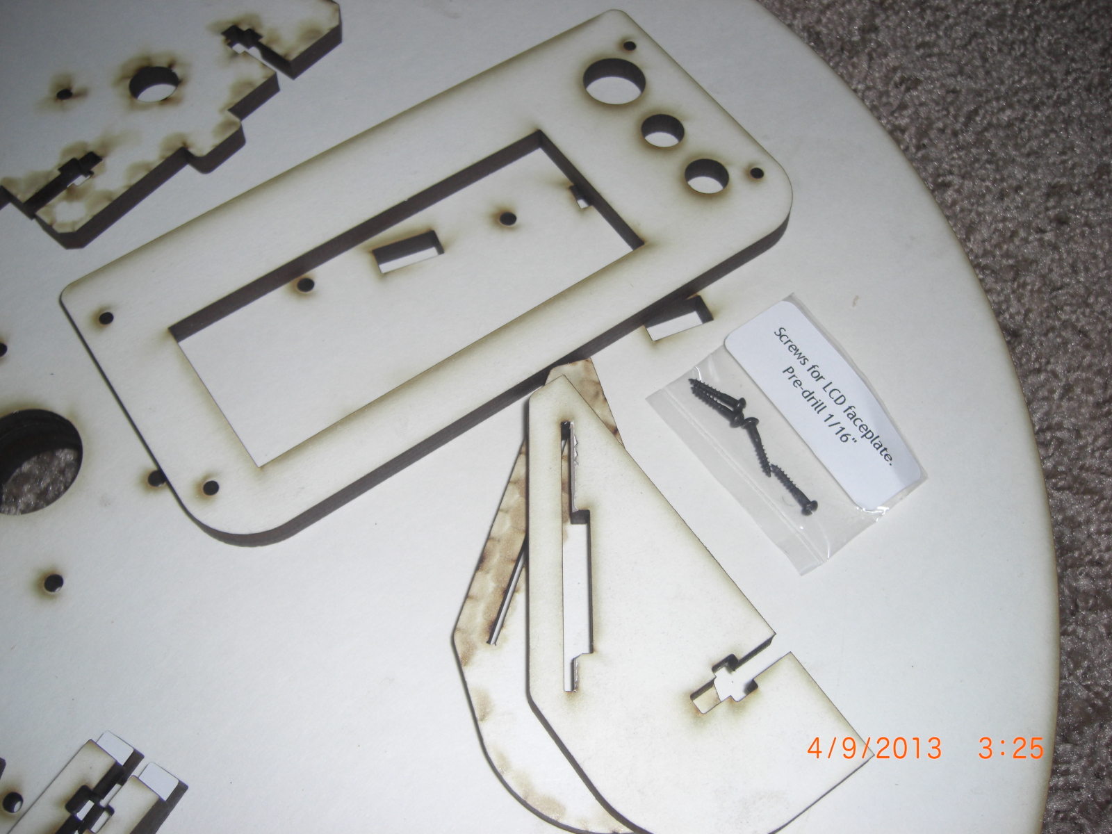

my new frame kit arrived from tricklaser.com also.. check out my custom made belt tensioner mount.
original left, new on the right http://forum.seemecnc.com/viewtopic.php ... &start=220
tricklaser TL-1 frame looks well cut and pre-removed from laser cutting sheet. packed nicely. will be assembling this and posting another report.
after some unpacking and visual inspection the kit is well cut, and very well aligned. top plate is perfectly symmetrical to the bottom plates. I can rotate the top plate to all three positions and the slots line up.
rambo mount is inside like the new rostockmax kits but it has more holes for mounting and running wires. also a fan mount.

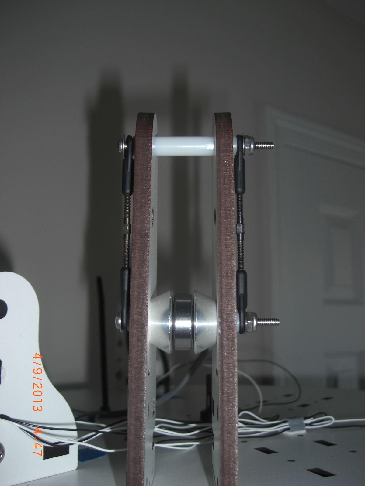

Belt tensioner take two.
Post by cambo3d »
some preliminary test fit photos. looks promising and I think its going to work. Now I know the exact sizes i need for turnbuckles. i'm gonna start looking for better parts. maybe get turnbuckles that are more heavy duty.

Cambo, I think that kit looks much better. But on the tension system, I think I would remake that.
If I recall you do a bit of machine work also. Wonder if you could use that tension mount but create a wishbone shaped bearing holder to replace the spacers on each side of the bearing. Then machine a point at the top for a single adjustment screw with a solid adjustment plate at the top.
I can cad out what I am talking about if that would help explain better.

I didn't want to machine any parts, goal was to make out of what was already available. I would rather prefer one single point of adjustment though.

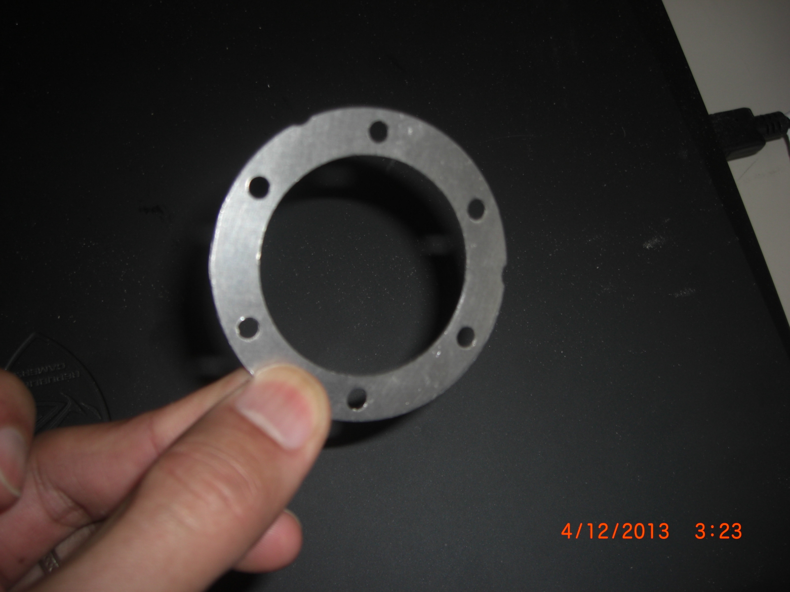

led light mount
Post by cambo3d »
I finally got around to milling out my aluminum led mount for the rostock platform ( http://forum.seemecnc.com/viewtopic.php ... =220#p8825) came out pretty good. here are some photos.
I used a scrap aluminum cover from a radioshack project box. About 1mm thick. Once I got my cnc router setup, It took less than a minute to cut out.

dbarrans
Posts: 273
Re: Another rostock max build
Post by dbarrans »
Why not print it instead? Too close to the hot end?
- dan
cambo3d
Posts: 1057
Location: Florida
Post by cambo3d »
dbarrans wrote:Why not print it instead? Too close to the hot end?
- dan
im using aluminum because it doubles as a heatsink for the 1 watt leds.

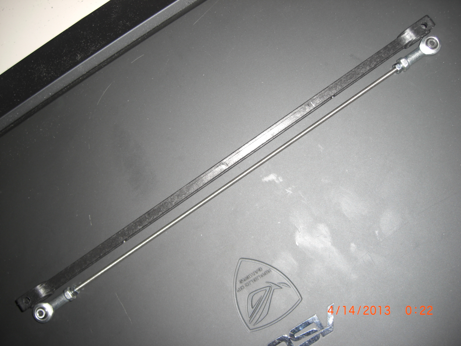

TL-1 from trick laser with some help
Post by cambo3d »
started prepping the frame with my little helper, The tl-1 frame went together without a hitch. I didn't have to sand or struggle assembling it. It was flat and level on first assembley. I was pleased. :mrgreen: I will be assembling this machine as parts roll in. along with my planned upgrades.
cambo3d
Posts: 1057
Location: Florida

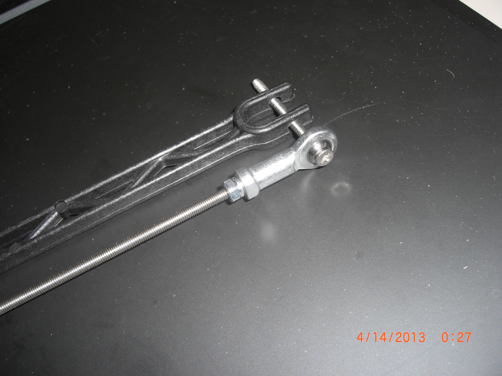

replacement arms arrived from china for testing
Post by cambo3d »
fit feels good, no play in the ball ends, balls feel a little tight but putting some lube on them should loosen them up more. these are metal so they are heavier. we'll see how they turn out. shipped from china took about a week not too bad. i had the seller customize these to 269mm lengths.

Those look great! Good to finally have something different to get away from all that sanding that never works the first time.
Have fun hooking those up and let us know how they work. Is that your son in the pictures?
