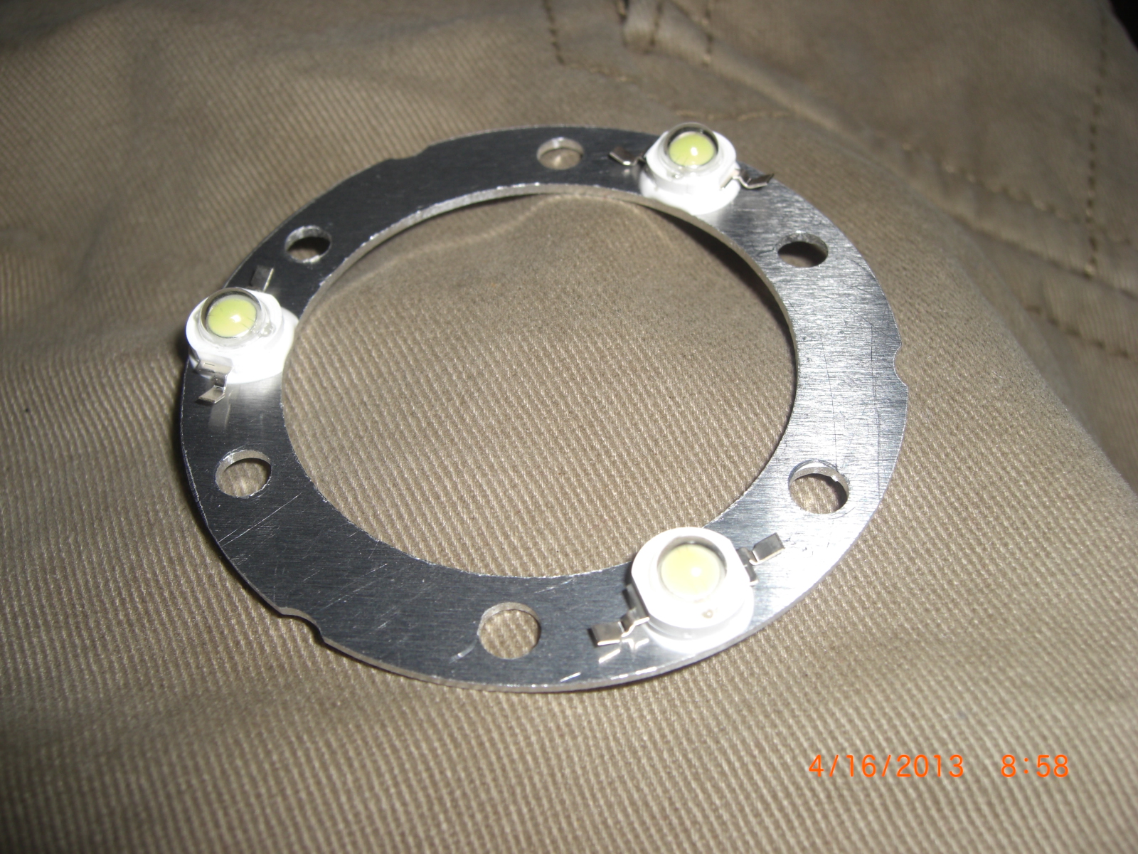

led light mount
I finally got around to milling out my aluminum led mount for the rostock platform ( http://forum.seemecnc.com/viewtopic.php ... =220#p8825) came out pretty good. here are some photos.
I used a scrap aluminum cover from a radioshack project box. About 1mm thick. Once I got my cnc router setup, It took less than a minute to cut out. test fitting leds

Why not print it instead? Too close to the hot end?
- dan
- dan
Re: Another rostock max build
im using aluminum because it doubles as a heatsink for the 1 watt leds.dbarrans wrote:Why not print it instead? Too close to the hot end?

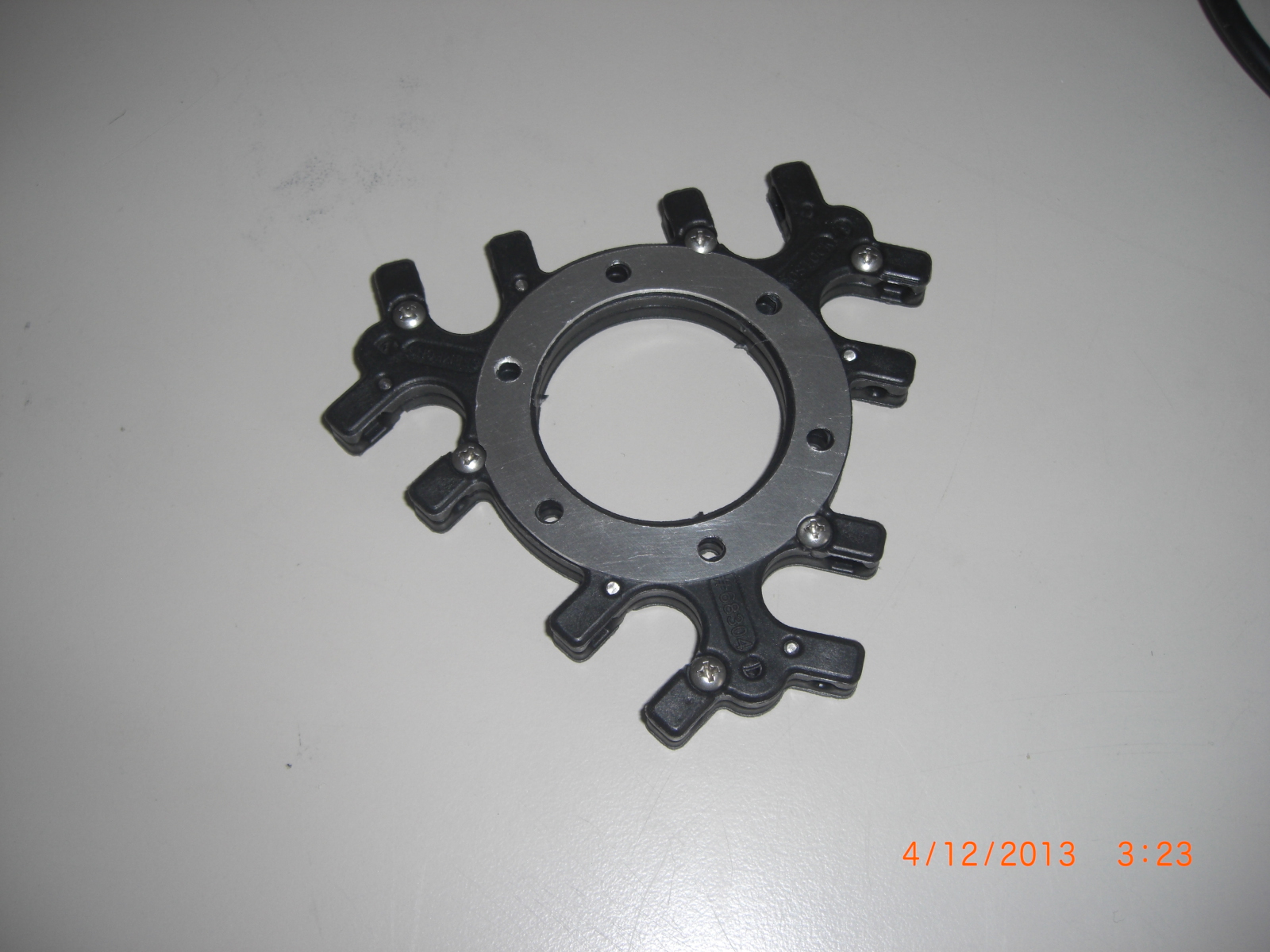

replacement arms arrived from china for testing
fit feels good, no play in the ball ends, balls feel a little tight but putting some lube on them should loosen them up more. these are metal so they are heavier. we'll see how they turn out. shipped from china took about a week not too bad. i had the seller customize these to 269mm lengths.
Those look great! Good to finally have something different to get away from all that sanding that never works the first time.
Have fun hooking those up and let us know how they work. Is that your son in the pictures?

led platform lighting finished
leds mounted using thermal adhesive epoxy, on my custom cut aluminum heat sink http://forum.seemecnc.com/viewtopic.php ... =260#p9718
50ohm pot wired along with 10ohm fixed resister, and on/off switch
how it looks on the platform all wired up. If I make another, it will be made of pcb material so the wiring and led will be integral part of mount.
powered up turned all the way down dim
powered up turned all the way up bright
IF ANYONE WANTS AN LED MOUNT LIKE THE ONE I MADE JUST SEND ME A PM, I DONT HAVE ANY STOCK TO MAKE THEM AT THE MOMENT BUT I'LL BE MORE THEN HAPPY TO GET SOME.
EDIT: I'M NOTICING A LOT OF FLICKERING WHEN THE RAMBO IS DOING ITS PID ROUTINE, SO I ORDERED A BETTER VOLTAGE AND CURRENT REGULATOR TO ELIMINATE THIS PROBLEM.
problem fixed, using this regulator below. no more flickering.
current and voltage regulator from ebay. http://www.ebay.com/itm/221200620645?ss ... 1497.l2649
simple setup, install and turn your led pot all the way bright, then adjust the voltage pot on the regulator till the flickering goes away. There's also a current adjustment if you need it.
