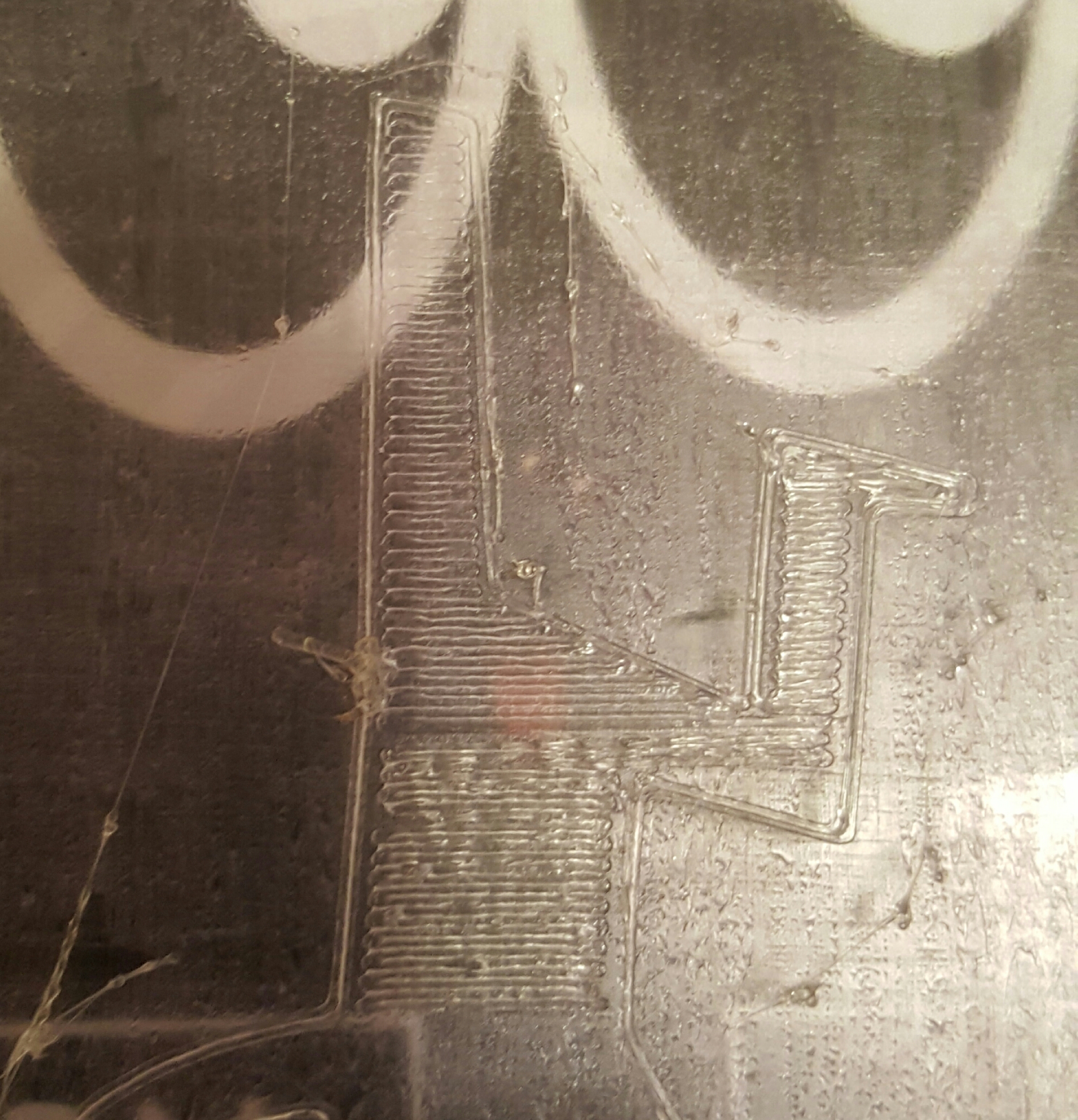

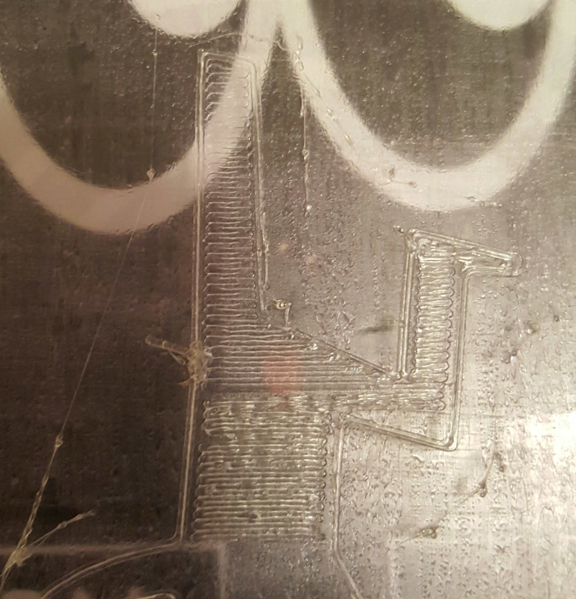

Ok, here's an update. I did the temperature calibrarion and the nozzle was off by almost 30 degrees Celsius. So I corrected that following the mentioned method. Then I did a test print with the same material and profiles as before. It came out better. First layer stuck well and everything. So I decided to go ahead and do the bed temp calibration as well. I got lucky, it was already pretty spot on, so I left it. Then I wanted to make sure my positional calibration was good so I went ahead and did that. I used a 0.038 mm feeler for Z-height and 0.203 mm for towers and center. Got that finished, re-glued, and started another test print. Same object. Results were terrible. The had filament wouldn't stick and when it finally did, I had the same infill problem. I feel like I'm back to square one... ugh
*I was trying to load pictures onto this post, but for some reason cannot. The attachments upload like they're going to work, but then they don't do shit. Not sure why. I've attached tons before. Anyway, suffice to say, I closed the gap between outline and infill in the improved model, and then it went to shit after the positional calibration, worse than before.*

Re: New Rostock Troubles

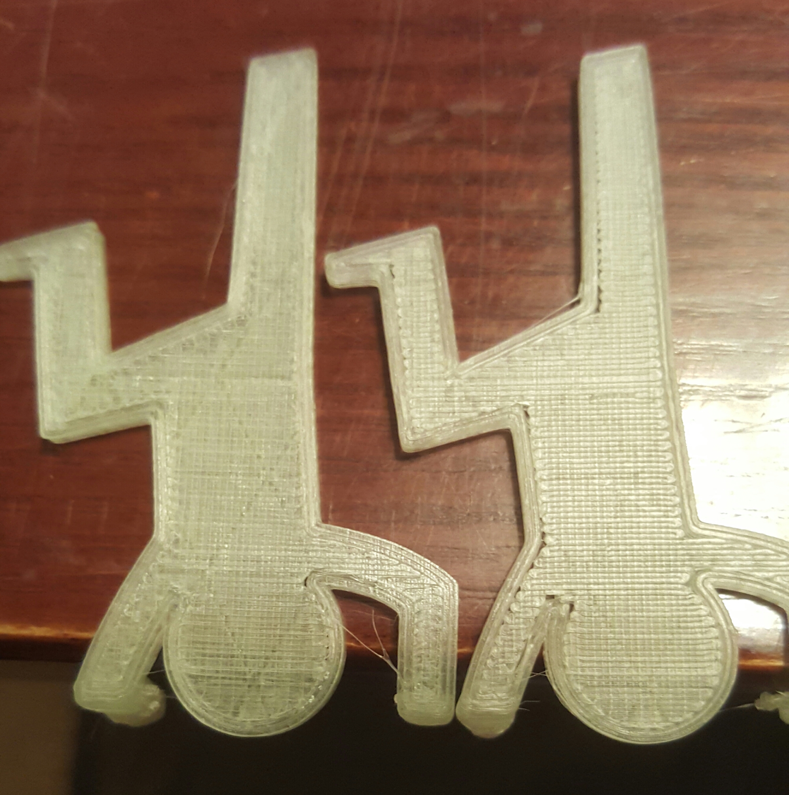

Ok, here are the pictures.
The first one shows the print before the temperature calibration on the right, and after on the left. The next picture is after the first one, but with a tower calibration in between. Since then, I have tried recalibrating, with no good results. I discovered my endstops were the tiniest bit loose, so I took care of that. Recalibration seemed like it would work because there was a noticable change. Alas, i get worse results akin to the second picture. This is ridiculously frustrating.
As a side note, I should mention how I do the calibration. I start at Z tower, do calibration until it's good on a 0.203 mm feeler gauge. Then I go around. After I do all three, I go back to Z and repeat until they all feel the same. Then I do bed center, make adjustments if necessary, and repeat. Is this correct?

I would chalk this up as potentially being a slicer setting issue. Do you mind posting your Gcode and possibly the STL?

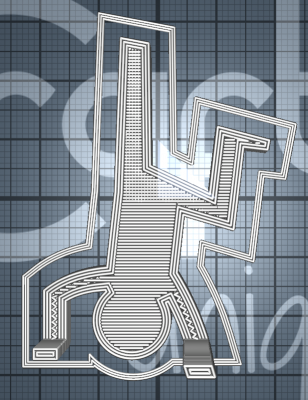

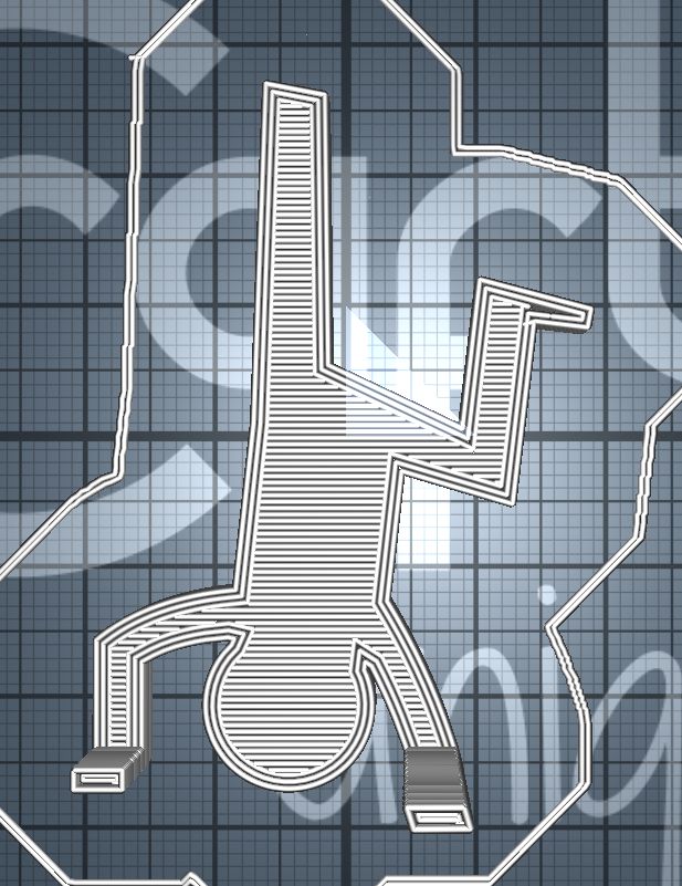

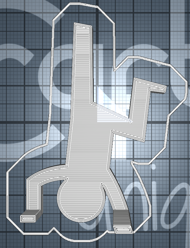

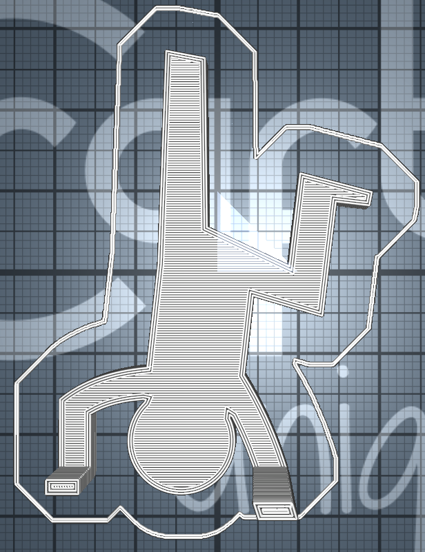

Ok, so here is what I mean by slicer settings...
The first below is your gcode file, unmodified, loaded into CraftWare for viewing.
The second is my file, but also take note that I am printing with a Prometheus V2 using a .3mm nozzle.
The third is a representation of printing with a stock .5mm nozzle using my CraftWare settings.
#1 #2 #3 The main thing that I notice is that your gaps seem to coincide with the small little gaps shown in the screenshot. You can click it to see the fullsize image. Any area that seems to show bed through it, will show bed on a real printer, simple as that.
Try printing the attached Gcode on your printer. I tend to run pretty conservative settings within the printer community, but CraftWare estimates your print to complete within 20 minutes.
The attached Gcode are set to print the first layer at a height of .2mm, at a speed of 10 mm/s and then 30 mm/s for the second layer and on, with a resolution of .2mm. Both are set to print at 230 because I usually only bump my prometheus to 240 to print with ABS. 230 to 210 is what I print PLA. If you don't like the temps, preheat your printer to whatever preferred temps you have found, and start the gcode from either the sdcard or your preferred printer host. Once the printer or host has engaged the Gcode and sets my preset temps, just go ahead and set them back to your preferred temps that you just preheated to. The print will continue at your temps and you will be able to try different temps to your satisfaction.
DISCLAIMER: IT IS NOT MY FAULT IF THIS GCODE HARMS YOUR PRINTER. I HAVE USED THESE SETTINGS RELIGIOUSLY ON MY PRINTER AND THEY HAVE WORKED FOR ME. PLEASE MAKE SURE YOU HAVE YOUR PRINTER CALIBRATED AND YOUR BED Z-HEIGHT PROPERLY SET.

This is a well known issue with slic3r. One way to deal with it if you are stuck with using it is to rotate the part so the sharp angled leg (in your case) is either parallel to or less angled than the perimeter. Many times just a 5 degree rotation will miraculously clean up those first layer blues.

So when doing a Z-calibration, it is important to note how you are doing it. Some people will manually lower their nozzle to the center of the bed with the LCD controller and set the Z=0 this way. This is truly the 0 point and should technically be where the nozzle is touching glass, because the slicer will offset the Z by however much your first layer height is. Most calibration routines which are run as scripts from this site for non-auto-calibrating machines, tend to calibrate JUST off the bed in order to slide a piece of paper in there. This is calibrating the Z=0 with a calculated offset. Either way is acceptable, as long as they are performed correctly.cyber.shifter wrote:This is very good information. It looks like your infill in a good bit closer to the perimeters, are you doing more overlap? I don't mind running conservative settings. I prefer quality to speed. I've been printing at 20 m/s per mhackney's recommendations in his guide, but I wouldn't have thought of rotating it to improve the gaps. So I guess my next step is going to be double-checking my calibration, and then trying that GCODE you sent me lightninjay. Did my calibration measures sound acceptable? I keep reading mixed signals about Z-height. Some people say as close to touching the glass as you can get, others say 0.1mm or something else. Not sure what is ideal. I've been doing 0.038mm for Z-height and 0.203mm for towers and center.
- cyber.shifter
- Posts: 95
- Joined: Sat Apr 18, 2015 8:02 pm
- Location: New Orleans, LA, USA
I've been setting the Z-height by using the controls on the machine, and the above mentioned feeler gauge. Would it be better to use that gauge and then offset the Z-height? The way I usually do it is following the Rostock manual, but using feeler gauges instead of paper.
