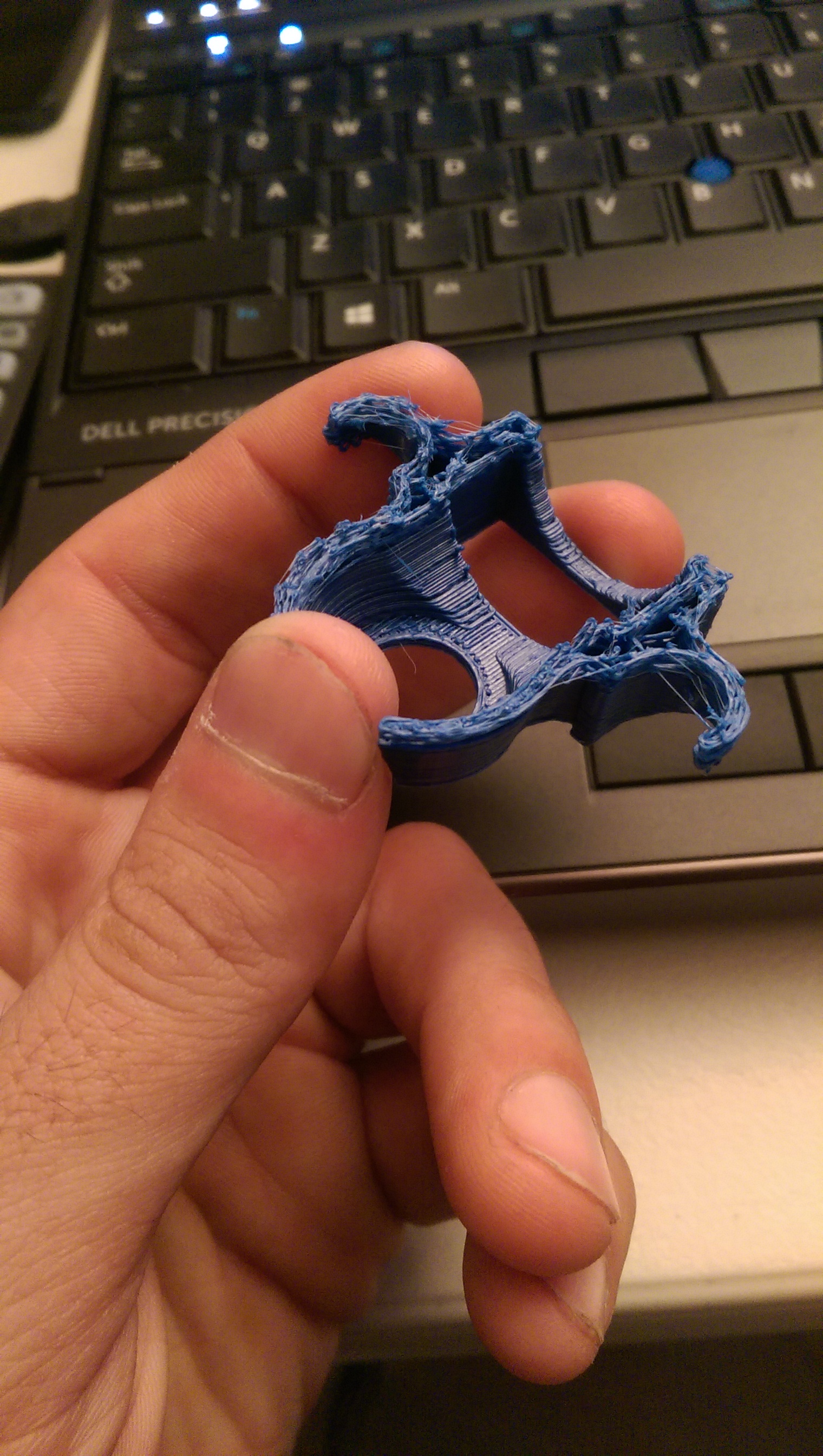

Ok. I was looking around for what could cause what I was experiencing, and I saw some things about calibration of the horizontal axis and z-stop calibration. However, I think it is an extruder problem. This is a picture of the print that I was working on last night when I had to stop it.
So I started looking at it again today and it seems like the extruder isn't pushing the filament down the bowden tube. I can sort of push it manually, but not really. This is at temperature (which MatterControl set to 228 for this ABS material). I'm not sure why it printing a good part of the part before it stopped working. Any thoughts?

I can check the nozzle. The first calibration pass did sound like it hit kinda hard. But then, how would it have print the first half of the object ok? I did see some slipping of the extruder, and when I pulled the filament out, it had wear marks showing it slipped. I'll be home in a couple hours and I'm going to try just running the calibration cube with a higher temp and see if that does it. Speaking of calibration, is there a better recommendation than the stock calibration method that I should know about? I saw some people tossing about scripts for calibrating, but wasn't sure how that worked.

The globs look like its too tight to the bed. Try backing off the bed a bit. Also would turn up the heat to at least 235C
If your using thin copy paper try this. See if it moves and then remove the paper and try to put it back under. If you can't get the paper back under the nozzle its too tight. It should be easy to put back under, but still have drag.

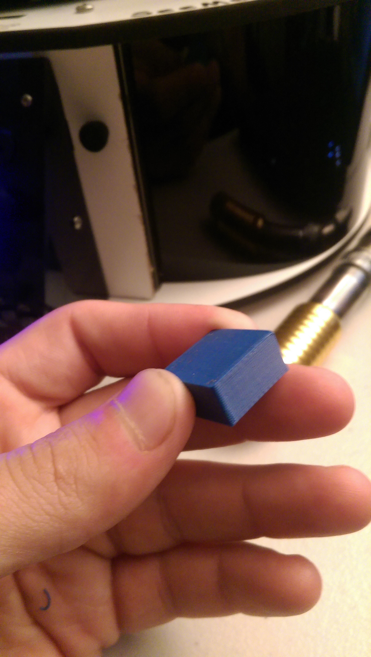

Got the nozzle cleared by heating it up. Used a single strand of the 18 gauge wire to do it. Also, reflashed the firmware and re-calibrated, this time with less "grab" on the paper. Finally, did a test print with the extruder temp set to 235 and got much better results.
It's only the calibration cube, but the layers look much better than before.

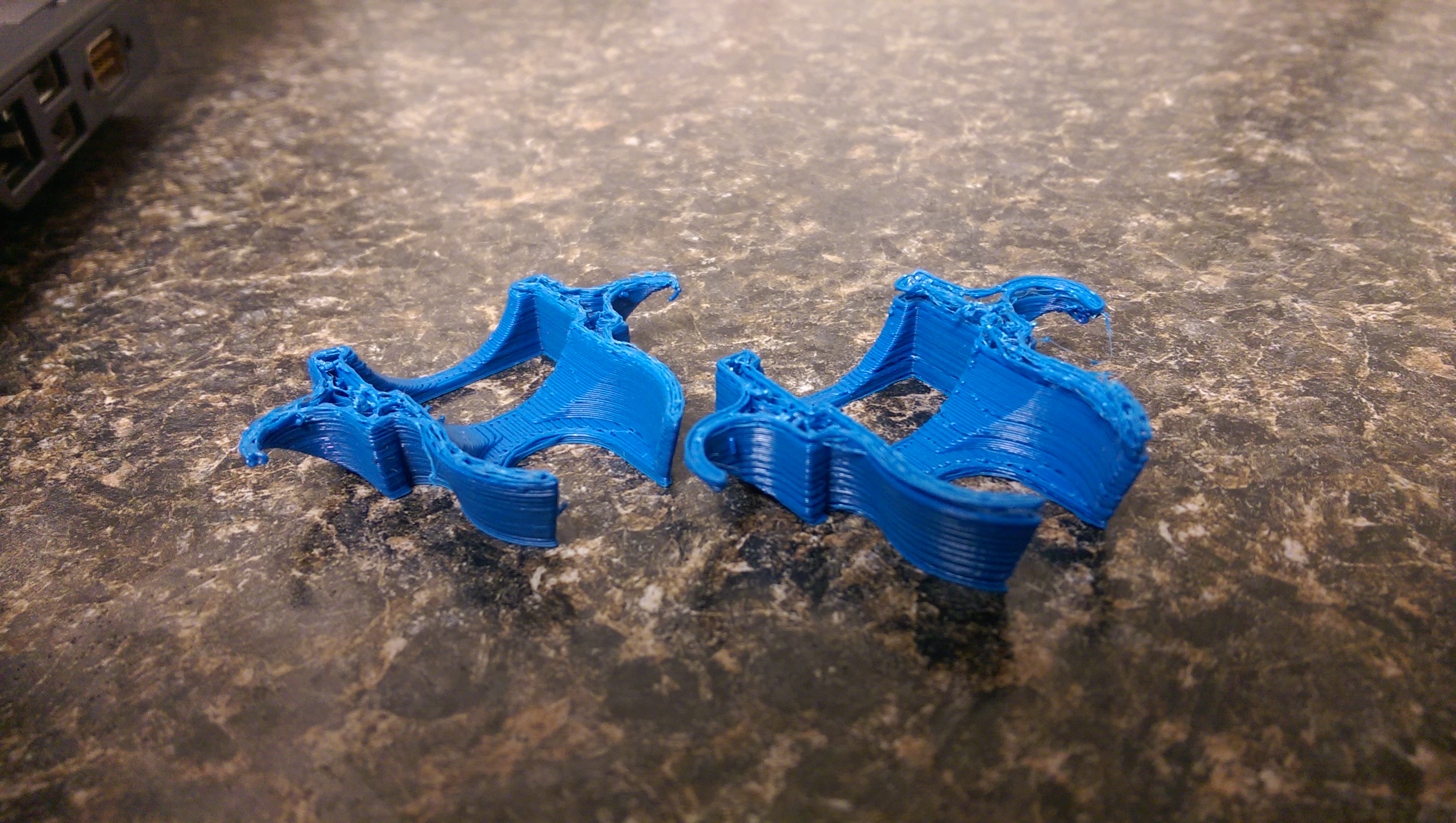

Still having trouble with printing. Second time I'm trying to print the PEEK fan shroud. I'm not sure what's going now.. The second time looks much better on the layers, but they both ran into the issue at almost the same layer.

My guess is that the hot end temp is too low.  It is just on the edge of being too low and eventually the hot end plugs.  I would try increasing the temp by 5 or 10 deg as an experiment.

I'm currently printing it at 235. If I up it to 240 that's getting close to my ceiling of 245. The only reason I get nervous is that I noticed that the one or two times I heated it to 240, it went up to 245 briefly before it settled down to 240. I'm just nervous about it overheating. Should I be worried about that?

telling ya you need a thermocouple for your multimeter... figure out what it is really doing.. your temp is too low if your nozzle is clogging. nevrer had a nozzle clog except 1 time with abs from not having my peek fan running and heat creep melted the abs up into the Bowden tube inside the peek/.

I did notice the two times that I unclogged it that I had melted ABS in the PEEK tube. However, the thermistor read that it was at the temperature that I wanted. If the thermistor is reading off, is there a way to correct for it in the firmware or something?
