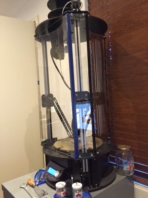

Found a local supplier of nutserts that were too big for the holes, but only just. Hot slipped those puppies in and they're tight enough for this application. Cut up my panels and screwed 'em in except for the front and I'm generally pleased.
Now I just have to connect the panels and seal. Our rubber supplier had nothing that would go 120º without looking like rubbish. Current plan is to print some little spacers that hold them straight - without the bowing they're doing at the moment - run some straight masking tape lines, goop up with black silly cone then pull the tape for neat edges. Should be ok I think.
Haven't sussed out the door hinge, seals or catch yet. Wondering if, given thin enough silicone beading, it would form a hinge for me. I doubt it.
Captain Starfish
Posts: 950
Re: Enclosure build to print ABS and Nylon bigger and faster
Post by Captain Starfish »
Done. Aside from anything else it's keeping the particulates under control a lot better - room is a lot less smelly when I print ABS hot. Which is nice.
Ended up buying a couple of caulking tubes of black silicone, masking the acrylic sheet with tape, running a nice thick bead between each pair of sheets and running down a scraper with the correct angle cut out of an old credit card. The hinge is just a length of gaffer tape on either side spaced out and stuck together between the sheets to form a flexible joiner. The catch at the moment is just a tag of gaffer tape. Rude and crude but it works fine.

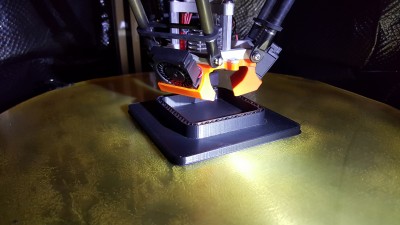

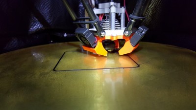

Sigh. Effector platform is smacking into the wall and skipping the steppers during the MatterControl 7 point calibration.
Captain Starfish wrote:Sigh. Effector platform is smacking into the wall and skipping the steppers during the MatterControl 7 point calibration.

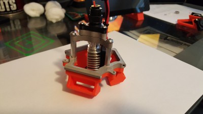

I've been designing my own enclosure, and I was worried about this happening... Thinking about working on a more compact effector, or at least one that doesn't have fans protruding as far.
What diameter would you say you can reach before hitting the wall?

I haven't built an enclosure yet but when I designed my layer fan Mount, I was trying to keep the fans as close to the effector as possible. This is what I came up with. I'm not really sure what radius I can get to. The only thing that will stop it right now are my towers. I can't go the edge of the platform without hitting the tower.

I'm still using the standard effector platform for the V1 loaded with an E3Dv6, layer fan free at the moment.
It wouldn't have been a problem using GeneB's calibration coordinates. It's not a problem using 3 point calibration in MatterControl. But the 7 point calibration takes the nozzle out pretty close to the edge which means a fair bit of overhang. I'm guessing but I reckon at least an inch overlap. It'd be ok if the triangle walls didn't come in past the edge of the circular base or top but, without vac forming round walls, that would be a monster of an enclosure.
Not just an issue for calibration, this will affect anyone trying to print right out to the edge of the bed too. It hauls your effective bed diameter down to about 230mm.
Might try and see if reducing the max radius on the printer settings fixes it. No spiffy spiral speakers for me without removing the enclosure, I guess.

Not to worry, dropping the bed diameter to 230mm got everything fitting where it needs to go and I very, very rarely need to print anything bigger than that.
