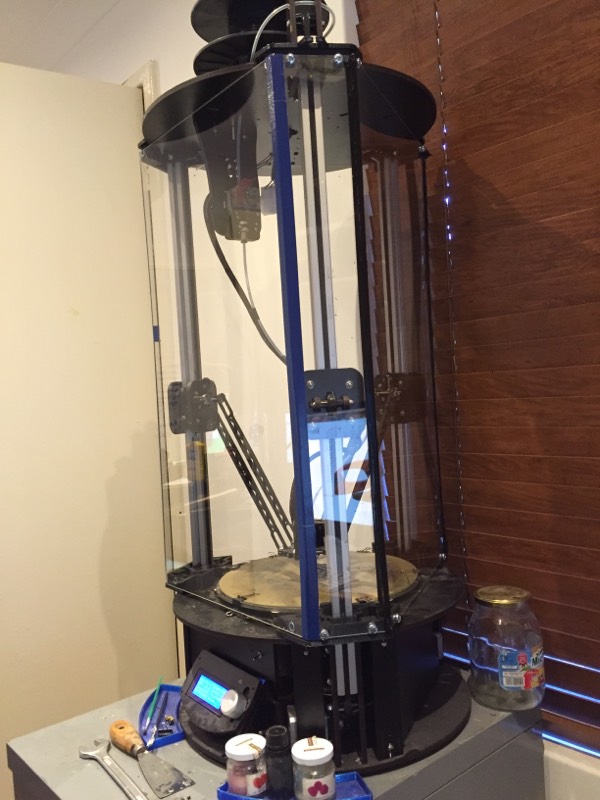

Good thinking, 99.Windshadow wrote:Could you epoxy them in the larger holes?Captain Starfish wrote:Those wedges went in really well. So well, in fact, that I snapped 'em trying to dig them out again to remove the plates. Ooops.
I should have checked the parts in a CAD package before just printing them too - no McMaster Carr here in Oz and I'm struggling to find inserts big enough for the holes in those prints. Most are at least a couple mm smaller on the outer diameter.

Re: Enclosure build to print ABS and Nylon bigger and faster
Geneb, ok, would you believe _this_ much?
Found a local supplier of nutserts that were too big for the holes, but only just. Hot slipped those puppies in and they're tight enough for this application. Cut up my panels and screwed 'em in except for the front and I'm generally pleased.
Now I just have to connect the panels and seal. Our rubber supplier had nothing that would go 120º without looking like rubbish. Current plan is to print some little spacers that hold them straight - without the bowing they're doing at the moment - run some straight masking tape lines, goop up with black silly cone then pull the tape for neat edges. Should be ok I think.
Haven't sussed out the door hinge, seals or catch yet. Wondering if, given thin enough silicone beading, it would form a hinge for me. I doubt it.
Done. Aside from anything else it's keeping the particulates under control a lot better - room is a lot less smelly when I print ABS hot. Which is nice.
Ended up buying a couple of caulking tubes of black silicone, masking the acrylic sheet with tape, running a nice thick bead between each pair of sheets and running down a scraper with the correct angle cut out of an old credit card. The hinge is just a length of gaffer tape on either side spaced out and stuck together between the sheets to form a flexible joiner. The catch at the moment is just a tag of gaffer tape. Rude and crude but it works fine.
Sigh. Effector platform is smacking into the wall and skipping the steppers during the MatterControl 7 point calibration.

I'm still using the standard effector platform for the V1 loaded with an E3Dv6, layer fan free at the moment.
It wouldn't have been a problem using GeneB's calibration coordinates. It's not a problem using 3 point calibration in MatterControl. But the 7 point calibration takes the nozzle out pretty close to the edge which means a fair bit of overhang. I'm guessing but I reckon at least an inch overlap. It'd be ok if the triangle walls didn't come in past the edge of the circular base or top but, without vac forming round walls, that would be a monster of an enclosure.
Not just an issue for calibration, this will affect anyone trying to print right out to the edge of the bed too. It hauls your effective bed diameter down to about 230mm.
Might try and see if reducing the max radius on the printer settings fixes it. No spiffy spiral speakers for me without removing the enclosure, I guess.

Ah, just use it as a former? Nice. If I was going to go down that road I'd make some battens, tape them to the printer top and bottom discs, lay the printer on its side, heat the sheet in the plastic and slump it that way. But it would take more plastic than I have and I ain't buying more now.
Not to worry, dropping the bed diameter to 230mm got everything fitting where it needs to go and I very, very rarely need to print anything bigger than that.

Ah yes. But then we go from "Oooh, I have some leftover acrylic sheet from building a CNC enclosure, let's print up a few brackets and enclose it" to major bucks for materials and subcontractor time. I don't care /that/ much.
My point is more a warning for anyone else looking to use this design: it's simple, it works well, BUT you will lose about 50mm of effective bed diameter.
