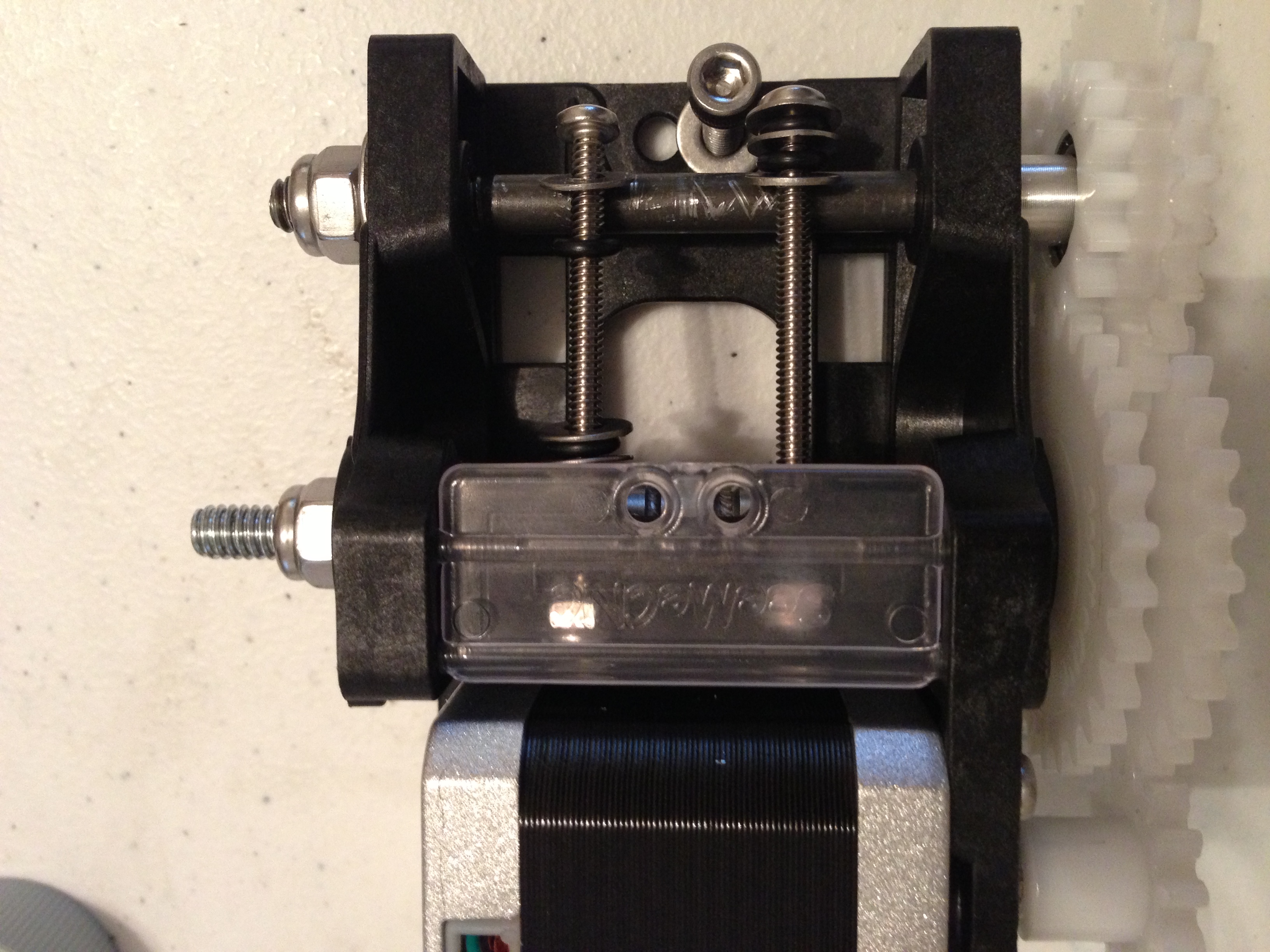

Extruder
This was one of my least favorite parts of the build. I cannot ever remember why I just know that looking at these pictures again makes me shudder. I know I did take it apart and reassemble several times. But my biggest issue was the set of bolts that was provided. One seemed to long and the other seemed to have been sitting at the bottom of the ocean. Anyway this part earned a trip to the hardware store to replace those items.
