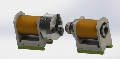

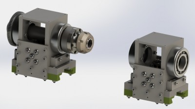

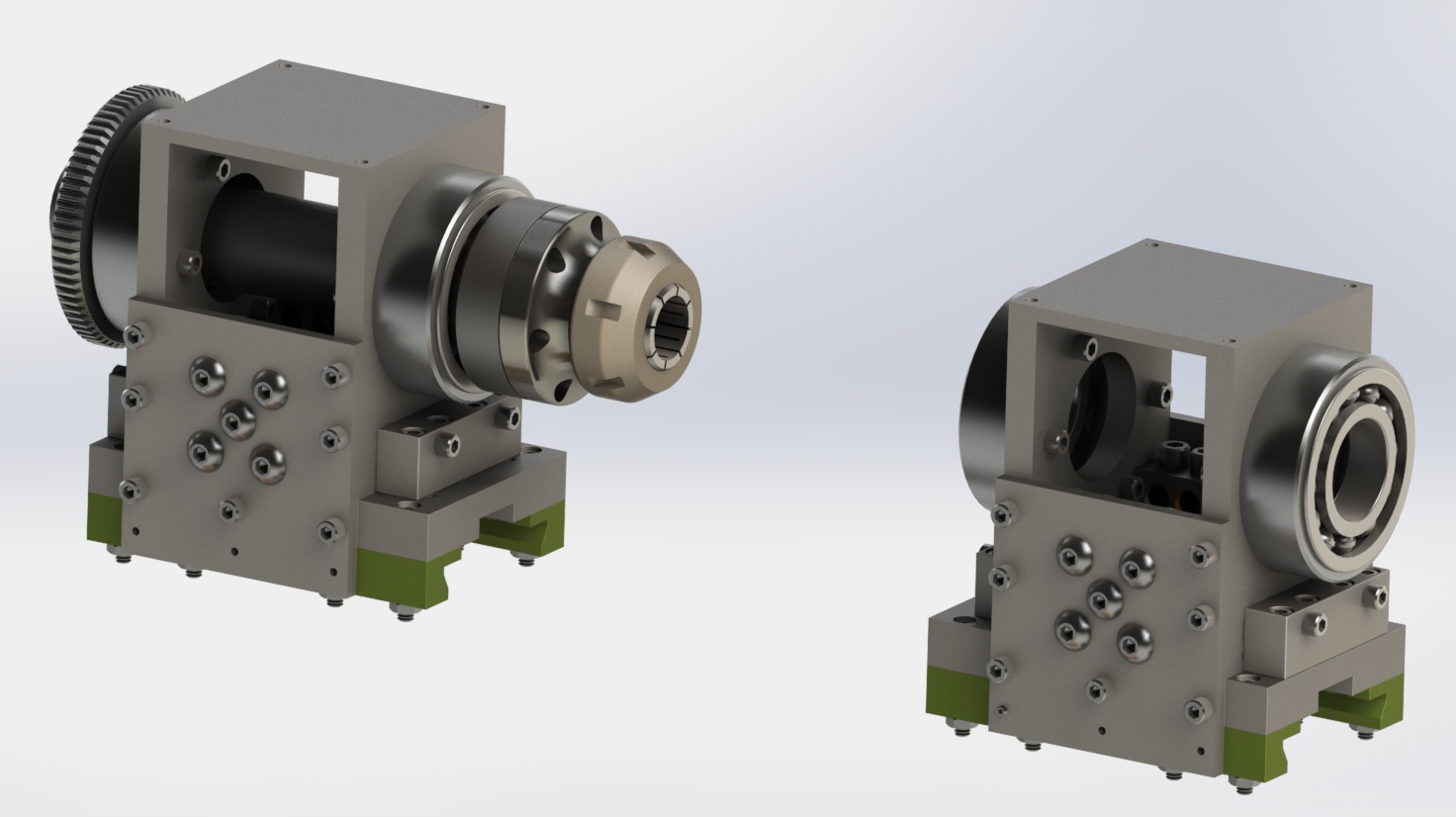

Yeah a couple of months ago when I started this it was more of a concept, something that I thought would be cool to do. In the last few weeks I've made some big design changes which I haven't shown here yet, but I know for certain that even meeting minimal goals will still be worth it. I knew from the beginning that this machine will never be as fast, powerful, rigid, or precise as full sized industrial turning centers. I'm just trying to get something that makes useable parts cheaply. I hope to learn along the way, and maybe even develop some new simple methods of doing things that actually work, like the printed leadscrew nut or the simple ball bearing limit switch. What gave me hope for this project is that my Sherline lathe can turn parts out of metal, and that machine has just about everything wrong with it from a mechanical and electrical design perspective. It won't take much to surpass it!
From what I've seen on the internet, the vast majority of DIY cnc machine builds are hobbyist routers and engravers, small machines that end up cutting wood, plastic, and maybe a bit of aluminum. People stick to tried and true methods (i.e ballscrews and linear ways) or try to go cheap with metal nuts on cheap threaded rods. For the electronics, they typically use Mach3 and steppers motors. Some go for servo motors.
I've always thought lathes are cooler than routers, and since our 3d printers are pretty good at making flat, simple, 3 axis router/mill type parts, I wanted to make something a little bit different. 3d printers simply cannot make precise round parts, and even the best metal sintering machines still leave rough surfaces. So I'm trying to introduce CNC lathes to the open source scene.
Onto the build....

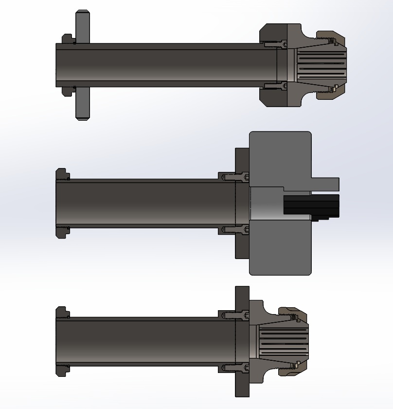

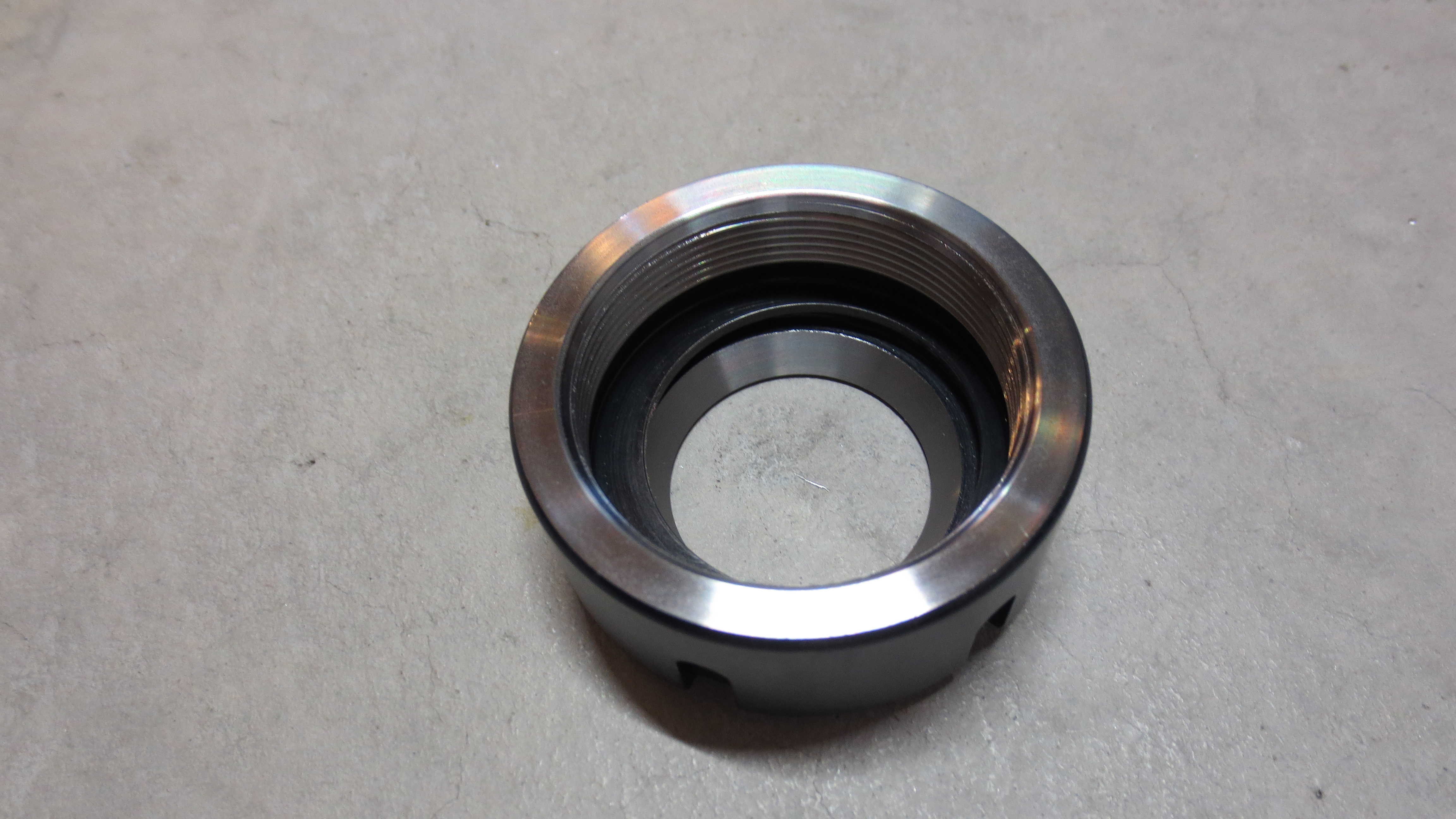

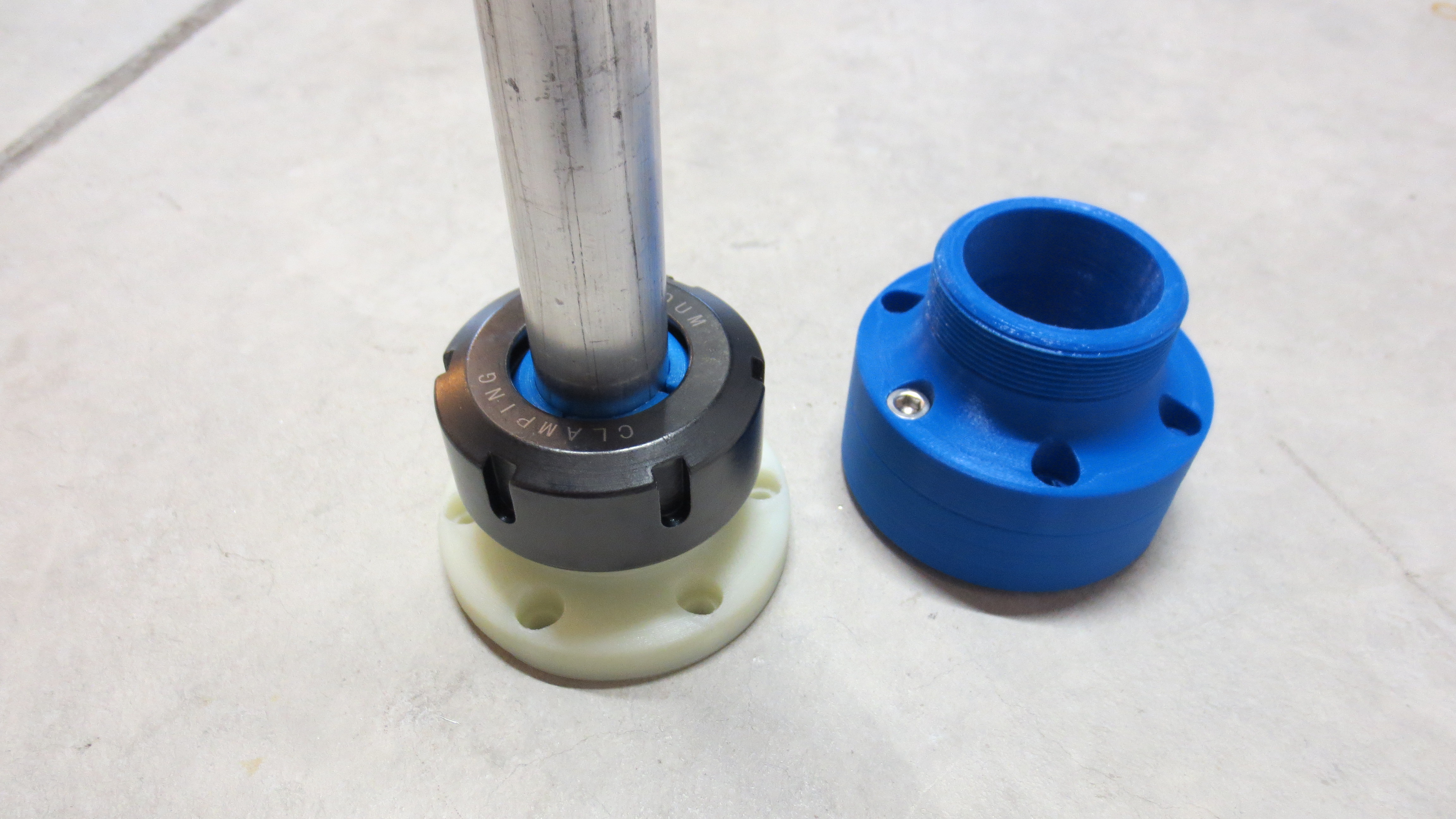

I got an ER-40 collet nut from Amazon. Now I can accurately model it and test fits. Surprisingly, it threaded on to my spindle adapter the first time smoothly with no problems!
This is what the collet nut looks like from the backside, notice the precision ground taper that contacts the collet. Also notice the eccentric groove to pull it out. Since I'm making this machine primarily from aluminum extrusions that I machine flat with a mini CNC mill, I'm going to have to rely on standard industry tooling to get precision. Everything can be adjusted by sliding it on a flat surface and bolting it down when it's in the right place. The collet adapter will work this way, it's the only way I can think of to get runout to a few ten thousandths without having access to a cylindrical grinder.

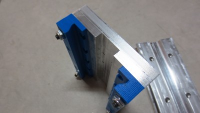

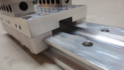

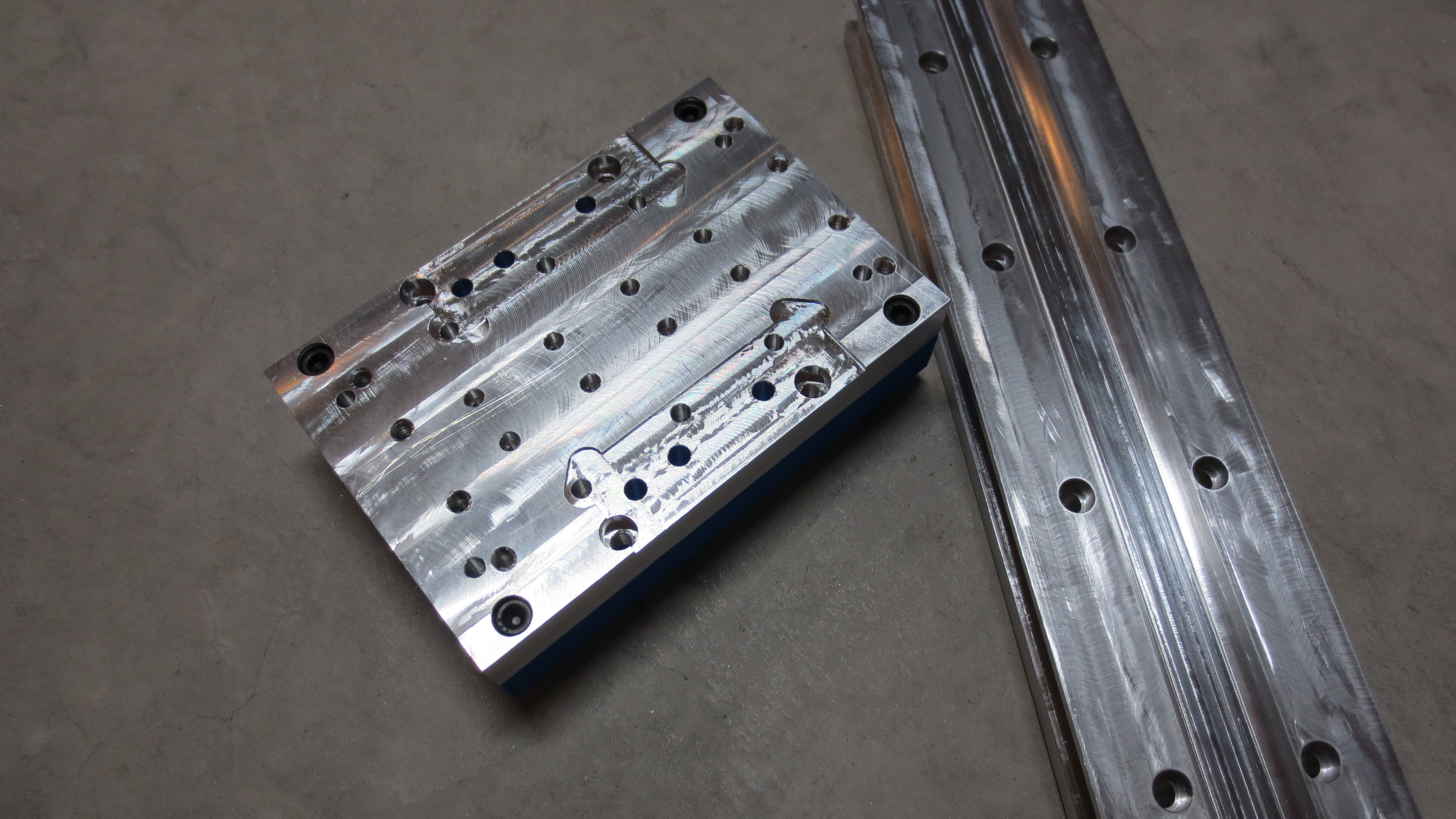

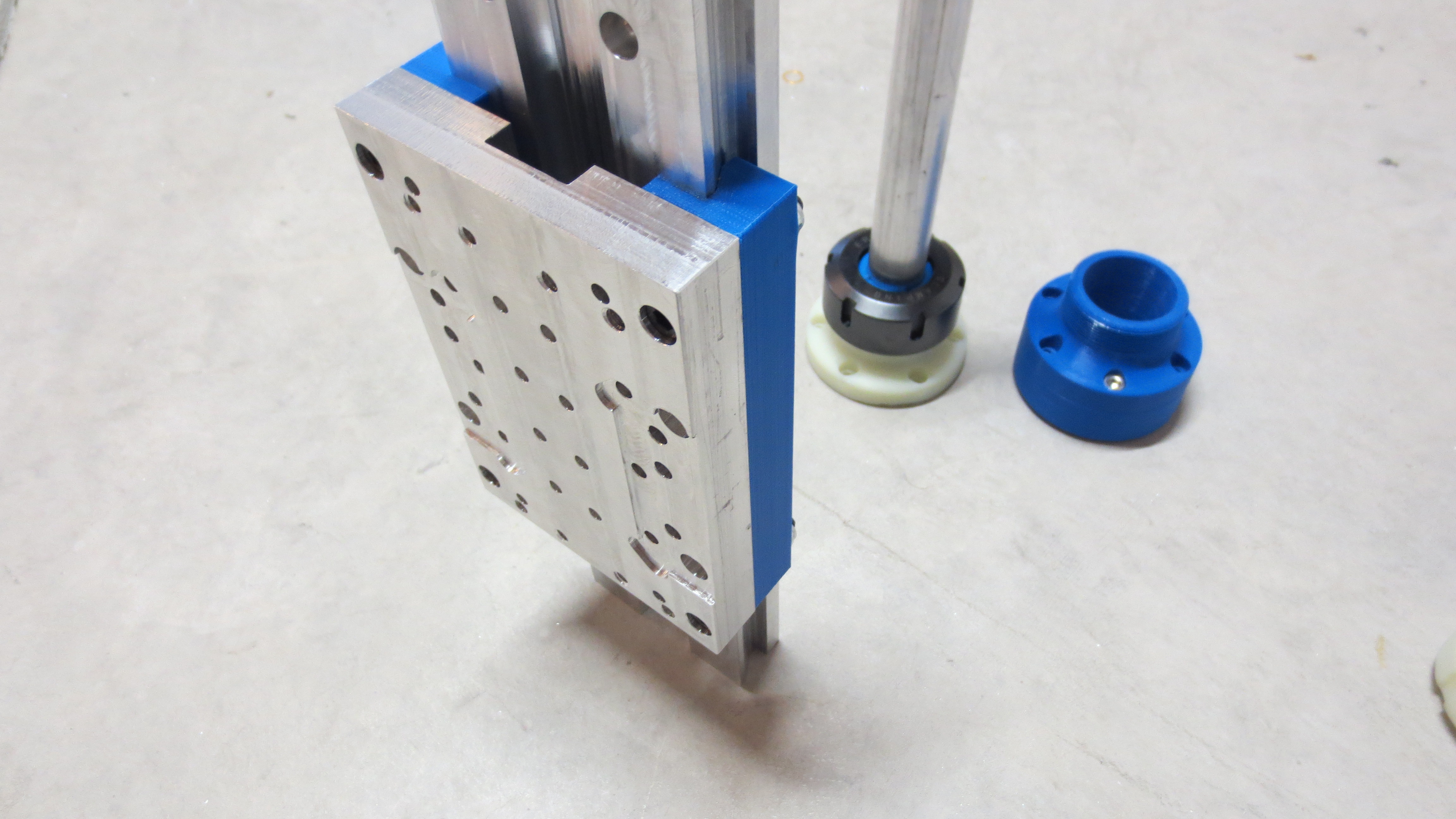

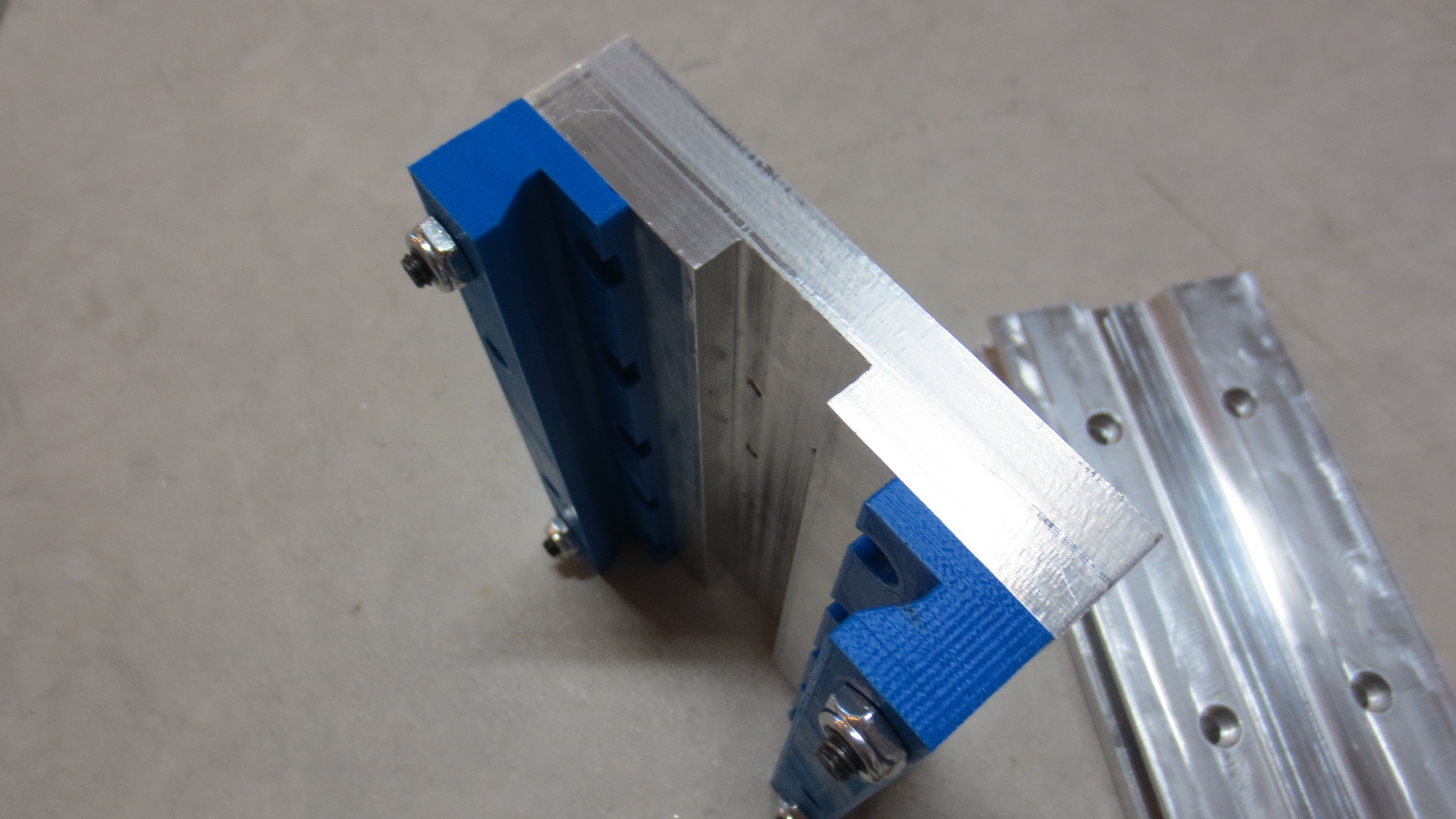

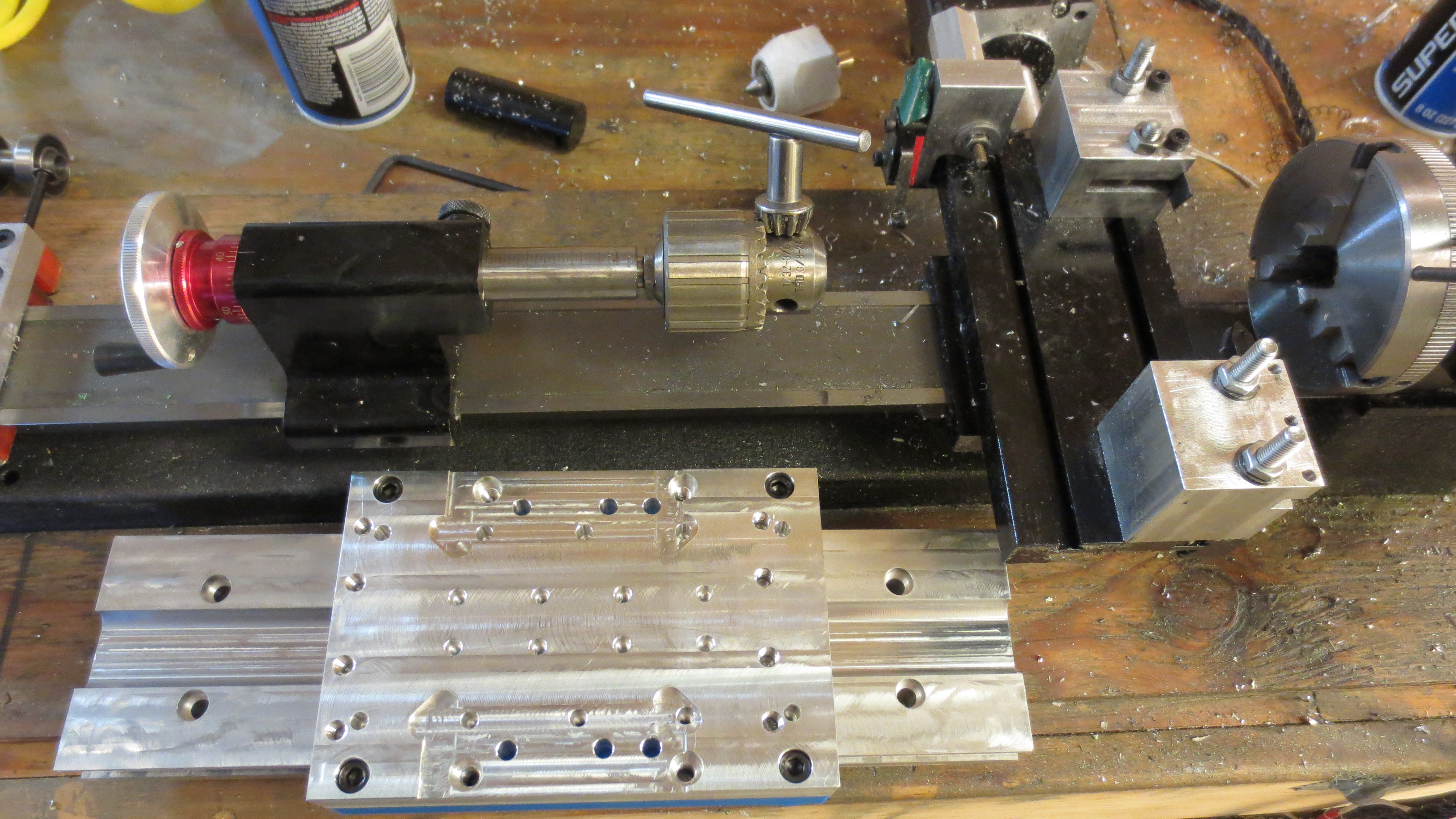

This is my design for the linear ways. The machine will have 5 linear axes in the end, only two of those are needed for basic turning operations. The other 3 add capabilities and automation. You can still do a lot with only 2.
It's a 1x3x12 flat bar of 6061 aluminum with 60 degree dovetails machined on the sides. All mating surfaces are milled flat to close tolerances.
The linear carriage that rides on it is 0.75x4x6 inches, also 6061 aluminum. Still milled flat on all mating surfaces. The two blocks of aluminum never contact each other, the carriage will ride on wear gibs. For now my wear gibs are plastic; I prototyped them with PLA but soon I'll machine them from solid acetal square bar. I'll also make some out of green Nyloil, an oil filled cast nylon 6/6 that supposedly has extremely low stick-slip and great wear resistance.
In comparison to the sherline lathe. My rail is huge and has a lot more area!

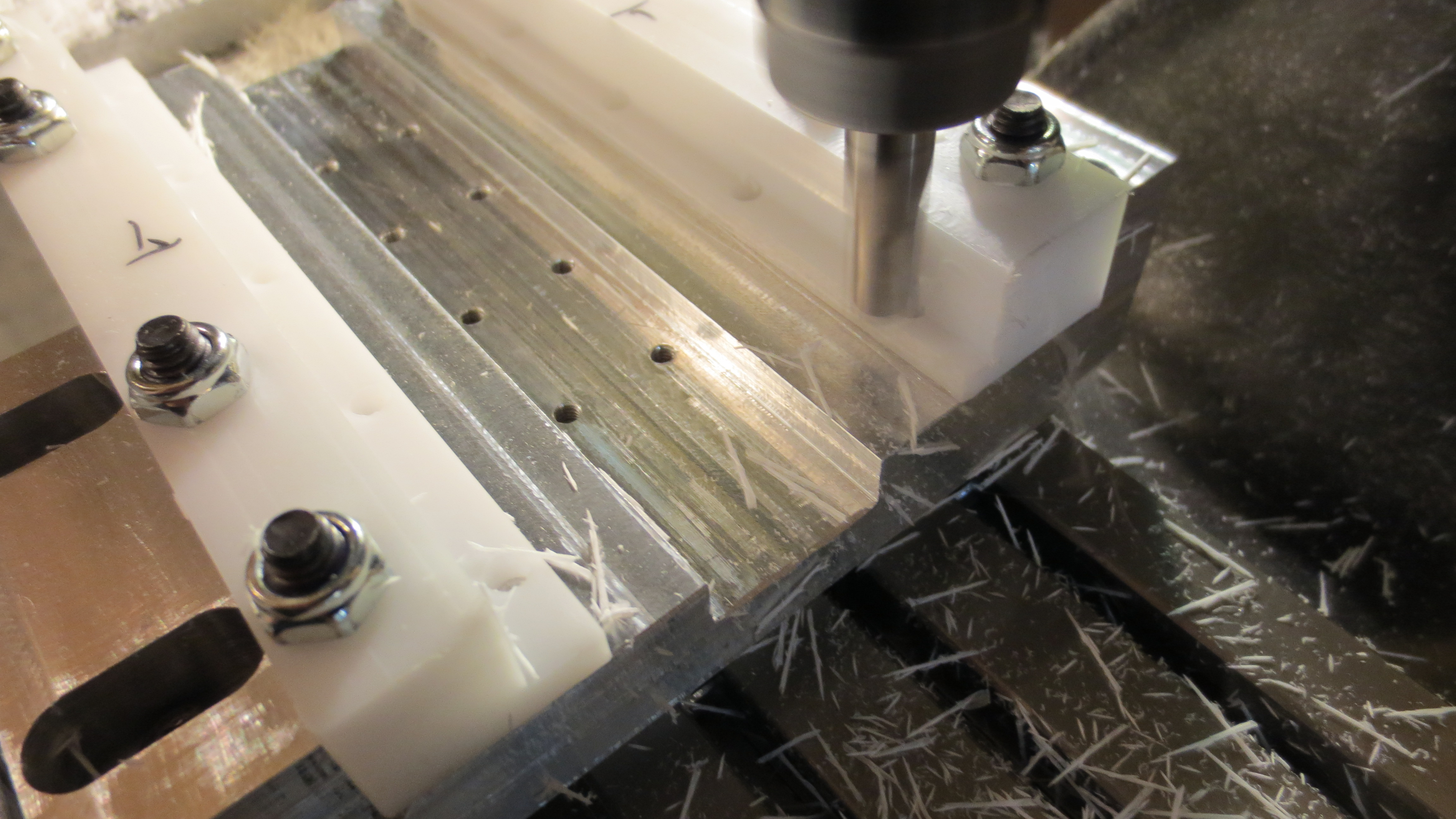

The reason for using polymer is to eliminate abrasion and wear between the sliding surfaces. It was pointed out in a previous post that aluminum is far too soft for a linear rail, which is true for metal-on-metal contact. But acetal or nylon on aluminum works fine! My main concern with using plastic is the lack of stiffness compared to metal; acetal wear plates/gibs have a modulus of about 3 GPa, whereas aluminum is 70, brass is 120, and steel is 200. So I had to keep my wear plate/gib design stiff with lots of metal reinforcement where possible. So long as the plastic stays in compression, stiffness should be fine. It's flexing that is unacceptable in machine design, not compression.
Ideally all of the sliding linear stuff would be make out of hard steel, or hard anodized aluminum, plated with boron-nickel and impinged with tungsten disulfide. An anodized aluminum surface is around 70 on the rockwell C scale, so it lasts pretty much forever if you keep out abrasive particles and keep the friction low. If I go to a metal/ceramet design in the future, the part geometry will stay the same and all of the differences will be in the surface materials/anodizing/plating/PVD coating. I'm just using plastic for now as a test, to see what I can get away with! I half expect it will fail and I'll probably end up using the metal stuff in the end unless this works exceptionally well.

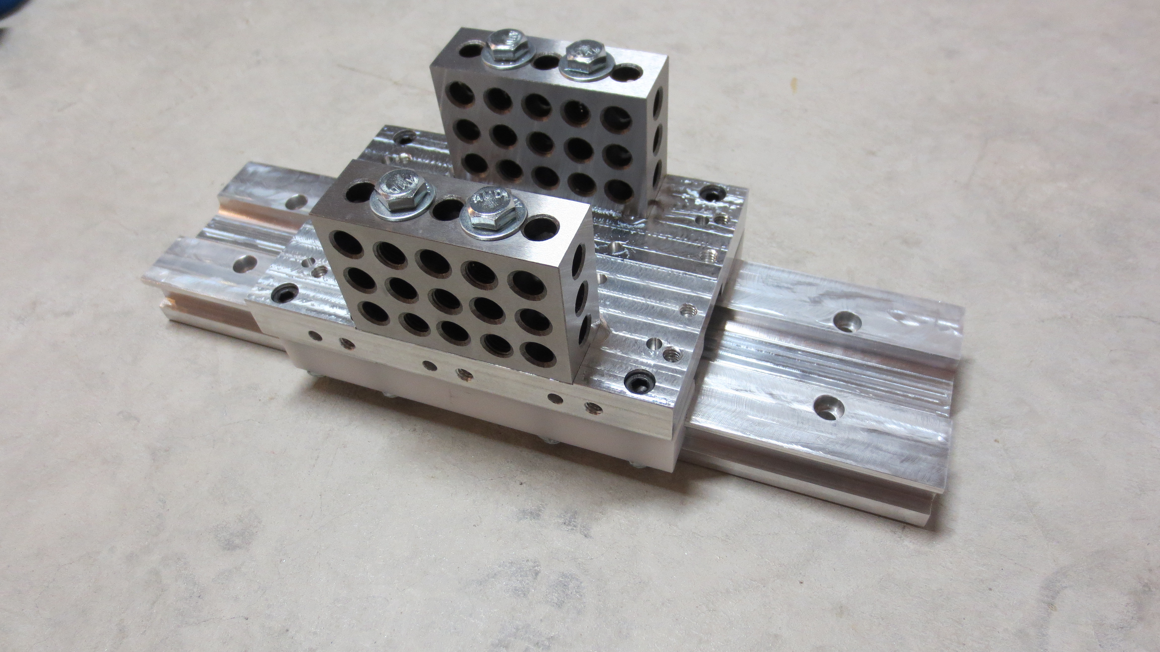

So far it seems promising, it is much stiffer than I expected using only 2 bolts on each gib instead of 4 and 5 screws on the bottom like I designed. I'll make the acetal parts today and fit them on with all of the fasteners. Both of the gibs are adjustable in the yaw axis of the headstock. The rest of the headstock has mating surfaces that will align one or both parallel with the linear doverail. The reference gib will be aligned then locked in place by tightening the nuts; the floating gib will be pressed against the opposing doverail with set screws, then locked in place as well. If it works out the way I expect, preload will be adjustable and the rails should will be extremely easy to adjust. We'll see how it goes!
Any questions/concerns about it? I fully understand that is method is pretty much unheard of in CNC machines. If it fails I'll go back to the norm of steel rails and ways with oil lubrication and a predictable service life.

Consider using this for your contact gibs and anywhere that wear of the soft AL might become a concern I helped a friend rebuild a Monarch 10EE toolroom lathe back in the late 90s and it is still working like new it is even easier to hold work to a ten thousandth on it than on a new Hardinge tool room lathe he also had

Thanks for the suggestion Windshadow! I never knew that Moglice stuff existed, and the examples on their page are very convincing to me. A resin like that is exactly what I need for some of the parts of this machine!
It's a resin, so it's much stiffer than most thermoplastics. I could make a few master molds out of aluminum and pins, then mold the wear gibs and drive nuts. It would eliminate machining and printing, plus it would be fast and easy to do. They say the parts don't warp or distort, which is necessary for precision linear motion.
I'll try resin casting some parts in the future and I'll let you know how it goes.

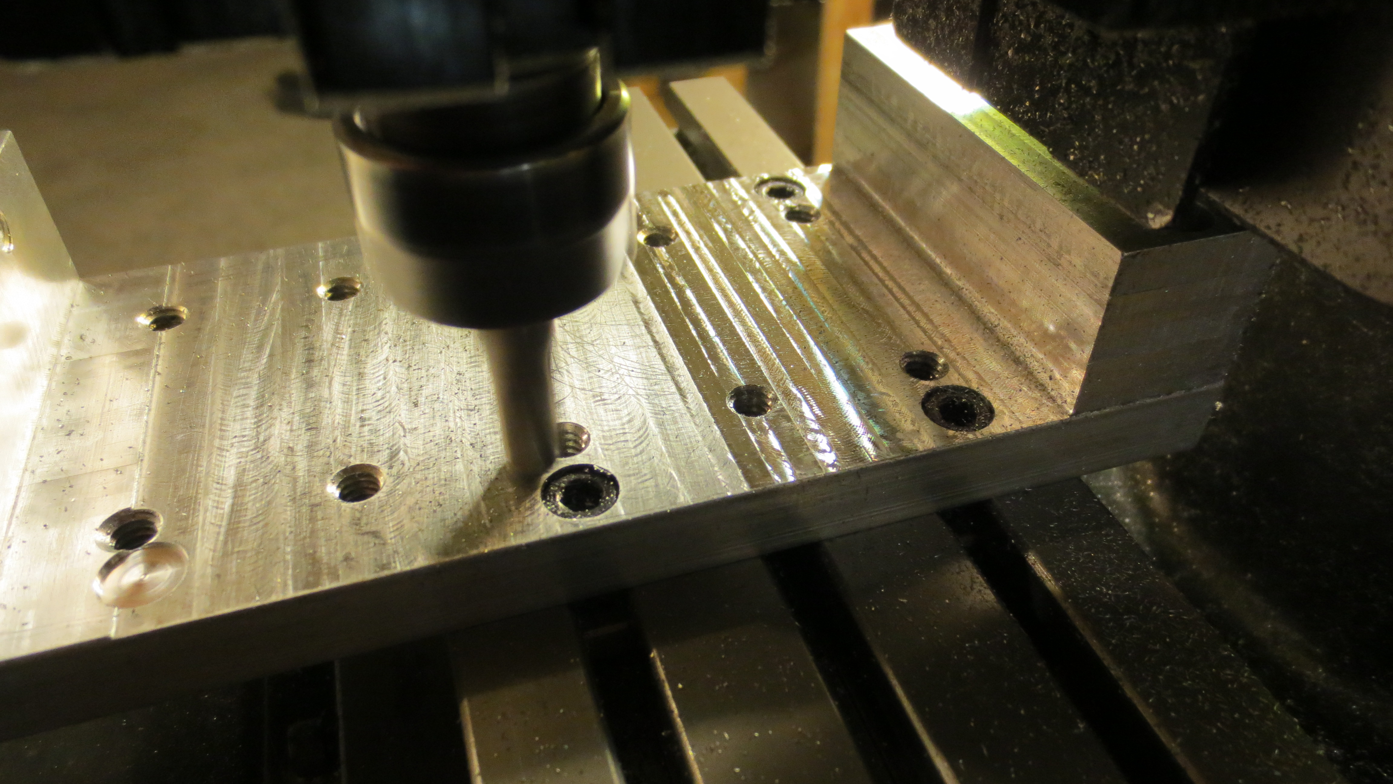

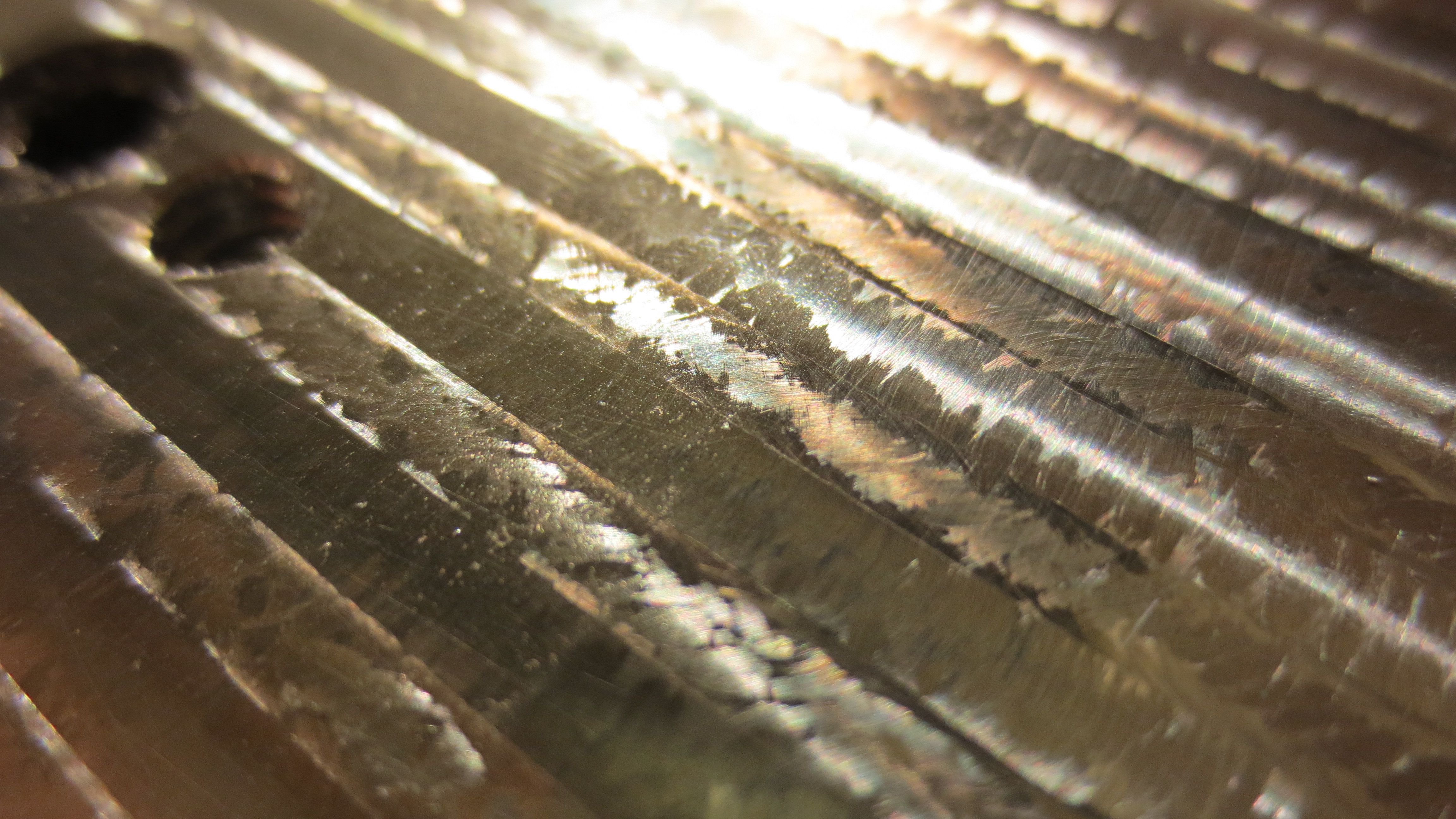

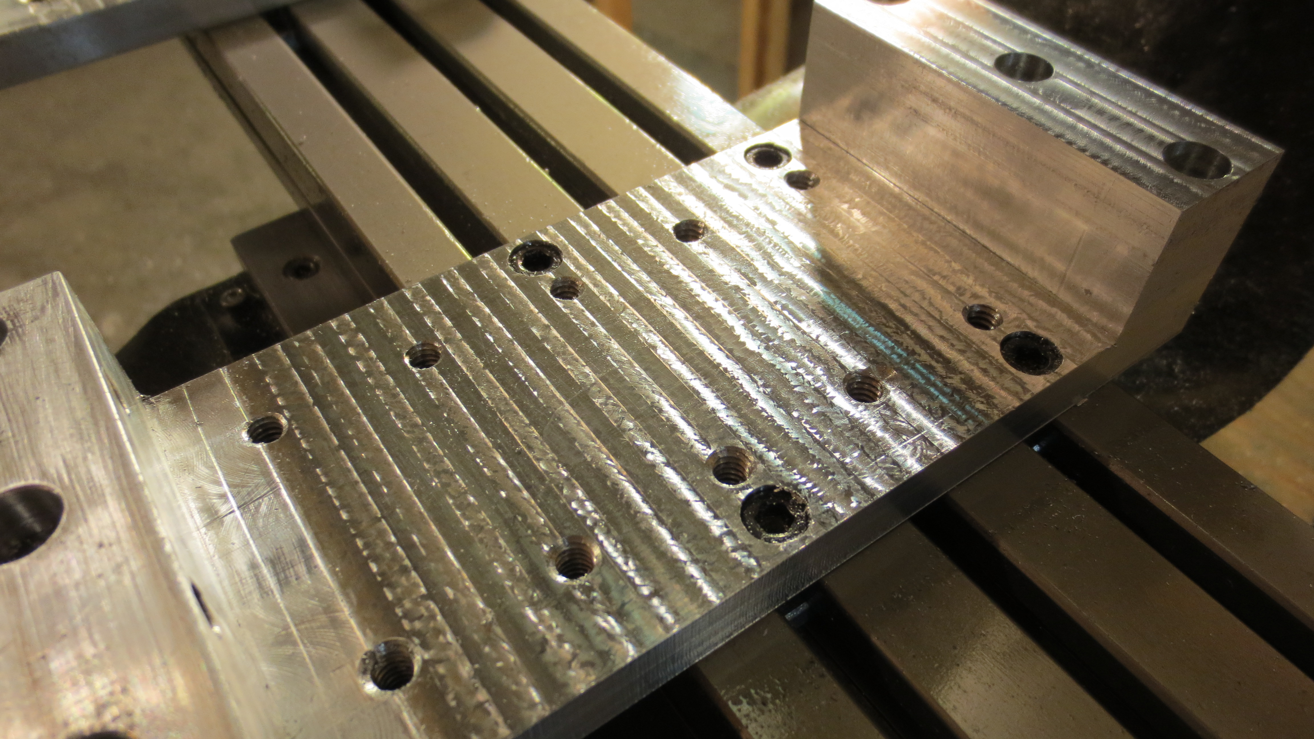

On a separate note, I messed up big time on my precision machining. There were two things I did wrong that have caused inaccuracy in my bigger linear motion parts.
1) I didn't pound the aluminum flat bars down against the parallels in my vises when machining
2) I didn't account for thermal expansion of the spindle when machining my mill vises in situ.
The first problem was a result of the second one. When I machined my mill vises, I started the spindle then immediately began face milling the vises flat. The idea was that by machining both vises in their final positions on the mill bed, all of the alignment problems could be avoided....and they were, in the X/Y plane. However the thermal expansion of the spindle during machining caused the surfaces that were machined last to be a few thousandths of an inch LOWER on the mill bed than the surfaces that were machined first. My raster type facing program made a zig-zagging staircase surface on the vises, so the vises were low on the Y- side of the machine, thus causing non-flat surfaces on all subsequent parts. Which is why they didn't sit flat on the parallels and I needed to pound them down.
So my new procedure for ultra flat surfaces will involve running the spindle for ~10 minutes before facing big flat bars of aluminum so that the spindle reaches equilibrium temperature before the program starts, rather than thermally expanding while the surface is being cut.
I re-faced my vises last night after running the spindle for a while, then I checked with a digital indicator to make sure they were flat. Good to within 0.0005" across the mill table now, which is the limit of my indicator.
I guess I had to learn this metrology lesson the hard way. I'll have to re-face both the linear doveway and the carriage plate to fix what I did wrong the first time.
First pass of re-surfacing. Notice how the shinier surface is on the Y+ side of the vise, the cutoff is the change in Z from thermal expansion. After re-surfacing for flatness. Close up of the finished vise surface. The tool marks are in the micron range I believe, you can see rainbows of light wavelength up close (naked eye).

Also, I finally finished making my acetal wear gibs for the first rail. It will be the first headstock rail. It is by far the most smooth linear motion I've ever felt, and I've worked with quite a few types. There is no grainyness or vibration or noise whatsoever. There is no stick slip either, and I noticed that even after I cleaned and degreased the surfaces, the sliding carriage has a velocity dependent friction force to it. So pushing very lightly will slide it at an incredibly slow rate, but pushing proportionally harder does not make the rail move proportionally faster. It's like a greased slide in that sense, and this is with significant preload. No wiggling or clicking at all, the whole assembly feels like a solid piece of steel as far as rigidity goes.
To check friction, I adjusted the preload until the gibs were in contact with the rail along their full lengths and checked to make sure no forces or torques caused wiggling. I tilted the rail at an angle until the carriage started to slide on it. It was an 8 degree angle, which corresponds to a coefficient of friction of around 0.14. When a force is pushing down on the carriage, the doveway top face takes the force at a 90 degree angle. When something pushes up on the carriage, the 60 degree dovetail angles take the force, which effectively doubles the friction force. So once the carriage has a spindle on it and a workpiece is being cut, it's better to cut down than up. I may change the design to boxways to get around this, although it probably won't be a problem in practice.
Yes, I used 123 blocks as an integral part of the machine headstock. I figured it's the only way I'll be able to align the spindle bearings coplanar to the tolerances I need. Plus they're rigid and stuff.

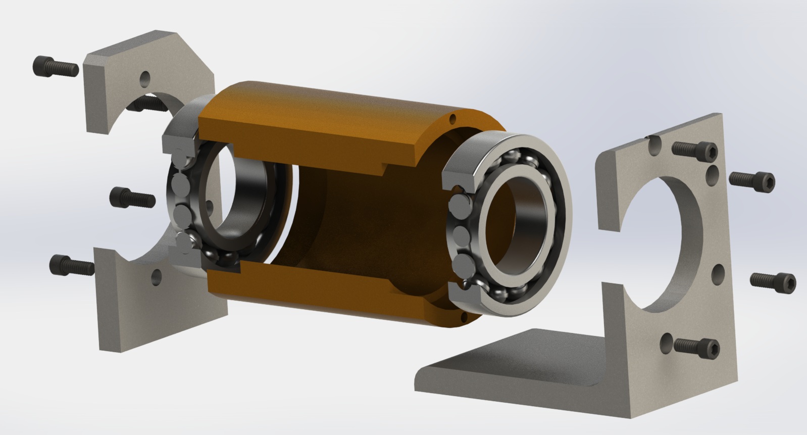

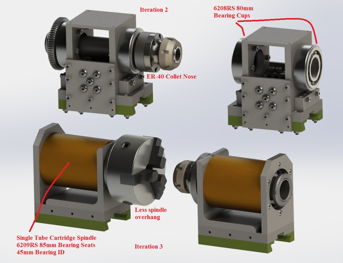

OK so a few design changes that I need to bring up here. I know I haven't shown the full machine yet, but I will soon enough. For now, I need your advice on the headstock and spindle designs. For the next few months I will have access to a full sized CNC lathe, so I can do full sized parts with THREADS and stuff!
In a nutshell, my latest (iteration 3) headstock is made of 4 main parts. The base, a 90 degree aluminum angle bar, a half inch flat plate, and a large 3.5" OD tube with wall thickness of half an inch. The tube is the orange part. It will be made in a single chucking on a CNC lathe. The OD will be turned, the face will be faced, then two bearing seats will be bored with an inside grooving tool (at least, all this is the plan). Then it will be parted off. My idea is that by making the entire thing in one clamping operation, all of the mating faces will be very perpendicular and precise. It's an aluminum tube so I plan on installing the precision bearings by heating the aluminum and exploiting the thermal expansion difference. The tube is 5 inches long.
The new iteration 3 headstock is a lot more simple and easy to machine and assemble compared to iteration 2. It should also be much more rigid and strong since it has so few pieces. Iteration 2 had two separate bearing seats, each of which would be positioned on the XY plane of the headstock, then locked in place with bolts. The bearings would be seated with thermal expansion in an aluminum tube.
Iteration 3 of the spindle will be machined in 1 piece from a foot of 2.25" 513 DOM steel tube. The spindle tube is only about 7 inches long, so it will be turned between centers then parted off. The bearing surfaces must be quite accurate, Iteration 2 of the spindle had a 40mm bearing tube fit, iteration 3 fits in 45mm bearings. Iteration 3 has a much larger face on the front, which has bolt holes in it so the faceplate that the chuck/ER collet nose bolts to has a way to take force or torque in any direction without coming loose.
Iteration 3 only has 0.125" wall thickness between the bearing ID and the inside of the tube. It has a bigger capacity for bar, though. Iteration 3 can fit 1.5 inch bar stock while iteration 2 can only fit 1.125 bar stock.
I am mainly concerned with overall system rigidity and strength, specifically the wall thickness of the spindle tube in iteration 3 being only 0.125 inch. Is this enough? I don't want it to fatigue or bend, but the forces on it will always be fairly low. I figure a 1.75 inch steel tube should not break.
In the machine assembly, iteration 3 headstock and spindle looks significantly more rigid and strong, it also has a cleaner, smoother look to it and fewer parts. There appears to be less overhang, so the work is being held closer to the bearings.
Give me feedback and questions please!
