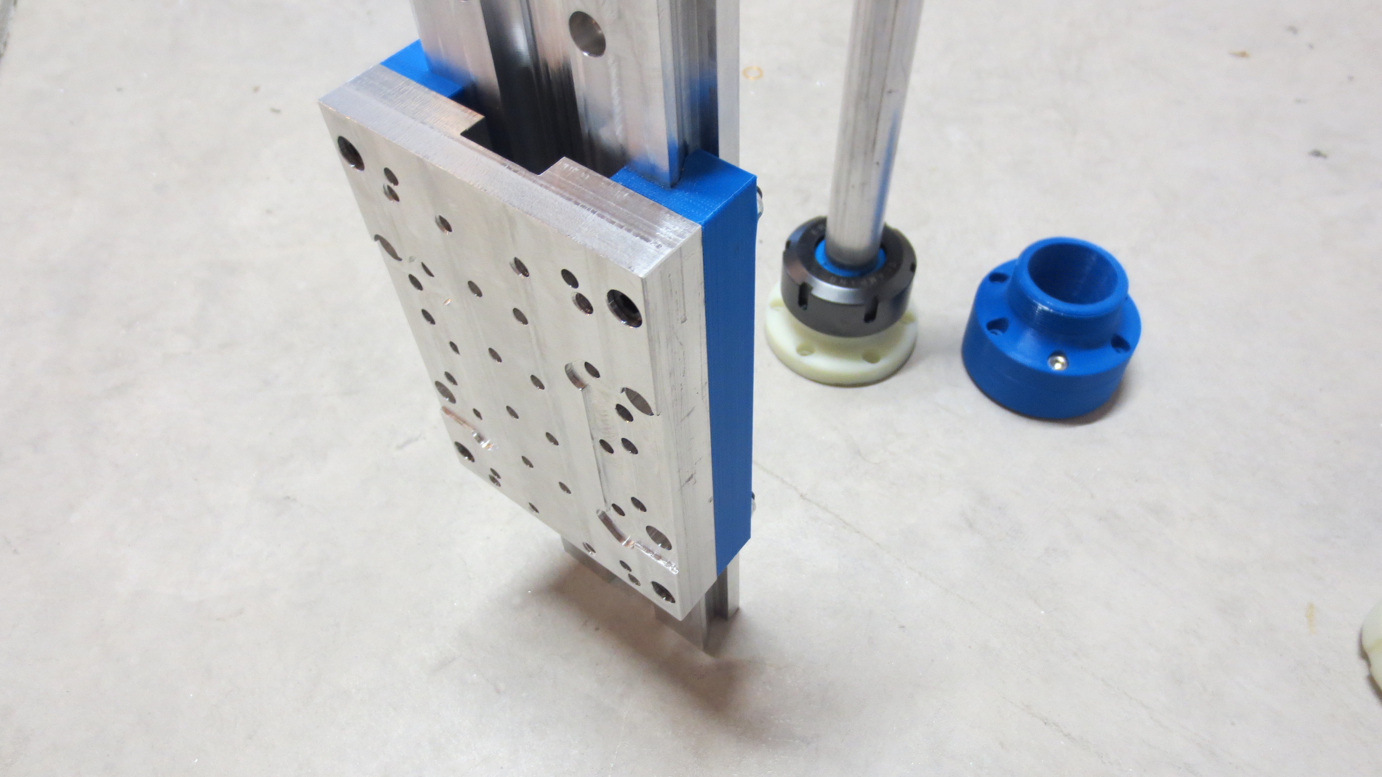

This is my design for the linear ways. The machine will have 5 linear axes in the end, only two of those are needed for basic turning operations. The other 3 add capabilities and automation. You can still do a lot with only 2.
It's a 1x3x12 flat bar of 6061 aluminum with 60 degree dovetails machined on the sides. All mating surfaces are milled flat to close tolerances.
The linear carriage that rides on it is 0.75x4x6 inches, also 6061 aluminum. Still milled flat on all mating surfaces. The two blocks of aluminum never contact each other, the carriage will ride on wear gibs. For now my wear gibs are plastic; I prototyped them with PLA but soon I'll machine them from solid acetal square bar. I'll also make some out of green Nyloil, an oil filled cast nylon 6/6 that supposedly has extremely low stick-slip and great wear resistance.
In comparison to the sherline lathe. My rail is huge and has a lot more area!
The reason for using polymer is to eliminate abrasion and wear between the sliding surfaces. It was pointed out in a previous post that aluminum is far too soft for a linear rail, which is true for metal-on-metal contact. But acetal or nylon on aluminum works fine! My main concern with using plastic is the lack of stiffness compared to metal; acetal wear plates/gibs have a modulus of about 3 GPa, whereas aluminum is 70, brass is 120, and steel is 200. So I had to keep my wear plate/gib design stiff with lots of metal reinforcement where possible. So long as the plastic stays in compression, stiffness should be fine. It's flexing that is unacceptable in machine design, not compression.
Ideally all of the sliding linear stuff would be make out of hard steel, or hard anodized aluminum, plated with boron-nickel and impinged with tungsten disulfide. An anodized aluminum surface is around 70 on the rockwell C scale, so it lasts pretty much forever if you keep out abrasive particles and keep the friction low. If I go to a metal/ceramet design in the future, the part geometry will stay the same and all of the differences will be in the surface materials/anodizing/plating/PVD coating. I'm just using plastic for now as a test, to see what I can get away with! I half expect it will fail and I'll probably end up using the metal stuff in the end unless this works exceptionally well.
So far it seems promising, it is much stiffer than I expected using only 2 bolts on each gib instead of 4 and 5 screws on the bottom like I designed. I'll make the acetal parts today and fit them on with all of the fasteners. Both of the gibs are adjustable in the yaw axis of the headstock. The rest of the headstock has mating surfaces that will align one or both parallel with the linear doverail. The reference gib will be aligned then locked in place by tightening the nuts; the floating gib will be pressed against the opposing doverail with set screws, then locked in place as well. If it works out the way I expect, preload will be adjustable and the rails should will be extremely easy to adjust. We'll see how it goes!
Any questions/concerns about it? I fully understand that is method is pretty much unheard of in CNC machines. If it fails I'll go back to the norm of steel rails and ways with oil lubrication and a predictable service life.

Consider using this for your contact gibs and anywhere that wear of the soft AL might become a concern I helped a friend rebuild a Monarch 10EE toolroom lathe back in the late 90s and it is still working like new it is even easier to hold work to a ten thousandth on it than on a new Hardinge tool room lathe he also had

Thanks for the suggestion Windshadow! I never knew that Moglice stuff existed, and the examples on their page are very convincing to me. A resin like that is exactly what I need for some of the parts of this machine!
It's a resin, so it's much stiffer than most thermoplastics. I could make a few master molds out of aluminum and pins, then mold the wear gibs and drive nuts. It would eliminate machining and printing, plus it would be fast and easy to do. They say the parts don't warp or distort, which is necessary for precision linear motion.
I'll try resin casting some parts in the future and I'll let you know how it goes.

On the Taig mill, the motor turns the spindle with a belt. Most of the spindle heat is generated by preload friction instead of load friction so the temperature doesn't increase much more with larger loads than it does just from spinning unloaded. Of course my facing programs only skim the surface, I never flatten a bar with more than a few thousandths of cut depth and if I do, I do another finishing pass.
I2C has a lower maximum data rate than SPI, but with the stepper speeds and update rates we're talking about, I don't think it would matter much. So I2C it is!
Also, I finally finished making my acetal wear gibs for the first rail. It will be the first headstock rail. It is by far the most smooth linear motion I've ever felt, and I've worked with quite a few types. There is no grainyness or vibration or noise whatsoever. There is no stick slip either, and I noticed that even after I cleaned and degreased the surfaces, the sliding carriage has a velocity dependent friction force to it. So pushing very lightly will slide it at an incredibly slow rate, but pushing proportionally harder does not make the rail move proportionally faster. It's like a greased slide in that sense, and this is with significant preload. No wiggling or clicking at all, the whole assembly feels like a solid piece of steel as far as rigidity goes.
To check friction, I adjusted the preload until the gibs were in contact with the rail along their full lengths and checked to make sure no forces or torques caused wiggling. I tilted the rail at an angle until the carriage started to slide on it. It was an 8 degree angle, which corresponds to a coefficient of friction of around 0.14. When a force is pushing down on the carriage, the doveway top face takes the force at a 90 degree angle. When something pushes up on the carriage, the 60 degree dovetail angles take the force, which effectively doubles the friction force. So once the carriage has a spindle on it and a workpiece is being cut, it's better to cut down than up. I may change the design to boxways to get around this, although it probably won't be a problem in practice.
Yes, I used 123 blocks as an integral part of the machine headstock. I figured it's the only way I'll be able to align the spindle bearings coplanar to the tolerances I need. Plus they're rigid and stuff.

OK so a few design changes that I need to bring up here. I know I haven't shown the full machine yet, but I will soon enough. For now, I need your advice on the headstock and spindle designs. For the next few months I will have access to a full sized CNC lathe, so I can do full sized parts with THREADS and stuff!
In a nutshell, my latest (iteration 3) headstock is made of 4 main parts. The base, a 90 degree aluminum angle bar, a half inch flat plate, and a large 3.5" OD tube with wall thickness of half an inch. The tube is the orange part. It will be made in a single chucking on a CNC lathe. The OD will be turned, the face will be faced, then two bearing seats will be bored with an inside grooving tool (at least, all this is the plan). Then it will be parted off. My idea is that by making the entire thing in one clamping operation, all of the mating faces will be very perpendicular and precise. It's an aluminum tube so I plan on installing the precision bearings by heating the aluminum and exploiting the thermal expansion difference. The tube is 5 inches long.
The new iteration 3 headstock is a lot more simple and easy to machine and assemble compared to iteration 2. It should also be much more rigid and strong since it has so few pieces. Iteration 2 had two separate bearing seats, each of which would be positioned on the XY plane of the headstock, then locked in place with bolts. The bearings would be seated with thermal expansion in an aluminum tube.
Iteration 3 of the spindle will be machined in 1 piece from a foot of 2.25" 513 DOM steel tube. The spindle tube is only about 7 inches long, so it will be turned between centers then parted off. The bearing surfaces must be quite accurate, Iteration 2 of the spindle had a 40mm bearing tube fit, iteration 3 fits in 45mm bearings. Iteration 3 has a much larger face on the front, which has bolt holes in it so the faceplate that the chuck/ER collet nose bolts to has a way to take force or torque in any direction without coming loose.
Iteration 3 only has 0.125" wall thickness between the bearing ID and the inside of the tube. It has a bigger capacity for bar, though. Iteration 3 can fit 1.5 inch bar stock while iteration 2 can only fit 1.125 bar stock.
I am mainly concerned with overall system rigidity and strength, specifically the wall thickness of the spindle tube in iteration 3 being only 0.125 inch. Is this enough? I don't want it to fatigue or bend, but the forces on it will always be fairly low. I figure a 1.75 inch steel tube should not break.
In the machine assembly, iteration 3 headstock and spindle looks significantly more rigid and strong, it also has a cleaner, smoother look to it and fewer parts. There appears to be less overhang, so the work is being held closer to the bearings.
Give me feedback and questions please!
