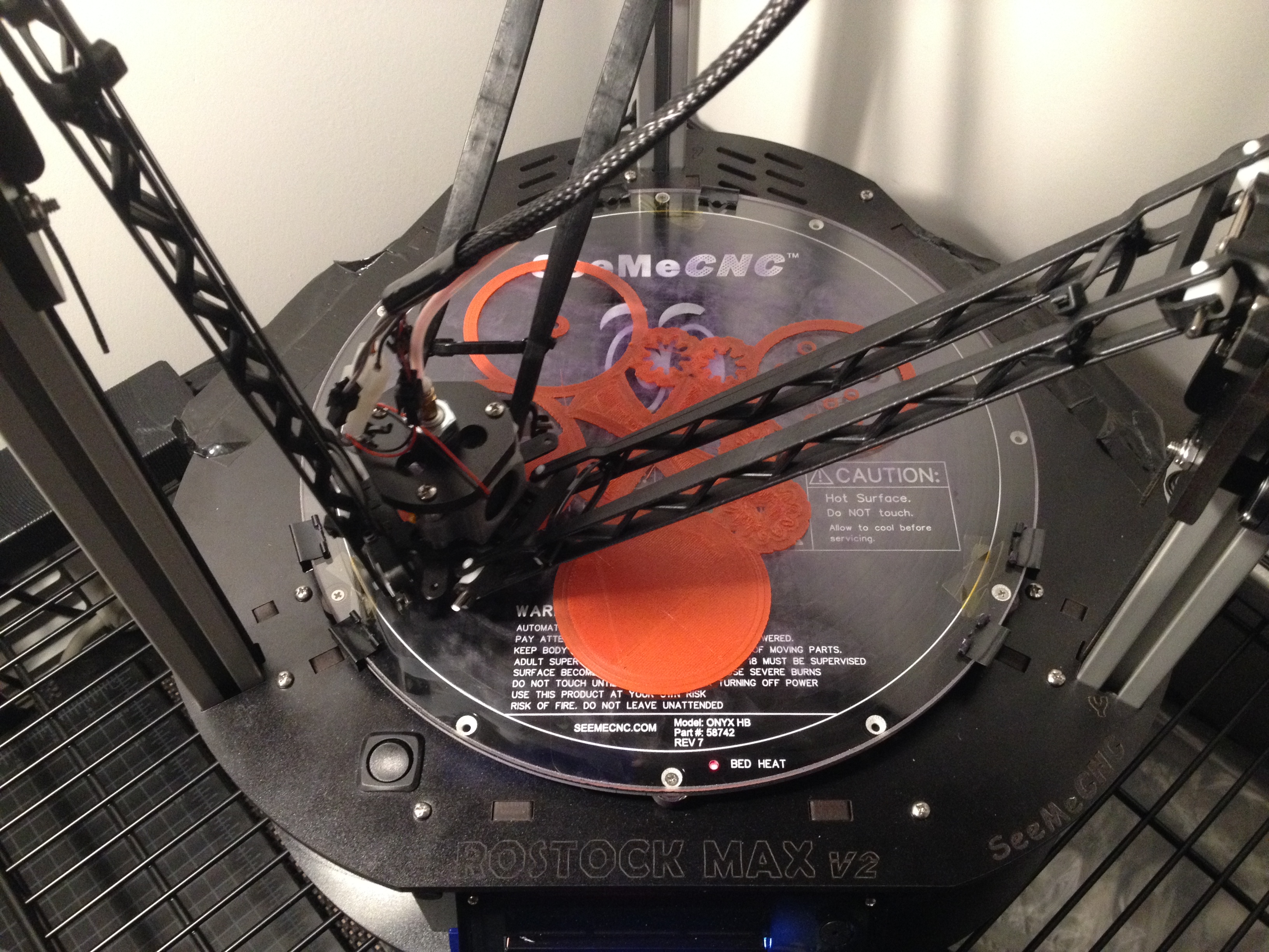

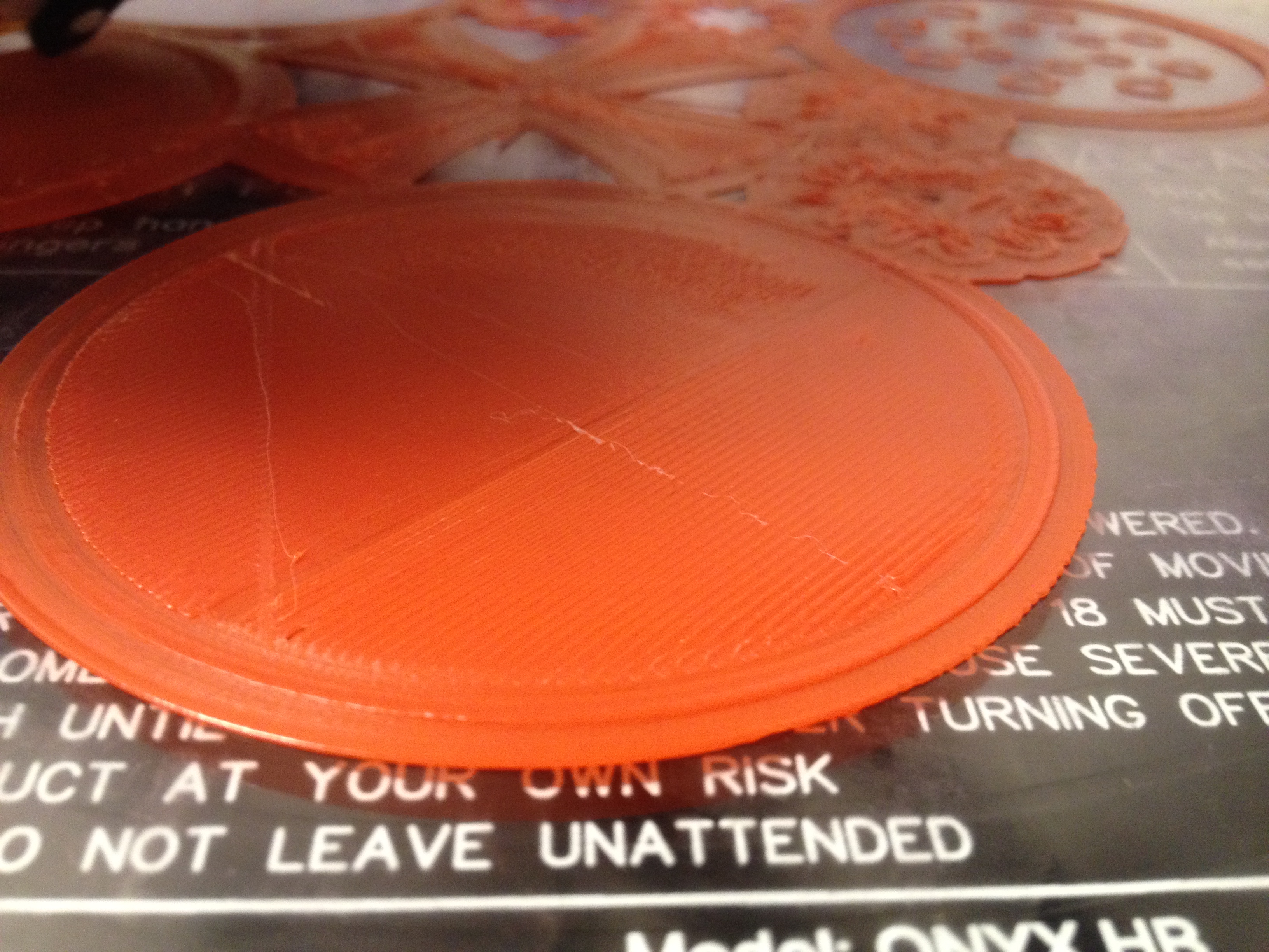

I was just the other day having this exact issue. In some of the "across tower" corners of the bed, prints weren't sticking. I fixed it, here's how:
Start by removing the "center" point as a pre-set button on rep-host (what is the center? It's defined by the movement of the three axes.)
I instead set the 5 buttons as follows:
1: under Z tower
2: under Y tower
3: under X tower
4: across from Z tower
5: across from Y tower
and then for the "sixth" I simply copy and paste the g-code for "across from X tower".
Then, by EYE (with the shiny clean glass bed to use the reflection of the nozzle to determine the height of the nozzle. Do not apply glue or hairspray first.) I make the points at the tower and across from the tower equal. I go around, adjusting each tower slightly. It's frustrating because each time you adjust one tower, it makes the others out of whack. Just keep going around until it seems like no matter what the points won't level. Now you have to adjust your radius. What you are essentially doing is defining the center point. The reason the "across" position is raised or lowered is simply because of an incorrect radius setting. The machine, mathematically, thinks it's farther out or closer in than it really is.
After getting each across value and below value as close to each other as possible (THEY WILL NOT ALL BE EXACTLY THE SAME! It does not have to be perfect, but they have to be in equilibrium - ideally, the variation will be within the thickness of a piece of printer paper - as in, you should be able to "feel" the nozzle at ALL points, including the center, with the paper under the nozzle. Some will be FIRM grips, and some won't be as firm. You wan't the firmness to be as spread around and even as possible, ie not a sloped bed.) you adjust the z height so it almost CLAMPS on a piece of printer paper (thicker than lined notebook paper). You should still be able to move it, but it should be hard.
I am printing across the full area of the bed acceptably. Sure, the base layer has thickness variation, but it adheres perfectly across the entire surface and the prints are stunning... so I think that is the best we can hope to achieve. Don't be expecting to print 10" diameter shims with an accuracy of better than +/- 0.05mm. This is terrific in my opinion.
On that note, I reckon the true FULLY cylindrical build volume possible is 260mm in diameter, or 10.2 inches. Beyond that and I think the towers start slightly interfering... It could go beyond 260 in between towers, but we all know how that goes...
Also, if you look closely, you can see my new and improved, high-tech, patent-pending, ultra-closed-source, proprietary (because a lawyer told me so) cable-tie arm-tension system.
I don't want to release too many details yet because I plan on ripping you all off by selling existing technology as proprietary... but I'll give you a hint: it's 4 inch cable ties, 11 inch cable ties, and you have to make sure the nubs don't interfere with the effector and carriage (look at the picture closely).
Beyond that, it's all hush-hush hush. I don't want to reveal too much, but if you ask nicely I'll make a write-up/photo-series/video detailing the highly-unobtainable, proprietary design.

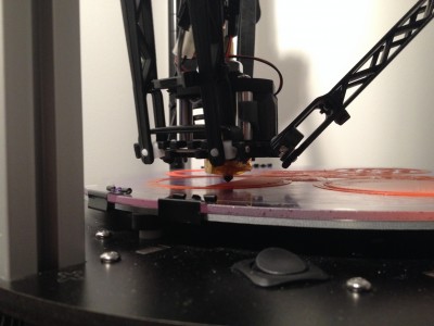

I have been struggling for weeks to get rid of high spots at the perimeter midway between all three towers. End stops and radius only got me so far. Did not have any clear signal suggesting it was tower rotation as all points were similarly high. I did notice a fair amount of play on the end effector using stock arms. Since I need to print large parts for my business, I broke down and ordered the carbon fiber arms.
After installing the new arms, I noticed the minor play in the end effector was eliminated. I went through the calibration process (base of each tower, 129mm radius) and center. My first print, a star with 1.95mm cylinders every 60 degrees around the perimeter (and other points) yielded completely new results. My points opposite the towers were lower and between the X and Y towers was actually low. Finally I had indication of a tower rotation issue.
I created an Excel spread sheet with both inverse and forward kinematics. Given the values in the firmware for arm length, horizontal radius, radial position of towers and the positions of my printed columns, I determined the skate positions for each tower. I then had additional variables for the actual length of each arm, the horizontal radius and tower angles which I used to see where the end effector would move given introduced deviations from the idea. I could then try different values for each variable to try to match my printed results. This told me to rotate my X tower .4 degrees and to increase my horizontal radius .1mm. Making the changes in firmware and printing again and I'm close. Still need just a bit more fine tuning, but the first layer now sticks on all six points.
This experience has me believing that this issue being seem by some users of lifting between all towers is caused by play on the U-joints. I have not done the math to confirm, just observational conjecture. As a mechanical engineer, I can also note that when you transition from between the towers to outside, you go from having all arms in tension (weight of end effector) to a condition where one arm (to opposite tower) is in compression. If there is play in the joints there can not help but to be some change during the transition.
Sorry for rushing through all this, but I have to leave. Wanted to get this out there for the discussion.
Next step? Try to figure out how to go from printed cylinder height at specific locations to calculated changes to all end stops, horizontal radius and tower rotation. Not sure I have time for that anytime soon.

I'm not sure if this was mentioned before, but this is what I found when I replaced my arms with ones I built myself.
If the print is too thin (too low) near the towers but not between the towers, the arm length needs to be increased. I had about a 0.15mm thickness variance that I eliminated by lengthening the DELTA_DIAGONAL_ROD by 3mm. After this change PRINTER_RADIUS also needed to be increased by 0.5mm to fix the bowl effect.

I've read the whole thread pretty thoroughly now, but I'm not seeing a set of enhancements or calibration steps that will result in a decent setup. I can see that using something on the arms to tension them is very helpful as well as making sure that everything is tight as far as screws, belts, etc. go. I also see that running the endstops and horizontal radius cycle until the radius is perfect is a good thing. I've done those things.
One thing I'm confused by is how to adjust the tower rotations. I know the physical reason for adjusting them and the location at which I adjust them in the EEPROM, but I am not sure what direction I should adjust them to or which one I should adjust.
Right now I am getting halfway decent adhesion at 100C for ABS on Elmer's purple glue stick and sort-of-okay first layer thickness on the very outer perimeter of the ~280mm diameter test print pattern, but some areas are thin and some are thick and some don't adhere properly. Furthermore, I've artifically "fixed" those issues by setting the Z0.0 height to be way lower than it should be, so basically at Z0.0 the nozzle is RIGHT at the glass bed, which basically means I adjusted it until it was catching the paper and then lowered it another 0.15mm until the paper was not quite pinned but almost pinned.
Let's say I'm getting thin areas between the X and Y towers (front 2) but further towards the Y tower (right front) and then I also get thinner spots on either side of the Z tower closer to it than the other towers. Would that mean I need to adjust the X tower and Y tower or X and Z or what?
Not that I am complaining, you guys are doing good work figuring out this stuff, but I sure wish there was an extensive guide on what, when, and how much to adjust each of the calibration items (endstops, tower rotations, horizontal radius, etc.) and formulas for how to adjust them. I suppose that I should just get into the kinematics of the thing and try and do it myself if no one else is going to, but I have enough maths to deal with in school on a daily basis :)
Anyways, what I found is I am getting the best adhesion ever from simply adjusting the Z0.0 height down by .10mm or .15mm below the height from the "paper test" artificially and also adding some zip ties to the middle of the twin arms to hold both ends tighter (Basically just threaded them through the arms and tightened a bit).
