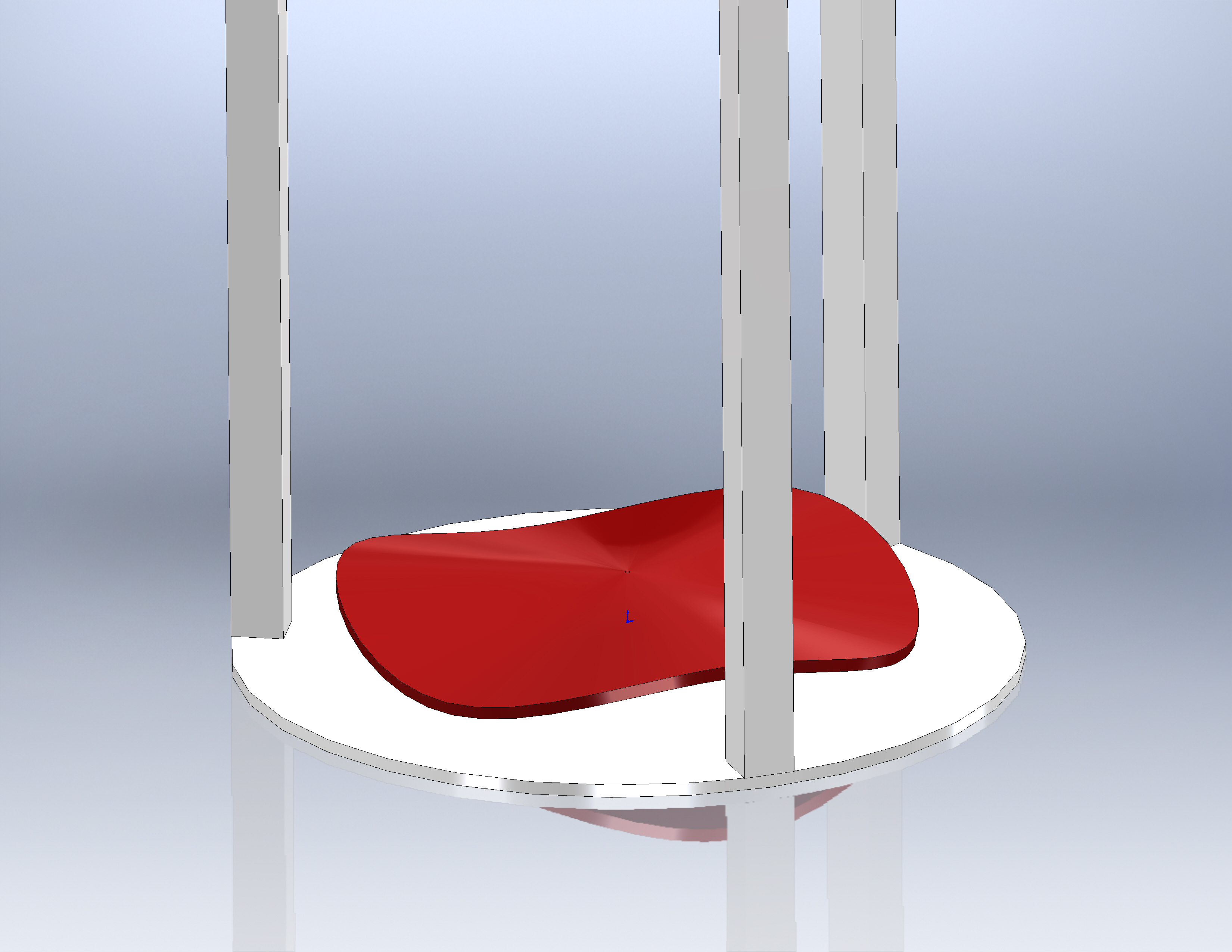

Hey Guys! I've had a Rostock for a little over a year and have always had trouble printing all the way to the edge of my bed. We started chasing the problem a little more seriously with all of the experts at MRRF, and it's still eluding us.
I run a bed leveling script that hits Z0 at the center point and right below each X, Y, and Z tower. This works well, and is how I've set my stop screws, delta radius (horizontal radius now), and other calibration bits...
If I run a script that hits Z0 at the points in between each tower (indicated by A, B, and C in this picture) my head is perfect at the center, but about 2mm above the build plate everywhere else.
[img]http://i.imgur.com/nrxsYHo.png[/img]
If I run a script that goes X, A, Z, B, Y, C (around the perimeter clockwise [that's anti-cyclonic for Gene]) The head will go back and forth between the perfect level point and the 2mm high point.
WTF?
I recently did the V1 to V2 conversion, and the problem followed. I was also concerned about the flatness of my build plate, so I switched from cheap window glass to a real borosilicate plate.
So the wood is all new, and so is the build plate... What am I missing?

TLDR:
0, X, Y, Z = good
0, A, B, C = bad
0, X, Y, Z = good
0, A, B, C = bad

Are you using the stock arms and effector?
The most likely issue, is incorrect geometry set in the firmware, either arm length, or one of the offsets.

very strange.
If you do the same moves but smaller, say 50mm smaller star pattern, does the amount of error change or remain the same?
If you go anti-clockwise does anything change?
hmmmm, let's do some testing at the meeting Thursday, OK? will you be there with machine?
Do you have a dial indicator? if not I can bring mine so we can get some measurable data.
Did you put that mic-6 aluminum tooling plate on your bed so we know it is flat?
I am thinking taking measurements at smaller and smaller star patterns (25mm increments) then putting that data in a spreadsheet to see if any pattern shows up.
could be some weird math out at the travel extremes where the arm angle gets small.
If that is true we should be able to 'predict' change and have firmware compensate depending on position.

If it's a geometry issue, in all likely hood you'll see it arc between the good values, it'e the nature of how the Math works out.
I'd would have guessed arm length, the carriage offsets don't really matter except in there contribution to computing delta radius, when you measured the arms I'm assuming you measured rotation center to rotation center? rather than end to end, and I assume you've compared them to each other.
Another way to verify arm length is to print a say 50mmx50mm square and measure it, significantly incorrect values for arm length will result in print scale issues.
Could also be tower positions, but it seems unlikely they would be out by enough to introduce a 2mm error.
I also think you'd notice if your glass were warped by that amount.

I have this exact same problem on my V1 as well, this is an exaggerated model showing exactly how it acts when printing near the outer edged of the build volume, by eyeball measurement the nozzle is probably around 1.0 to 1.5mm higher off the bed between the towers.

I'm also confused as to why their calibration guide tells you to write the scripts to only go out about half way to the edge of the build diameter, I actually changed my scripts for calibrating to move it much closer to the outer edges of the build area which I seems to have better luck with calibration with those settings.
Re: Unsolved Mystery. Weird Z0 behavior around build perimet
The calibration guide's coordinates probably date to the smaller "Phebe II" PCB heater shipped with earlier Rostock MAXes.
I have spent an extraordinary amount of time trying to get my printer to produce .1mm layers out to the perimeter. It has never delivered this reliably. I could print some wide things at .2mm if I lined them up a certain way, but most of the outskirts of the print surface are unsuitable for printing because the printer can never figure out how to position the effector over them.
Delta kinematics involve a lot of (somewhat shallow) exponential curves. To move the end effector a given distance, the Cheapskate carriages have to move slower when the effector is close, and progressively faster as it moves further away. If you command your printer to move the effector from x=-120 to x=120 in a straight line, you will see the Y carriage moving slowly at first and accelerating as the effector draws near, even though the effector speed is constant. The weird behavior - OK near a tower, but terrible opposite it - is because the carriage is either being moved too fast (driving the nozzle into the surface, possibly punishing the belts) or too slow (lifting off the surface and air-printing.)
Maybe the delta arms are an uneven length. Maybe the radius delta is off. Maybe the towers are slanted just a touch, or perhaps the top plate is not directly over the bottom. One way or another, the carriages are moving too fast or not fast enough when the effector is far away from them. This is the problem that must be solved.
I really hope SeeMeCNC is paying attention to this. It's been a problem for myself and many others since the beginning. We the users have collectively spent thousands of hours trying to figure this out, to no avail. I feel it appropriate that SeeMeCNC should now direct its full attention to solving this problem, which renders the printer unable to perform according to its advertised specifications. .05mm positional accuracy and an 11" build diameter are what we are supposed to get, but while either specification is true on its own, they are not true in concert. I would like to be repaid for the time and energy invested to get this printer operating on spec, with some reasonable way of getting the printer to perform on spec. To me, that means 0.1 - not 0.05, but only half that resolution - ALL the way out to the edge. I am willing to collaborate further, with end users or with SeeMeCNC staff, but I really need to see SeeMeCNC take a leadership position and drive this issue. User effort so far has produced small incremental improvements, but we need SeeMeCNC to do its part. Unless someone with a degree in robotics happens to saunter in, I don't see this ever getting solved without their help.
