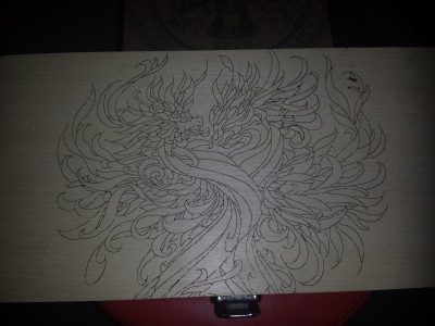

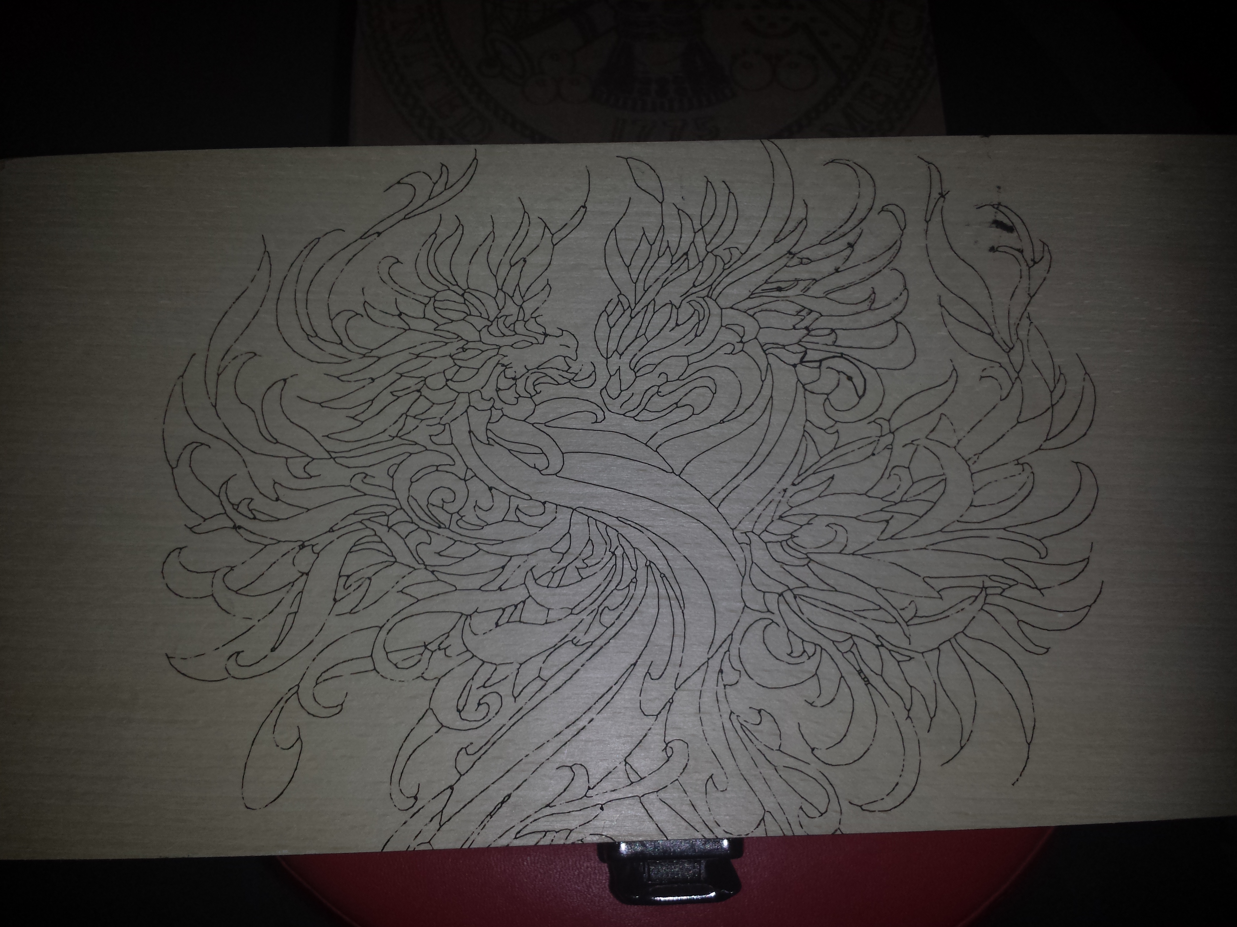

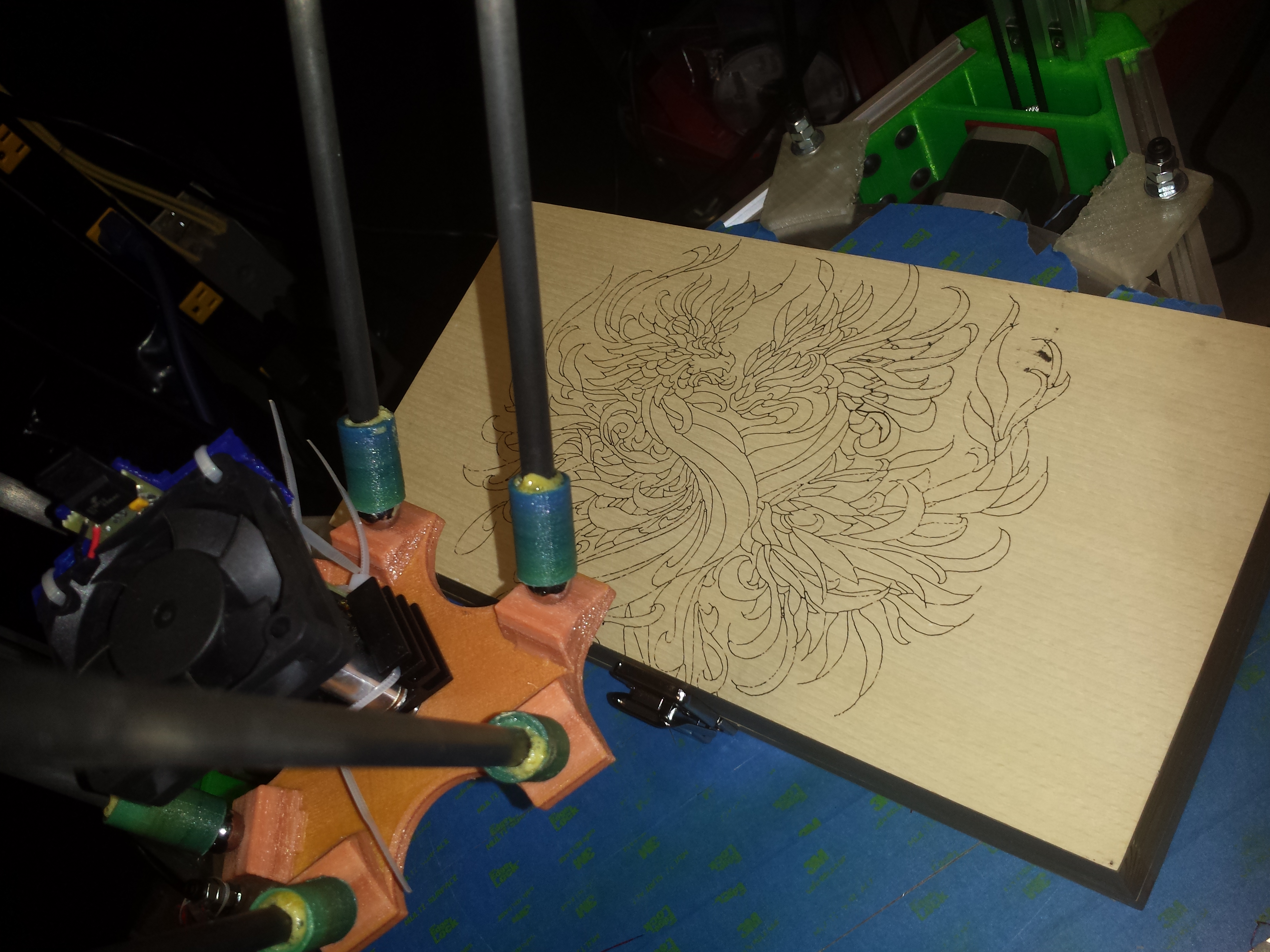

bubbasnow
Posts: 1061
Location: Dayton, WA
Re: L-Cheapo Laser
Post by bubbasnow »
Had a wood box laying around

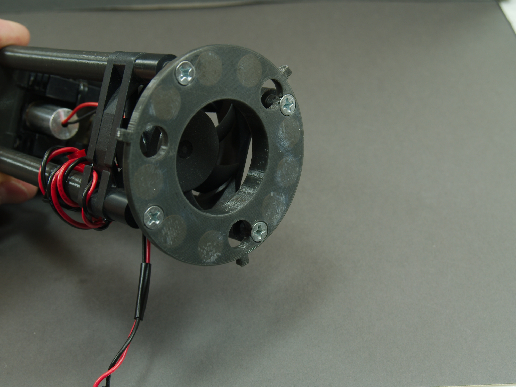

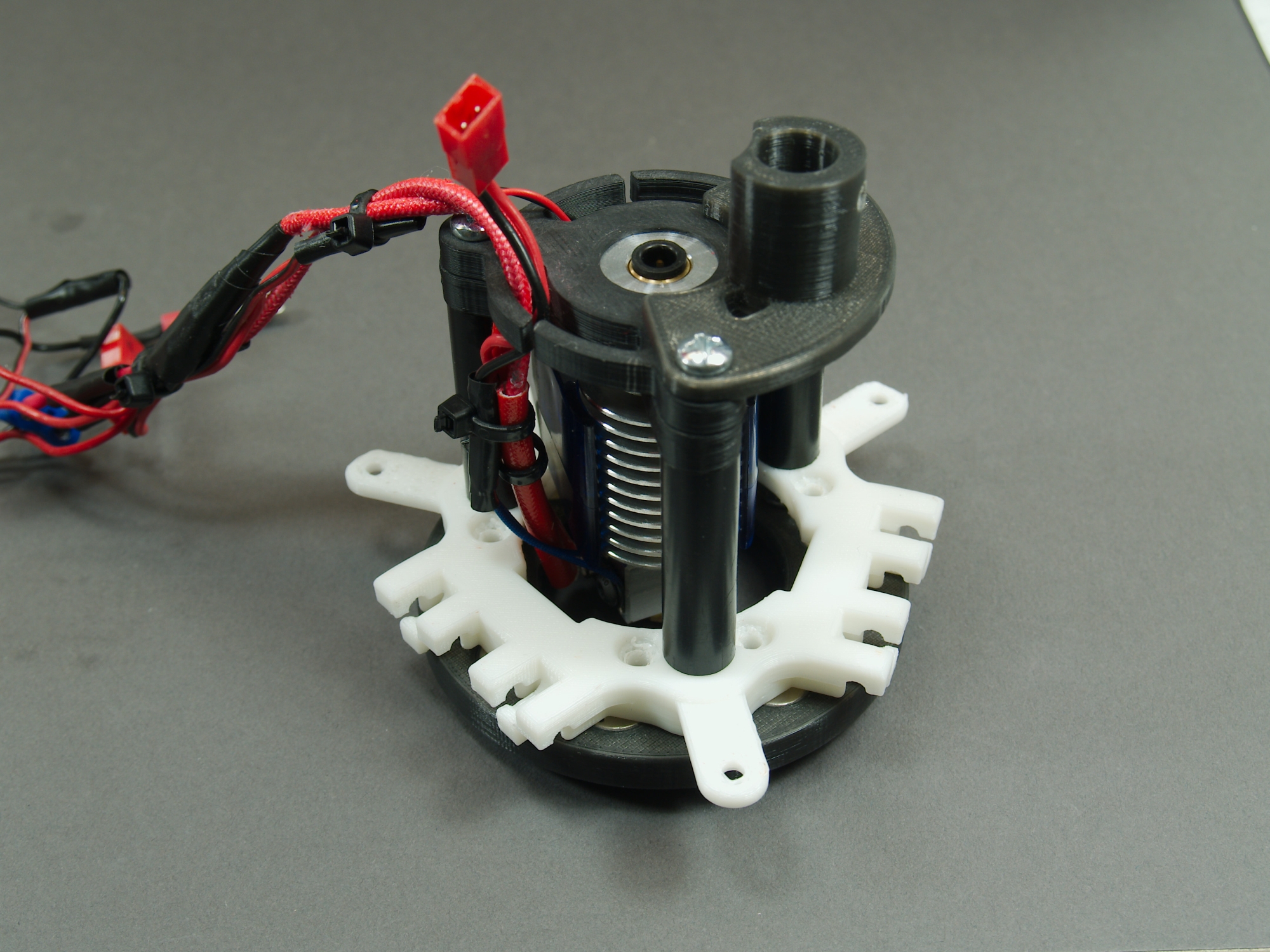

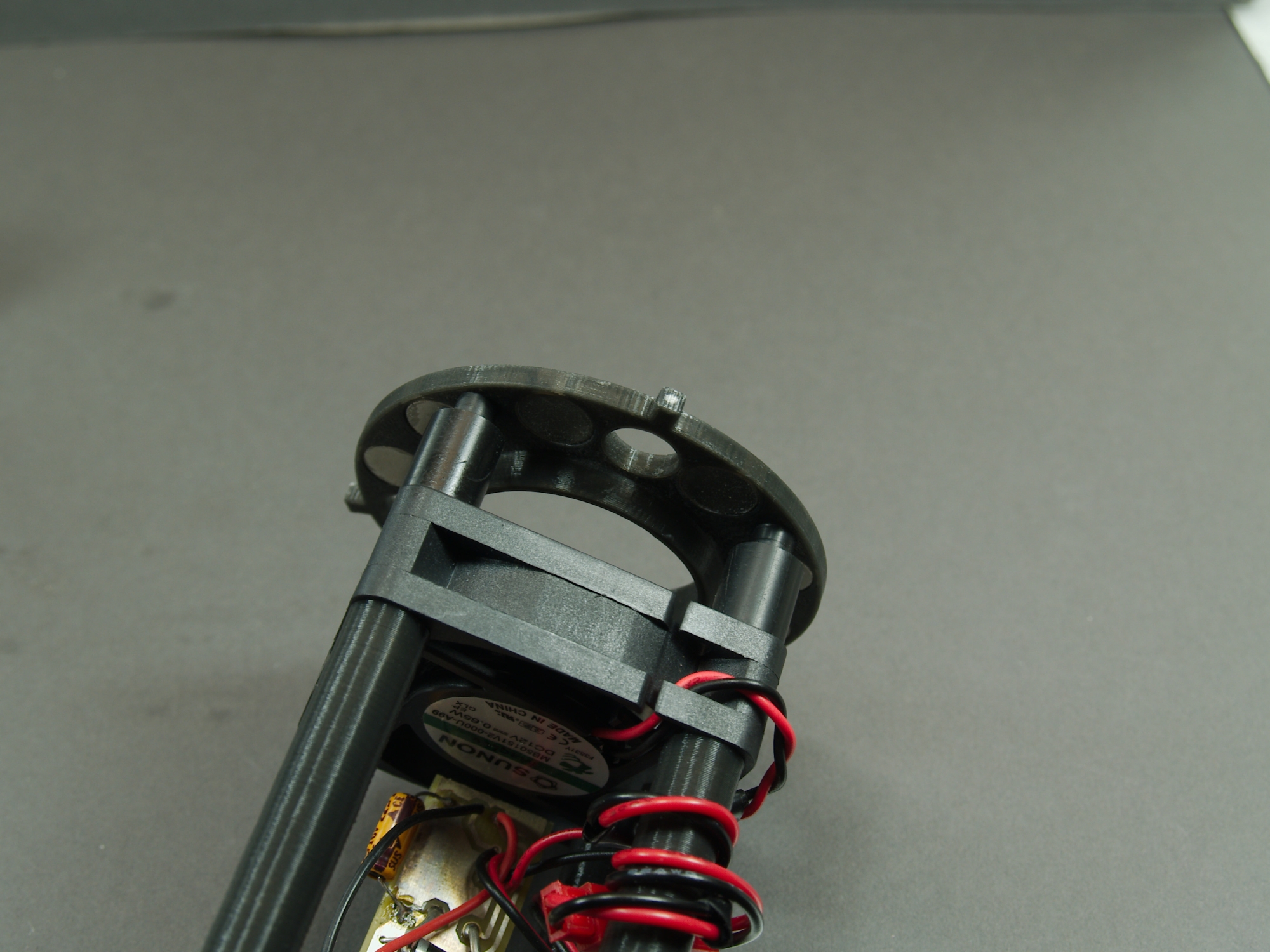

heathenx
Posts: 305
Location: Northern Indiana
Re: L-Cheapo Laser
Post by heathenx »

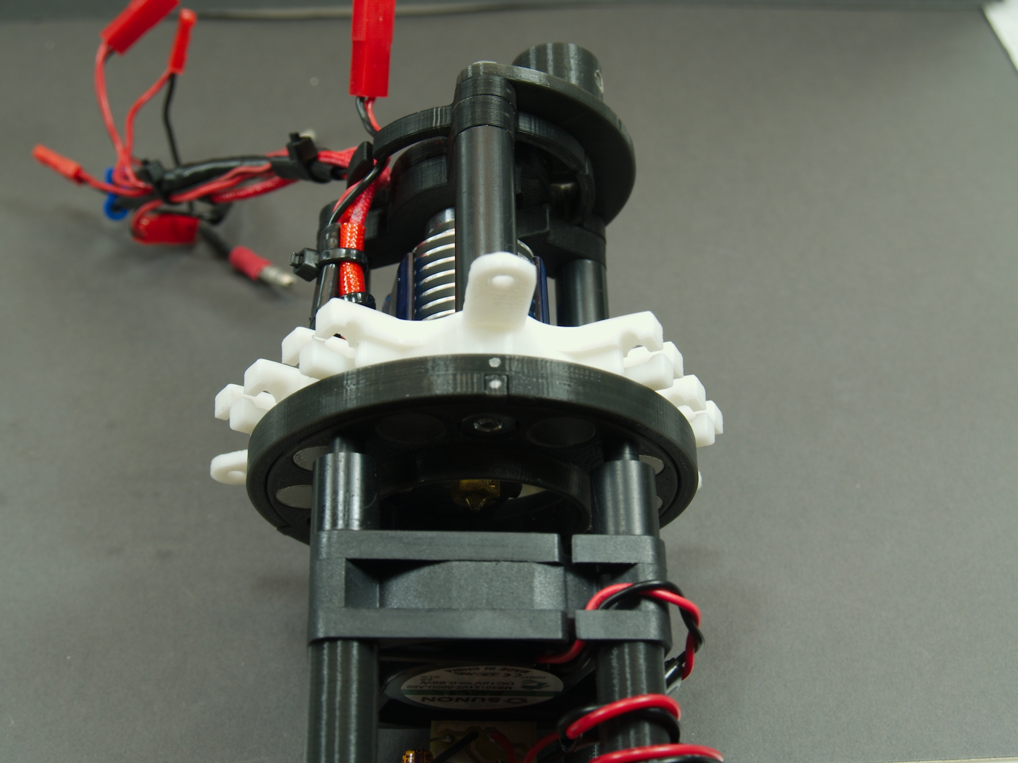

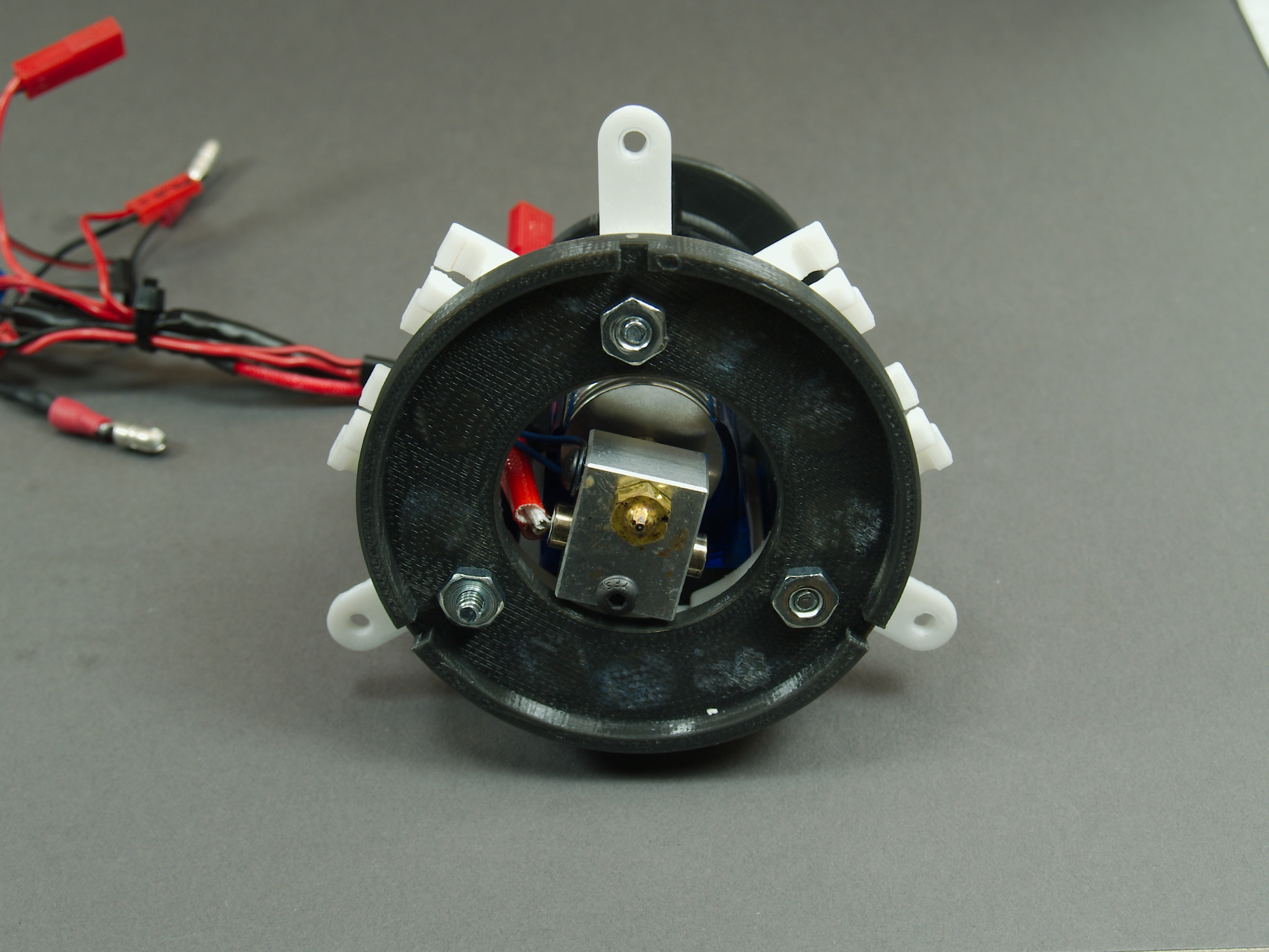

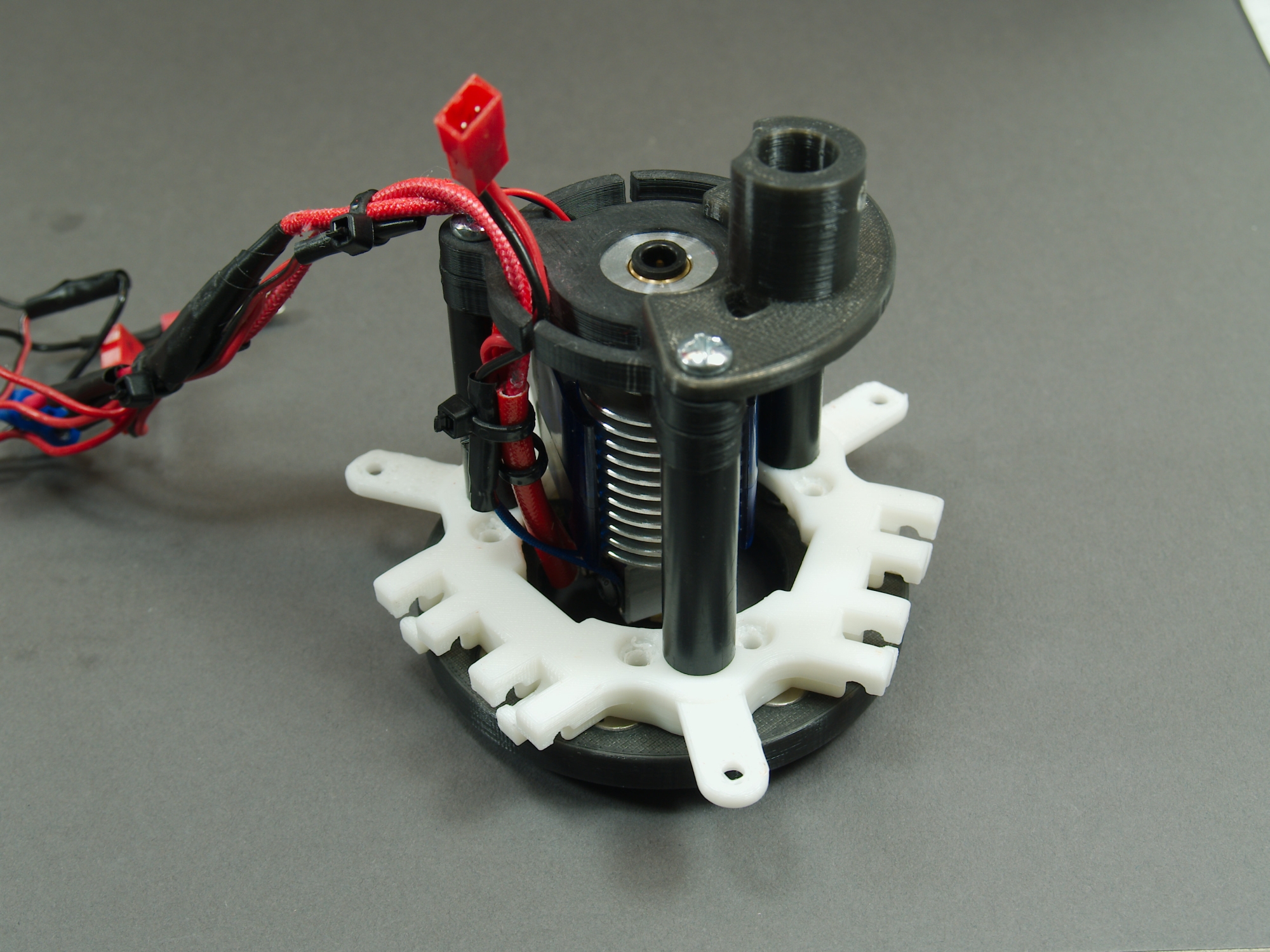

So I finally found some time to make that magnetic mount that I was kicking around. Seems to work rather well. It's much easier for me to screw the single magnetic top plate to the underside of the effector. The rest of the mount just snaps into place afterward. The mount is keyed so it won't twist. Not sure if twisting would ever happen but under fast travel moves I suppose it might be a possibility. Anyway, I have enough magnetic strength on this thing that Magneto would be proud. :) If you are using my mount from repables (http://repables.com/r/370) then you won't need that top plate. You'll need this magnetic version a long with the effector mounting plate.
I purchased the magnets from ebay. 50 of them for about $10. A few left over for future projects. http://is.gd/RkXSCd
By the way, that white stuff on my printed parts is super glue residue. The magnets where glued into place. Be sure to get the polarity right before gluing.
rostockmax_lcheapo_magmount.zip
(276.94 KiB) Downloaded 478 times
