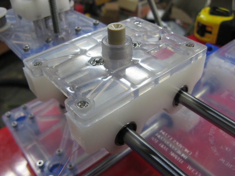

Well I am going to start an official build thread here.
I purchased mine several weeks ago and assembled it and got all the electronics and configs done and tested motion. Then I promptly disassembled it as there were a few areas that i thought needed attention and I am not one to leave well enough alone!
So the list of mods starts with an 8mm linear bearing upgrade, all bearings and rod were purchased from ebay (VXB).
I also replaced the idlers with 608 bearings as well.
When I first put it together I noticed a lot of flex in the Zaxis as well as a wobble that tended to vibrate the machine. So for starters I replaced all the all thread throughout the machine with 5/16" and modified the clamps to accept the new rod.
The Z wobble was a little harder to track down, I have heard complaints of the Z screw being bent so I checked mine against my granite surface plate and they appeared to be fine. so I chucked them up in my lathe and they appeared to run true as well. So back in they went only to wobble some more.
They were also a little slop in the lower bearing. So I purchased some from the LHS and I gotta say not all allthread is created equal as the new stuff I bought was much tighter in the captured nut on the Z.
I also ran them against my wire wheel to clean any burrs off and clean up any loose material on them.
I found the bottom of the nylock was actually the culprit for the Z wobble as the bottom face was not flat, so I chucked it back into the lathe and trued the bottom of the nylock and re-installed, nice and smooth now, no discernible wobble any more WOOOOOO!!!!!

HAHA I know that one Dave! I will try to get some pics up tonight, its not completely assembled yet but I can snap some pics.
I still have to machine the 4 Z bearing blocks, and those are the last pieces to machine. I am using some
UHMW-PE that I had laying around. It doesn't have much in the way of thermal resistance so the X bearing blocks might be a re-do depending on if they hold up. Its ok though as I have plenty of Al to work with as well.
I am currently working on the electronics enclosure as well. I personally cant stand to have all these electronics out in the open so they will be housed in a plastic enclosure that the printer will sit on.

As promised Dave here are some pics of my progress so far. I am going to finally order some filament tonight as well as the heated bed.

OK JT I believe you now :lol: Looks real good. I have not done my z axis linear bearing mod yet. Trying to get the heated bed going. I have some printing for a job I need to get done ASAP.

On the Z fixed plates instead of turning the 8mm rod down I chucked it into my lathe by the boss and bored it out to 5/16" for a nice snug fit, I aligned it with a .25" drill in the tailstock before tightening the chuck and was surprised at how well it worked! I was sure I would be remaking them out of AL seeing that thing whipping around, but all turned out well.
Some of the flex I see in the frame is coming from those plates, but I think an extra "foot" on each side would serve wonders for that, but I gotta keep telling myself this thing isn't going to be machining metal. :lol:

First, sorry not to clarify earlier, the parts were machined on my cnc mill not printed. I dont even have any filament yet haha, got some on order from protopardigm. Even picked up some glow in the dark!
The 8mm smooth rods were ordered in 30" lengths (need 3) on ebay from the seller irvineman, (VXB) http://www.ebay.com/itm/8mm-Shaft-30-76 ... 5d303b69f5
The 8MM LM8UU bearings were also purchased from ebay http://www.ebay.com/itm/American-Seller ... 7618555299
I am sure these items could be sourced a little cheaper if one was to search a little harder than I did but the items came in good time and packaged well.
