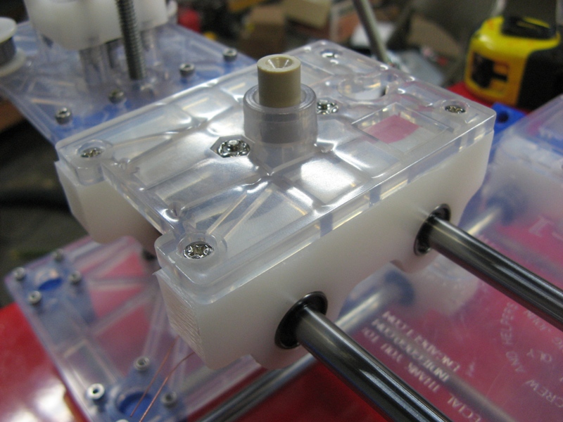

Holy smokes! Michael is already on page 3 I better get on the ball

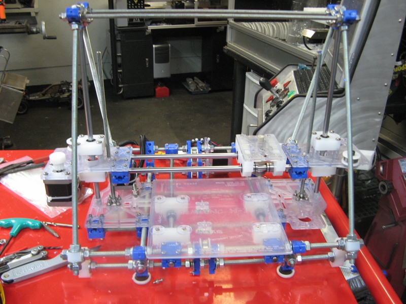

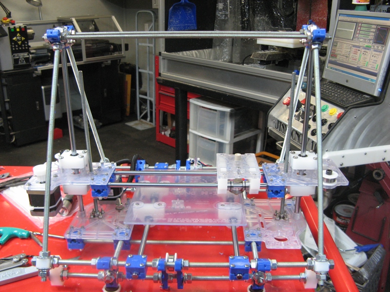

As promised Dave here are some pics of my progress so far. I am going to finally order some filament tonight as well as the heated bed.

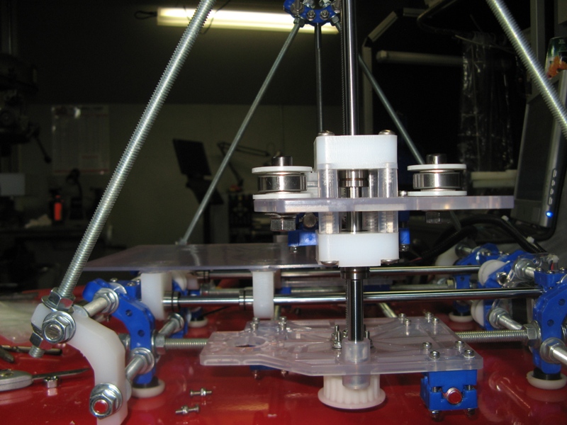

Here is some more

OK JT I believe you now
Looks real good. I have not done my z axis linear bearing mod yet. Trying to get the heated bed going. I have some printing for a job I need to get done ASAP.

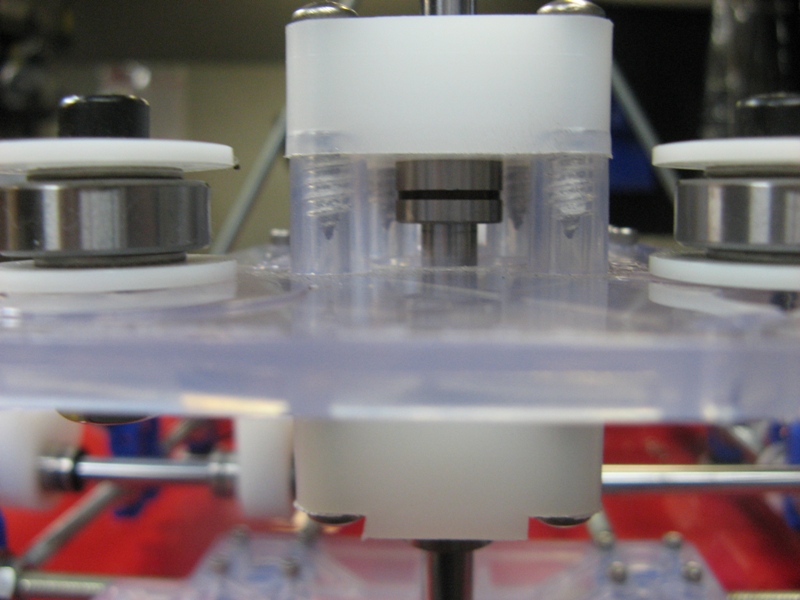

On the Z fixed plates instead of turning the 8mm rod down I chucked it into my lathe by the boss and bored it out to 5/16" for a nice snug fit, I aligned it with a .25" drill in the tailstock before tightening the chuck and was surprised at how well it worked! I was sure I would be remaking them out of AL seeing that thing whipping around, but all turned out well.
Some of the flex I see in the frame is coming from those plates, but I think an extra "foot" on each side would serve wonders for that, but I gotta keep telling myself this thing isn't going to be machining metal.

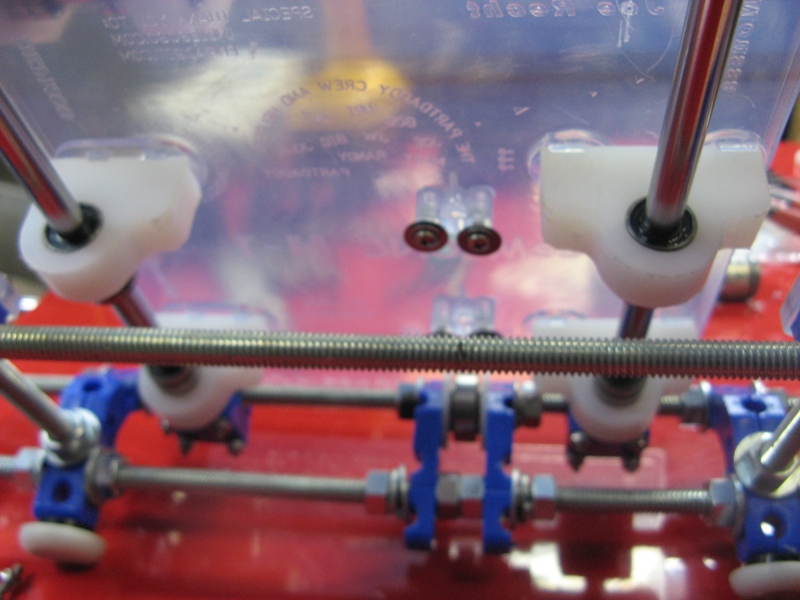

The issues I ran into with the 5/16" all thread was clearance between the all thread and the upgraded 608 idlers for the Y axis. If you are using the stock idlers its not an issue, but I had to run some emery cloth around the all thread to knock down the peaks on the threads so the belt didn't rub.
All in all not a big issue, and the skate bearings are a great upgrade.
The other issue was with the skate bearings was unless I narrowed the base a little ,the belt for the Z was too short to install. I wanted all the travel I could get so I left it wide and got another belt for the Z the stock one is a 200XL 155T, I got a 158T to replace it.

I will try and post some more pics of my progress today.
I am chomping at the bit to get this thing printing! I will probably have plenty of questions about slic3r when its all said and done, but everyone here is pretty helpful so I should be able to muddle through.
