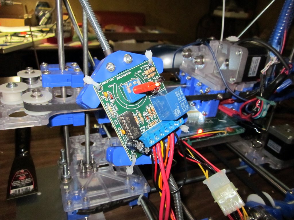

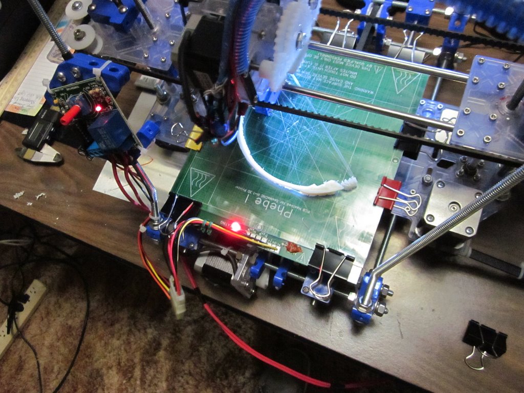

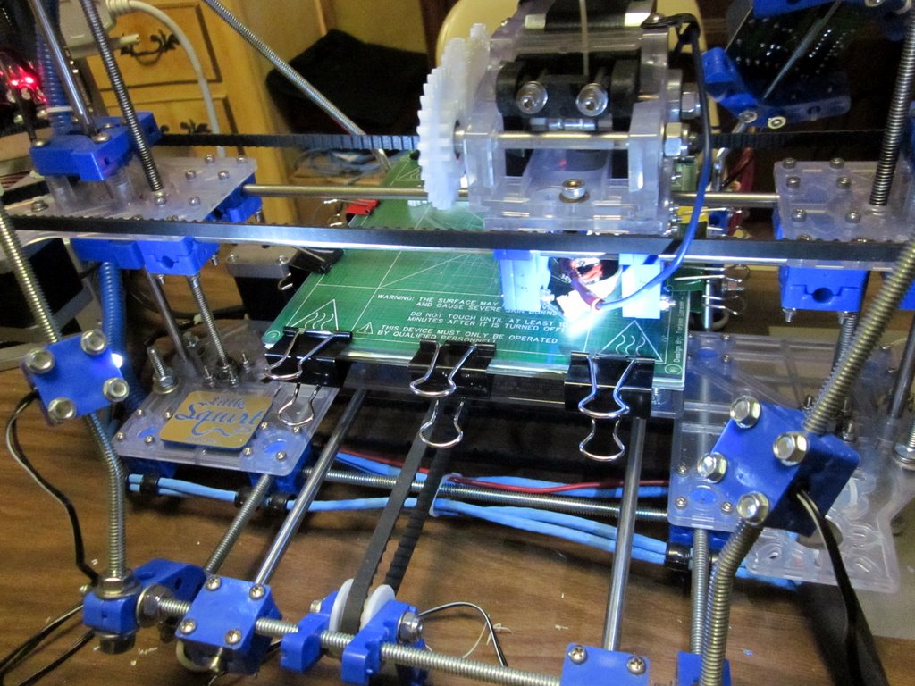

The new heated bed is working really well! Easily holds 100c, I have printed about 6 hours the last two nights without any issues.
Controlling temp with a Vellman board from SeeMeCNC.
Prints sure do stick better to bed and do not curl up.
Nice design, thanks TKL!
I have 4 spring standoffs for bed leveling, then two pieces of 3/32" glass covered with 3 layers of paper mask sandwiched together, then the PCB heater, then the clear plastic build sheet.
So far it has stayed nice and flat.
The stock bed underneath gets a little hotter than I would like, but no problems so far, prbably should insulate under heated glass with something.

Brian, what thermistor are you using? Stock Velleman? Did you futz with the MK138 resistors at all?

Hey Drew, just put a jumper in R6 to use the heated bed. That will allow you to set the low end in line with a heated bed, not a hot end

johnoly99 wrote:Hey Drew, just put a jumper in R6 to use the heated bed. That will allow you to set the low end in line with a heated bed, not a hot end
I put a 1k resistor in place of stock R6
( jumper R6 will work also, according to Oly at SeeMeCNC )
I am using a 4k thermistor from SeeMeCNC
Glue in place with small daub of automotive high temp silicone, clamp the thermistor in place until silicone is dry.
Make sure thermistor makes good thermal contact to board, you don't want silicone between thermistor and board, only over it to hold in place.
One thing I need to change is the board LED, it sticks up to high and the head can hit it... should have used smaller LED and/or bend it back away from table.
I also wish I would have soldered wires to come out on underside of board.
Make sure you drill 1 or 2 small holes at back edge of board for zip-tie strain relief for wires.
I wired in a plug from old PC power supply so I can disconnect it for service or whatever.
~*Brian V

the pcb heater board should be spaced up about 1/2" from stock bed with standoffs.
I made mine spring loaded so I can adjust standoff screws to level bed.
