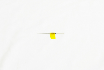

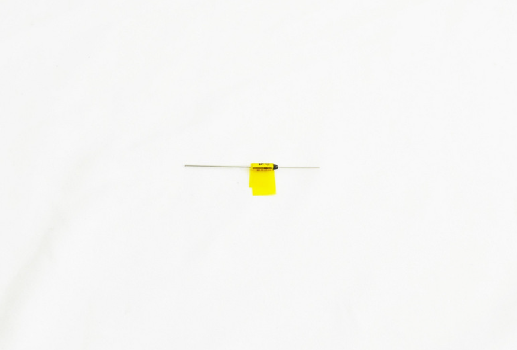

I would like to share a couple of additional failures' root causes, related to the def and causing mid-print stops, that I have recently experienced.
1- The first is related to the Kapton tape around the thermal fuse.
If the fuse body is not properly covered with the tape then it can short with the heat sink. Worst than this, when assembling the hot end you might force the fuse into its housing damaging, without knowing, the proper tape protection. On the long run, hot-end vibrations and other environmental factors can further degrade this installation shorting the fuse. In my case, the short was occurring after few hours into the print, due certainly to the heat sink dilatation and hot end vibration, exposing unprotected fuse parts to contact the heat sink (Fig. 1)
Fig. 1
. The remedy was to re-do the fuse protection. I would recommend adding a warning sign to highlight this aspect in the HE280 upgrade instructions so that builder is made aware of this critical aspect.

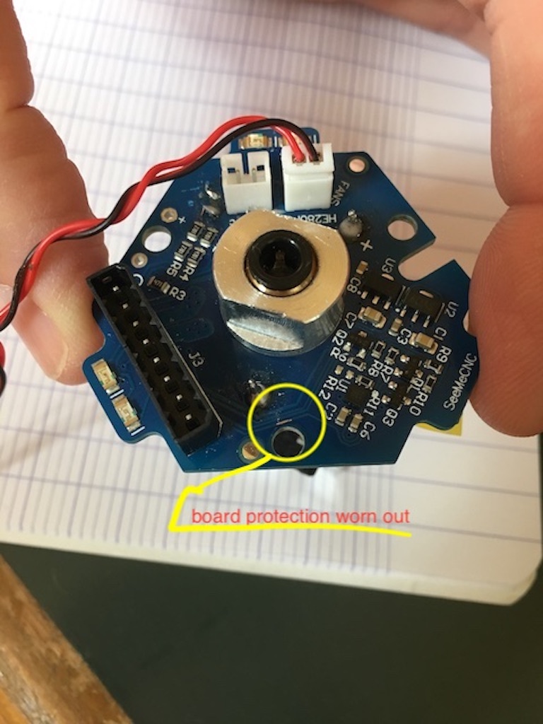

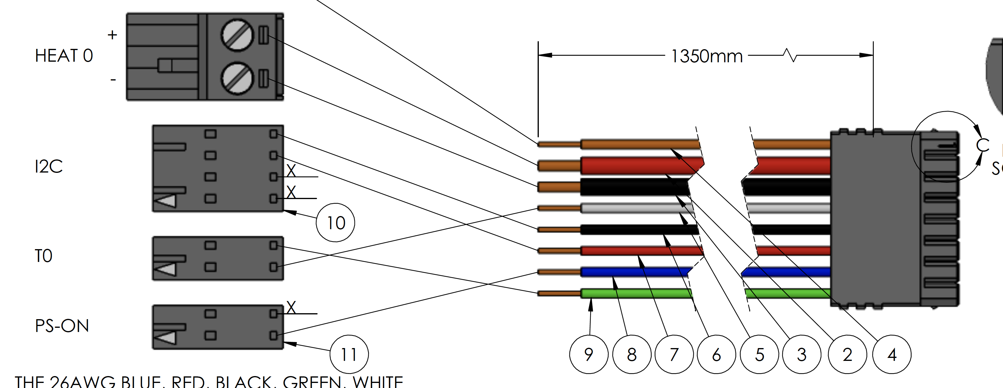

2- The second defect is located on the HE280 electronic board.
There again, vibrations have induced a board surface wear nearby one of the fixing screws causing the PS-ON circuit to short with the screw itself (Blue wiring, Item 8, Fig.2)

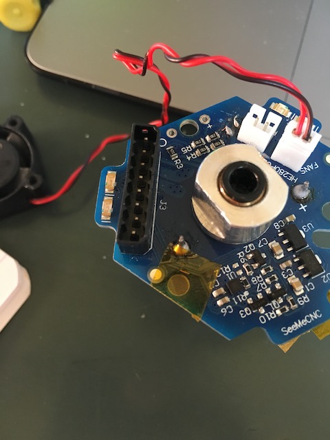

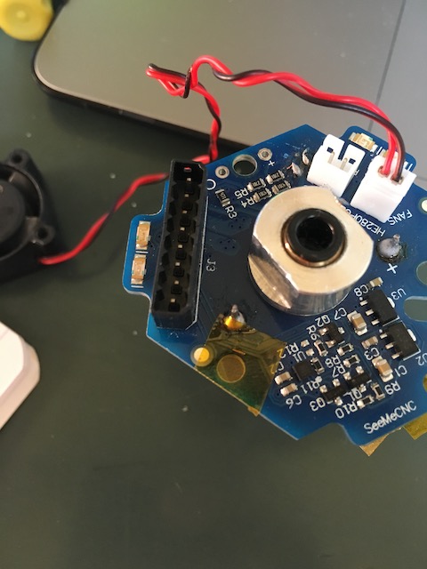

. In this case, the remedy was to apply the Kapton tape to isolate the damaged circuit board line from the screw (Fig.3 & 4)
Fig. 3
Fig. 4
