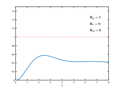

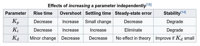

You can read up on proportional-integral-derivative (PID) algorithms, but they tend to be very complicated to understand. Instead, let me save you some time on that by showing you this excellent GIF animation from the article on Wikipedia:
See? MUCH easier than reading an enormous wall of text about integrals and derivatives! From that article, there is some explanation of what each factor does:
That table is nice, but for me, it's too much theory and not enough application. Let me boil all that jargon down into something directly actionable:
  • "P" controls the reactiveness. It is called "proportion", but I like to think of it as "power" instead. This is because it determines BOTH how aggressively it will try to get the heater up to temperature, AND how aggressively it will back off as the temperature is approached/exceeded. The higher this value, the closer you have to be to the set point to get a big reaction out of the system, so increasing it to the right amount will narrow the range of temperature oscillation. (However, if you set it too high, it will backfire, so you'll have to experiment a little.) Set this first. If the heater doesn't get hot enough, increase it. If the heater overshoots like crazy, and never quite settles down to the requested temperature, decrease it - but not too low. If you set it to a very low value, it will heat constantly, and the temperature will run away! Anyway, don't expect the temperature to be smooth at this point. You just want it to be "sorta close."
  • "I" fine-tunes the result you get from P, but will also make the temperature oscillation more "peaky." As you can see in the GIF animation above, it will get the average temperature to be what you set. If you ask for 210 degrees, and it's oscillating between 209 and 211, you have this one set right.
  • "D" smooths out the final result. Increase this to take the "wobble" out of the temperature. Don't jump the gun and set it to some high number out of the gate. If there is an overshoot, undershoot, or excessive temperature oscillation, doing so may make it harder to figure out whether P or I (or both) need to be changed.
You can see all that in the animated GIF above. When you start, unless you have "known-good" starting values (as below), you will set P=(some reasonable value), I=0, D=0. That lets you see what P is doing by itself. Tune P first, I second, and D third. Do NOT adjust more than one variable at a time! They are all interrelated, so you may wind up chasing your own tail for hours! Once you go through P, I, and D, and get the temperature to hold somewhat, you can go back and adjust the variables individually. (See Troubleshooting, below.)

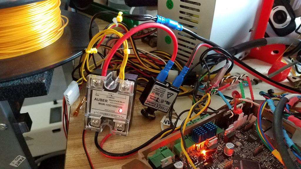

Heated Bed with Solid State Relay (SSR)
PID values that work fine for the MOSFET on your controller won't work if you install a solid-state relay (SSR). The resistance of an excellent SSR, like the Auber Instruments 100-amp DC SSR, is extremely low, whereas the resistance of a relatively small MOSFET (like you find on a controller) is - if not exactly "high" - still significant. That's why the FET on your controller will get hot, whereas the Auber SSR will barely be above room temperature at 12V. When I asked Smoothie to auto-tune my SSR-fed Onyx, it came up with the values P=155, I2.5, D2350. P and I are not surprising, but D is huge! Maybe that is how the algorithm compensates for the very long thermal lag time.
EDIT: When I wrote the above paragraph, I was running the SSR on the ground side of the circuit. I have since switched it to the hot (+12V) side of the circuit and installed a Blue Sea Systems 25A circuit breaker. This threw off my PID tune. I'm now using values P=170, I=0.5, D=2250, and the temperature is almost always exactly at set point (75C +- 0.1 degree, sigma appears lower than 0.01C). It may be that the hot side of the circuit is a better location to put the SSR. When it was on the ground side of the circuit, it had more variance, and I had to limit the max PWM. As it is now, max PWM is 255 (highest value) and it has no trouble maintaining temperature.
Fore more info about using SSRs, this appears to be the definitive thread. For reference, this is my (amateur and not certified by an electrical engineer) SSR/breaker setup:

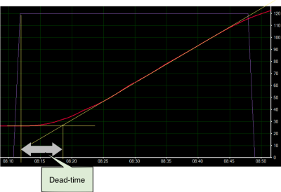

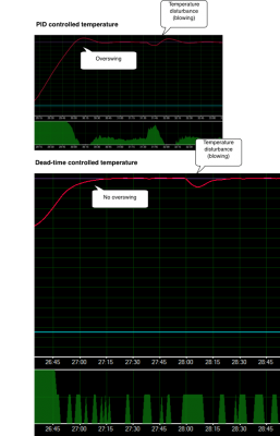

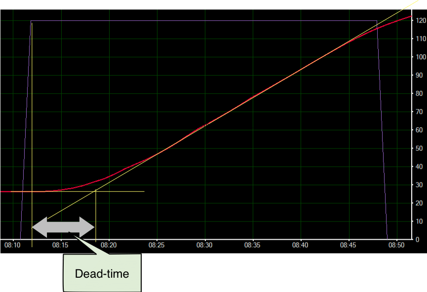

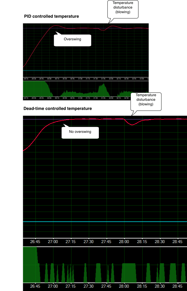

A dead-time heat manager is implemented in Repetier. It takes only two variables, which effectively describe the thermal inertia of the system. Overshoot is minimized or eliminated, and there's no oscillation around the set temp.
The idea is to figure out the "knee" of the temperature curve. Once the temperature is climbing at a relatively steady rate, you project the slope of that down to the temperature where you started. The time it takes to get from start to that intersection is put into the dead-time variable. The second variable is called "PID drive max" in Repetier, and that tells it how much power it needs to maintain the temp in a steady state. That's all it needs to know!
If I have time, I would like to try implementing this algorithm in Smoothie. (I asked the devs about this once - they were not interested in doing it themselves.) This algorithm worked very well for me when I was using Repetier. I honestly like it a lot better than PID. It seems to acknowledge that the goal in heating a radiative mass requires a precise, gentle fall-off as the set temperature is approached from below, and then "just enough" to keep it there. PID is more general-purpose, and might be the better algorithm if we were driving a heat pump (like a Peltier) rather than a heating-only circuit. It was originally designed long ago to control the rudder of a large vessel, so it would correct for current-induced drift and keep the vessel on course. The rudder on a ship can turn in both directions, but our heaters only go in one direction.

I was very content with dead time on my Rambo for the bed. I am not so sure that it works the same wonder for a hotend because of the very low thermal mass.
Because of the conversion to a duet board, I had to find a different method. Although bang-bang on the duet works much like dead-time on the Rambo, I have found PID to work even more precise. After some manual fiddling with the manual in another thread here I reached an oscillation of not even half a degree in both hotend and bed. Nice about the duet is that the PID switching frequency for the heatbed channel is only 10 Hz so any SSR can handle that. Sorry 626pilot, I know you are a Smoothie guy ;-)
