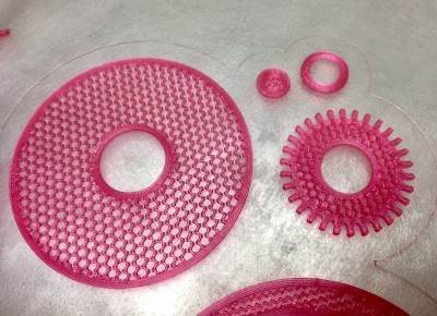

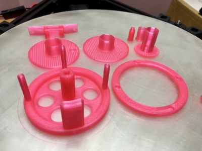

I'll throw this photo in to show what I expect from my printers. All perfect. No stringing, no blobbing, great registration. Each one of these parts offers unique challenges that would be difficult printed alone. Being able to combine them all on a single platter takes a fanatic attention to details.

Beautiful prints! What type/brand filament did you use for these parts? You mentioned PLA in this post, but these parts (at least in the pictures) look more like the PETG that I've experimented with. So very cool...
Re: Rostock Max V3 Build with minor mods
This is generic eBay stuff. I don't pay much attention to brand, I pay more attention to color! These are all PLA. Many PLAs are this beautiful translucent. That's what I look for when I buy. I can get good results from any PLA I've ever tried.

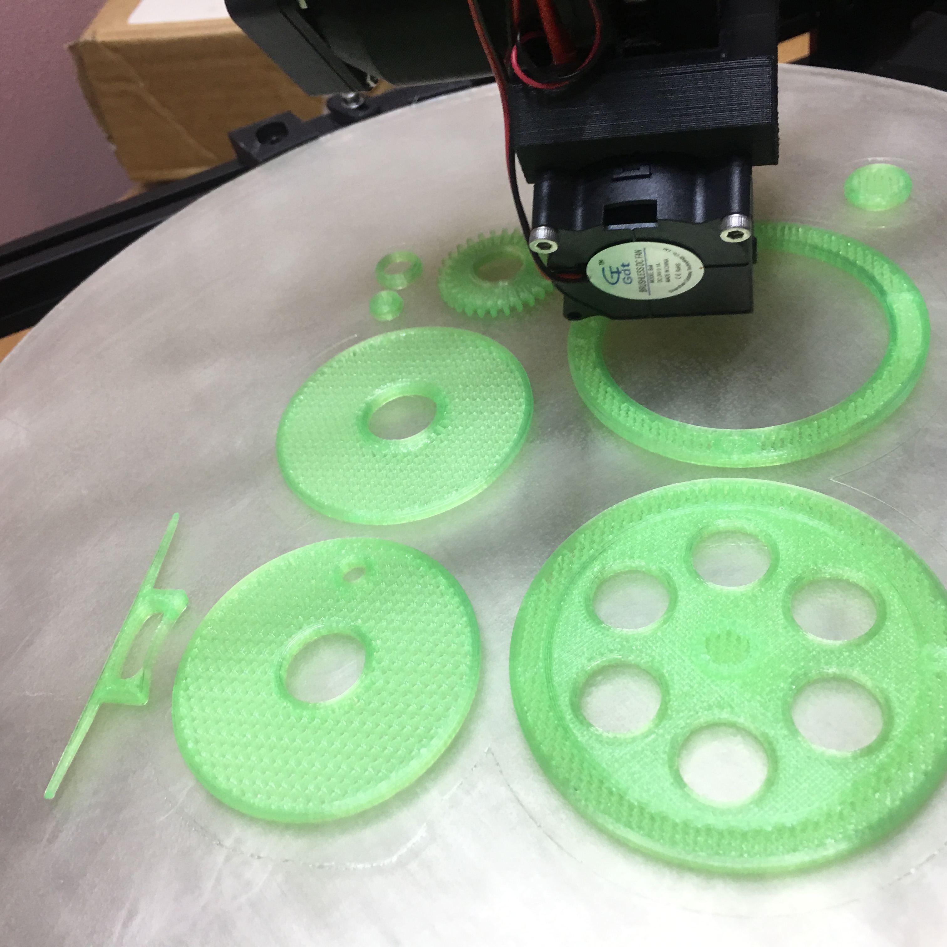

After getting the proper parameters entered for using 0.9 degree steppers and 16T pulleys, and running the bed levelling three times (it was fine after the first), and forgetting to run any extruder tuning, here is the first part I printed out of ABS:
Once we print a new extruder feeder housing of our own design, and mount a planetary-reduction stepper motor in it, and do a few tuning prints, the quality should go up considerably (based on improvements to print smoothness seen when upgrading our V2 to the same). This part will be printed again from the same material after that, giving us a good "before and after" comparison.

Here are photos of a test part ( http://www.thingiverse.com/thing:763622 ) we printed at the following settings:
Hatchbox PLA that has been open for 1 year
188C Nozzle, 60C Bed
No supports
0.1mm layer height, 0.3mm first layer height, 20% infill
3 perimeters, 10 top solid layers, 6 bottom solid layers
Avoid crossing perimeters X
Stock speed settings:
Infill 40mm/s
Top Solid Infill 40mm/s
Inside Perimeters 40mm/s
Outside Perimeter 30mm/s
Bridges 60mm/s
Travel 200mm/s
First layer speed 15mm/s
Retraction settings:
Length on Move 2.5mm
Extra Length on Restart 0
Speed 100mm/s
Z-Lift 0.5mm
Minimum Travel Requiring Retraction 5mm
Retract When Changing Islands X
Minimum Extrusion Requiring Retraction 0.5mm
Wipe Before Retract X
Disable Fan For The First 2 layers
The part was not trimmed or cleared of print spiderwebs for these photos, so this is how it turned out:
So, now on to more tuning to figure out how to improve the issues of it leaving those spiderwebs and boogers. We added some layer fan redirecting shrouds ( http://www.thingiverse.com/thing:2024656 ) to try and get the cooling air in closer to the nozzle, but I think we may be looking at something different to get the air closer than those are doing.
No supports
Infill 40mm/s
Bridges 60mm/s
Travel 200mm/s
Speed 100mm/s
Z-Lift 0.5mm
