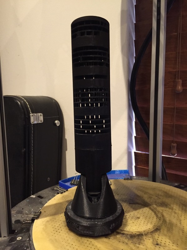

So I've had my v1 Max for a couple of years now. Had the initial rush of printing countless gazillions of the calibration cubes, torture tests and pyramids then kinda skipped the whole "printing pretty faff" thing and got down to making stuff that was useful.
All along, if it took longer than three or four hours to print my view has been:
1. Too long.
2. Design is flawed. Get clever and get it quicker.
3. Too long. Fix it and try again.
Finally though, it's caught up with me. The gnomon from a digital sundial (on thingiverse) that a mate has requested and it's his birthday on Saturday. Feck it. Not going to change the design because it's crazy and I know I'll break it. 30 hour print job, 300 or so layers of 0.1mm and the thing stretches wider on the print bed than anything I've done on it before.
Three hours, 10% of the way in and it's all going strong. Working from home tomorrow so I can babysit (for safety reasons I won't leave the house unattended whilst the printer is operating).
But I'll admit: I'm as nervous as hell...

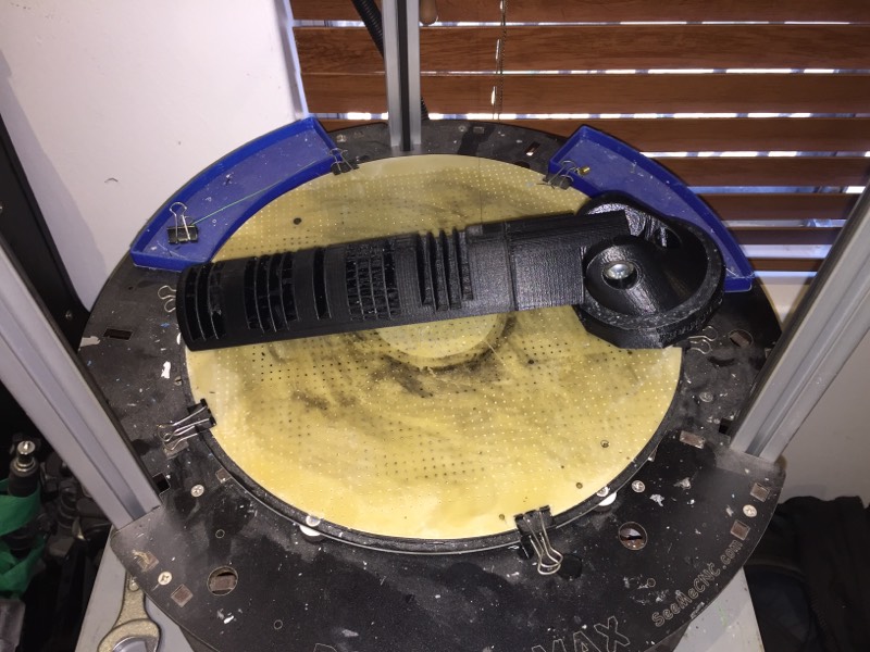

Captain Starfish
Posts: 950
Re: My first long haul print
Post by Captain Starfish »
Did someone say something something bad at cleaning? My Max is a bit of a victim of the same phenomenon :)
Came out really, really well. Used Isaac (doodaddoes.com.au) primo black ABS and the stuff is lovely. Paranoid me decided this would be a good print to use a raft and ABS juice to prevent lifting and that worked out well. The large part ended up taking about 24h and went off without a hitch. One of the couplings gave me grief when the filament spool seized up and needed a couple of goes, the rest went really well. Those three parts took another 4h each or so. I did myself no favours timewise by specifying a 3mm perimeter, but the gnomon (the long bit) has so many intricate holes and bridges in it that there wasn't really a lot of room for infill anyway.

Captain Starfish
Posts: 950
Cheers. Nervous day, waiting for something to crap out at 23 hours into the 24. Annoyed when the next part failed but so, so glad it didn't happen on the big bit.
For anyone still wondering "wtf is that?" here's the link to the part: http://www.thingiverse.com/thing:1068443 and a video explaining it all: http://www.mojoptix.com/2015/10/25/mojo ... l-sundial/
