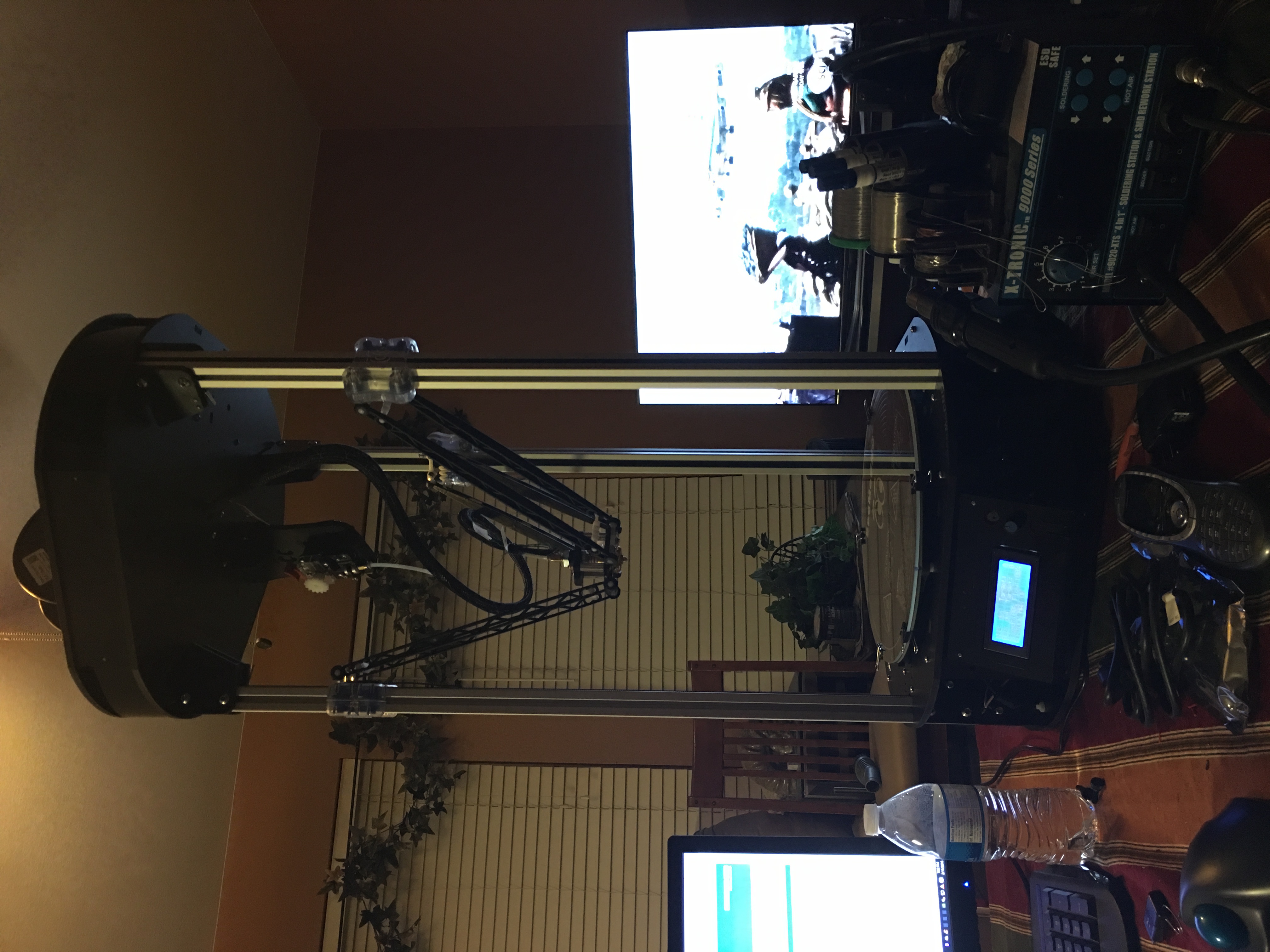

New Rostock Max V2 is alive! Well, at least in dry mode
Now a just need to figure out why my printers bed thermistor acting up...

Thanks for the pointer. I am at the initial function tests and the Mattercontrol terminal shows an error with hot bed thermistor causing RAMBo to be in dry mode. I measured both thermistors at the RAMBo connector at 68 degrees F and both thermistors have a resistance of 130k but only the hot bed shows to be in error. My next step was to thoroughly inspect solder joints on the board, any other recommendations? Is there a way to disable the hot bed so that I could move forward with calibration?

Never mind. Hot bed works now! I had it plugged into the wrong spot
