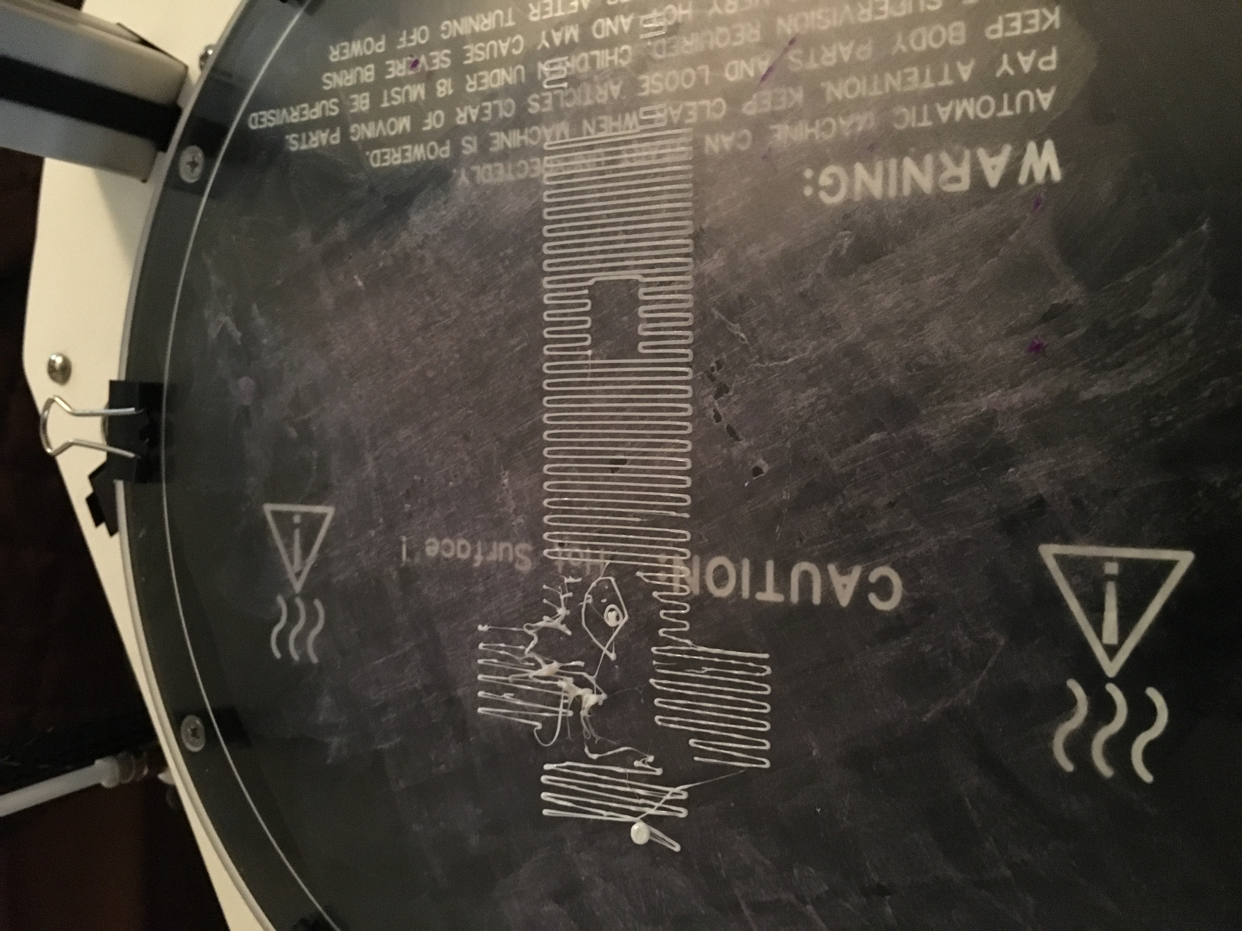

I had no issues printing the test print cube but now when i attempt to print something bigger it doesnt stick to the bed, the PLA filament just clumps up at the end of the extruder

When it does start printing it's late after the first few things haven't stuck and it does this

My printer didnt come with ABS it came with PLA blue PLA. Everything was installed for me but the LCD screen and the power cable/usb cable. I did remove the bit that is extruded from the printer when it is heating before it started its print. i did put down the glue.

Fix this tower. It looks that there it's printing a bit away from z=0

Tincho85 wrote:Fix this tower. It looks that there it's printing a bit away from z=0
i do that by running the tower script and adjusting the screw right?
Tincho85
Posts: 659
Re: not sticking to bed
Post by Tincho85 »
Yes sir
