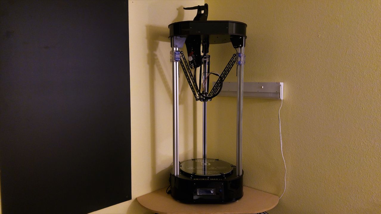

Just wanted to take a moment to introduce myself and share some progress photos of my Rostock, current and future plans, and unfortunately some user errors.

Without further however the hell you spell ado, I give you my currently nameless Rostock!
[img][img]http://s18.postimg.org/4vgqudnh1/20160111_140352.jpg[/img][/img]

I am currently down and out due to a likely shortage in my hot end fan or led wiring. After wiring up two additional layer fans, adding an 80mm angel eye led and wrapping my hot end in silicone tape I blew the F3 Little Fuse. Powered up and connected to printer with no issues, manually tested layer fans with success. With fans at 100% set hotend temp to 200C, led panel and Rambo immediately went dark, and lost connection to matter control. PSU continued to run as usual, had I been able to connect or manually control printer I would imagine that the motors would have been responsive. I switched the F2 & F3 fuses after disconnecting all attachments from end effector. LCD panel works properly, matter control connects properly, but as expected zero motor/extruder response.
Tried again multiple times individually connecting everything, heating up hotend, etc... no blown fuse. I'm guessing the problem was my led ring making contact somewhere. Out of curiosity does anyone know if superglue bridged between two contacts will create a short? I used magnets to attach the ring adapter to the end effector, and a liberal amount of super glue to attach the led ring to the adapter. It should be noted that I had the led ring successfully working while printing before i added the new adapter and additional layer fans. Im guessing I just made an error in the wiring somewhere, but if anyone has some insight I'd greatly appreciate your recommendations.

Perhaps with all the various attachments, and the need to drive the Rambo logic and LCD, you've managed to get over 5 amps? Superglue is non-conductive (so long as it's unfilled with conductive junk).

That is something I have been considering. I've seen so many similar configurations with 3x layer, led, and e3d that I had assumed it wouldn't be an issue. I have the led wired to the e3d cooling fan, and all 3 layer fans wired to a single jst connector. There is an unnecessary splice that I made in the led wiring as a convenience, rather than removing heat shrink and re-wiring.
I am definitely not an electrician, maybe this a less than efficient configuration?
