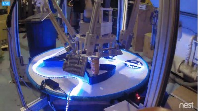

Re: Mounting hot end below the effector plate?
I just noticed that on the PartDaddy live feed (https://video.nest.com/live/partdaddy), the hot end nozzle is way below the effector.
Only "negative" is loss of Z height.
No, you don't need to change any firmware settings other than setting your new Z0.
Actually I prefer under mount, it is easier to see print in progress and I have found hot end runs cooler and more reliable.
Several of my printers are setup this way.
One thing, any play/looseness/flex in your arms, joints or carriages will be greatly exaggerated with nozzle way below platform.
As long as you have a good tight and stiff setup, you will be fine.
