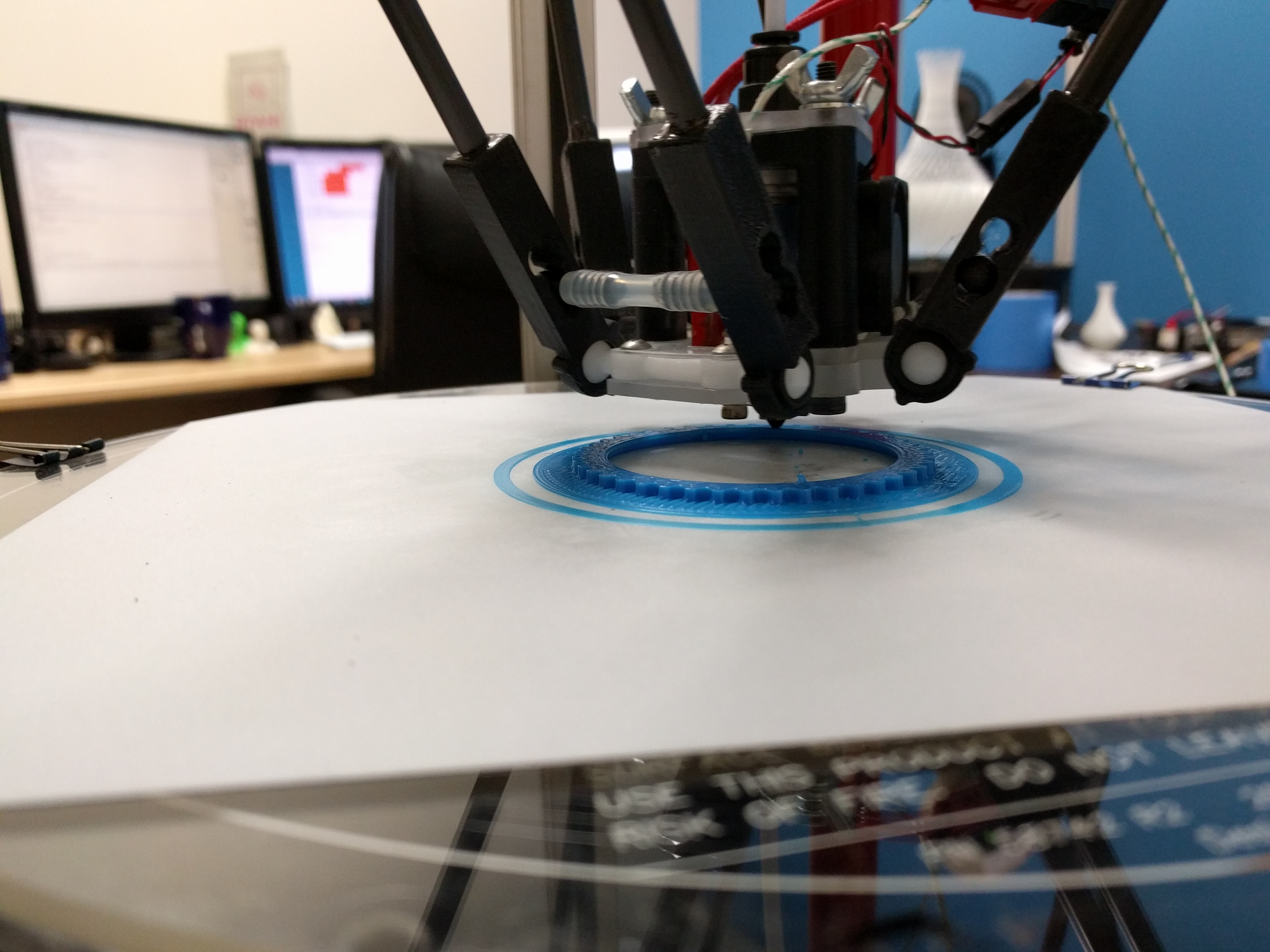

Re: Nylon
I used to print on paper. White printer papare works just well with many filaments.
I don't do that anymore since it gets messy when you remove the part, and need to scrap the paper off the glass. However, I would definitely give it a try if I ever need to print a filament that does not stick to anything else.

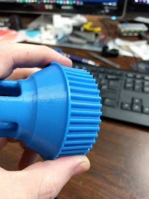

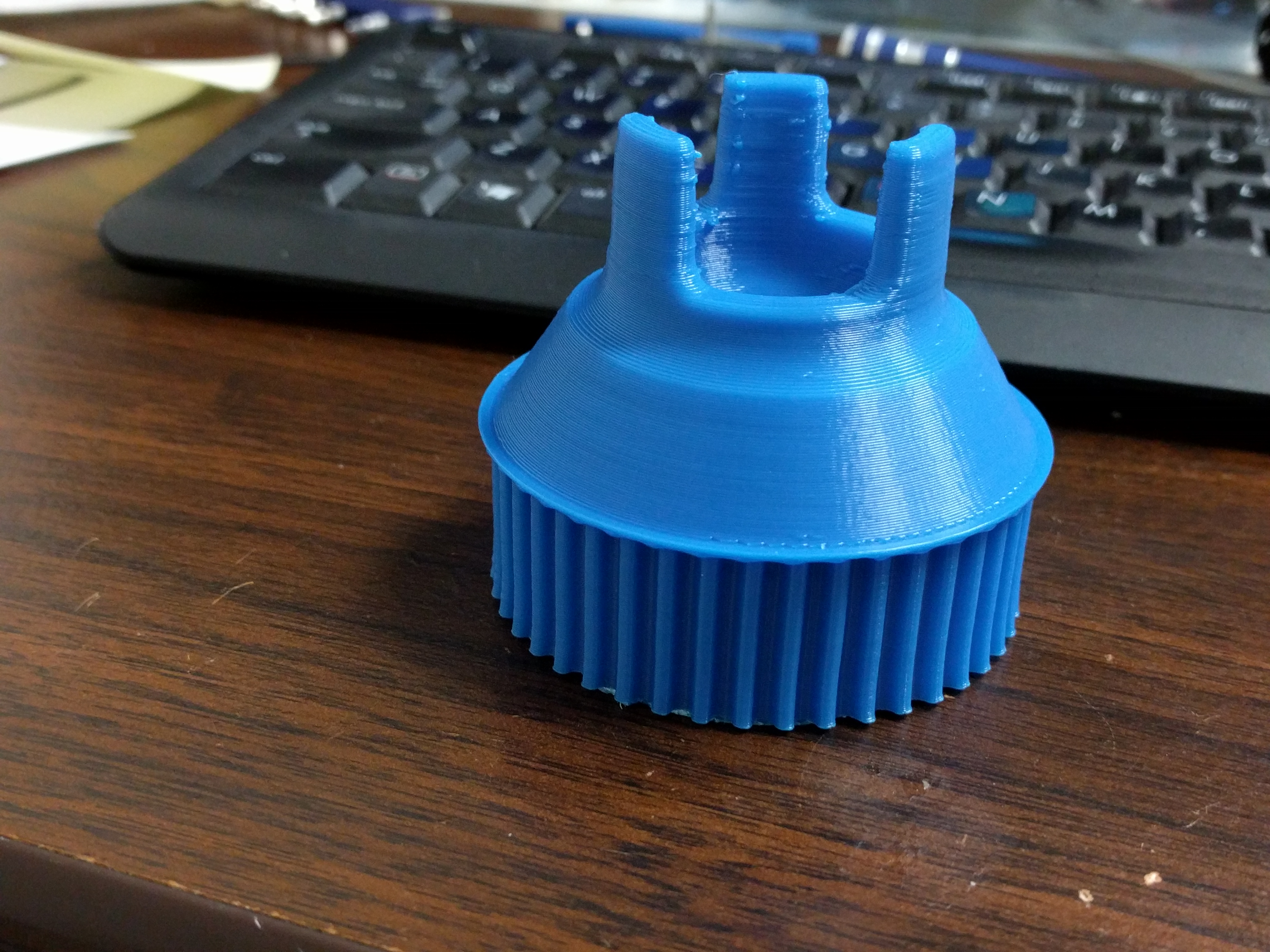

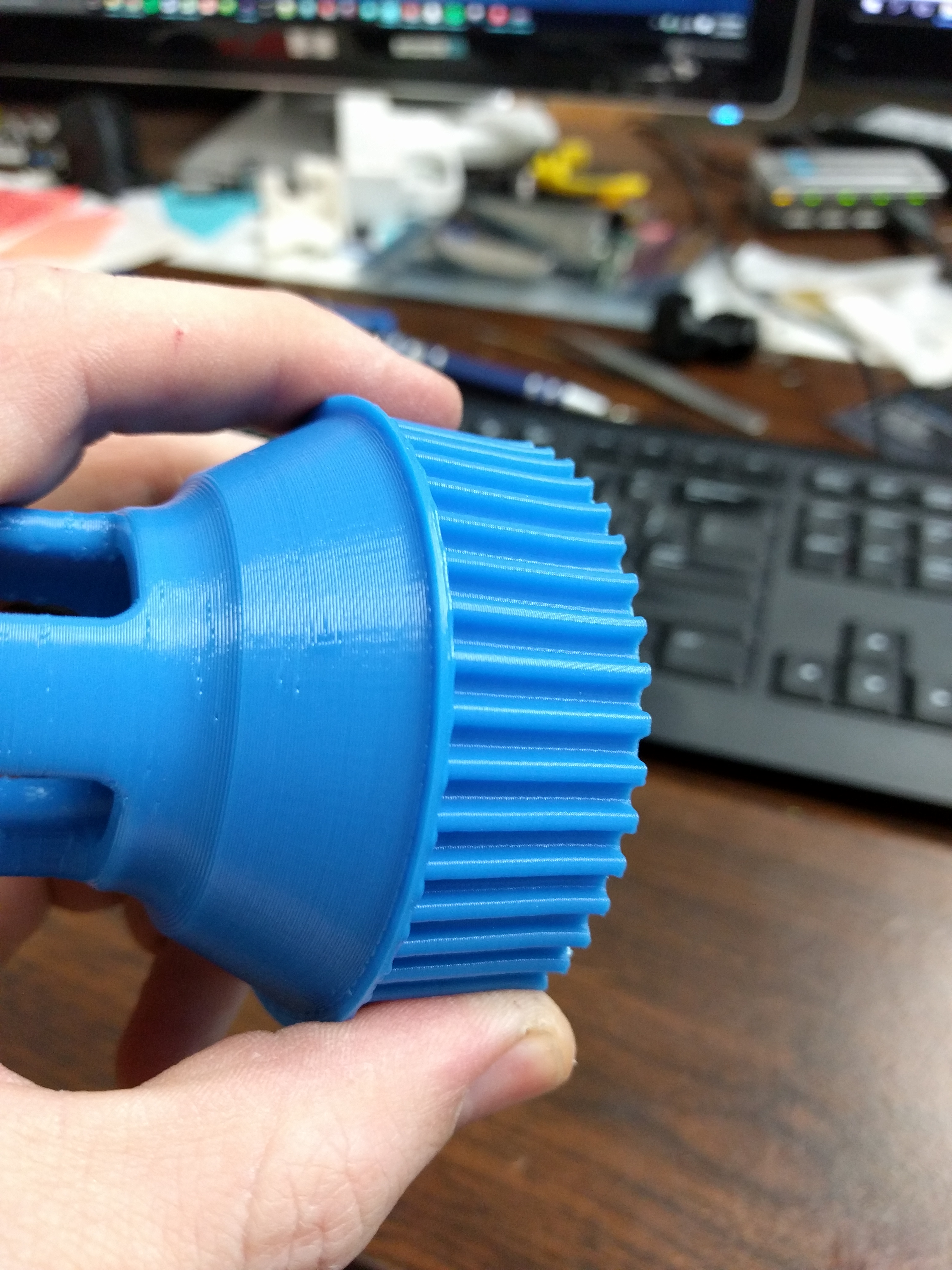

Re: Nylon
Ask and ye shall receive.
Hot off the machine in freshly dried blue trimmer line (dried in a vacuum oven @ 150F)
This gear goes on a 36v 600w electric skateboard and can take a 250-300lb rider 20+ mph for 8-10 miles.
I made and sold 400-500 of these things from 2012-2014 and I saw exactly 4 break - 2 of those were user error.
This stuff is indestructible, prints buttery smooth when dry, and has very little warp.
I modeled my part in Solidworks with a .5mm thick brim. You can see it in the first picture, and the finished piece with the brim removed.
If you pull the part off while it's still warm, the brim comes off pretty easily with a swift yank. If you let it fully cool, you need a sharp razor to trim it off. Nylon is tough stuff.
