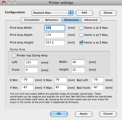

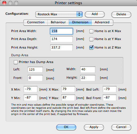

Hi,
I have a similar question here. I calibrated the z axis per the newly updated info on the Reprap wiki page and it worked great. I now connect to the machine in Repetier, send G28, jog down to 0.1 in Z and I'm right at a piece a paper width above the stickralon plate on the heated bed.
But X and Y are not saying zero even though the platform is centered. They are saying -79 and -87 (corresponding to my bed left/front positions). When I jog +79 in X from the center I get to the edge of the plate on the heated bed - actually a little short of the edge to allow for where the clips touch the plate. Similar for jogging +87 from center in Y.
The Reprap wiki says this:
My Printer Settings | Dimensions tab is attached. This is Repetier Host for Macintosh version 0.51 (47).
Barnett
Not sure where to set home to zero. Firmware has 0 for X & Y home position and 337.2 for Z:4. Also while in the Printer Shape tab, we need to change Home X and Home Y to 0 instead of Min or Max, and Home Z to Max.

Hey guys. To set the zero, you home the machine, you can do this one of two ways, the easiest is to just type G28 in the manual tab and press enter. That will send the three arms up, and they will home individually once the first arm touches an endstop. The other way is to jog up close, and press the Home icon in repetier. Do this one carfully though. By default, clicking the home button in repetier send G28 X Y Z, which will home the X tower, then Y, then Z. If your platform is close to the table, this can cause the platform to crash into the towers. G28 only uses what is called 'quick home' where all 3 axes move until one has triggered an endstop, then they home X, Y Z seperately
Re: Zeroing the Rostock Max
Sending G28 moves the carriages as you describe, and Z shows the Max position of 337.2 for me. But X shows -125 and Y shows -125 even though the platform is centered.
I can try the home button as you suggest though. Thanks.
Ahh, barnett, in repetier, open config-printer settings and in printer shape tab, set x home positiin and y to 0
I suspect the Mac version is different from the Windows version.
I'm not finding a Config menu but I do have a Printer Settings in the Printer menu (also accessible from an icon along the top).
In Printer Settings I don't have "Printer Shape" but I do have "Dimension". A screenshot of that tab is in my post from yesterday. It's not clear how to set home position to zero there.
I could try posting to Repetier.com or someplace else?
FYI: here's the reply from Repadmin to my inquiry at Repetier.com.
Indeed the Mac Host has not the needed setting. The windows host has already a setting 0 for this. Will add this for the next release if I don’t forget it For now you have to ignore the wrong resulting preview. The print will not be effected from this.
