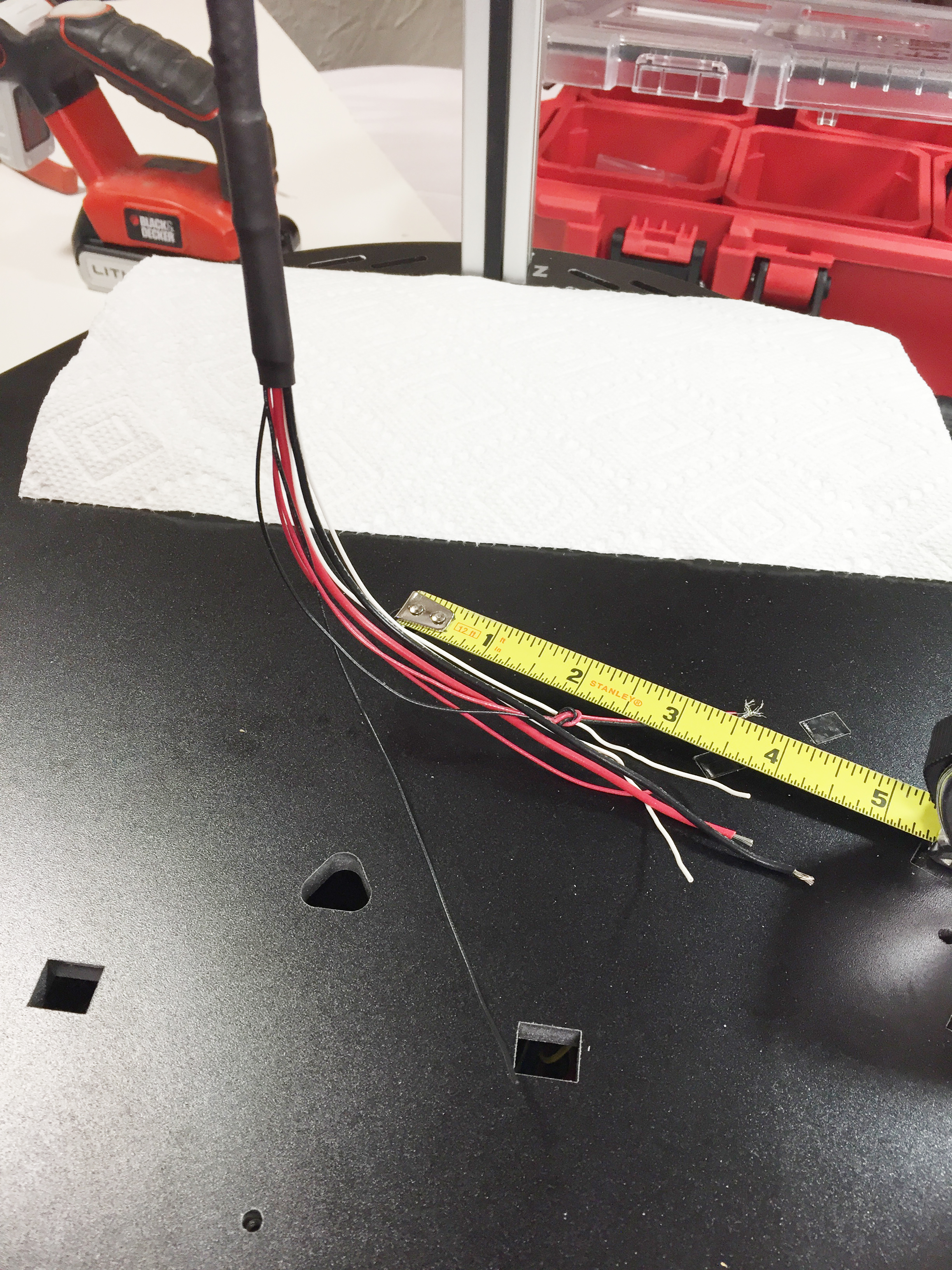

Made some good progress today.
All of the laser cut melamine parts have been separated and painted.
I sprayed shellac onto the part edges to reduce the paint absorption.
I used primer on the edges of the four largest pieces, because their edges are painted silver metallic.
The edges on all of the other pieces are semi gloss black.
The stock hot end is assembled, and waiting for the RTV to cure
The power supply is wired (the PSU's terminal orientation is 90degrees with respect to the assembly manual photo, but I don't expect any issues)
I wired the Onxy plate... No issues thanks to my trusty Hakko soldering station and lots of kapton tape
That's enough for one day.
Tomorrow begins with installing the gears on the stepper motors. I have to check to see if the gear position has to be moved out a bit before locking the grub screws, to compensate for the isolators that I am installing.

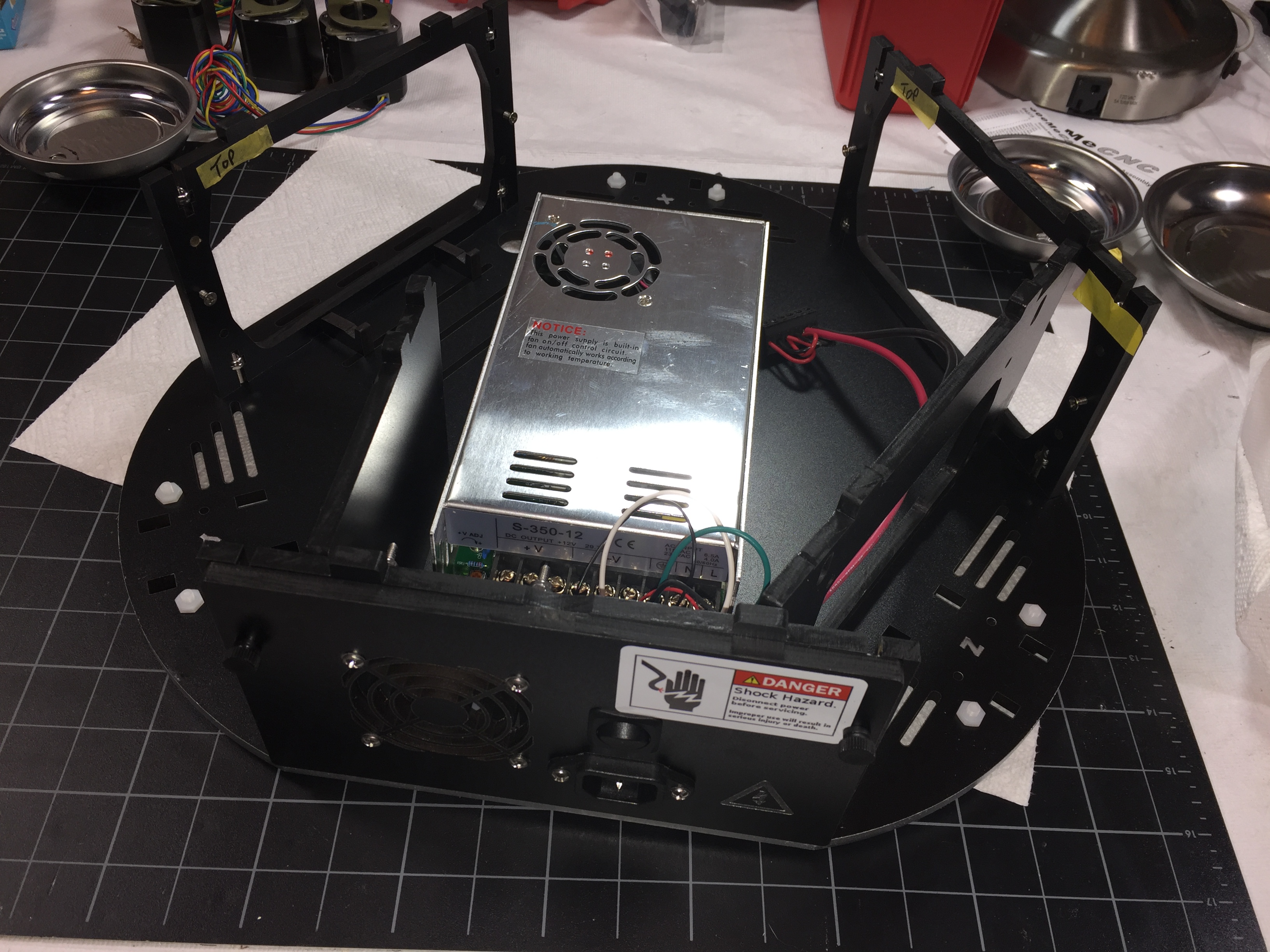

More progress.
Got all of the protective paper removed from the laser cut parts.
Mounted the gears onto the stepper motors, extending the gears out to compensate for the Astrosyn damper thickness.
Started assembling the base
Installed the power supply, connectors, switch, fan and side panel.
Began assembling the tower supports.
I got the bearings installed into their sleeves (with the help of a tapered dowel and a small hammer to tap the bearings in carefully... I didn't bother using my arbor press)
Then I hit a little roadblock, that I will unblock in the morning.

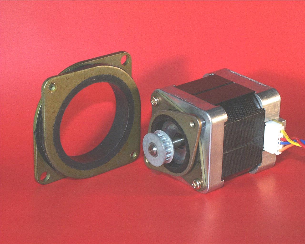

The Astrosyn dampers don't come with any instructions. I noticed on each damper, there are two tapped holes, and two slightly larger holes.
At first I thought "ah, I need longer screws to go through the melamine and the damper an into the motor"
I had some longer screws in my shop, and started to install four into the first motor.
It then occurred to me that I didn't know which was the correct orientation of the holes, and more importantly, that tightening the longer screws would compress the rubber in the mount.
This didn't seem right.
SeeMeCNC forums to the rescue. A search of the forum found a discussion thread, and now I understand how the dampers are to be mounted, and it makes perfect sense.
For those who have not already installed them.
The plate with the larger screw holes sits against the motor. The motor nestles nicely in the close fitting center hole of that plate.
Only *two* screws attach that plate to the motor. This is my temporary roadblock, I need shorter screws than the M3-10mm that ship with the machine's kit (I likely need M3-5 or shorter).
Then *two* stock M3-10mm screws go through the melamine and into the threaded holes on the AstroSyn damper.
This way, there is no direct connection between the motor and the melamine... it's got rubber in the middle.
So now it makes sense, and I will pick up some shorter screws in the morning, and continue the build.
I am continuing to shoot video footage of the build, and will put together a highlight video when I am done building.
Here's the base so far
Time to pack it in for the evening.

There's a photo in this datasheet from the AstroSyn web site that shows the two screws holding the vibration damper.
http://www.astrosyn.com/shopimages/tech ... asheet.pdf

Re: AlanZ's Rostock v2 build
I will be wiring the hot end tomorrow.
The black mesh sleeve is 26" long.
Currently the 'hot' end of the sleeve is about 3" above the melamine (the top of the base), and there is about 7" of wire exposed beyond the sleeve.
How much wire should be exposed on the hot end side of the sleeve to facilitate wiring the hot end, fans, etc.
I would prefer that it not have a lot of extra wire, but it would be nice to have some flexibility when adding fans, switching hot ends, etc.
Your thoughts?
Your thoughts?
- nitewatchman
- Posts: 624
I would suggest wiring up the hot end and then pulling the excess up into the top of the printer rather than cutting it off. If you have to reterminate the hot end for some reason, that little bit of wire could come in handy.
I agree... it's the approach I was going to take unless someone came up with a compelling reason for a particular length.
