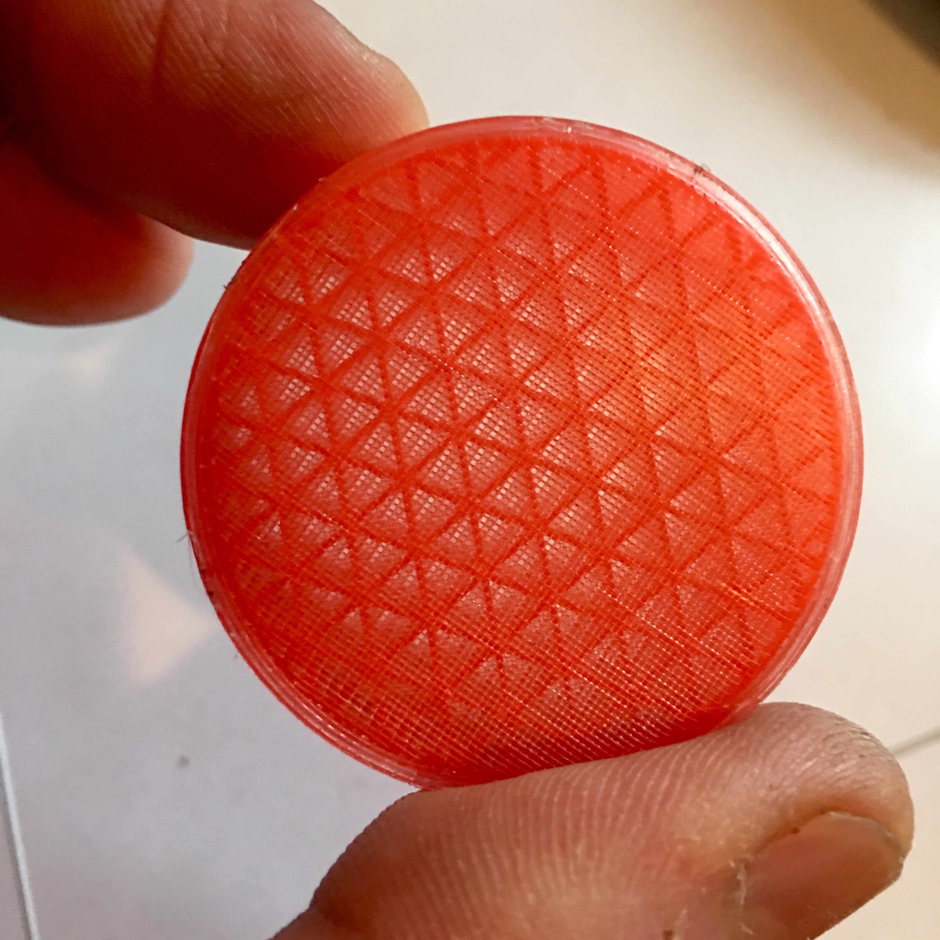

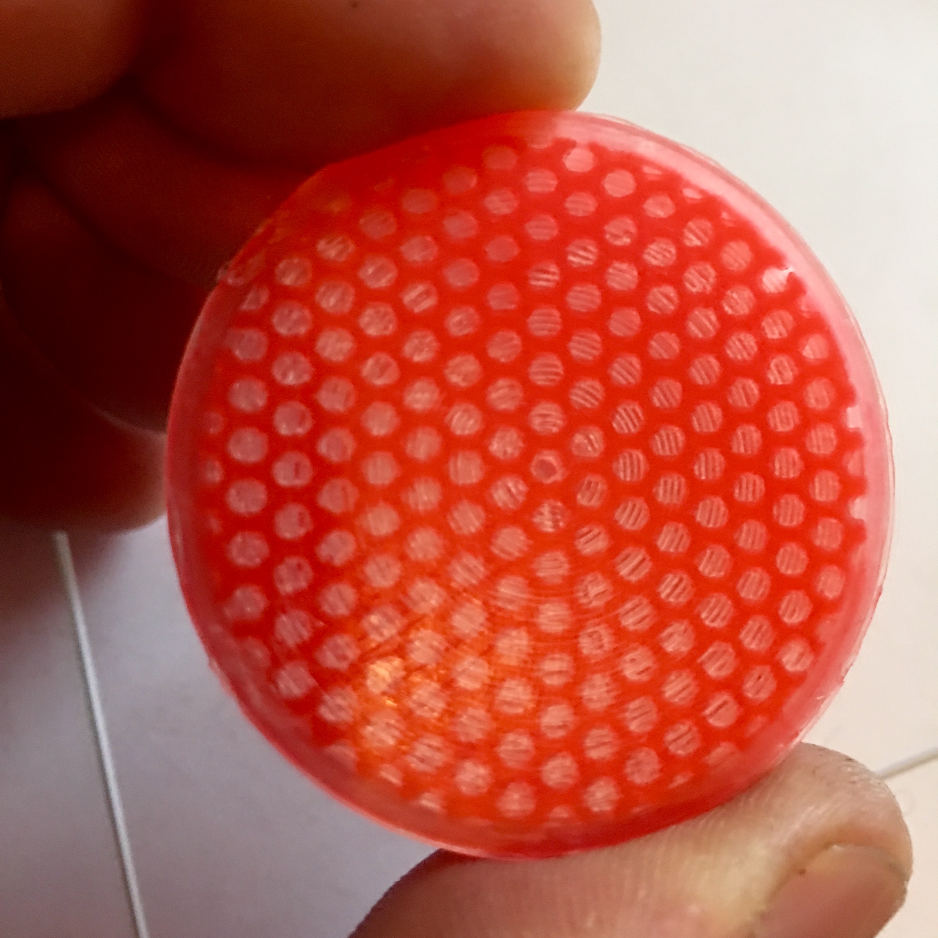

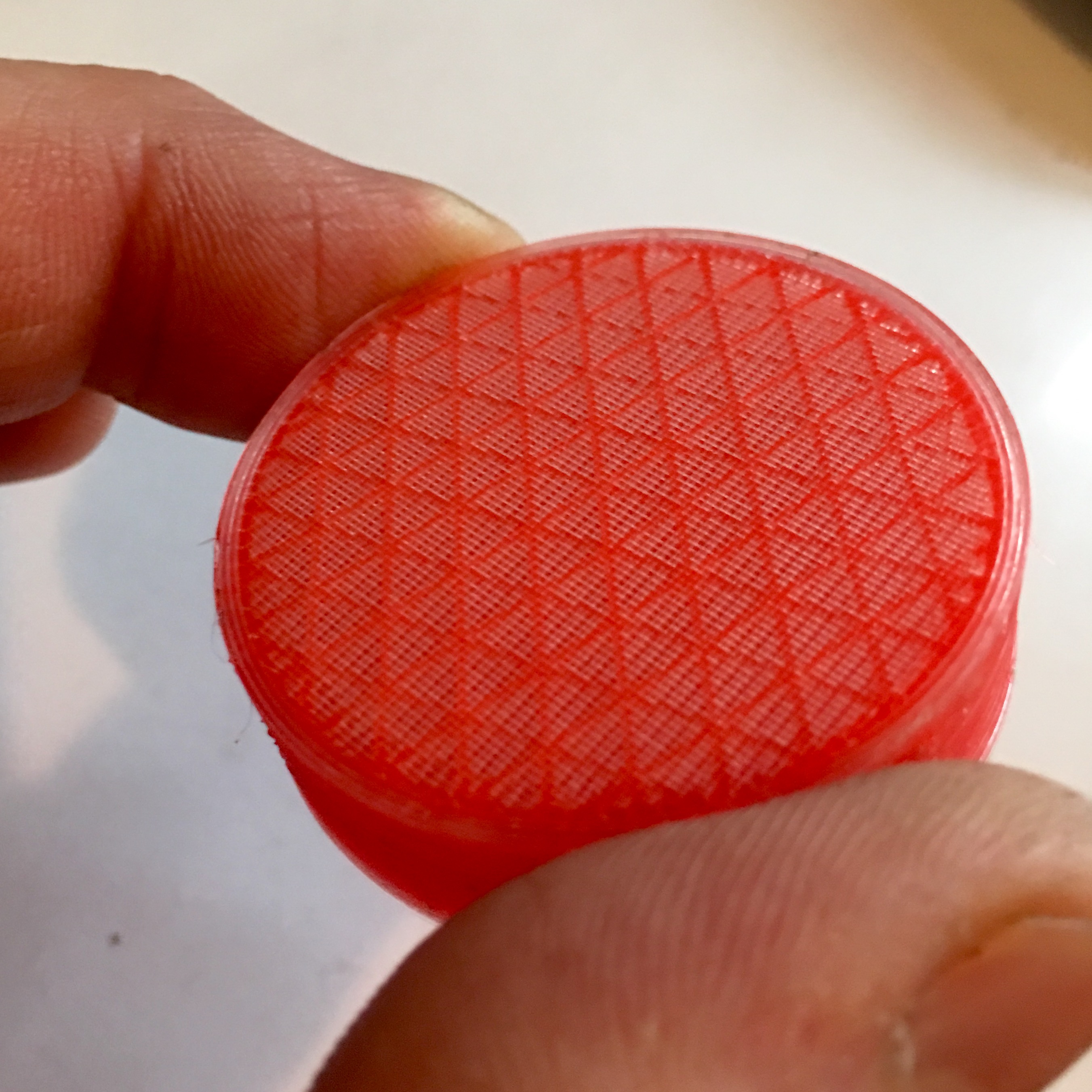

Exactly bot, I am trying to push the design envelope with multi color printing. I am working on a technique I call "kaleidoscope" that encapsulates a decorative color infill inside a transparent shell. I'm almost there. KISS doesn't allow selection of the extruder for perimeters & shells vs infill. S3D does. What I'd really like is to be able to specify the extruder for shells, perimeters and infill separately.

Here's a couple of examples of the kaleidoscope technique I'm working on.
Held up to the light they just glow. Very hard to photograph well.

I bet you could print an awesome looking beehive with this technique. Yellow honeycomb infill with the clear outside shell.
I only say this because I printed a beehive for my sister (to make a bear themed mobile for her new baby) and I secretly used honeycomb infill because it was too appropriate not to. But only I was aware. :lol:

I have some beautiful honey colored translucent PLA that would probably look spectacular.

I like your use of this idea! I often wanted to do this just to increase the amount of plastic available without switching rolls. If the print needs to be white, but I only have x grams of white, I can print the infill in a different colour and have enough white to make the whole perimeter white. Or something like that. Your idea is better. I need a damn cyclops/chimera now. :)
