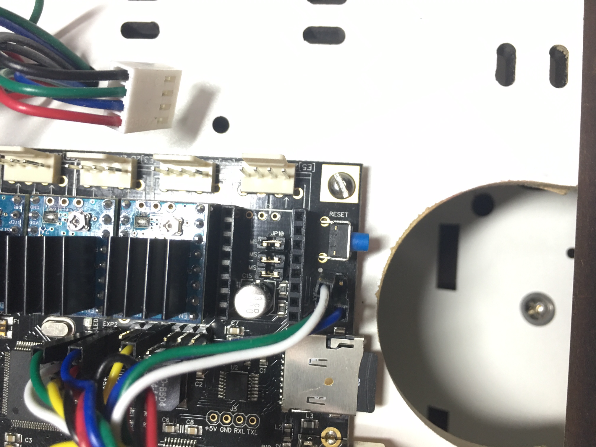

One Year ago I bought a "Panucatt Devices" an Azteeg X3 Pro Controller, and the VIKI LCD - with 8 Sure stepper drivers SD 8825.
And for One year, it has been looking really pretty - sitting on the shelve, in the box… along with the entire arsenal for the Kraken with different spare parts...
I wanted to install it into my Rostock Max V2 - but Panucatt offers only a FRACTION of the just BASIC Tech Info - to even just INSTALL their products. And I do NOT want to roll the dice with inserting the Stepper Drivers the WRONG Way!
And Email - and phone calls - to Panucatt where simply IGNORED!
Now - lucky me - the RAMbo board blew - I did trouble shoot it with the help of JJ from SeeMeCNC.
I gathered as much info as I could, I think I can connect the VIKI LCD to the board.

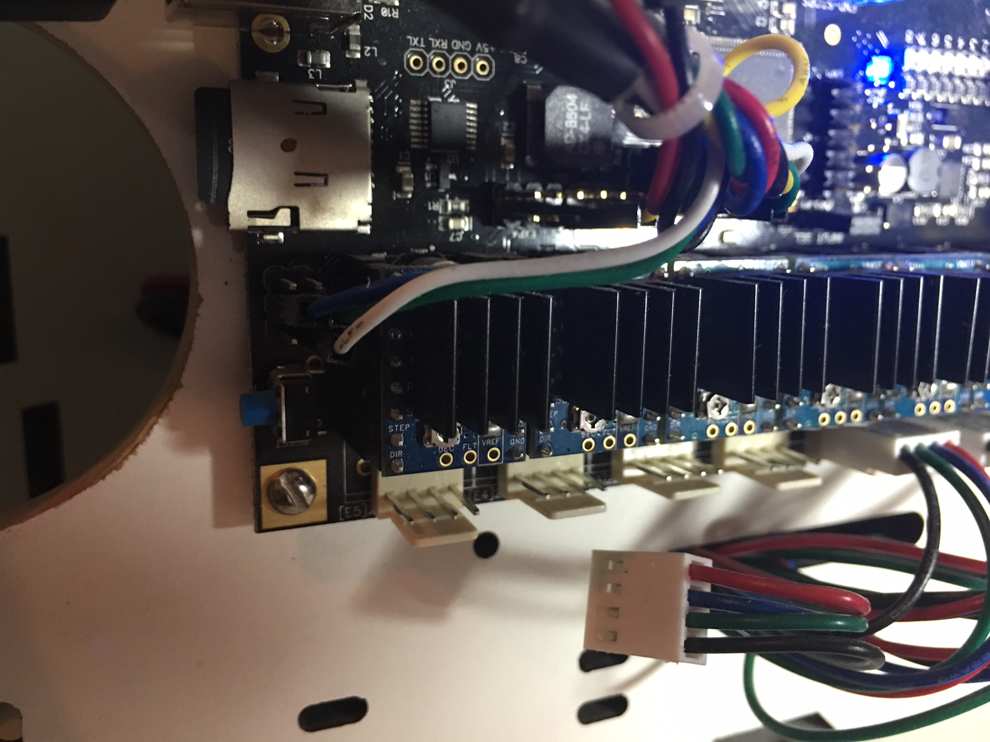

The Questions I have: How to Install the stepper drivers SD 8825?
The ONLY indication is on the "Wiring Diagram"is:
The 3 holes - for "Vref", "Fault" and "Decay" are facing OUTWARDS, AWAY FROM THE CNETER of the board - and are RIGHT NEXT TO Stepper Motor Terminals.
Is this CORRECT?
There are 3 Power Terminals for "Input 30 V Max" - Connect (loop) them if you are using a Single Output Power Supply?
Microstepping:
I know - it would be a Real Advantage.
I will be running the 3 Axes for the Delta - and 4 Extruders. For the Axes Microstepping would be good - but for the Extruders?
There is NO Switch - but some propel talk about "Jumpers" - but I do NOT see any - are they hidden?
All I see is ONE Potentiometer - but I think that is for the Max Amp Adjustment.

Ok, let's start with the stepper drivers. See this photo, the row of drive slots is at the bottom. I have heat sinks on my drivers but you can see how they are oriented in the slot.
Here's the driver removed so you can see the microscope jumpers. I am using 32 microsteps so all jumpers are installed. I run 32 MS on the extruder too.
