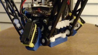

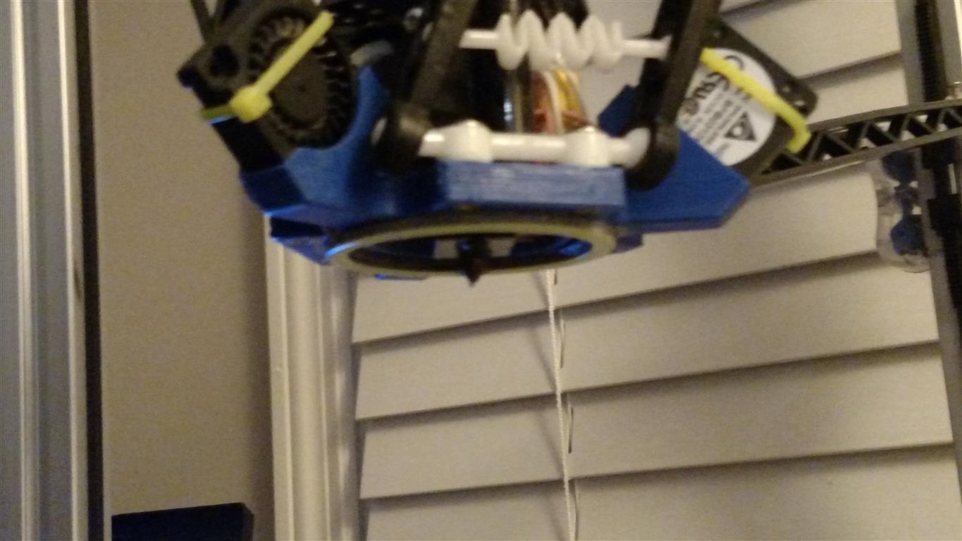

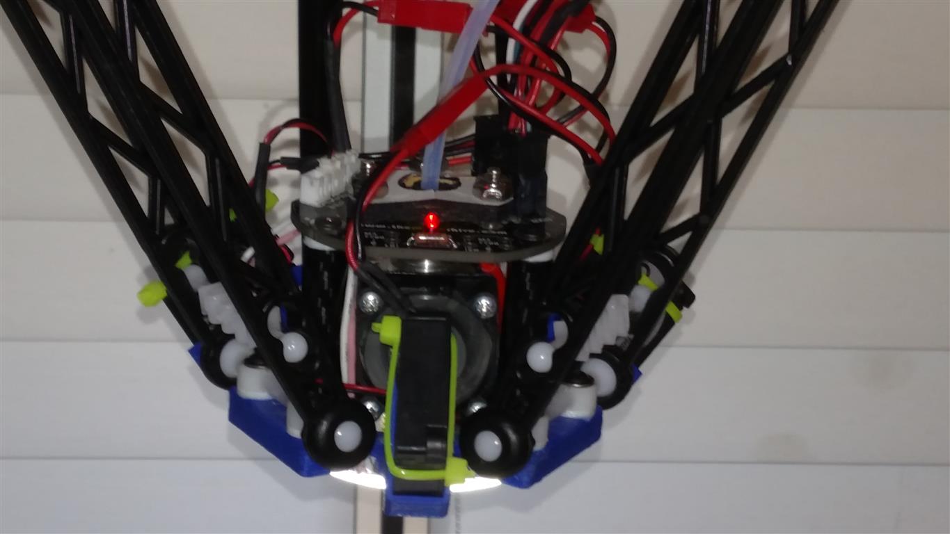

I've been kicking around the idea for a while, and a failed print that ripped off one of my fans motivated me to finally get busy. Here's what I've been working on for the past week or so.
http://www.thingiverse.com/thing:1167280
http://repables.com/r/705
[img]http://i.imgur.com/ZFqNbrR.jpg[/img]
[img]http://i.imgur.com/wfsaAj4.jpg[/img]
[img]http://i.imgur.com/uyjINbX.jpg[/img]
[img]http://i.imgur.com/tlXHXdj.jpg[/img]
[img]http://i.imgur.com/asWd1Tk.jpg[/img]
So far so good.
Ironically, since printing and installing it I've only been printing ABS and haven't used it much. Tonight I'll be kicking it into high gear on PLA prints taht need the airflow, and I'll let you know how it goes.
The design clears my E3D hot-end fan, has flats big enough to fit TravelPhotog's aluminum mount standoffs, and should fit stock V1&2 axles, Trick Laser carbon arms, and *I think* will also bolt up to the new ball and socket arms. I haven't tested that last one, but the holes are in the right place according to the STLs on GitHub.
Anyway, if you're looking for an effector or a fan or both, print away. Enjoy!

Re: Effector Platform - Fan Duct Combo
Jim, you might want to spin a new version of that so it has the posts that the ball arms fit on, otherwise centering them on those holes will be nearly impossible.
I was thinking about a bushing with a flange or something like that... You're right though. The new arms are different enough that they warrant a remix.
Printed the effector duct and modified for ball joint arms. Added bosses for the ball end bars, brass inserts and ring light. Works quite well BUT parts are now printing large by 2%, go figure.
I am adjusting size back down by shortening arm length to something less than 290.8 but this seems like the wrong way to "fix" the problem. Kinda like offsetting the error by intentionally entering another error.
Any words of wisdom from a been there, done that vantage point.
You made the bosses for the ball joint arms centered over the axle groove, right? The holes that I put in the grooves were to align with the ball joints, and the other two holes were for axle clamp screws.
						- nitewatchman
- Posts: 624
Exactly, and the arms fit over the bosses quite well vey snug and good center to center. Centered over the grooves should maintain the same arm geometry.
Must be science that I don't understand. For example, I don't understand the science behind color television but I can sure can watch it.
Good job on the effector.
I think that Jim's Ducted Effector will do what you want quite well.
I have been running the printed unit for about month now and I am quite pleased with the compactness and the uniformity of the cooling ducts. I run cooling on all PLA parts and any ABS parts that have fine details or thin sections.
The posted .stl provided vee grooves to accept the axles and u-joints that you currently have and I think that it is dimensionally correct. The unit in my photos uses the newer ball end effector and I just modified the .stl to accept the bosses at the same radius as the vee grooves. This is not quite correct. Placing one of the new ball end effector plates on top of the older axle effector plate shows that the holes have in fact moved out. I compensated for this by increasing the arm lengths by 3 or so mm but eventually I want to make it correct.
My effector shown in the photos uses three layer fans, an E3Dv6 Hot End, Yellow Jacket Quick Connect Board, LED Ring Light and CFT Supports. The design prints very well and easily without any problems in the internal chambers.
Weeeeelll almost.
I modified Jim's .stl by filling in the vee groove and using the holes he had placed there to locate the bosses for the ball arms. These were all printed in ABS and the bosses Acetone bonded in place. I then inserted 3mm heat set brass inserts into the bosses to attach the arms. Everything fit fine but after assembling the effector, it printed off size. The holes in the effector for the ball ends would appear to be outboard of the original vee grooves. I compensated for this by increasing the arm length from 290.8 to 294.5 but I want to get a new effector printed to use the standard arm length.
Other than that it is a good very compact effector.

I just printed the Effector bLITzJoN created and am in the process of using it to mount my E3D-v6 onto my Max using the 713maker.com mount.
My question is does the E3D sit okay on the Effector or is it too low to where the fan ducts will compromise the performance of the hot end?
[img]http://i592.photobucket.com/albums/tt6/ti9327/Rostock%20Max%20build/th_20160314_161959755_iOS.jpg[/img]
[img]http://i592.photobucket.com/albums/tt6/ti9327/Rostock%20Max%20build/th_20160314_161955489_iOS.jpg[/img]
[img]http://i592.photobucket.com/albums/tt6/ti9327/Rostock%20Max%20build/th_20160314_161952622_iOS.jpg[/img]
