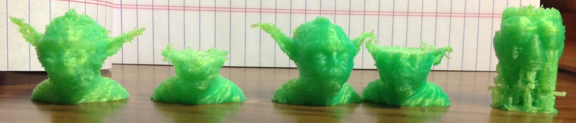

New H1.1, I have sometimes managed to get a Yoda head, but I am having a lot of trouble getting the first layer to stick.
I am using PLA (nozzle at 200 C) on an unheated bed with 3 layers of blue tape (3M #2090). Repetier Firmware for Rambo using Repetier Host Mac with Slic3r. First layer is 200 microns and I have tried speeds as slow as 5 mm/s and as fast as 60 mm/s. I have tried with the head scraping across the bed and obviously too high as well as the right height. I have tried doubling the extrusion flow rate.
Nothing sticks.
Any suggestions? Should I be running my nozzle hotter/colder? Moving faster/slower? Something other than 3 layers of blue tape? Laying down a raft (how do you do that in Repetier?)?

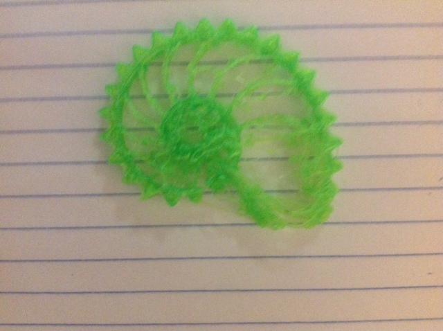

Re: First layer not sticking to bed
Thank you. The rubbing alcohol was a huge improvement. Most of my test object (the nautilus gear) stuck to the bed this time. Full fresh tape, then wiping with alcohol, will probably make it even better.
Apart from the partial non-sticking, the biggest problem is a lack of solidity ( i wanted 100% infill but the strands inside the gear teeth have gaps between them, and the weight of the piece is less than 3 grams, whereas based on slic3r it should have 3.1 cm^3 -> 3.9 grams of plastic.) There is blobbing and threading, and the extruder has a tendency to stop feeding partway through a run. But now that I have adhesion, I can work on those other problems.
Those nautilus gears are tricky. I had to slow everything down on first layer to get it to stick.
It sounds like Slic3r may not be extruding enough filament. This could be because the steps/mm is not calibrated correctly or because Slic3r is not calibrated correctly.
If the extruder stops feeding, it could be jamming, slipping, or the PLA filament could have absorbed water.

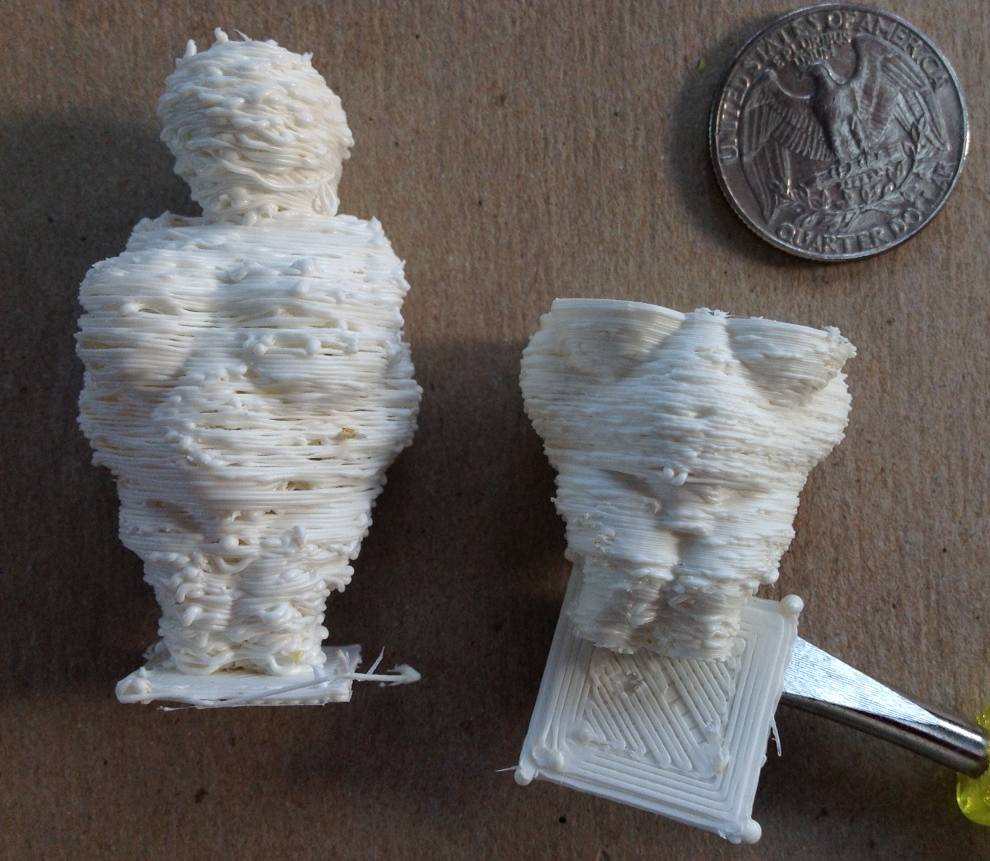

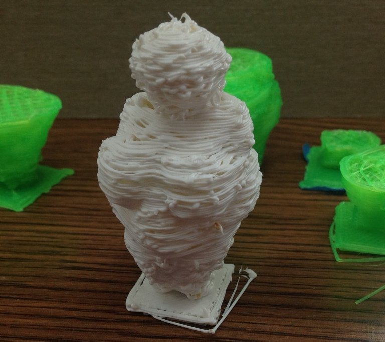

I added a a fan to the hot end, and I still keep getting jams. When it jams, I can just pull out the fiber, snip off the end, feed the end back in, and there's no more jam.
I got some ABS and it worked the first time. (Not very good surface texture and I was fiddling with the temperature along the way, but my neolithic porn now has the sexy sexy head of a hot brainy temptress who can build fire and chip stone.)
Printing at 250 C, 200 microns, 5 shells (vs. 220 C, 400 microns, 3 shells; both cases had 30 mm/s perimeter speed) made a much nicer surface texture. However the ABS filament jammed.
In this case, the jam was due to uneven filament. Just above the jam, the filament was 1.82 microns, which was too thick for the pinch rollers as I had them set. 30 cm further on, the thickness is 1.62 microns. Is this an appaling incosistency, or it is about what you would expect?
(Edit: The filament was white 1.75 mm (nominal) ABS from 3dprinterstuff.com via ebay.)

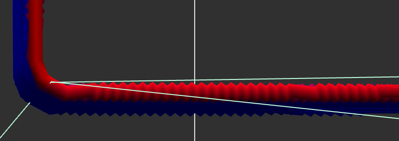

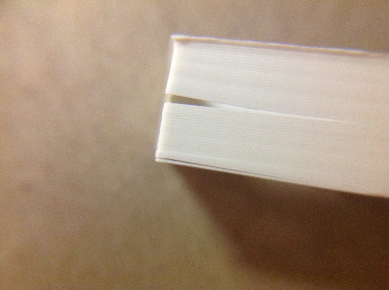

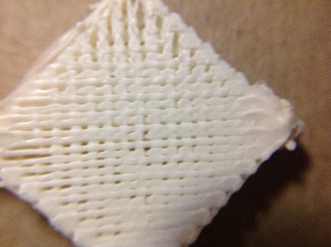

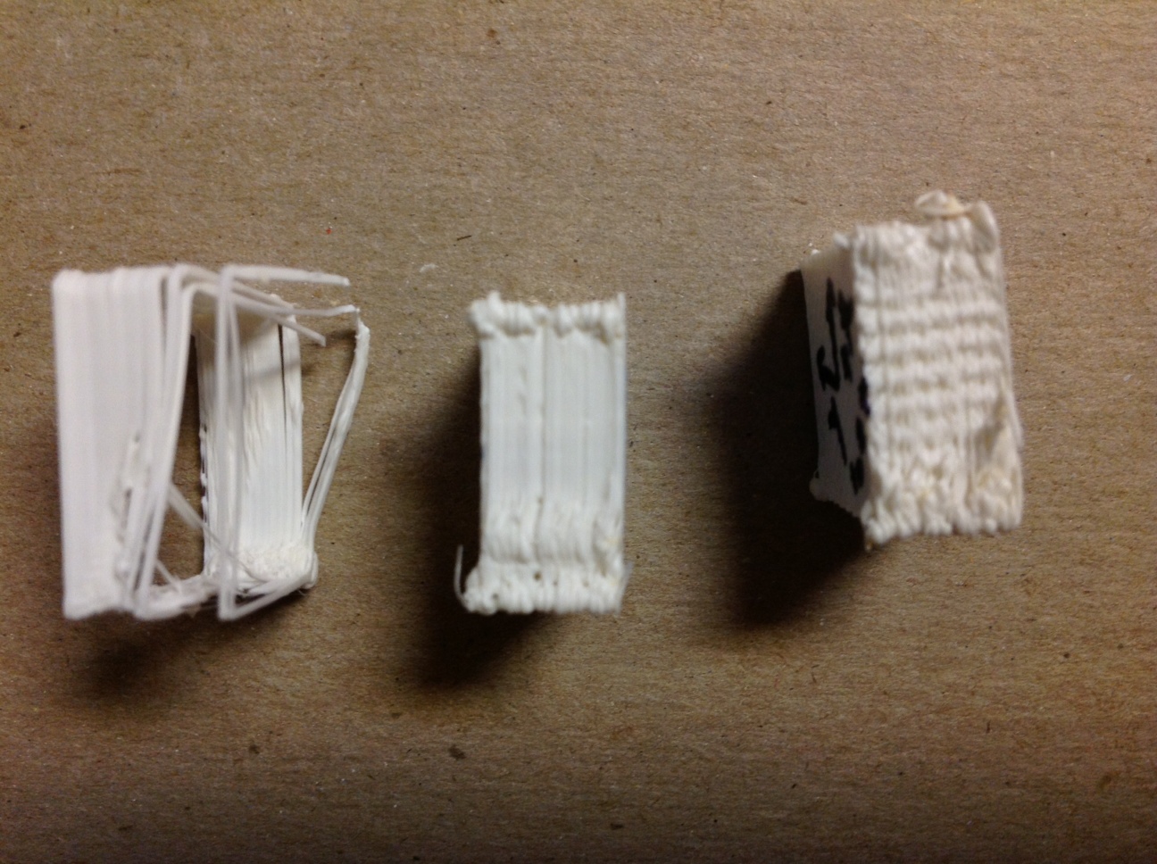

Here are the thin wall, 20% infill and 100% infill calibration pieces, all at 200 micron spacing. Dropping the 100% piece in water, it is about 90% dense. (It floats about 10% above the water.)
For the thin-wall, the Slic3r did sometign strange, and sometimes it zig-zagged when it drew the wall. I could see it slow down at that point in the wall, hear it change tone, and it shows up in the Repetier g-code visuallizer, but not in the STL visualizer.
Which version of Slic3r are you using (many versions have significant bugs) and what speed settings I would suggest finding a copy of 0.72 it was the most stable and still has the best surface finish.
How do the parts measure?
Let's concentrate on the single wall test piece first, if that's correct, then the rest should be easy.
It's hard to tell from the pictures, but it looks like you are not getting consistent extrusion, I'd try increasing the tension on the pinch rollers, slow down the print, you can usually feel the filament stop feeding if you rest your finger on the point it enters the extruder.
On the 100% object, the easiest thing to do to see what's happening is abort the print half way through, and look at the infill.
With slic3r 0.9.5 (the latest: I couldn't get 0.72b to work due to the difference in available options in my config files) I tried the 100% fill again and stopped it in the middle. Here's what it looks like using a loupe in front of my iPad camera:
I couldn't get Slic3r to not make wiggles in the walls of the 0.5 mm wall calibration object. However, when I have it do the 6543 cube (Thingiverse #1543 by Da3v) the walls are straight and smooth in the g-code rendering. Printing it slowed down to 10 mm/s (vs 30 before) at 250 C in PLA, I get nice smooth walls except at the origin corner (where it starts each layer height). However, there is some layer separation, probably due to the curvature of the base layer I see from my unheated bed.
Slic3r predicted 233 mm, so I measured that off and marked it, and the run pulled down to about 3 mm before the mark (i.e. 230 mm), so that feed rate is better than 98% accurate so the rollers don't seem to be slipping for this run. (When it hit the thick part of the filament previously the feed stopped turning and the motor rattled, but backing off the spacing between the rollers seems to work.)
Exterior dimensions are good (19.5 x 19.4 mm). Wall thicknesses are 0.47 0.56, 0.60, 0.64 mm (with +/- 0.03 variation depending on how I measure it at different places on each wall.) Nominal wall thicknesses are supposed to be 0.3, 0.4, 0.5, 0.6 mm. I don't know how good the thickness tolerance is supposed to be, and of course the variation in the filament diameter will make it hard to get good absolute thicknesses.
That's WAY to hot for PLA if you're getting a reasonable temperature reading. Are you sure it's PLA, it's relatively uncommon for PLA to delaminate like that, it's relatively common for ABS.at 250 C in PLA
Depending on what sort of PLA it is, it should be in the 180-200 range or possibly 200-220 range.
The single wall test looks like a good start, make sure you are printing on blue tape if you don't have a heated bed, you'll probably also have to print the first layer a little lower than ideal to get good adhesion.
Exterior dimensions being within 0.5mm is about what I'd expect.
With Slic3r the walls should all be the same thickness, not .6 .5 .4 .3, the number it should be is the single wall extrusion width noted at the top of the GCode file, not the thickness of the walls in the model.
Rather than using the 0.5mm calibration piece use the solid cube, but set infill and solid layers to 0 to get a single wall piece. The extrusion width should match the value noted at the top of the generated GCode. Adjust the flowrate in Slic3r to get it close.
The 100% cube looks like you are getting inconsistent extrusion, for now, slow everything down (including infill) to whatever rate the single wall piece was printed at. Once you can get decent quality pieces printed, you can start increasing the speeds, and fix whatever mechanical issues come up.
