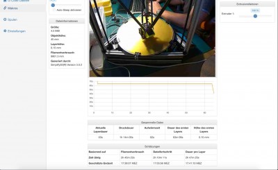

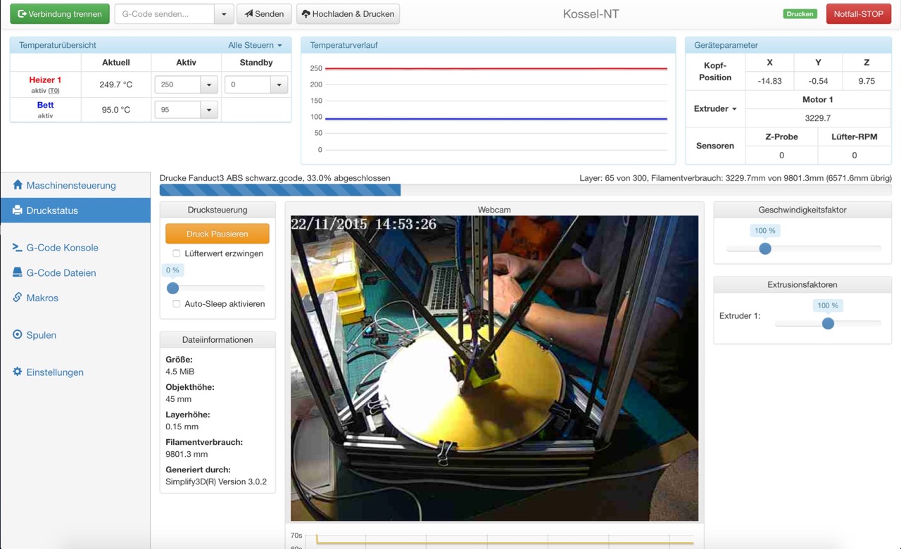

Hi All,
I was tired to go every 10 mins to the workshop so I integrated a videostream to the Web Control to check the progress from the living room...
just inserted a div-section into the original html with the link of the videostream. Now I can see the statistics and the live picture:

Great_Thark wrote:Awesome. Any chance of an idiots guide for how to do this.
Simply install the new Webcontrol version 1.10. Video is now integrated.
https://github.com/chrishamm/DuetWebControl
And check out Chris´s lasted Firmware Fork. Amazing!!
