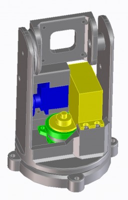

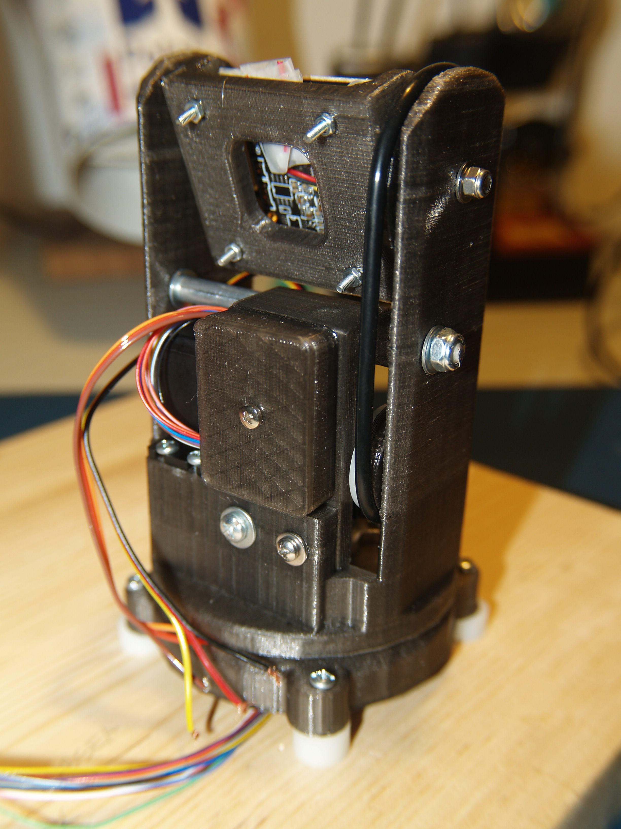

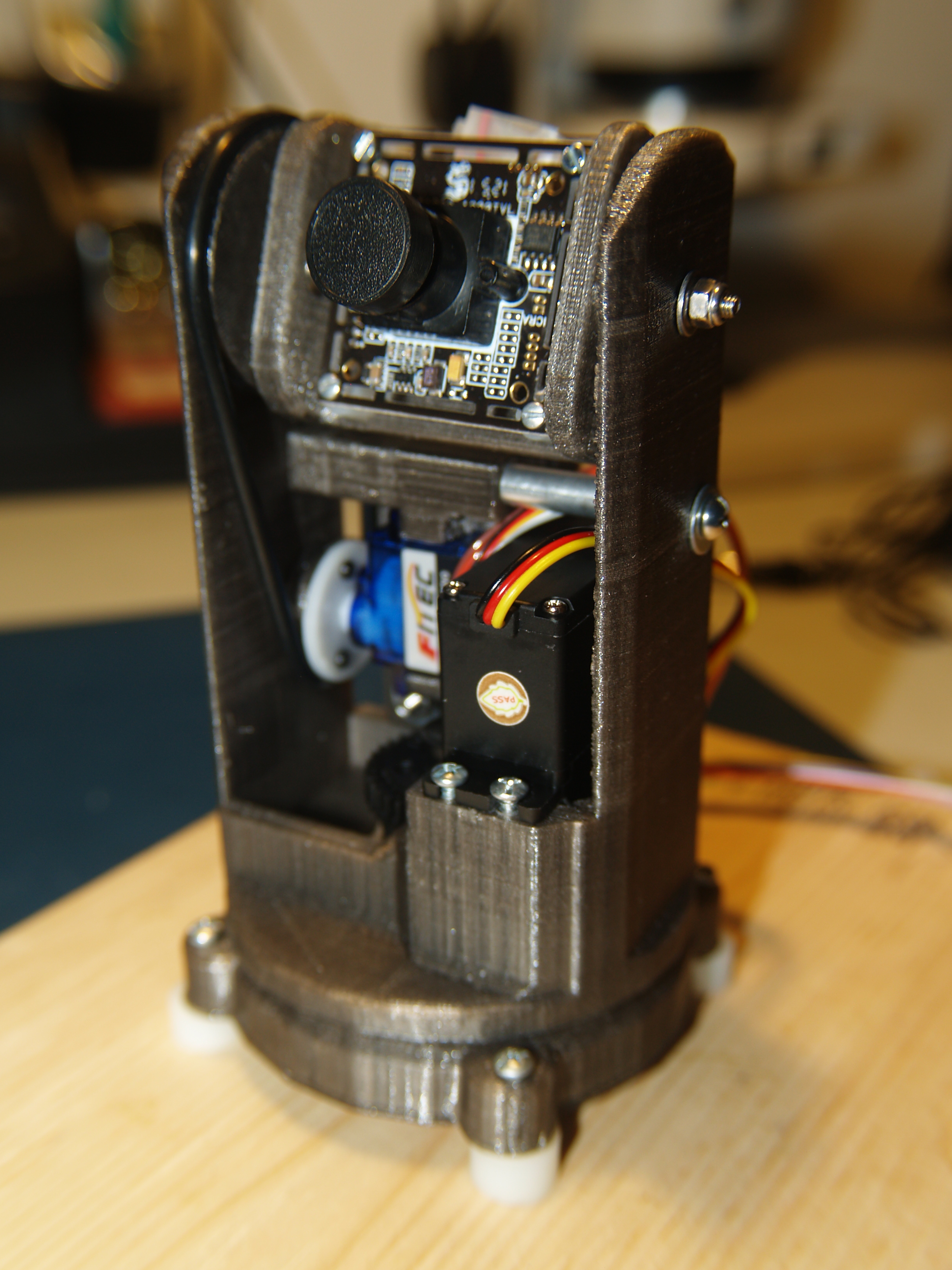

here is a pan/tilt video camera platform i've been working on. uses RC continuous rotation servos for pan and tilt. still have to add some limit switches for tilt axis.
has a rotary slip ring on the pan axis for continuous panning. Made using an orion delta and T-glase all around. This is the first print, came out fitting pretty well could use a few tweeks
for better fit. Will be used in a subsea drop camera facing downward thru an acrylic dome view port. Designed in creo cad element express.
- Captain Starfish
- Posts: 950
Re: Pan and Tilt camera platform
Nicely done - how are you getting the camera signal through the slip ring (given high data rates, everything becoming an antenna etc)
I have tested the slip ring with color video camera ntsc analog signal and the servo power and signal at the same time without any problem. The slip ring data sheet says there are 12 rings so I placed the video power and signal next to each other and the servo signal and power next to each other instead of mixing them up. The slip rings has 12 conductors, 12 rings, got it off ebay for about 9 dollars, its part #
is SNM012A-12 FROM http://www.senring.com

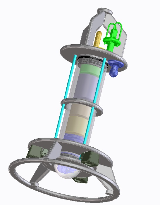

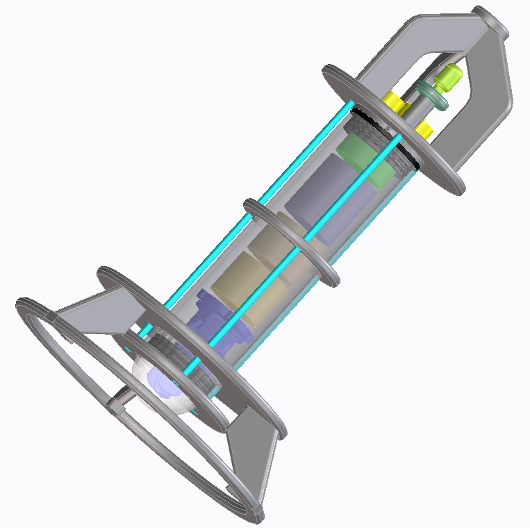

oh no now you got me started!, The sub is almost an ROV, it is a drop camera that may be upgraded to an rov in the future by adding (4) BlueRobotics thrusters. It uses a 4.5" O.D. acrylic tube and dome housing by BlueRobotics. The tube is oriented vertically with the dome facing downward. The p/t cam looks out the dome with lighting mounted external to the tube while another pan camera looks out the side of the tube ( possibly a hacked GoPro 3 which can supply live video as well as take high res clips and stills). The subsea end runs off a battery pack and has basic sensors (depth, compass, temp, etc ) as well as a sensitive hydrophone to hear marine life, mainly whales. Everything subsea is run by an arduino Mega 2560 and custom shield. Control and telemetry is over RS-485. A modified Cat5 cable is the tether with one twisted pair each for video, hydrophone and rs-485 plus ground. Topside is another arduino mega and uno for control via a game controller and all data on a video overlay screen. The Orion 3d printer is invaluable in the project and i plan on making more parts using it. As well a a local fellow who has a cnc router to make the drop cam framework out of plastic sheet. All this is for a local non-profit Marine Science Center to use in their program with youth and adults offshore on a boat, so far they can only see and hear whats happening on the surface with the drop camera they can get a peek underwater , at least up to 250 ft deep.

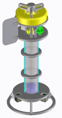

here is a cad rendering of vehicle with frame and payload less lights and a few sensors

Why not use non-continuous servos and have the limits set in software as the servos will have absolute positioning.
I will post more pics and info as it develops and time allows, If you have need for specific info let me know, i will try to accomodate.
When complete iwas thinking of posting all files cad, code, pcb schematics etc on a file sharing.
thought of using non-continuous servos with position feedback. For the pan axis i choose continuous because the cam platform needed
to turn 360 degrees plus via use of a slipring, that way if you are following something with pan motion you don't have to reverse direction an go back around.
On the tilt axis a postion feedback servo might work with a homing limit switch since the platform is belt driven for that axis, but
i was concerned about belt slip so opted for continuous with two limit switches.

Also worth noting that these style rigs tend to spin on the tether and rock and roll on both pitch and yaw if there's any surface movement or surge. Quite different to an ROV where a lot of the motion is translational but the tether doesn't have such a massive influence. So your reference frame is the surrounds based on the image, not the body of the unit. 'Absolute' positioned servos referenced to an unconstrained, randomly twisting and rocking platform, have absolutely zero advantage in this application. But continuous (as Tinker12 has mentioned) certainly has an advantage. You could probably add an inertial package to provide some stabilisation but it won't be capable of holding the image still - errors will creep in fast - and, given operator input's required anyway plus the relatively low frequency of the positional noise then inertial stabilisation is probably overkill.

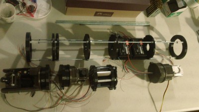

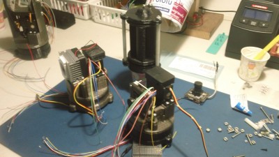

Pan and Tilt camera platform update
got to love these 3d printers!

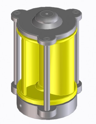

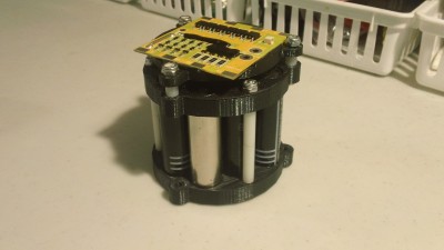

printed two more servo pan units for LED light and a video camera placed in acrylic housing also decided to make a rotor vane type water current meter, worked out great, printed at 70 % infill will with black t-glase
will use a coating to water seal. http://www.smooth-on.com/index.php?cPat ... baj3pter00.
Current sensor uses magnetic bearing for very low friction, just used ring magnets similar poles facing each other on top and bottom with a pin thru center.
Have lengthed housing tube from picture to accomodate all stuff it is now 24 inches long 4.5 inches diameter.
orion printer works like a champ. Had slight problem with center pin for servo units not being perfectly true along the center axis, a little tilt, i.e. tilted as it is printed upwards from base, does anybody know what causes this?

here is updated dropcam design with recently 3d printed parts. have be using t-glase and recently esun petg for material with very good results.
have printed parts with upto 90% infill (top and bottom rings on rail mount) for very strong parts. Things i would use to make out of HDPE sheet
now i just print, much easier to let the printer do the work!
