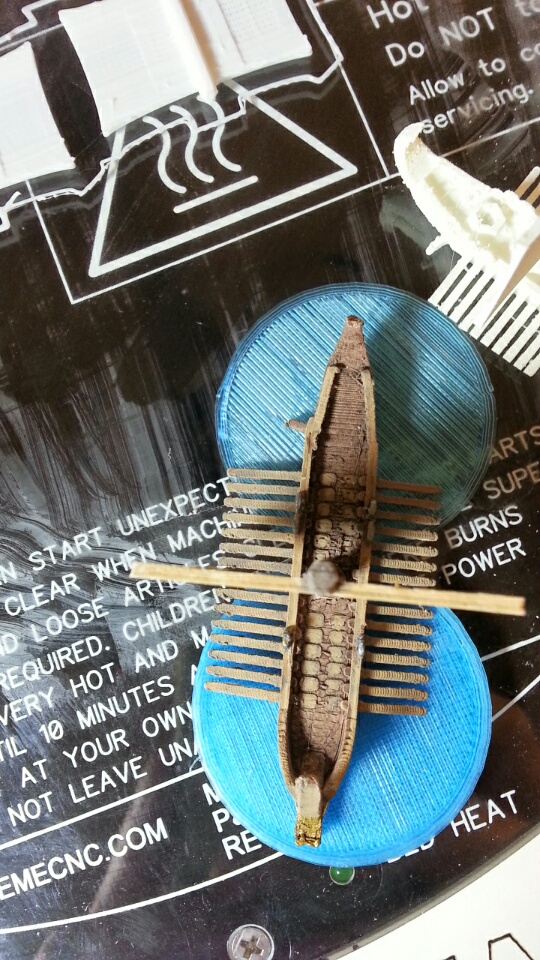

I did some extensive research and modeled this Carthenian Triaconter. It's missing 10 oars per side, but I need the ship to be little shorter in length so that the larger ships still fit into the hexagons (yes yes, i'ts not 100% historically accurate, but concessions must be made at times!). I'm working on a table-top gaming concept and fleshing out the models. This is the first one. I approached it in sections that get chained together (bow, stern, rowing sections) and will also be adding Triremes, Biremes, and a capital ship Quinquereme. I hope you like my first print of it!

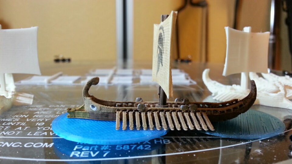

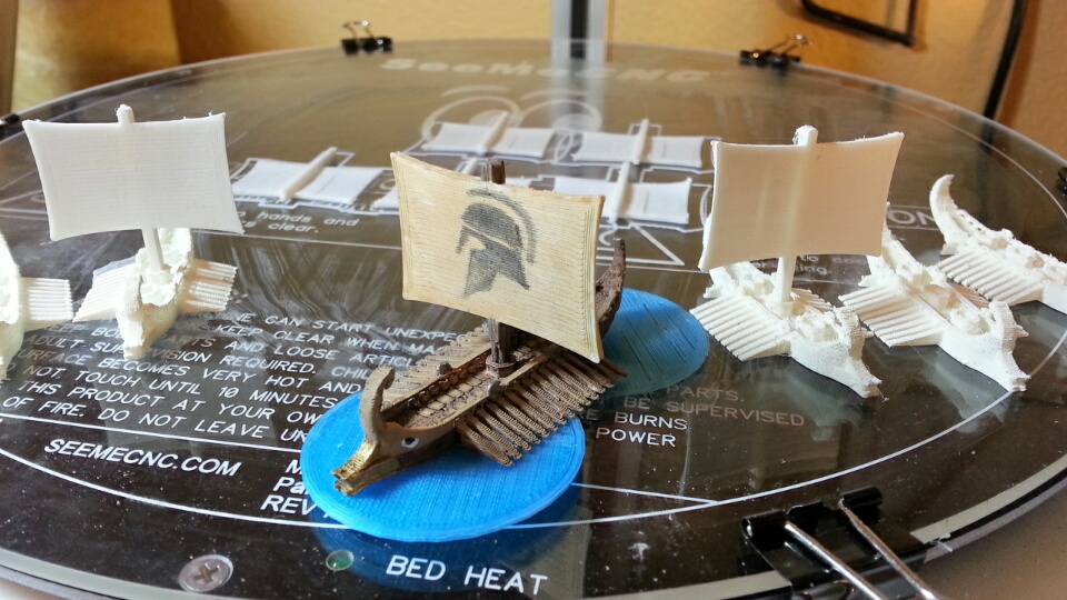

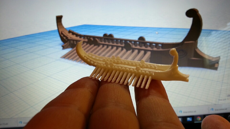

Here are the latest STLs that work best, and a few pics of the fleet. I painted one of the throw aways really quick just for fun. The STLs are at the end of the post.
I'm working on the Bireme right now. It's proving tricky due to the way the oars are layered.

Agisis
Posts: 131
Joined: Fri Jul 31, 2015 12:37 pm
Re: Greecian Triaconder - Board Game Peice
Post by Agisis »
0.5mm at 0.11mm per layer. White PLA at about 183c. Very slow print speed with fast retraction. Bed temp at 73c with supports. Tried using my 0.35mm nozzle, but there is a clog in it that I cannot get out for the life of me.
