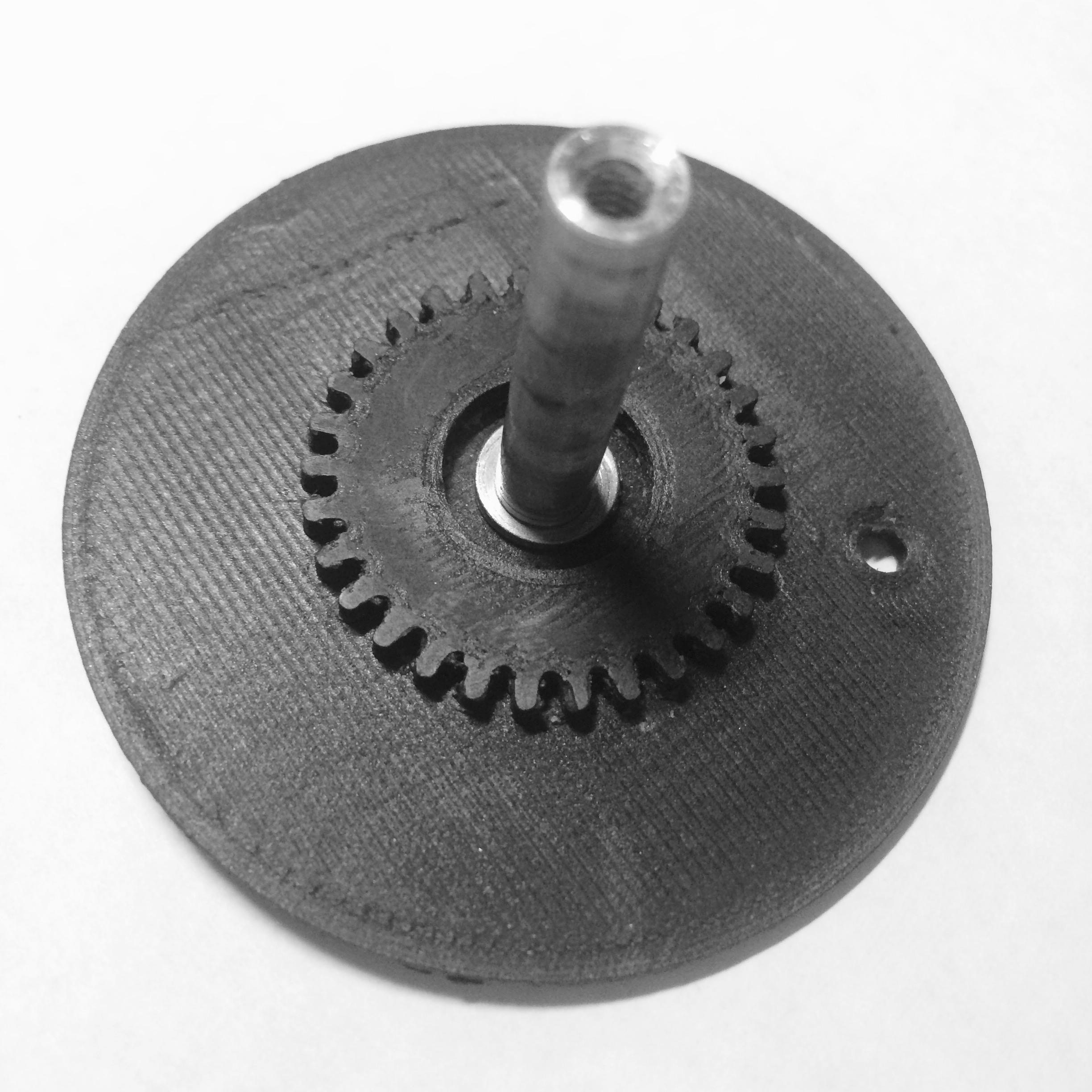

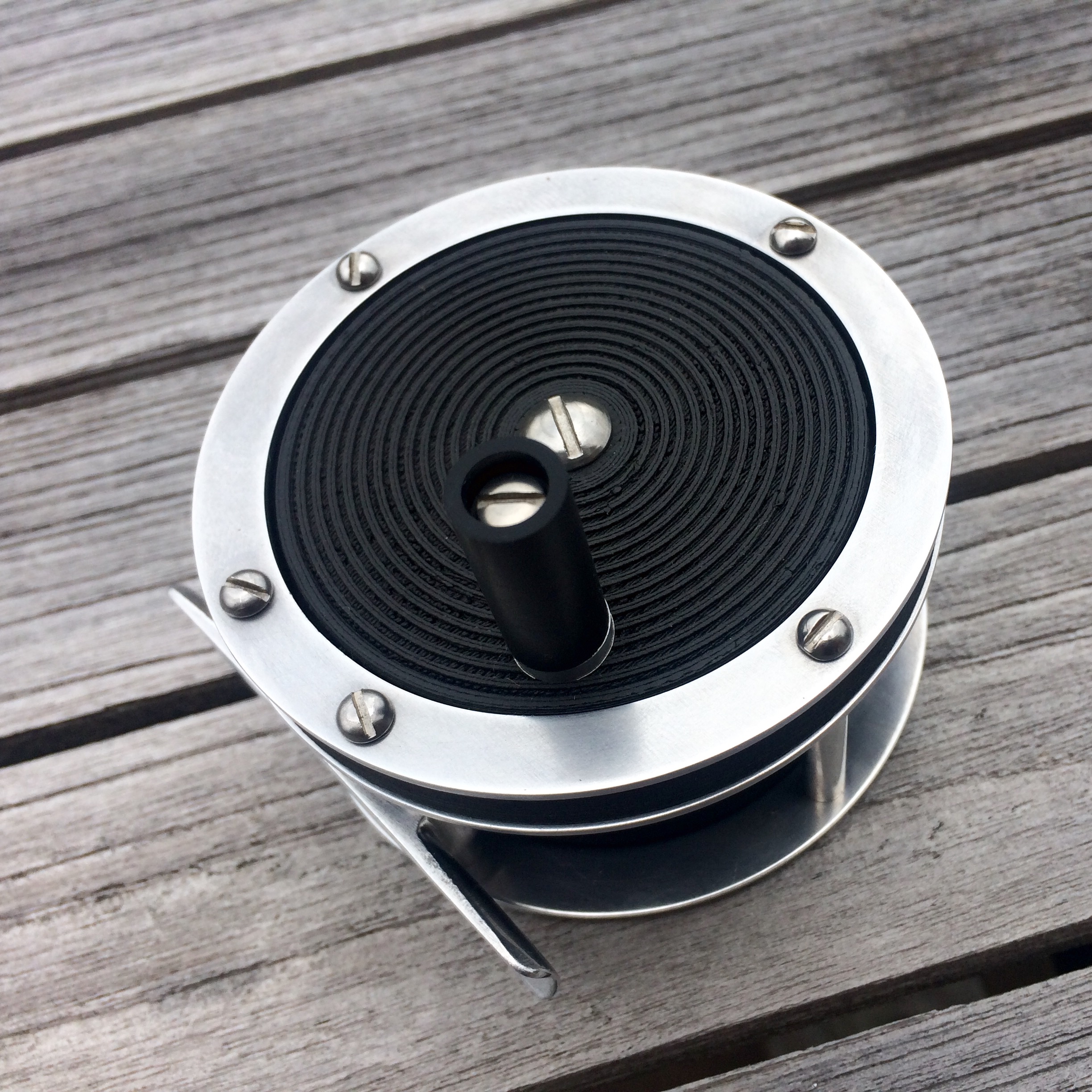

For the past few months I've been working on a hybrid metal / 3D printed carbon fiber composite fly reel based on the Hardy Perfect design. It is a challenging reel to manufacture using traditional means but 3D printing makes it much simpler and results in a really nice product.
There are four printed parts. This component is the trick one in metal and is usually made in several parts. But I am able to print it as one part, saving a lot of production cost.

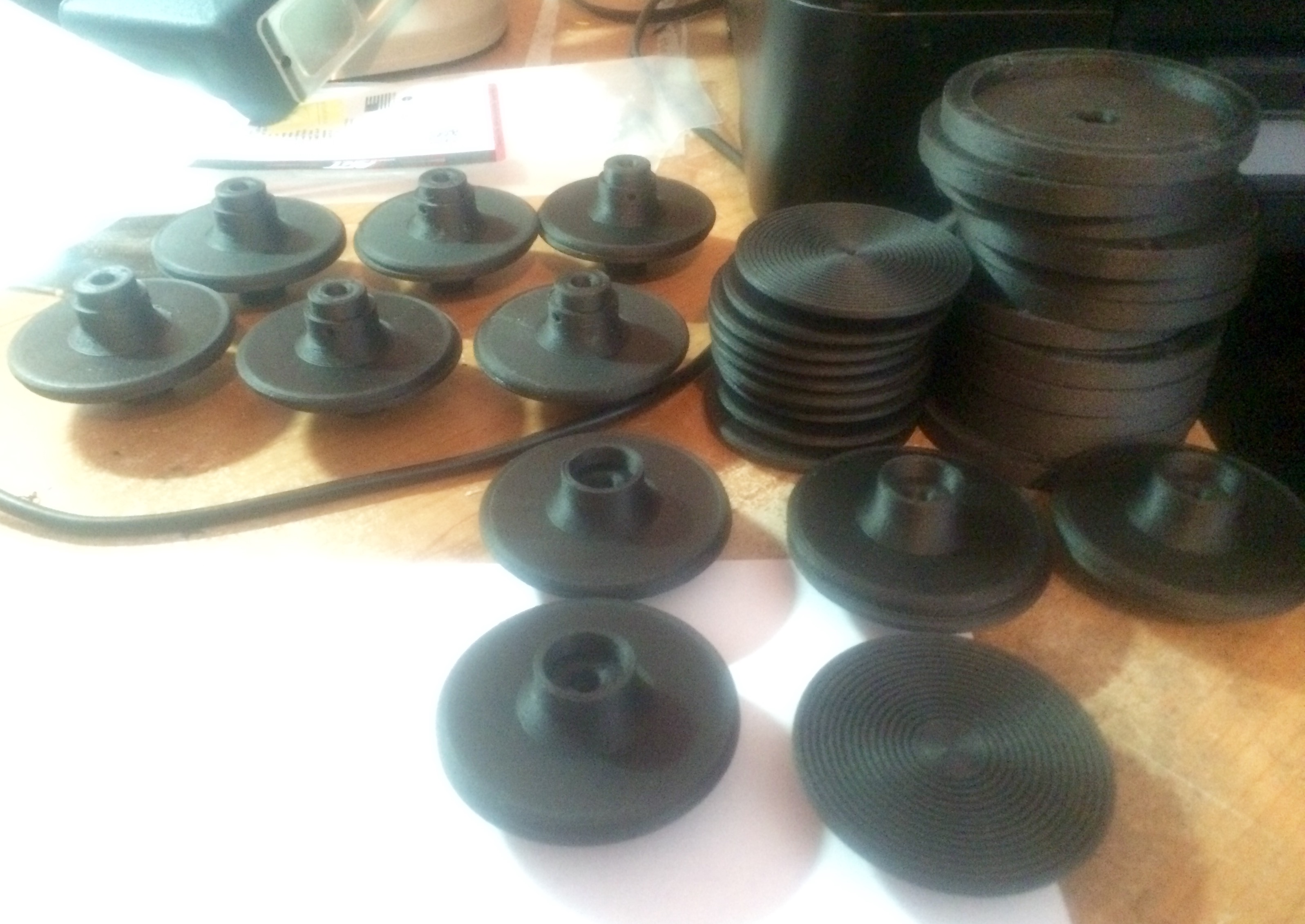

Here are a bunch of parts (12 of each of the 4) all done in Proto Pasta CF PLA ready to assemble into reels.

That looks QUITE nice. I love the departure from "pure" 3d printing to a hybrid.

would love to see an exploded assembly on the bench of how that thing goes together......... the reel side with the gear, do you press the shaft in, or is it held with the flathead screw?
Tom C
MAX V1
Corvair750
V6 Hotend
Robo 3D
Flashforge creator
Re: A hybrid fly fishing reel
PDG Instructions.pdf
(743.5 KiB) Downloaded 444 times
Rather than explain it all, here are the instructions that come with the kit. They tell the whole story with photos and drawings.
