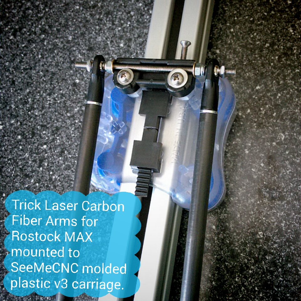

Just a FYI ... the Trick Laser CF Arms do work with the new molded plastic v3 carriage.
We now included M3 fender washers with arm sets to better grip the axles on the new plastic carriages.
The stock washers DO work, but barely, the larger washers insure a firm grip.
(the photo shows stock washer on left and the larger washer on right.)
